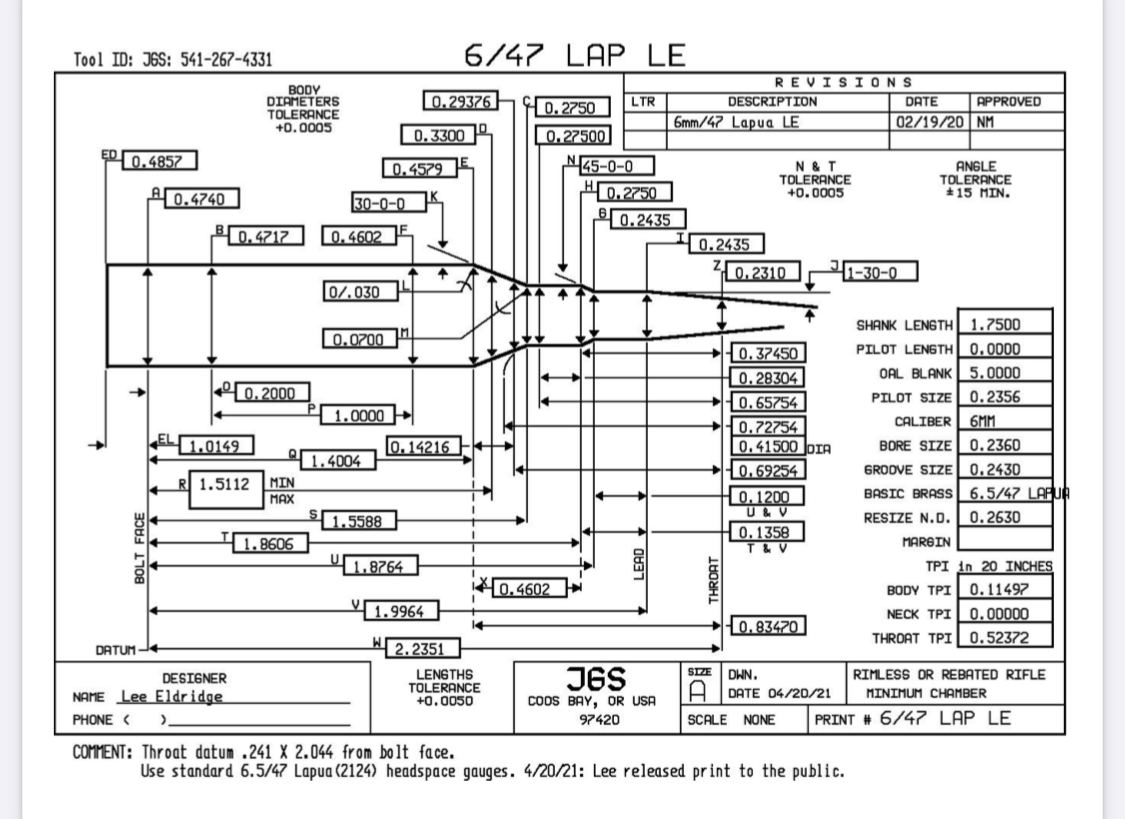

I know its proprietary.
Understood. Measurements of a fired case neck diameter, and BTO or OAL measurements of a loaded round touching the lands would help if you have those available.
It's more curiosity than anything, I'm not looking to steal their IP. I've been reading up on 6x47L a lot lately, and there are as many "it's finnicky" threads as there are "it hammers" threads, so I'm trying to figure out what the truth is. From what I can gather, a 0.272" or less neck is bad, and 0.274"+ neck is good. Beyond that I'm not sure.
I read a very early thread discussing 6XC vs 6x47L, and it was determined one could make a 6x47L barrel and dies by simply machining 0.049" off the base of a 6XC barrel or sizing die. So if the 6x47L is really a 0.049" chopped 6XC, I don't understand why it would throw fits or be hard to stay in tune when the 6XC is so highly regarded.

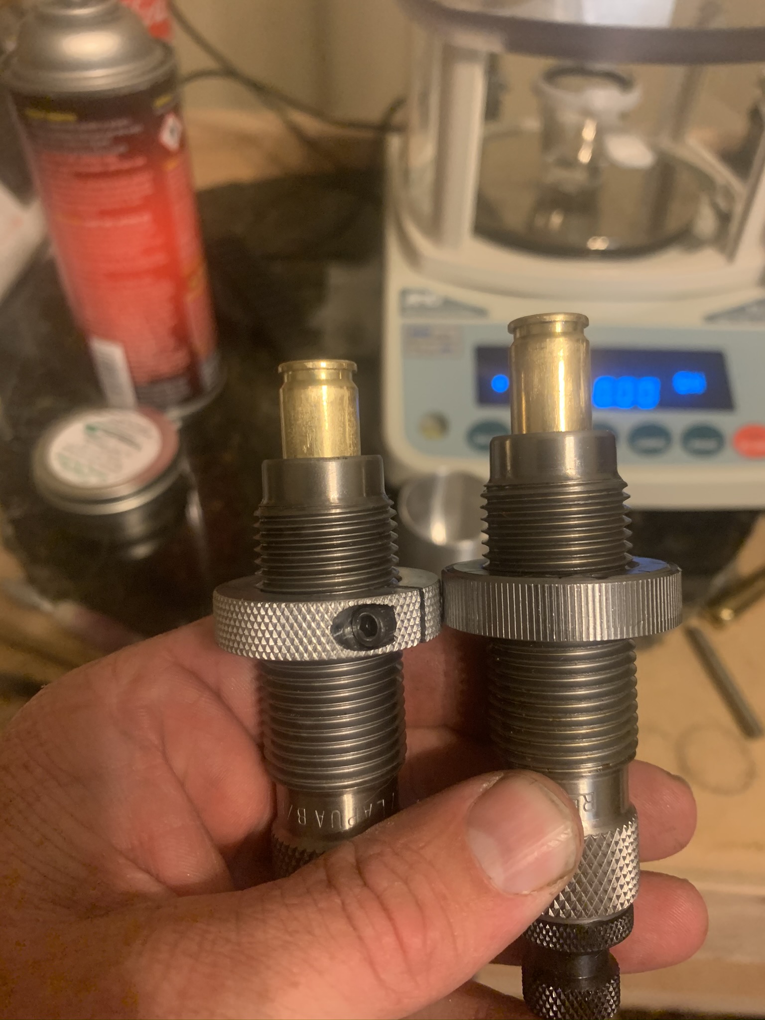

Did you make sure the body retains the same dimensions as the 6.5x47? A lot of reamers (no idea why) decrease the size of the body.
Even Redding seems to be using a smaller body for their 6x47 die. I use Erik’s reamer which keeps the 6.5 body and a .275 neck. In the pic, left is a Redding 6.5 die and right is a Redding 6 die. Brass is fired out of the same chamber:
Reactions: DIBBS
To be honest, I did not do that as I had never even heard of the "leave the body a 6.5" thing until very recently. Now I am a bit concerned about that but the reamer was ordered in late January so its probably too late is my guess....
