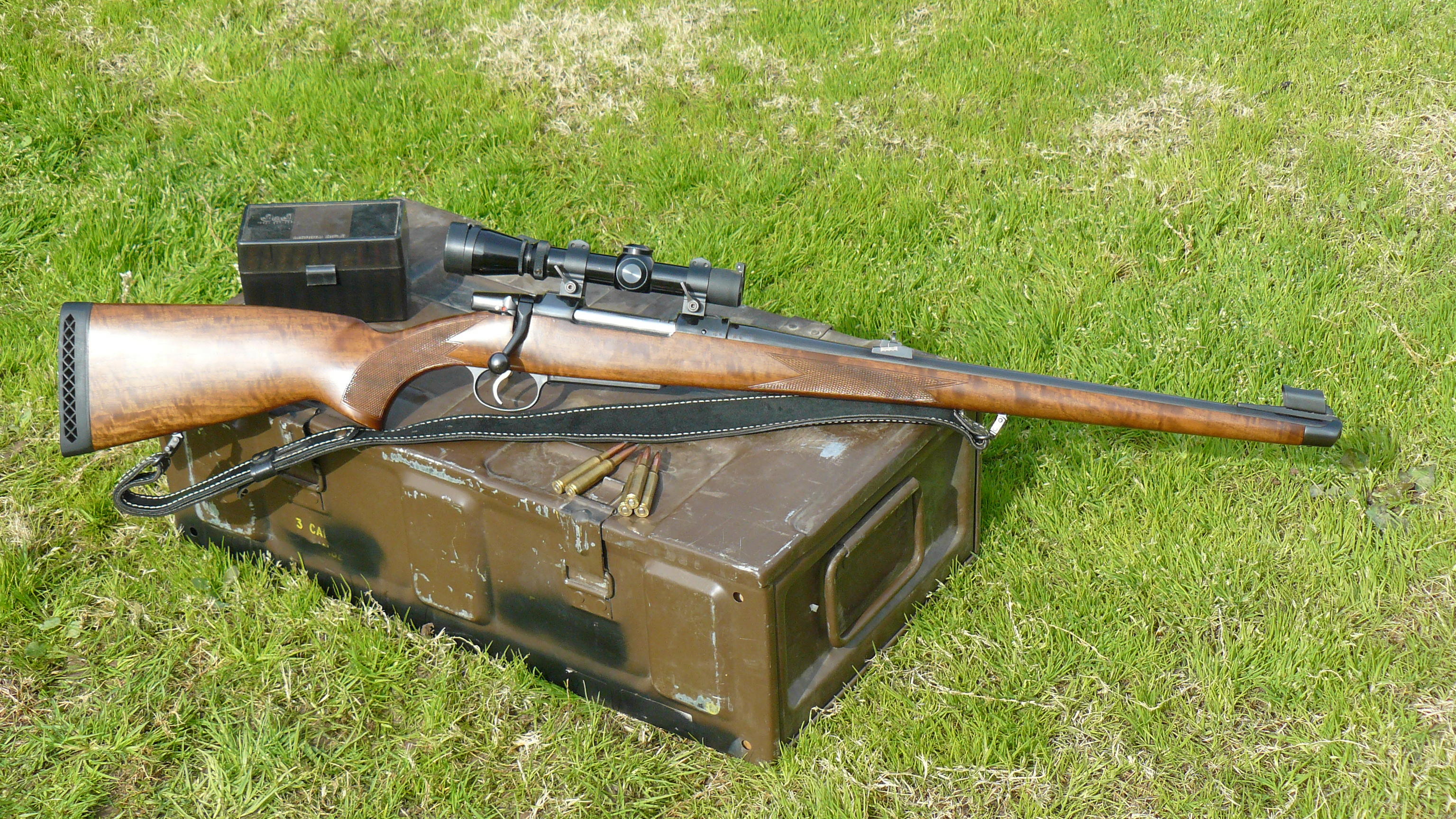

I had a CZ 550 Full Stock in 6.5x55 with a 20.5" barrel. It was plenty accurate.
I was getting 2800-2850 with the 123 amax and 2650-2700 with the 140's. I would think you could get +/- 2900 with the 140's and a 26" barrel set up on a long action.

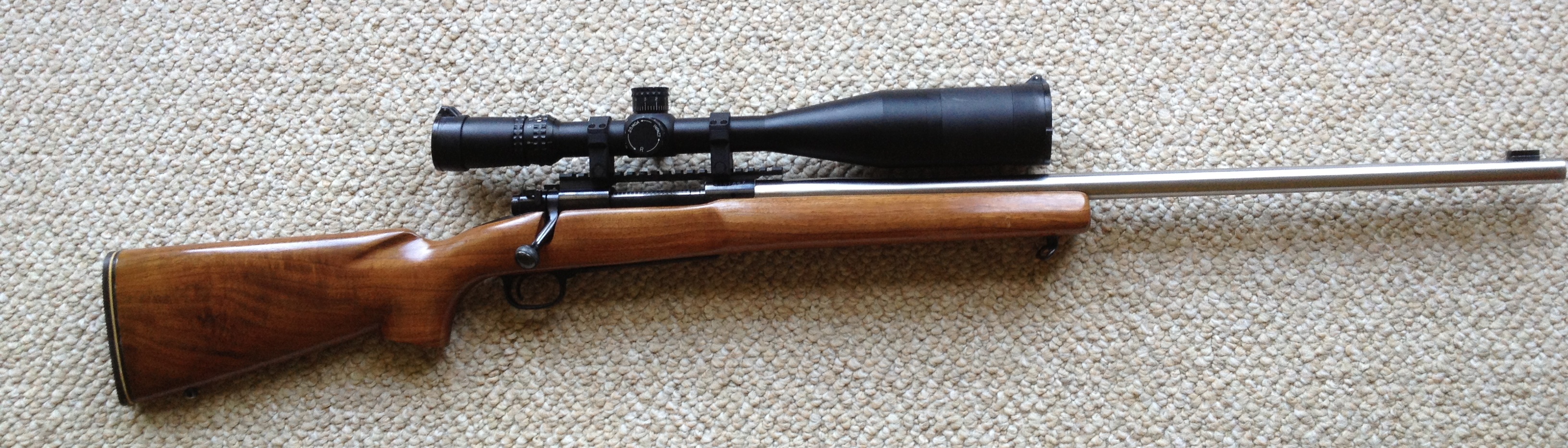

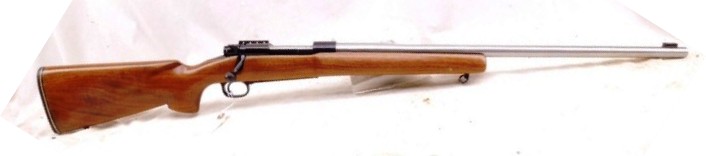

IMG_5584 crop.jpgI love my CG/63's, but I just picked up a modern M70 match rifle 6.5x55 and it's pretty amazing.
Larry Racine full build with Rem Varmint contour 1:8 twist, set up for irons and stripper clips.
I put a Nightforce on it, and with some load development this could be my favorite rifle.

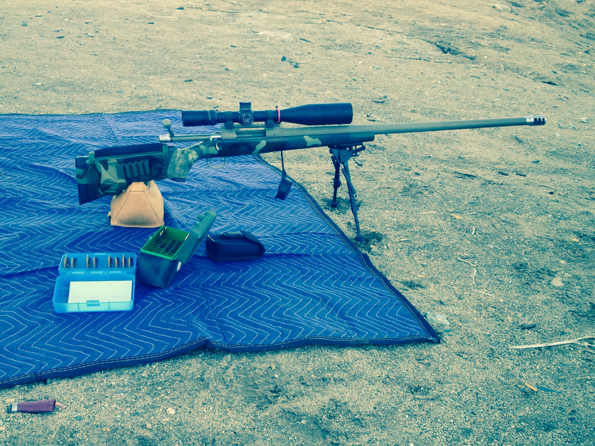

Oh what the hell, I don't post much here but this is up my alley. Here's my ugly duckling. I upgraded to a DBM and a new stock a few months ago and haven't got any good pics yet.
You can believe me when I say this biche hammers. 29" Krieger, Rem700 stainless long action. Won a few ribbons at our long range steel shoots here in N. NV. This barrel has been fast. 136Scenars at 3050, no pressure problems. Killed several antelope, and marmots. Still shoots lights out after 2500+ rounds.
