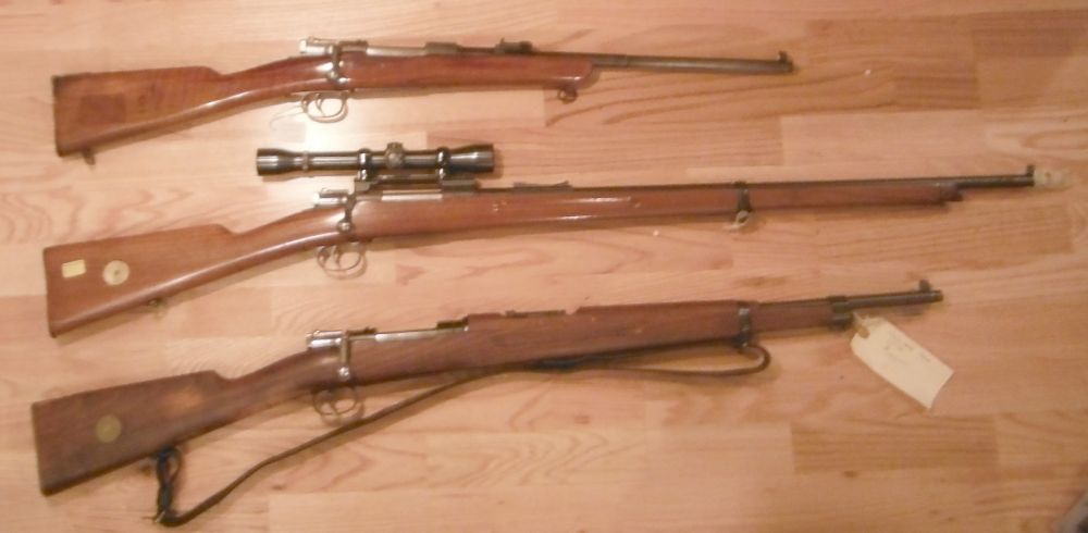

I have a 96 Swede I got for $100 in 2002. I bend the bolt, drilled and tapped, and hunted with that rifle. [the date is under my scope mount]
I have a 38 Swede I got for $135 in 2004. I have not shot it. It looks kind of unfired. 1942
I have a 94 Swede I got for $80 in 2008. I have not shot it. I looks like someone really sporterized the stock. 1903
I have a 96 Swede I got for $130 in 2013. I have not shot it. 1912
I have a 260 Reamer and a 6.5-06 Reamer. I am more focuses on those rifles now. The American made 6.5x55mm brass is made on standard tooling and is closer to 0.4703" than 0.4770" that it should be.
