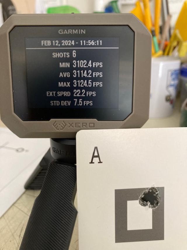

It was one of those days when everything worked as expected.
6.5x55 SE in a Bighorn long action w/ 29" Bartlien 5R 1/8 twist
123gr Scenar
Lapua brass / large rifle primer
H4831 SC / 49.6gr
CCI BR2
My Oehler 35P chrony finally stopped working after many years of good service, so I decided to upgrade to the Garmin. Form factor and simplicity make it worth the money for me.
I had planned on shooting a 10 shot string but a cease fire was called so I only got 6 shots down range.

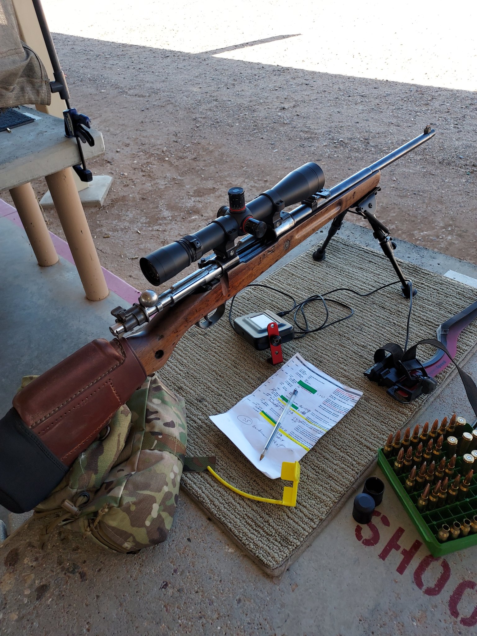

For those of you shooting lighter bullets, I'm going to be testing the 129 Nosler ABLR and the Hornady 135 Atips next week. I have a Gustaf 17" carbine length barrel on my build that really likes the 108 Scenars best so far.

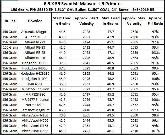

Got out today to test the Nosler 129 ABLR, Berger 156 EOL and 120 Nosler BT bullets in my Swede Carbine. Had some 108 Lapua Scenars also in the mix. The 156 EOL shot best with the ABLR second, both using IMR 4350. I tried CFE223 with the 108's, 120 BT and ABLR. None shot well with this powder and the recoil impulse was way sharper!
Threw CFE in the mix due to the short 17" barrel. Wrong assumption! Spoke with Berger today to get their load data for the 156 EOL and the confirmed slow powders is the only way to roll with the Swede. They are sending me their load data (hopefully today) for the Swede.

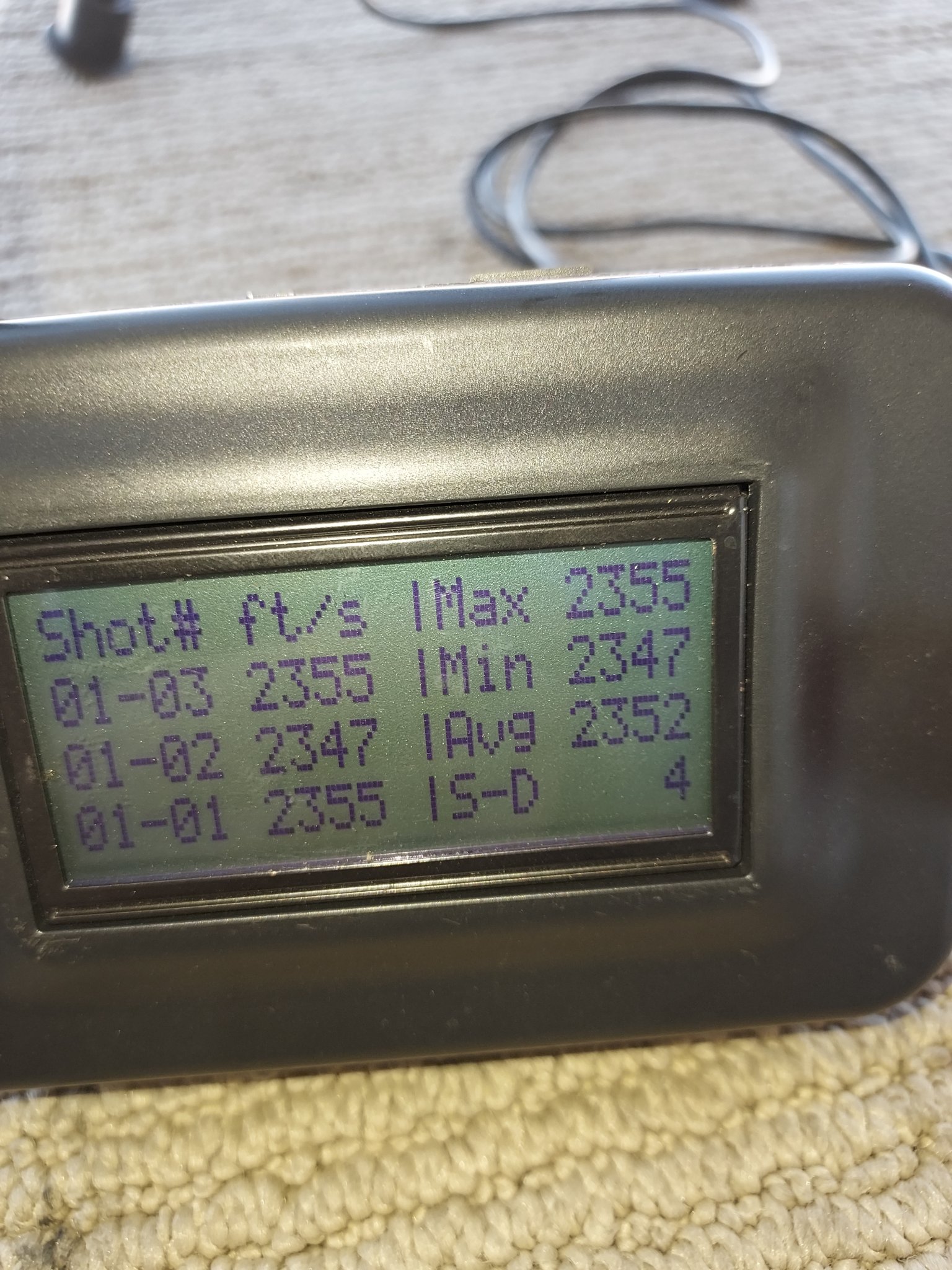

Finally got a chance to test some loads albeit very limited. Chrono tested 3 loads with 3 different bullets. Slow speeds but to be expected with such a short barrel. Tested 3-shots with the 129gr ABLR , 135gr Atip and 156gr Berger. The Berger shot best at about 1.5 inches with one pulled for sure.
Going to stick with the Berger's going forward since its the only bullet I can get remotely close to the lands with this old carbine barrel. If had to guess its only about 85% fill capacity with the 42.0grs of IMR 4350 I used. Moving to slower powders on the next go round.
Berger provided me with their unpublished load data for the 156 in the Swede which is attached for reference.

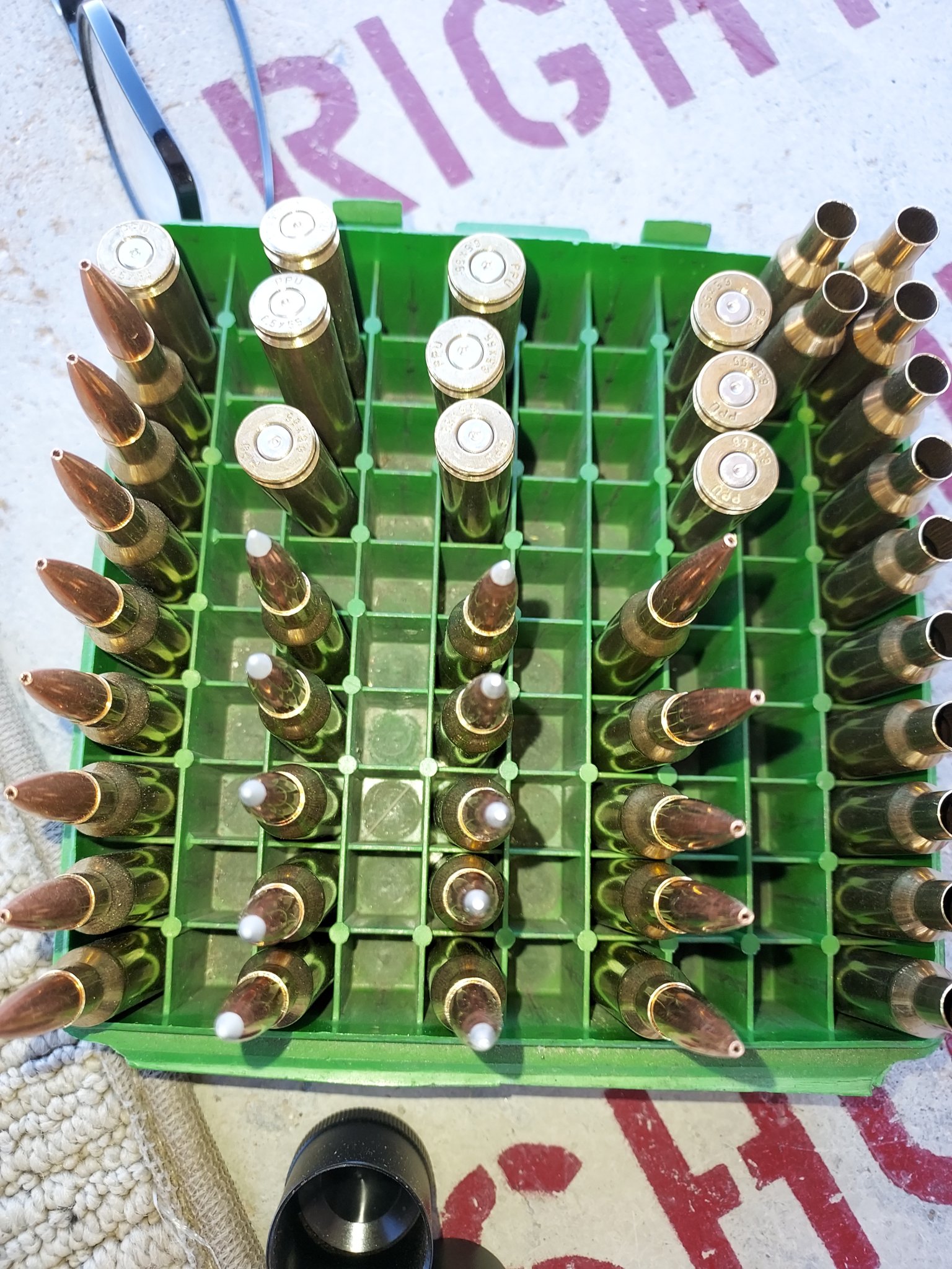

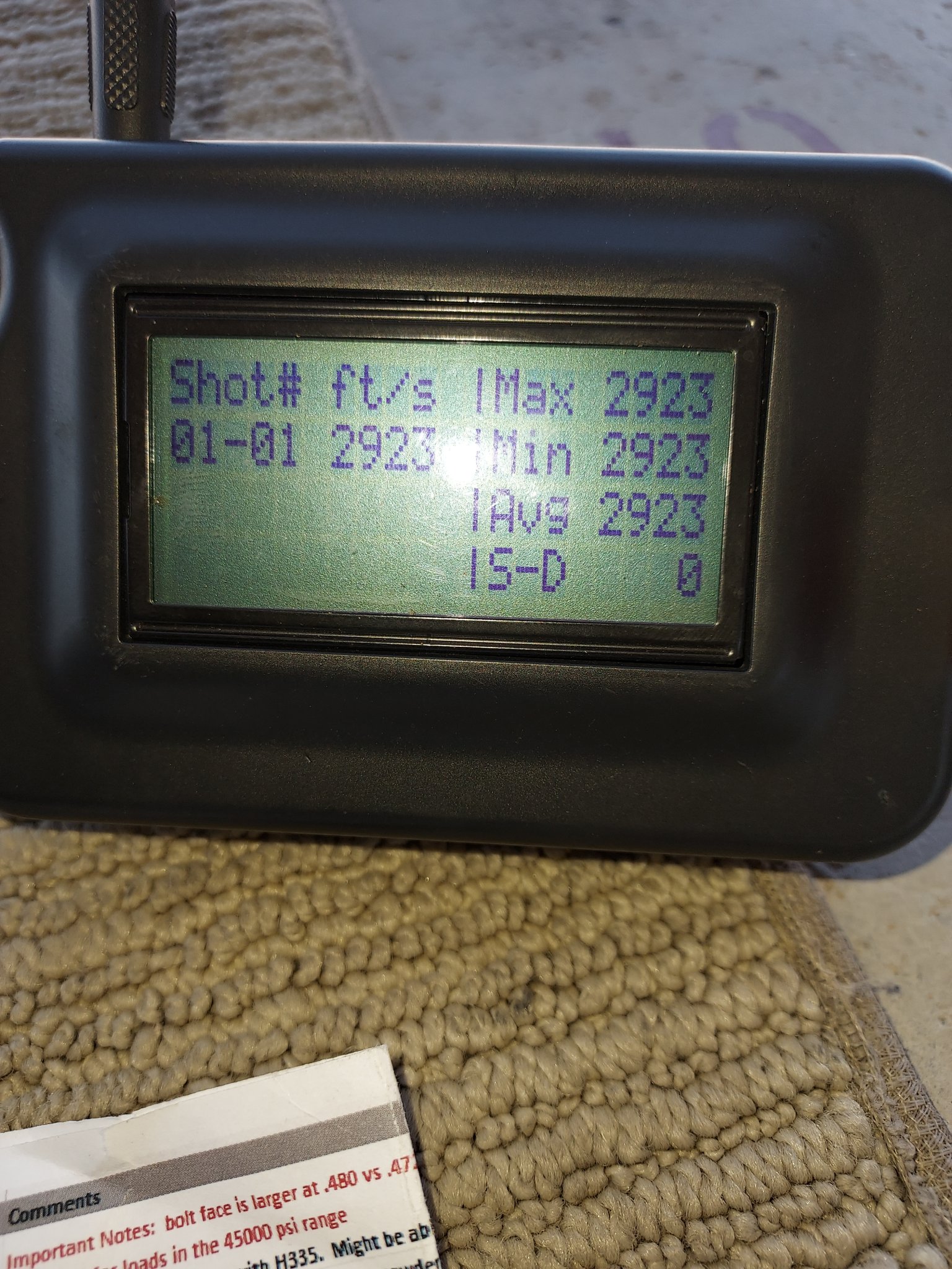

Forgot to add that I did shoot one round of a very hot load. Got the Lapua 108 Scenar rocking with 47.6gr of IMR 4350. This is too hot based on previous testing. Need to break them down and reload to a max of 47.2.
