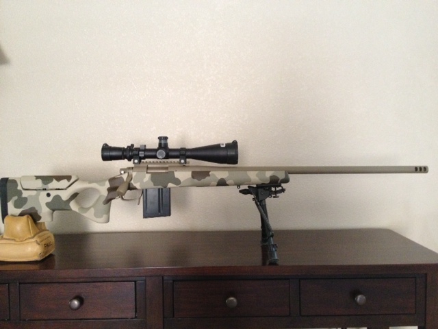

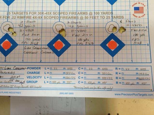

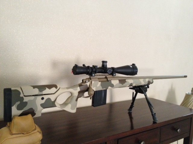

    My 6 Creedmoor built by Moon of Crescent Customs arrived yesterday. Took it out and broke in the barrel with Berger 105's Hybrids using 41.5 H-4350 which shot well, but today I took it out and tried 42 grains of H-4350 @ 2.80 COAL and they shot better. The 3rd target is 6 shots with the 1st shot being my flyer, the other 5 grouped together. My info is recorded next to each group. Bottom info is another rifle on a sample target I used. So far, I have 48 rounds down the tube.
    Rem 700 trued
    Bartlien Barrel, 26" Med Palma
    Badger DBM and Muzzle Break
    Manner's T-5 Adj
    Jewel Trigger
    Leupold Mark 4 FFP

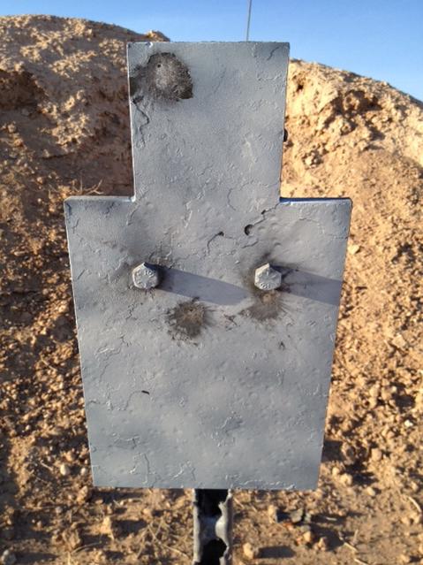

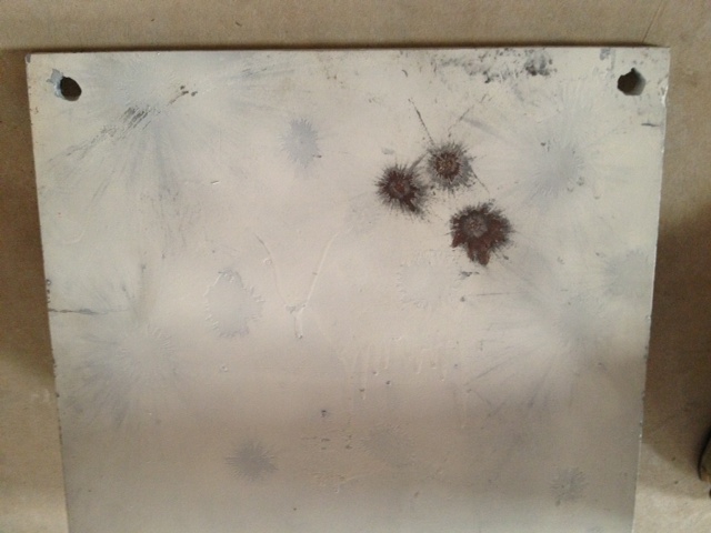

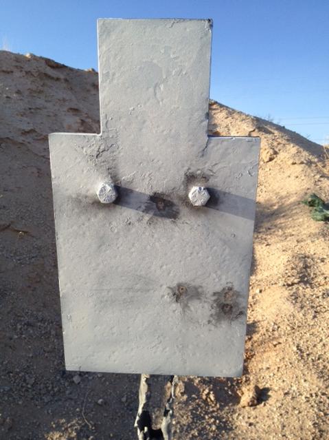

    Took the 6 Creedmoor out for some distance shooting at steel. These are the results using 42 grains of H-4350 @ 2.80 OAL and the 105 Hybrids- 3168 fps
    3 shots @600 yds
    6 shots @ 656 yds
    3 shots @ 712 yds, Took first shot, hit the head, adjusted elevation down and took 2 more.
    4 shots @ 760 yds Again, first shot high, adjusted elevation down, then shot 3 more.
