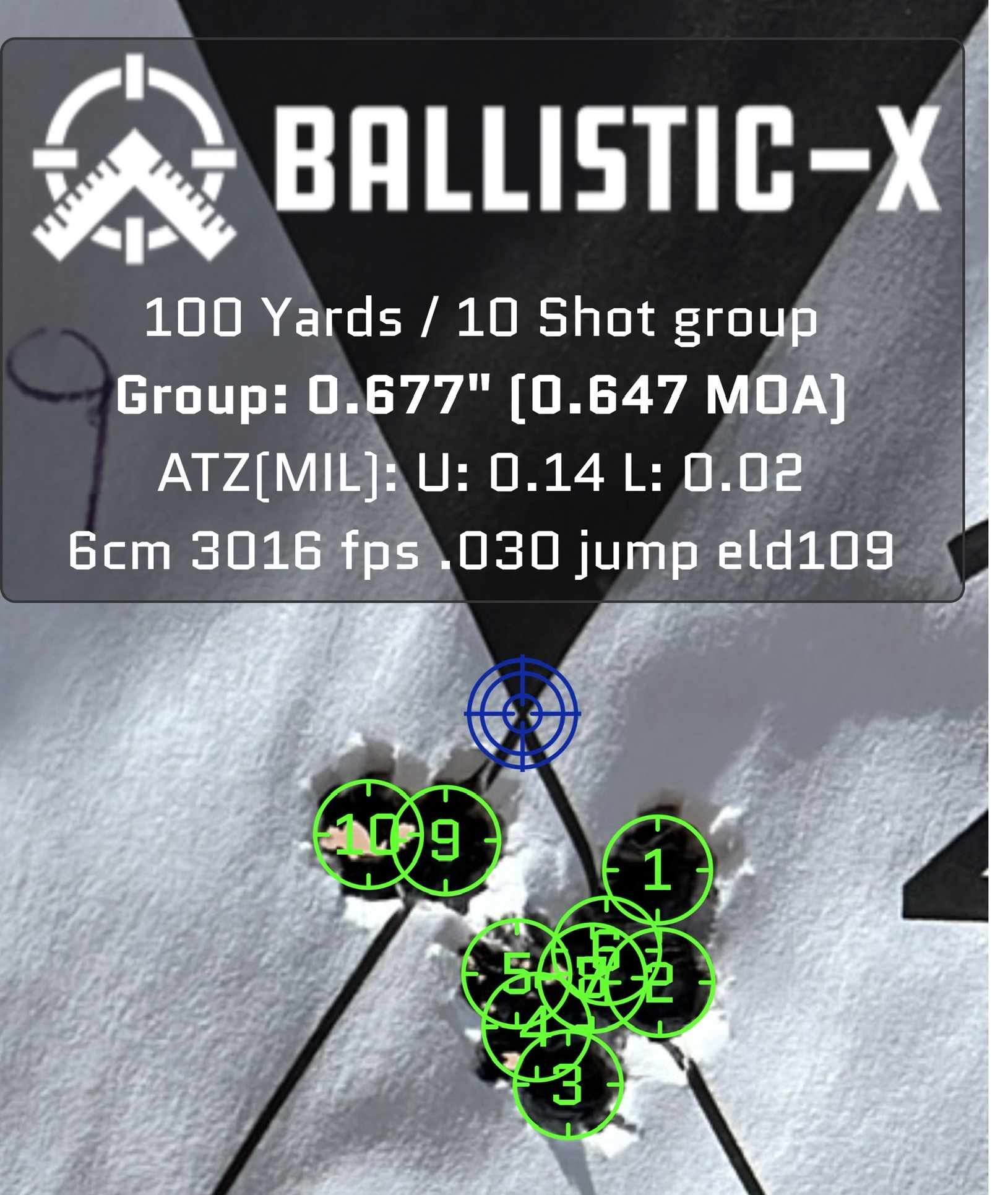

39.4 IMR 4451, virgin lapua 6cm SRP. Hornady ELD-M 109. Jumping .030. This is shot 31-40 on a new barrel. This group avg was 2975. End the day with the last ten shots going 3016. I know one of those flyers was me for sure.

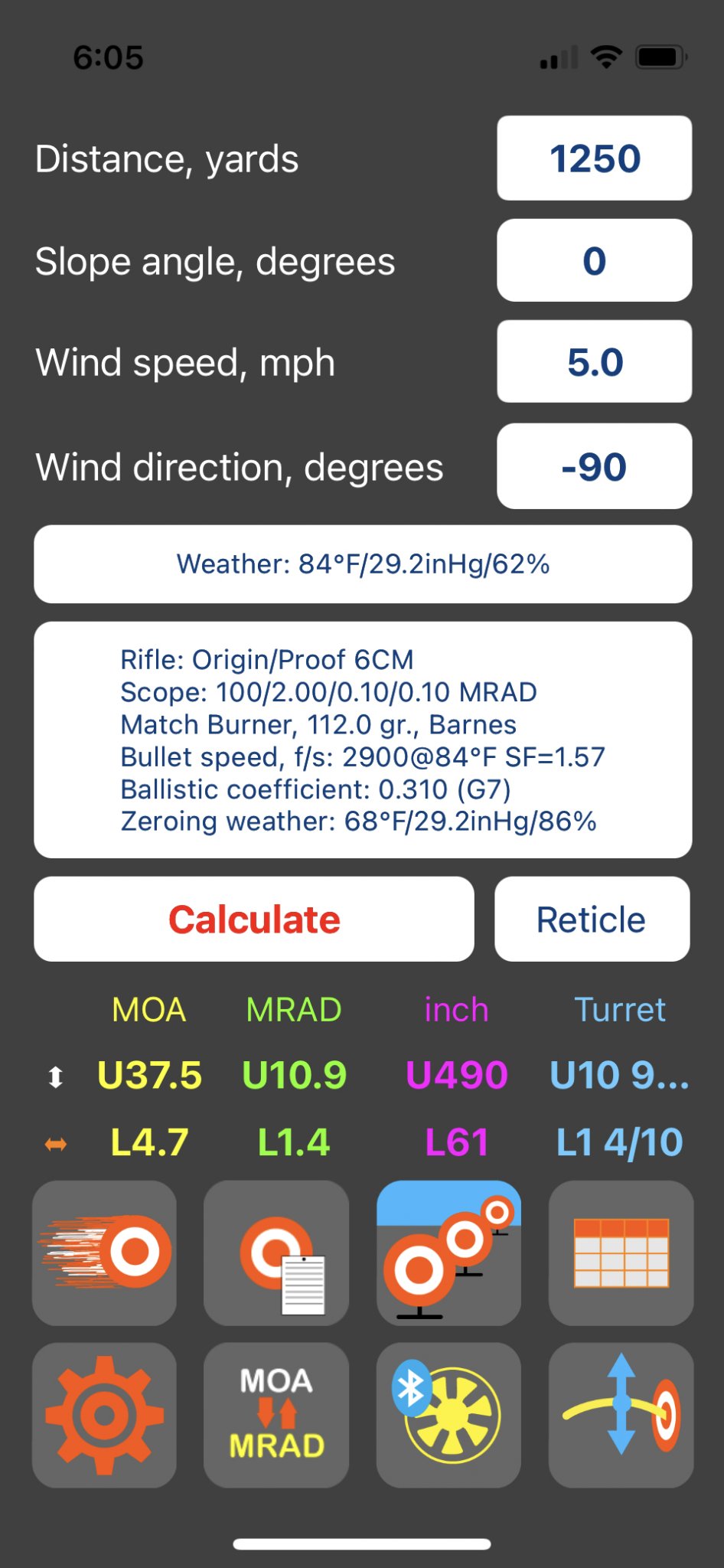

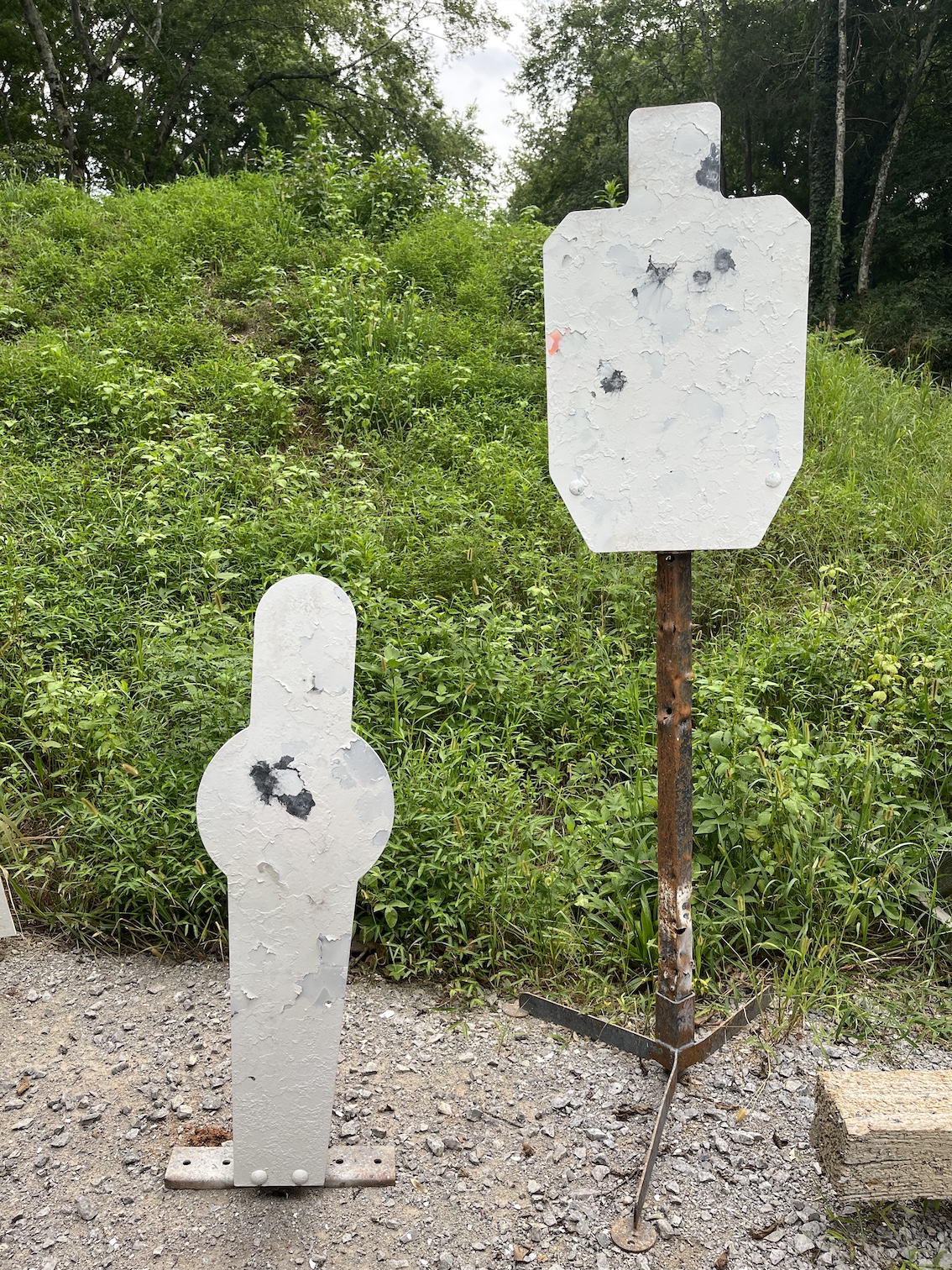

I'm not going to say the 112gr Match Burners are better than A-Tips or Hybrid 109's, they're not... but they aren't half as good either (even though they cost half as much).
112gr MB, jumping 100 thou, 41gr Staball, Fed 210 LRP, Lapua ex-22-250 8x fired
1250 yards, 5 shots on the IPSC (+ 2 on the popper to make sure it wasn't luck), calm conditions (~5mph), bag/bipod/bench, .310 G7 for $0.27 a bullet:
Reactions: IronicTwitch
View attachment 7941046View attachment 7941047

I was talking with a guy at my club the other day about how some reloading components can reach rock star status while others can end up with a reputation as being dogshit... and how most of this misinformation is fueled by guys who seem to hardly ever shoot beyond 100 yards.
I'm using Match Burners + Sta-Ball... which "the internet" (including the Hide) might have you believe is a recipe for total garbage... nope.
A-Tips and/or Hybrid 109's may indeed help me shoot a .3" group at 100yrds vs my usual .5" group I see with the MB's (though it might have more to do with the fact that I hardly ever shoot groups at 100 and therefore suck at it), but, in the big picture, fuck 100 yard groups, who cares lol!
I use a baby 7" wide x 12" tall IPSC at 750yrds to tell me if my load/gun is shooting ok. If I can empty a mag on it under calm conditions, without trying too hard, then there's no doubt: when I suck/miss, it's me, not the gun!

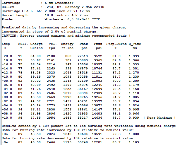

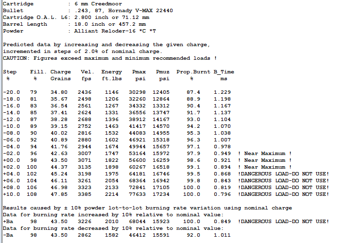

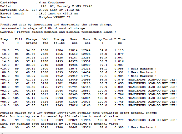

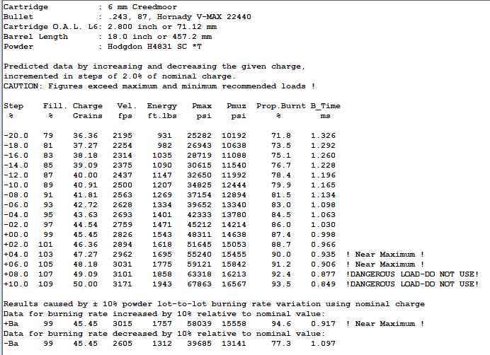

Getting a 18" 6 Creed barrel for my thermal coyote rifle. I have Lapua SRP brass, 87gr V-max, and StaBall, 4451, 4166, Varget, H4831sc, and Rl16. Any suggestions on what would give me the best velocity?
I did some research and 4451 looks like it gives decent velocity. Thinking about trying the 75 gr V-max for a little more velocity. I know I will give up some bc, but this is going to be a 300-350 yard max rifle at night.
I’ve been using 4451 with 105-110 grains. I like it. Works well. Current load is 38.9 with an 110 atip at 3100. (28” barrel)
