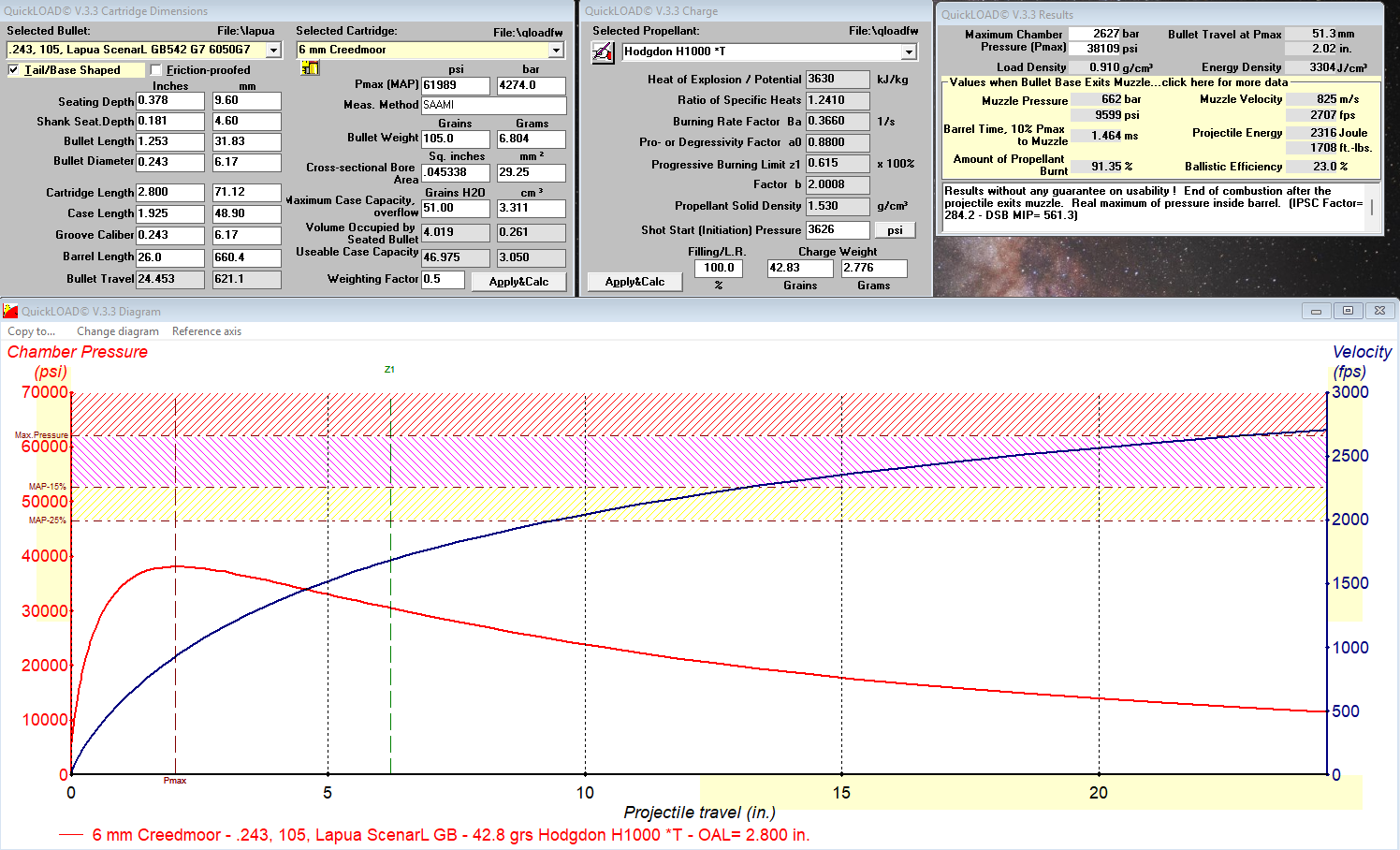

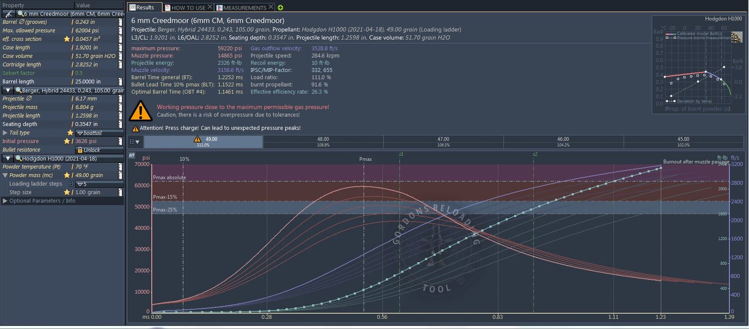

4350-4831 is the most common burn rate powders used. You can test it, I don't believe you'll be able to fit enough powder in there that'll get you close to trouble. Modeling shows 49gr will move a 105 over 3100fps at 59k psi. Try to use some your older lots, the stuff from last few years is slower burning than my old stock by a fair bit. I pull this off another site but it's near match to my GRT info.
Nosler listed H1000 as their most accurate powder tested... pushing 105-107 grain pills in 6 Creed. They list 41 to 45 grains max/min with 43 gr being the charge that yielded the best accuracy.
H1000 was far from yielding the highest velocities. But they were respectable enough.

I use H1000 in my 6prc lol. My suggestion, load em long, use a drop tube, add powder till you start to hear the slightest crunch while seating. That's max. Shoot 5 rounds at that charge, if accuracy and velocity is acceptable, run it.......
