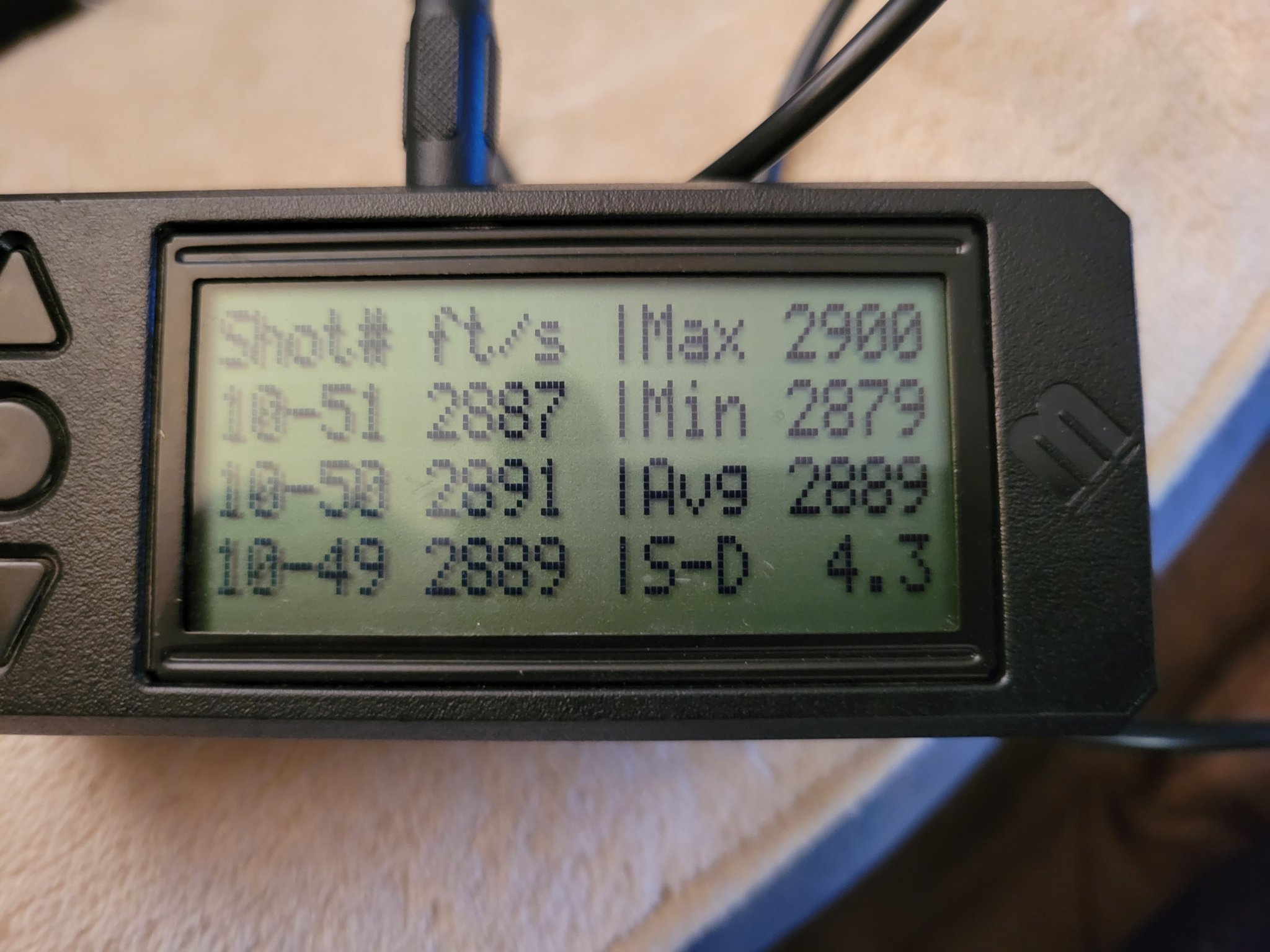

I went from 34gn to 33gn of SW Precision Rifle with 112MBs (2850fps-2804fps) and am really digging it at ~2800fps, easier to see more on plates inside 500.
~2800fps it’s soft like a Dasher and my brass will last forever.

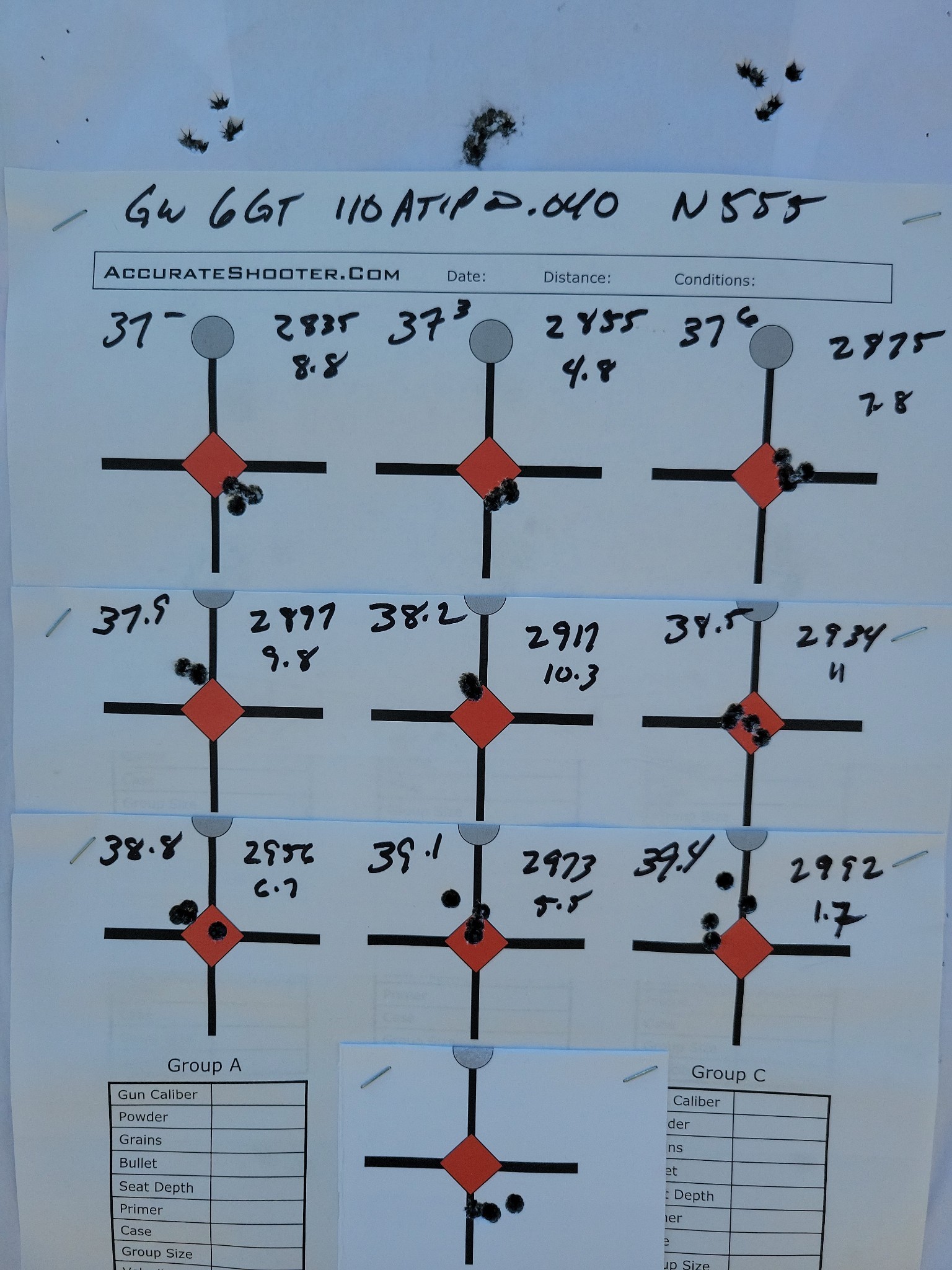

Alpha Gay Tiger brass + 33gn SWPR yielded 2825fps out of a Proof SS 26" prefit.

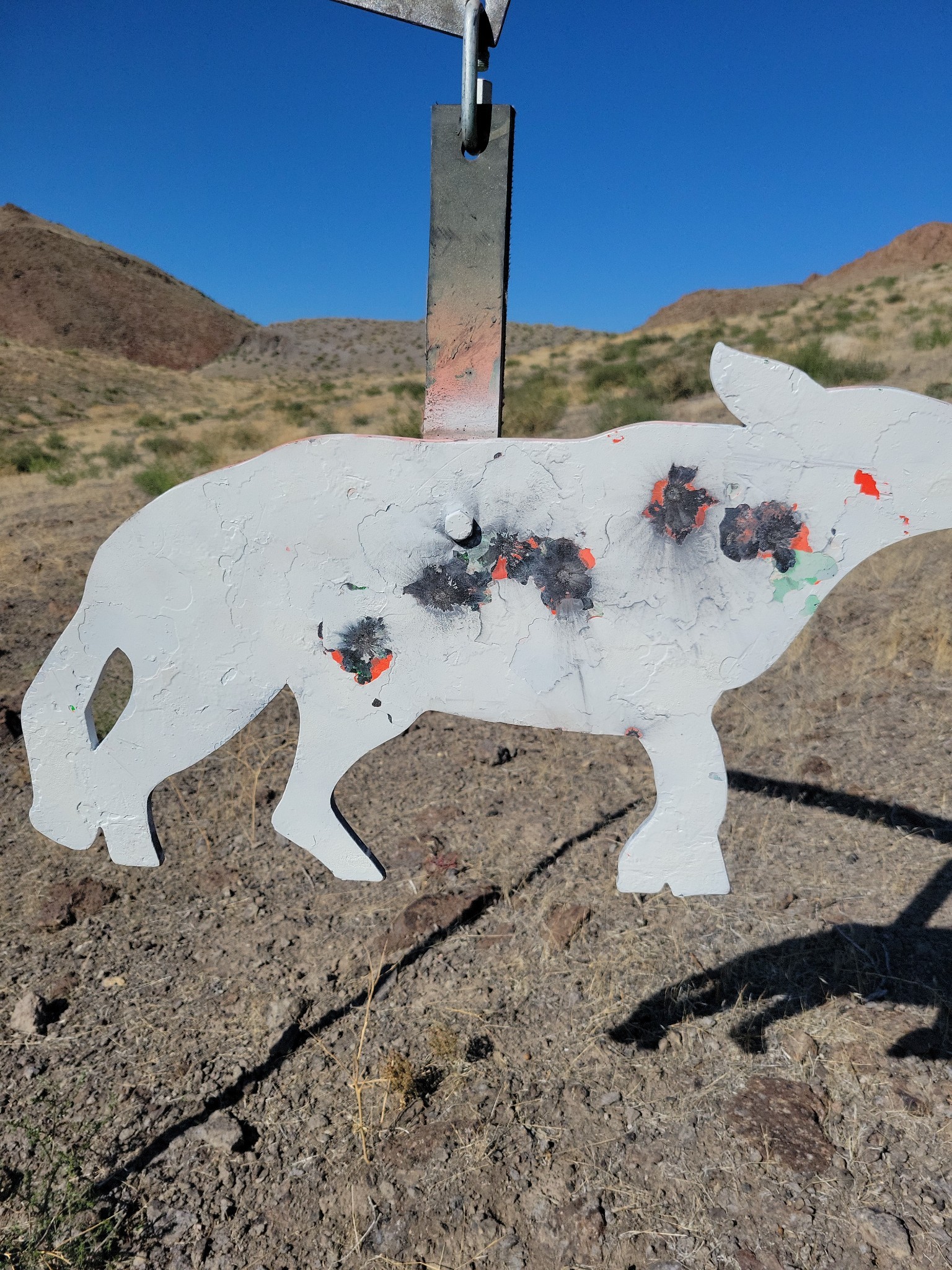

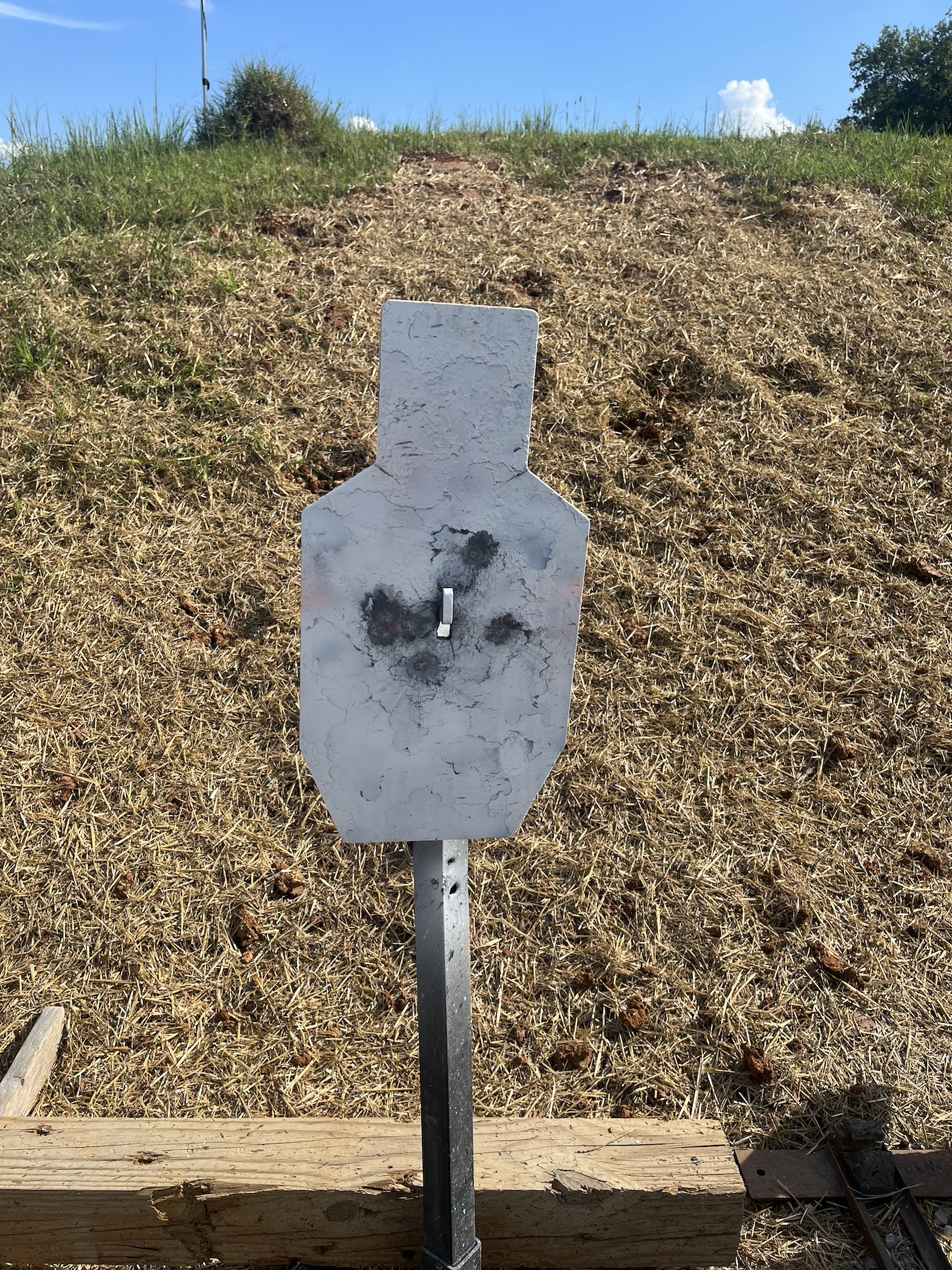

I didn't shoot any 100 yard groups, but here's 6 shots at 750 yards off a cattle gate/Shmedium bag, 33% IPSC:

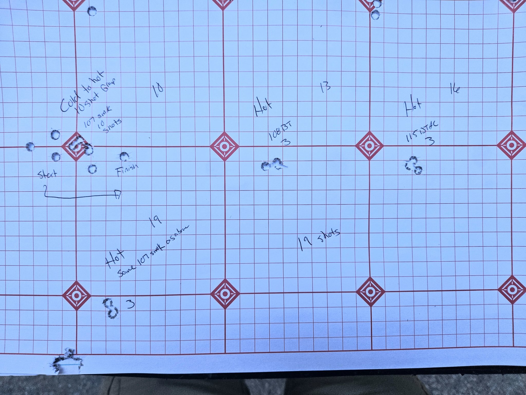

This photo is 3 different loads from a 22" 6gt on a bat action, 107smk at 2880, 108bt at 2860, and 115dtac at 2860. It does this every time I shoot it. Bartlein tells me they won't do anything till I have over 200 rounds and it's settled, blew my mind.
Load development was making me furious, I rarely ever shoot a carbon more than 6-8 rounds, before cooling. This is my 8th gt barrel, I know what they like........and this liked nothing.....until it got too hot to touch. I randomly out of anger one day just kept shooting, and by miracle it shot some tiny groups, blazing hot. It's repeated this tendency 6 times now with 19-20 shot groups.
