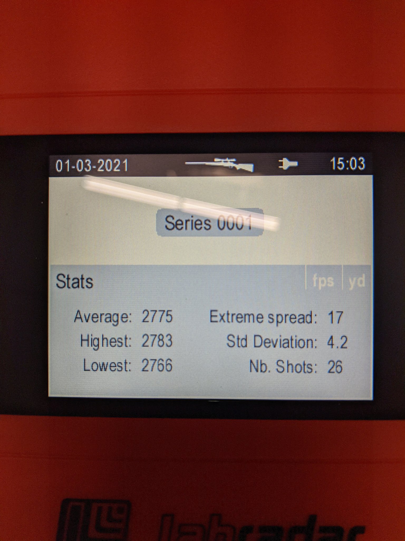

    6mm GT115N55536.530 OTL2854267.5
    6mm GT115N55537205mAlpha OCD20 OTL2775267.5low rnd count
    Alpha OCD brass
    Fed 205M
    37.0 gr VV N555
    115 Dtacs at -.020
    2775 avg es-17 sd-4.2 for 26 rounds (4 of the 30 round string did not register)
    This is w/ 65 rounds on a new Stuteville 26" 7.5 twist. I expect it to speed up to around 2850ish.
