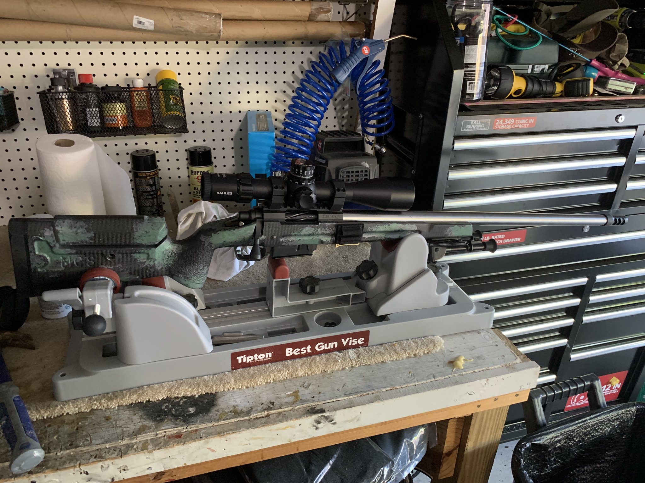

    I also got my Vortex Razor HD Gen II in yesterday and took it out this morning to get it leveled so I can use it on my 300.
    7059564

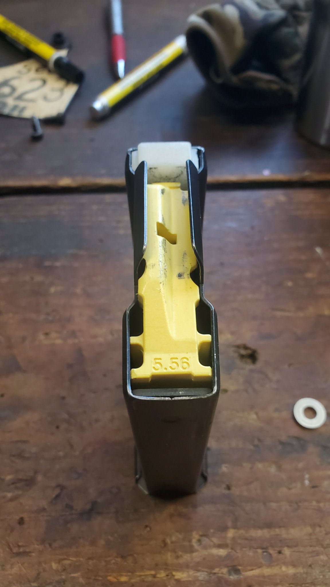

    MDT is now making magazines for short 6 rounds. I got two of those and also three AIs along with Impact's "shortening" kits. For those who don't know, essentially these short mags have a sort of block at the back side of the mag that forces the rounds forward by maybe 1/4" or so.

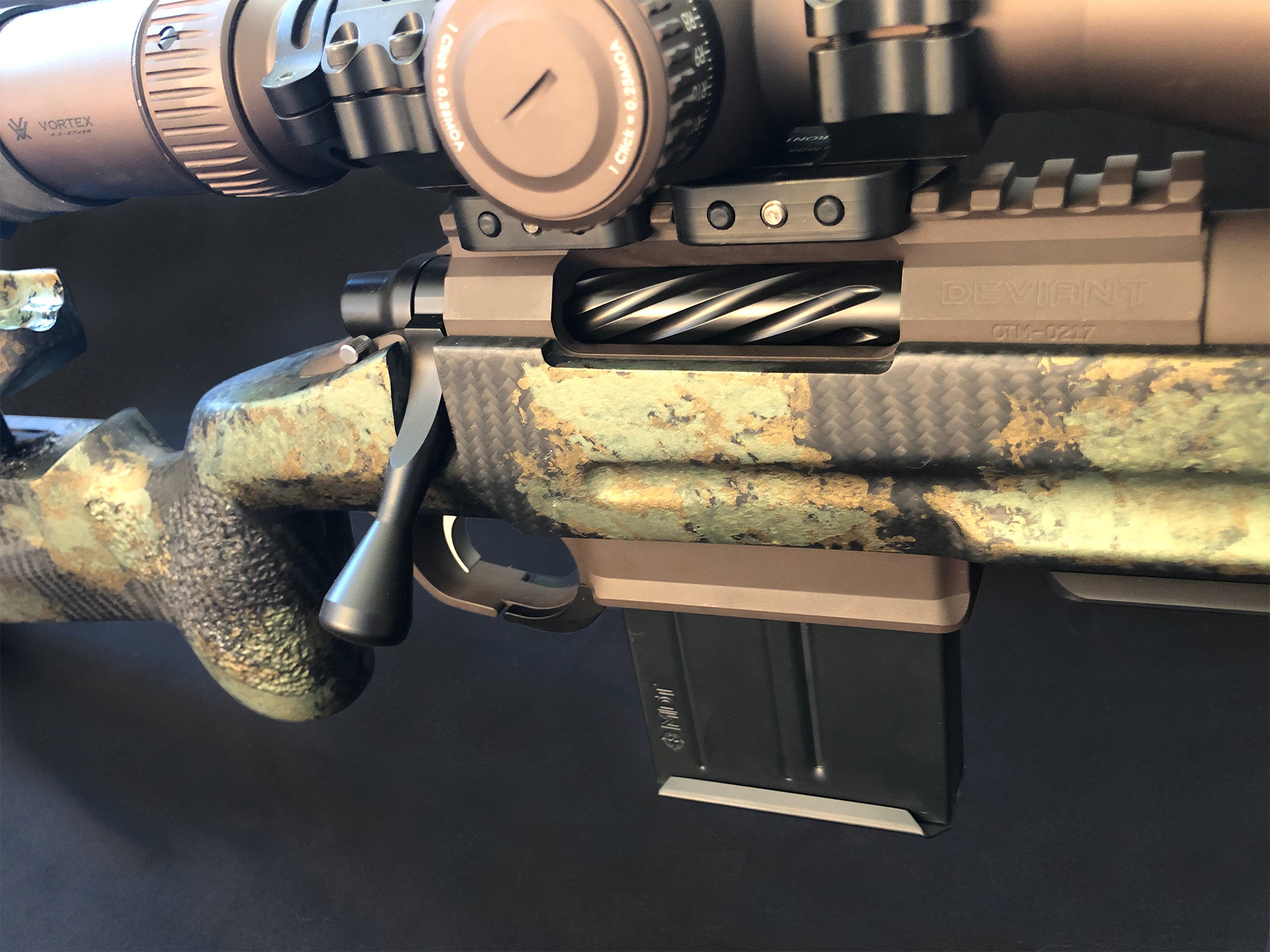

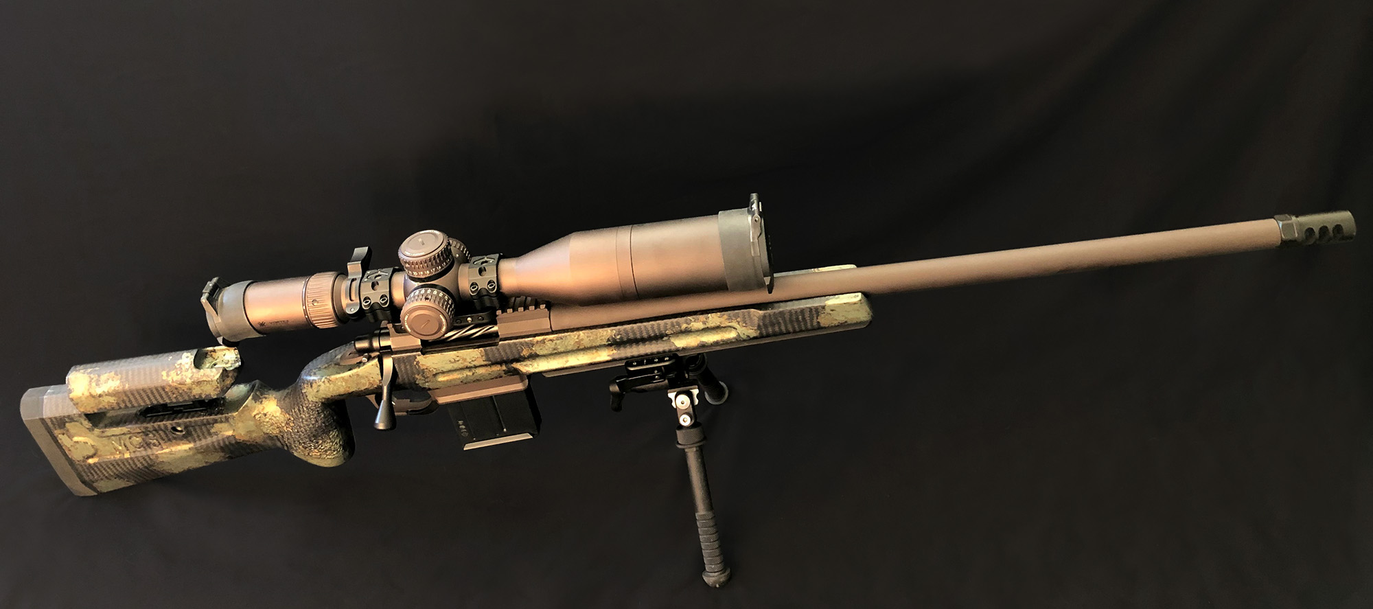

    Full rifle:
    I kept the brake and bolt black and Cerakoted the action, most of the bottom metal and barrel in H293 Vortex Bronze. The scope is bookended by the black caps, and this layout bookends the barrel/action with black as well. Also, all the levers were kept black (e.g. bolt release, mag release) and so was the Arca rail.
    Closeup of the Action:
    The bottom metal is Spartan Precision's proprietary design that matches the Badger M5 footprint. The mag release is on either side of the trigger guard, which I find interesting, and convenient to access without having to look.

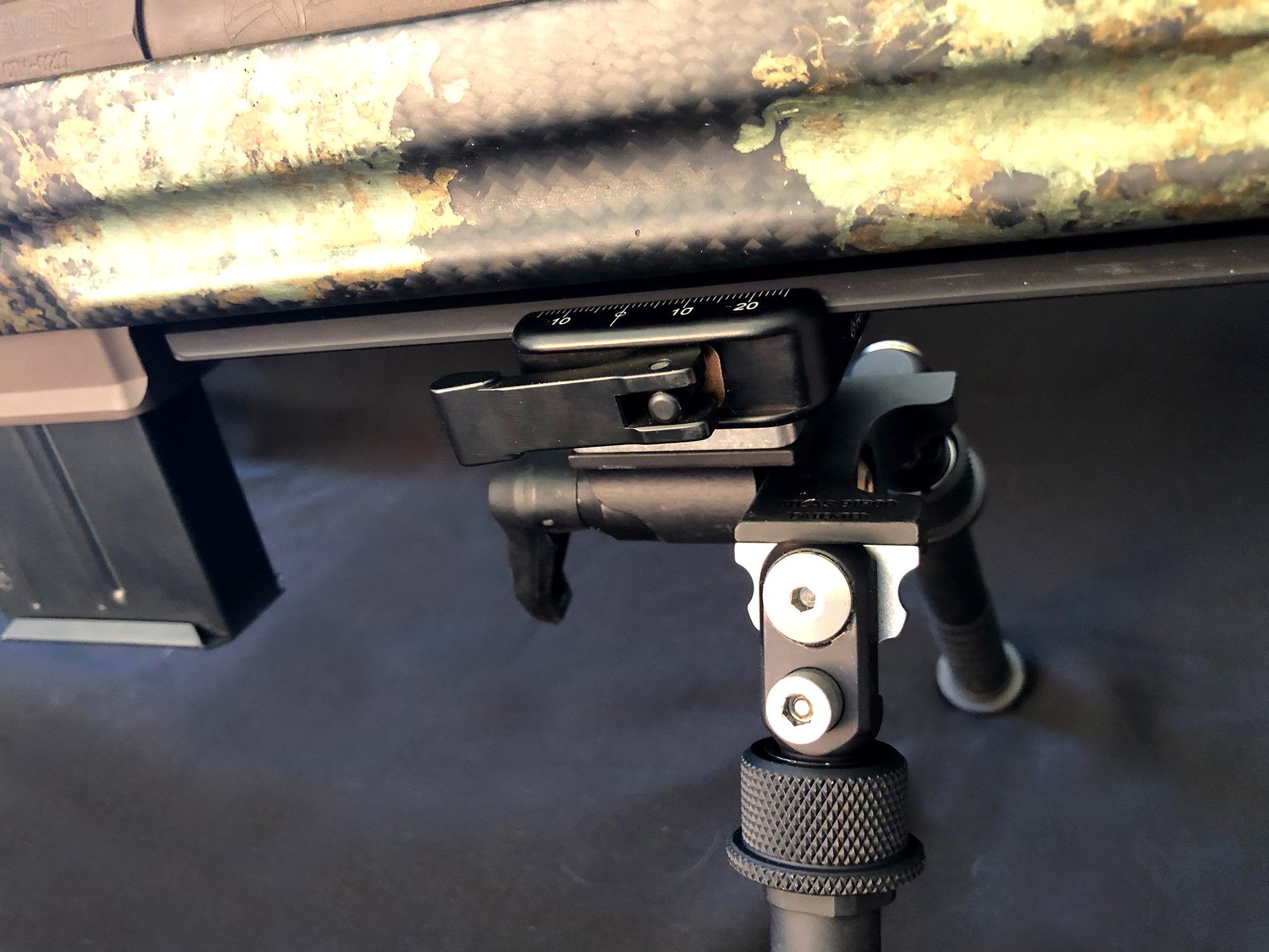

    Closeup of the Arca rail:
    As mentioned, this rail/clamp works very well - quite happy with the entire setup.

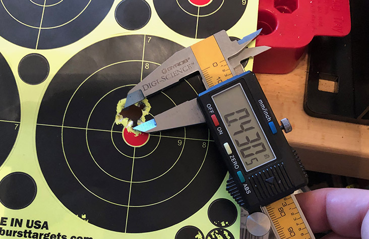

    10-shot group with pre-fire-formed 6mm BR brass:
    I'm doing a ladder on Saturday when I go out to a private range. I'm also going to pick an arbitrary load and do a wide seating depth test per Berger's guidance on the VLDs.

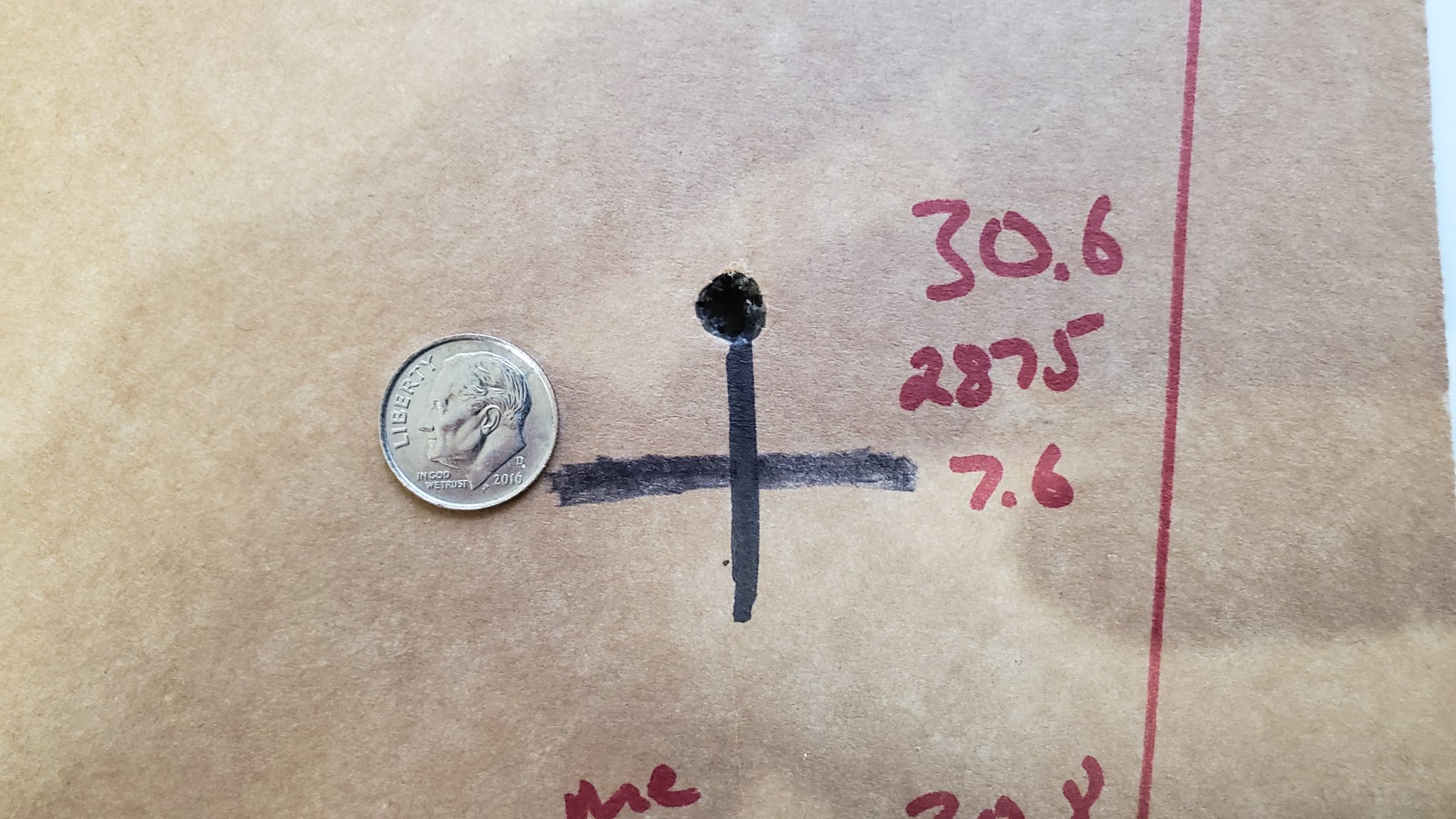

    More load development info from the range.
    On the plus side, my low ES/SDs continued with my 30.5gr load.
    I had separate 5-shot groups with the following:
    - Avg: 2962 fps (it was cooler today), ES 4, SD 1.8
    - Avg: 2965 fps, ES 5, SD 2.0
    - Avg: 2959 fps, ES 6, SD 2.6

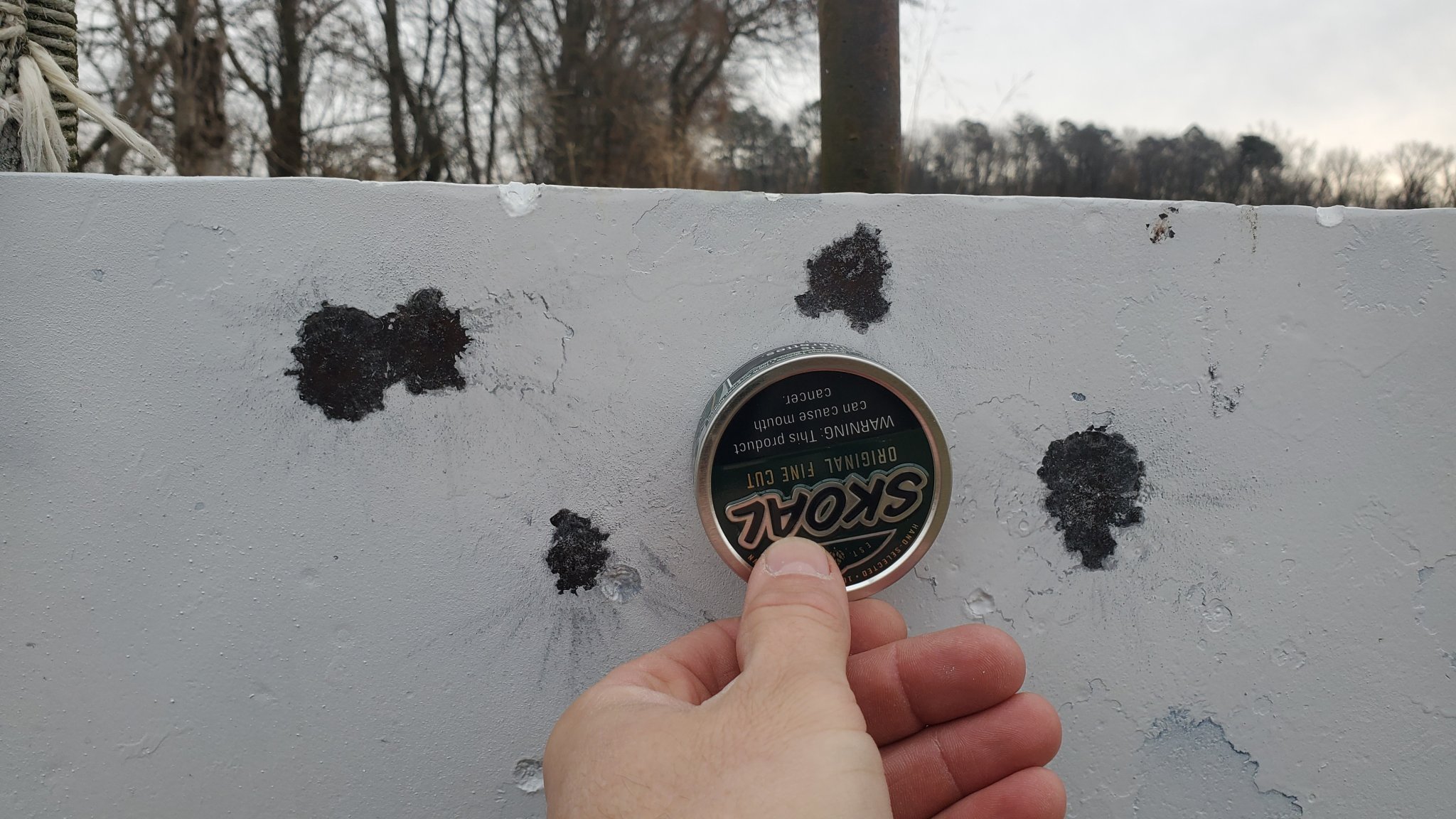

    So the low SDs are still holding true. Unfortunately, the groups were not. I had a number of 1.4" - 1.5" groups at 300 yards, but that's the best I could do at 30.5 gr.

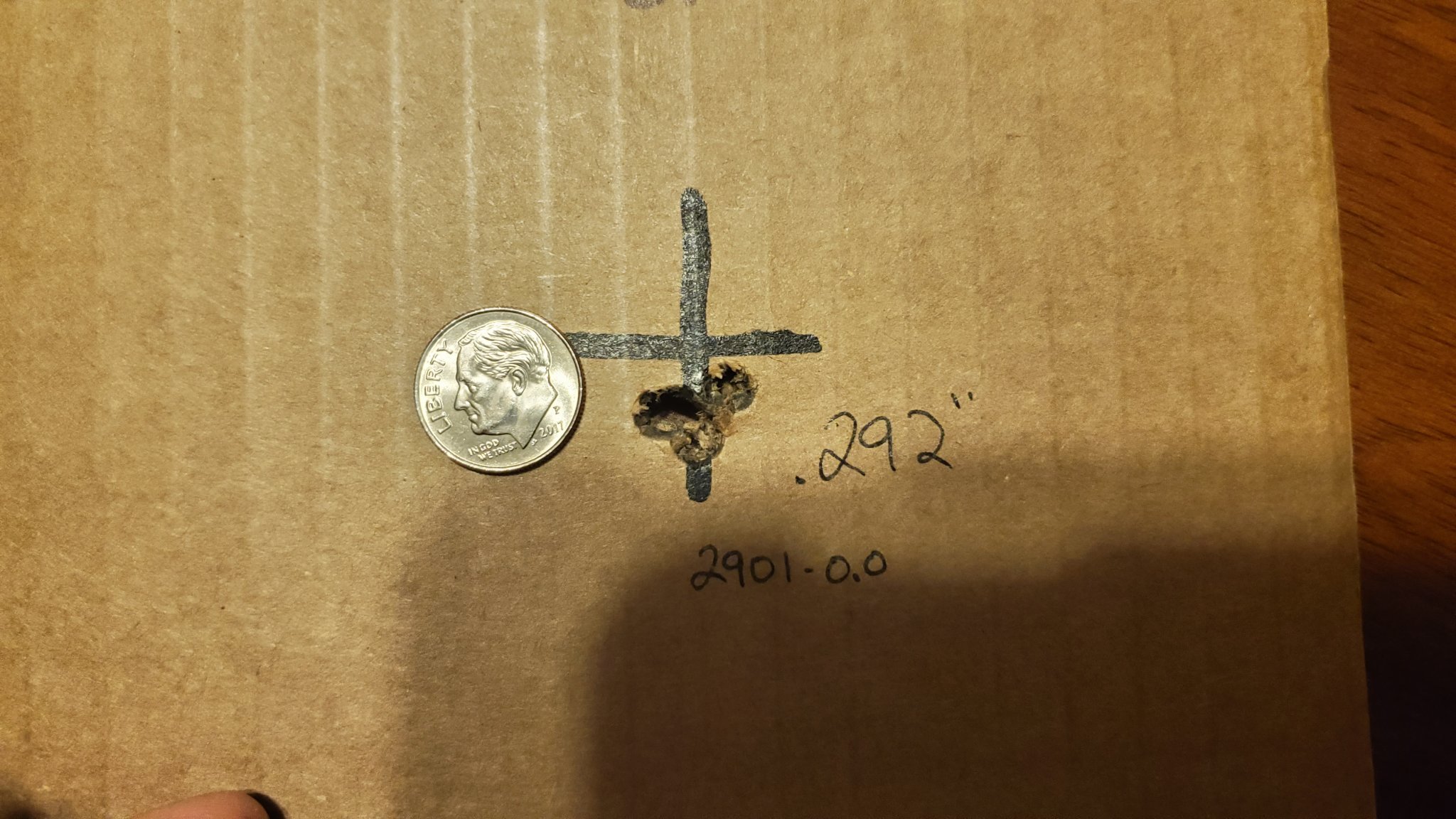

    However, I also ran groups at 29.6 gr to 30.0 gr at .1 gr increments. All but 29.6 kind of sucked. That low group, however did quite well.
    Average: 2849, ES 6, SD 2.6 and a group size of 1.0" at 300 yards - and there was a little wind. Vertical spread was just under .5".
    I didn't expect to like a load at this low of a powder charge. I'm going to now validate this load (and likely go a little lower to see what it does.)
