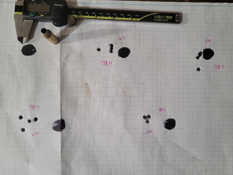

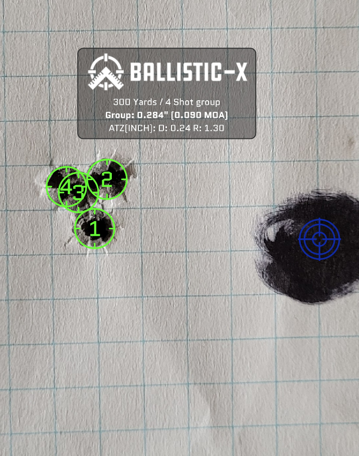

Don't rule out H4350! Im running 33.7gr behind 105hyb seayed 30k jump, i have 140 freebore so no powder crunch even with powder at base of neck. Heres a test I ran at 300y 4 shot groups. Velocity was 2910-2930 with 33.4-33.7gr. 33.7 shot the smallest group I've ever put on paper at 300y, 0.09 moa. Obviously all these charges would work as all under 1/3 moa grouping. I had best es at 33.4gr. I'm sure I could tighten it up with the barrel tuner.

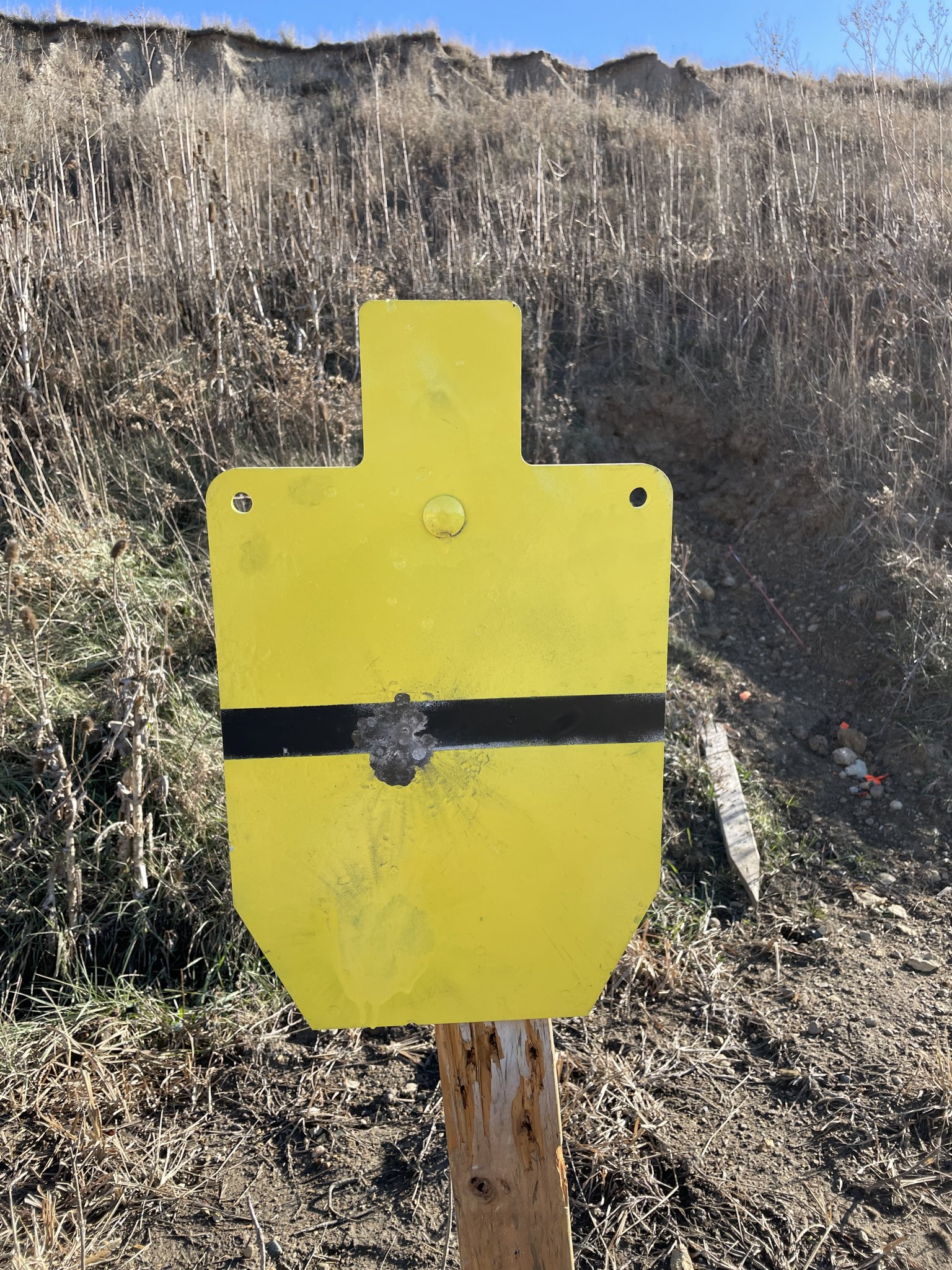

Haven't really had the chance to shoot much this year, I went and had kids and stuff. Finally managed to sneak in a range trip with my BRA to practice some positional shooting and managed to print this miracle group at 600 yards - according to Ballistic X it's around an 1 in. I switched over to Varget with the 107 SMK and Alpha Brass. Also tried 105s and 108 ELD-Ms, they all shot well but for some reason the 107s just keep printing extra tiny groups so I'll keep em. Rifle is shooting stupid accurate right now, I just need to get out and shoot :|
