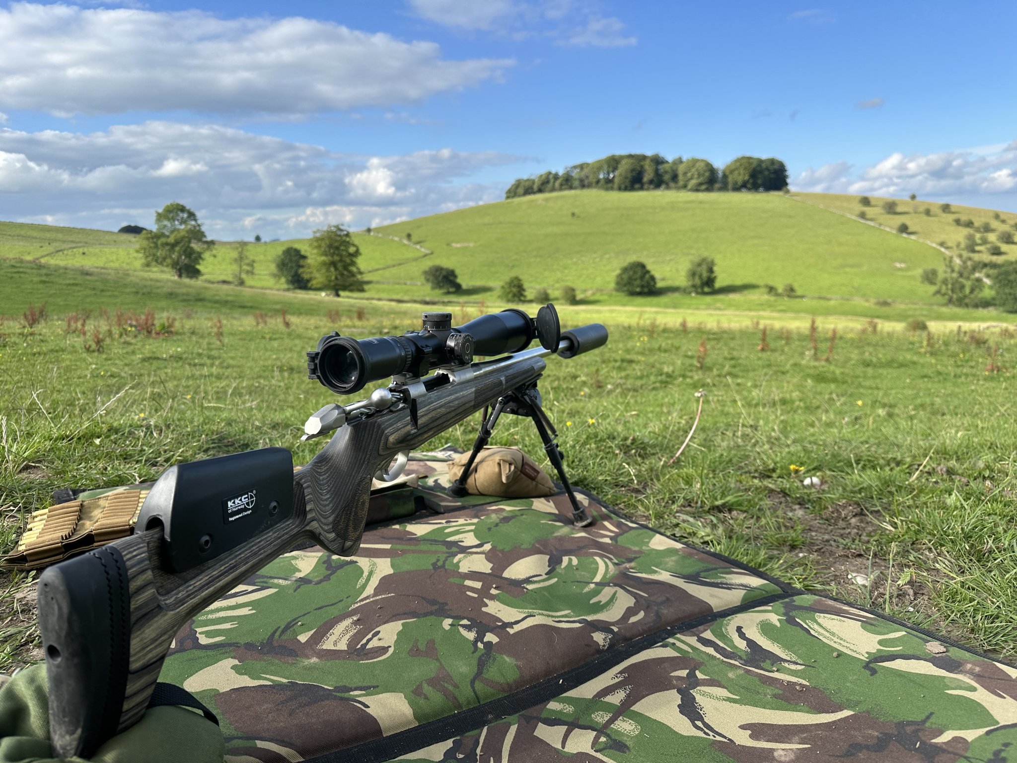

My rifle built on a sako 85 with a kKC laminate. I had planned to use a McMillan but they stopped inletting for sako just as I had it built.
