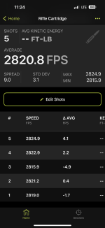

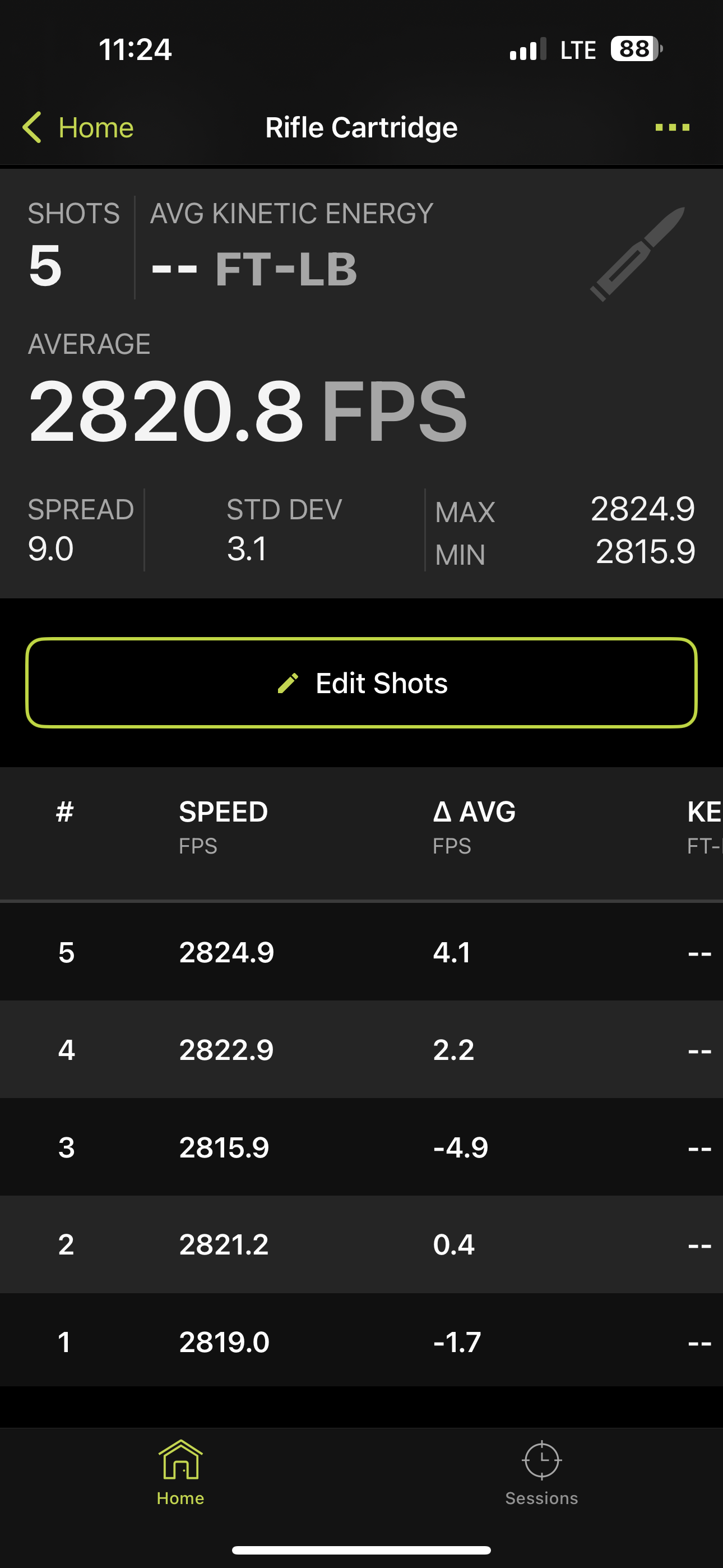

This is what I’ve got so far. 105 bergers. H4350. Virgin alpha brass. Fggm primers. I’ll have to get data book tomorrow for grains.

Mid to low 2800s and mid to low 2900s with 105-110gr bullets using H4350. I have several barrels that shoot 115 dtacs very well around 2810-2830 with a dtac jumping 50-60k. I run 170 freebore in all my 6gt barrels. I've ran 108 and 109 Bergers at 2920-2940 in a few barrels as well. Cci450 always.
Virgin Alpha brass is going to shoot very tight ES/SDs as long as your powder charges are consistent. Virgin Alpha brass really only needs a chamfer and maybe a debur before it gets loaded. I do go the extra step to mandrel to .002 under, but it really isn't necessary and just gives me a warm fuzzy before I prime, charge, and seat.
With those kind of extreme spreads, finding the "node" is anything but... especially with single shot samples. Sorry, it just is a waste of components. I know that the trend a few years ago by everybody who wanted to be anybody was to shoot single-shot velocity ladders and "find the flat spots", but truth is that you need to shoot quite a few rounds to get reliable data. It's like relying on the data after shooting a one-shot group. If you have an ES of 30, you're going to potentially cover several tenths of a grain (or more) in normal distribution... and fool yourself into thinking you found a flat spot or a spike.
First, I'd be double-checking that RCBS Chargemaster against a quality scale. Second, quite often the velocity spreads will tighten up as you increase charge weights and fill the case more (that is not gospel and can't be counted on). You shouldn't have a problem getting up around 34.0gr in the GT and the 105 Hybrid in Alpha brass though. I think that it is possible once you get to 33gr and up with Varget that your velocity spreads will tighten a bit, and you can fine tune your accuracy with seating depth.
