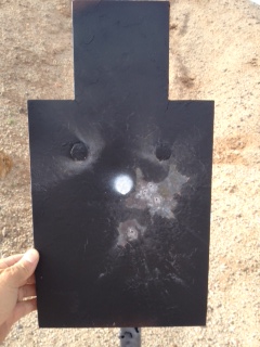

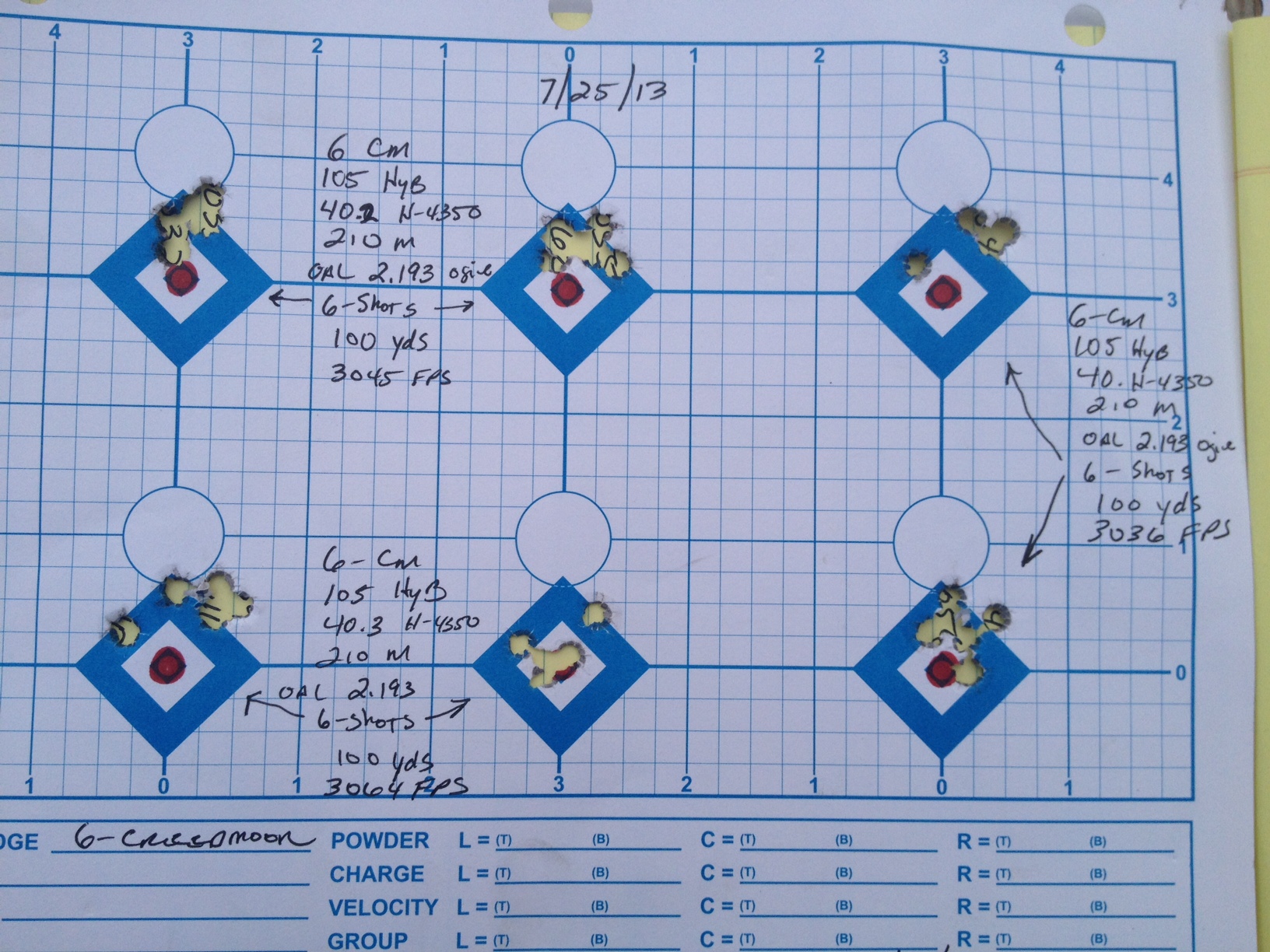

Love my 6 Creedmoor, accurate as can shoot! Would do better with a really good shooter. With 42 grains of H-4350 I was at 3168 fps with Berger 105 Hybrids in a 26'' barrel. Super accurate load. I backed down to 40.2 grains @ 3045 fps because my primer pockets were also getting loose after a few firings. Still shoots lights out!
That group wasn't shot by me.
But no, there isn't a rifle or cartridge capable of producing groups like this all the time. I bet there was a lot of work put into that load, the rifle obviously shoots as good as a rifle will and the stars aligned just right for that guy. Too be honest I've never shot a 5 shot group that tight at 100Y.
Bugholes... Thanks for putting in the work for this info. I'm extremely interested in putting a 6mm rifle together and this info was very useful.
