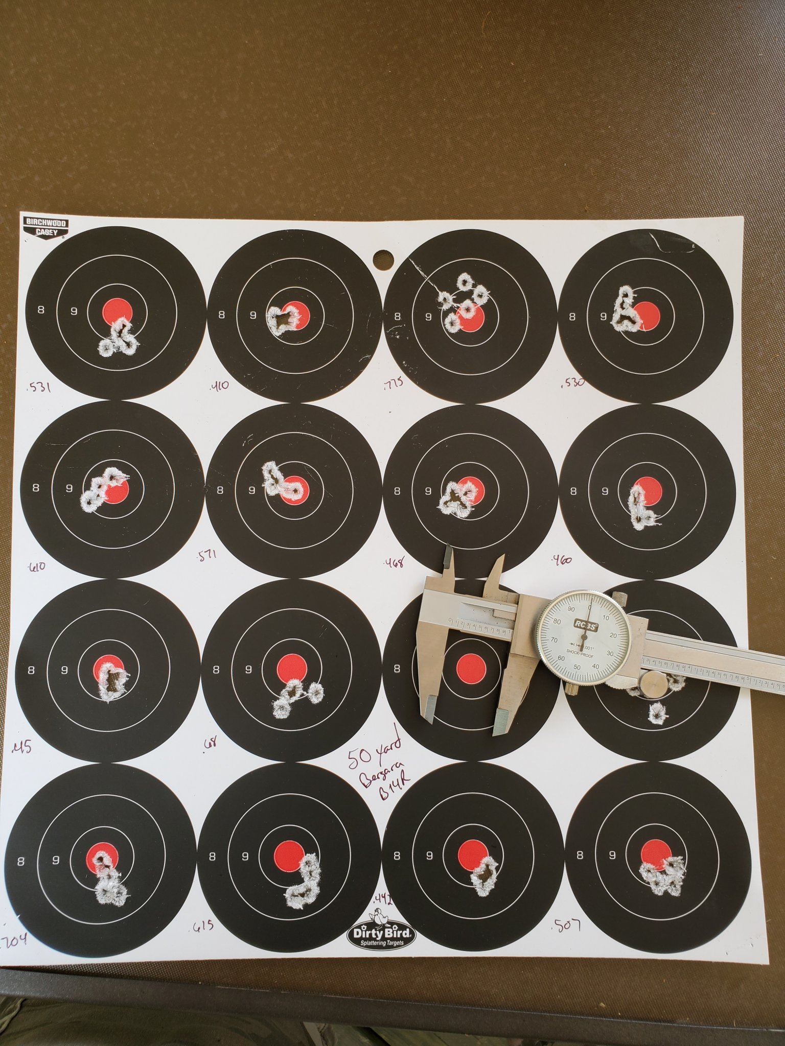

50 yards
Bergara b14r Steel barrel
Wolf Match Target

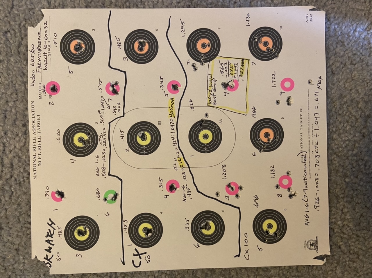

I'll present my intended entry as well as a target that does not meet the letter of the rules but I believe meets the spirit of the rules. I picked up a Vudoo V22 barreled action (18" MTU profile) in the early days of our quarantine which I completed with a Trigger Tech Diamond, MDT ACC folder and stole the Sightron SIII 10-50 from another rifle. The first range trip was windy but it showed some promise. Today was the second time I've shot the rifle to gather drop for an upcoming ORPS match (similar to NRL22) I though I'd try the 6x5 at 100yd with a lot of Center-X which performs well in my KIDD barreled SR-22 resulting in a 0.985" average and a best group of 0.791" which was a little disappointing compared to my expectations. This was shot prone off interlock pavers with a Ckye pod and an Armageddon Gear Squishy Rear Bag.
I still had a clean target on the stand and a brick of Center-X that didn't shoot well in my SR-22 or my Vostok CM-2. Not one to take a clean target off the backer nor particularly fond of taking unfired ammo home, I started pounding out 5 shot groups like I was on the clock. 8x 5 shot groups averaging 0.724" with a best of 0.578" which I'm quite pleased with. 8x5 is not 6x5 but I'm claiming within the spirit of the rules as every shot on the paper is counted in the average.

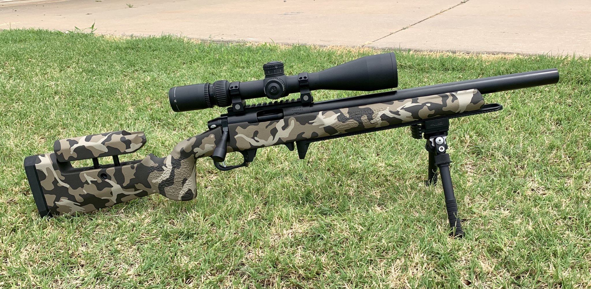

And I know it's not on the range but it's the only photo I have of the rifle. I think it needs an extended length thread protector to look right in the ACC chassis.
Temperature 14.5*C
Humidity 42%
Pressure 1015.8mbar
Wind 3mph switching
Jeff

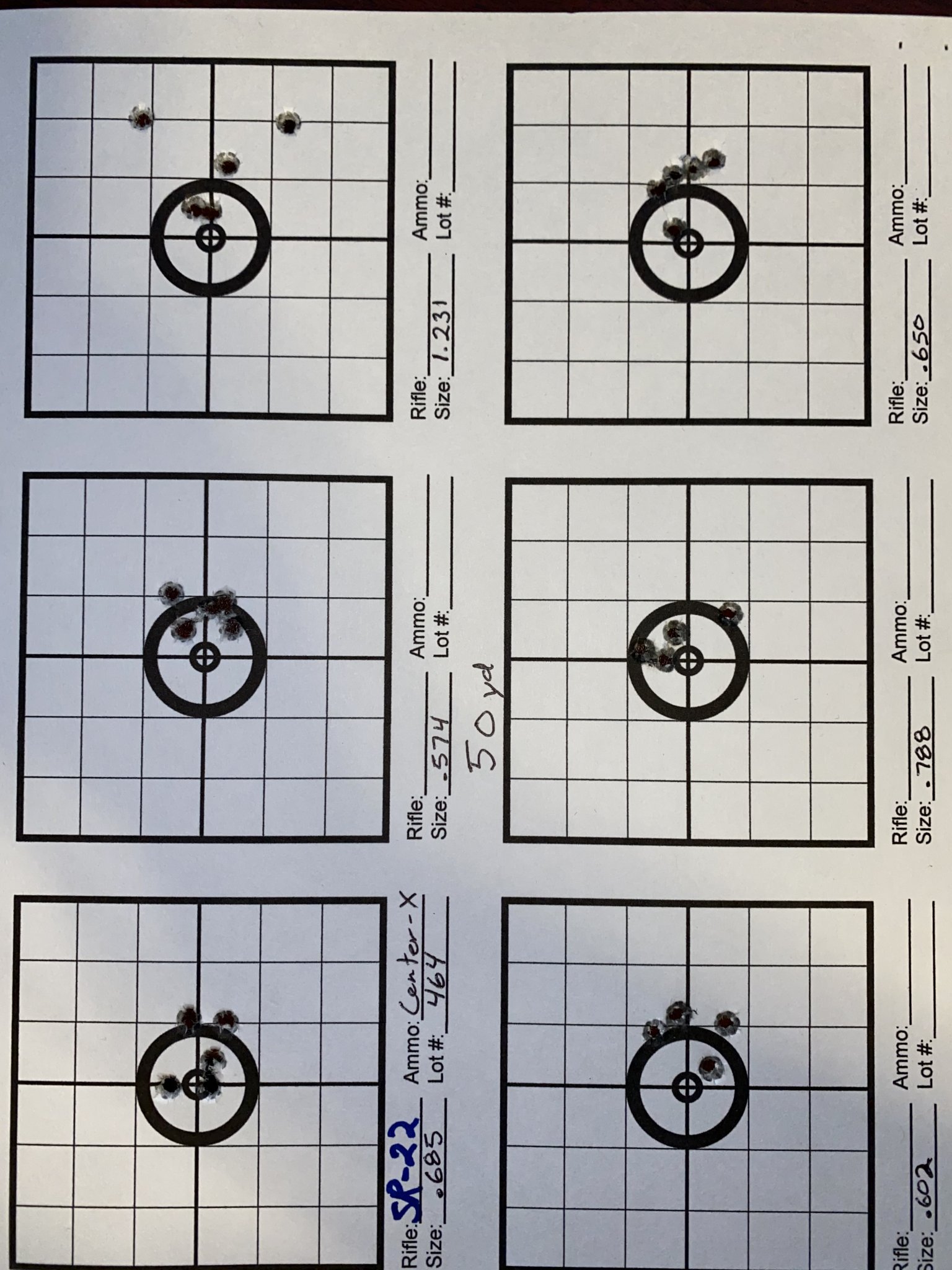

Temperature 14.5*C
Humidity 42%
Pressure 1015.8mbar
Wind 3mph switching
Jeff

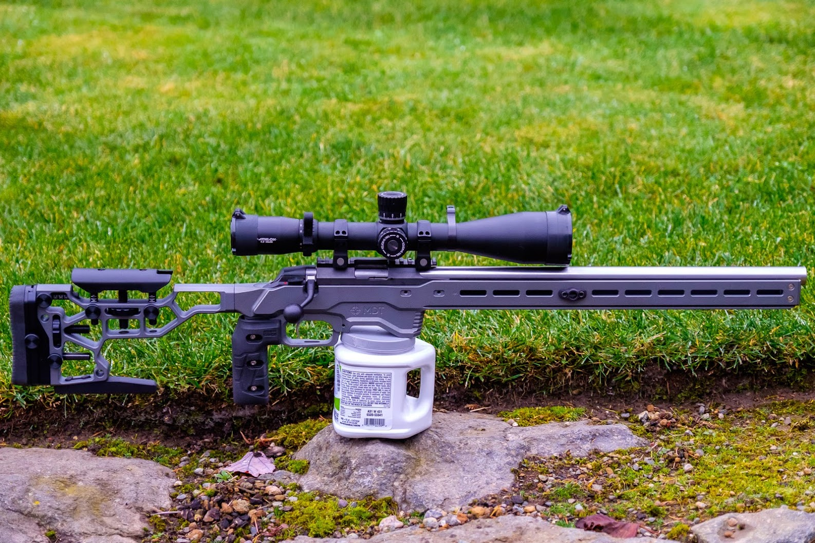

You can cut down the ACC pretty easily if you want it shorter to fit your 18" V22 :)
Reactions: DIBBS
That looks great littlepod, I'm just hesitant to cut my new chassis. My intention is to spin up a custom 6" long thread protector or muzzle brake on the lathe when I have some spare time. I prefer the feel of a longer rifle (it moves slower / smoother in less steady positions) and I can always remove it if I need the extra maneuverability. POI shift should be minimal with the MTU contour and quite repeatable.
Reactions: littlepod

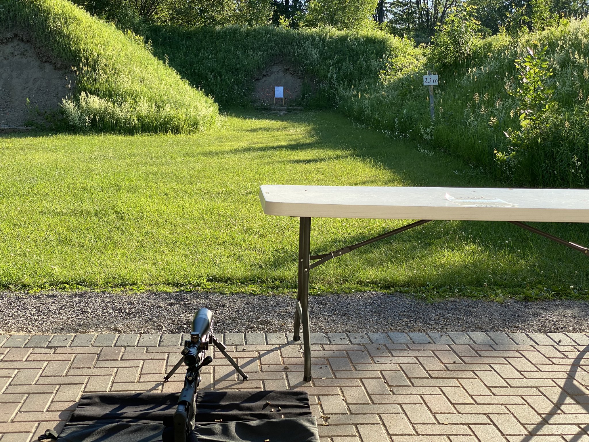

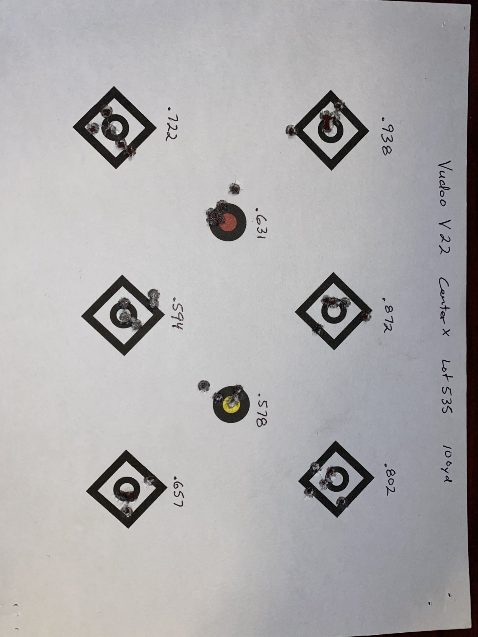

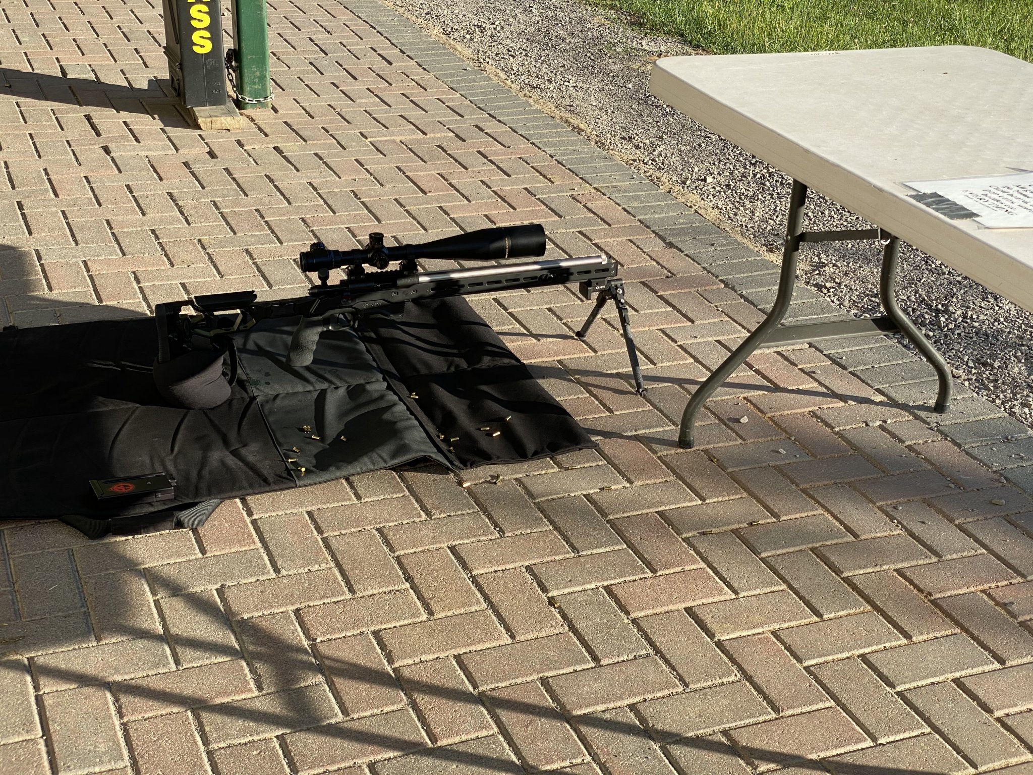

I have a go at 50 yards this evening. 30*C, very little wind and I shot from the shadow on the range table to keep the sun out of my face. I have a 50 yard entry for the SR-22 in the first series of this challenge and though I would try to better it. The first 2 shots killed that idea. The rifle would not shoot this evening. I think the issue is heavy carbon buildup on the crown. I have mostly been shooting barricades at 20 yards (indoors) and hadn't noticed the accuracy fall off but the barrel shroud / weight I made is blowing all the crap back onto the barrel.
And the resulting disappointment down range (0.755" at 50 yards), with my best group worse than my previous average.

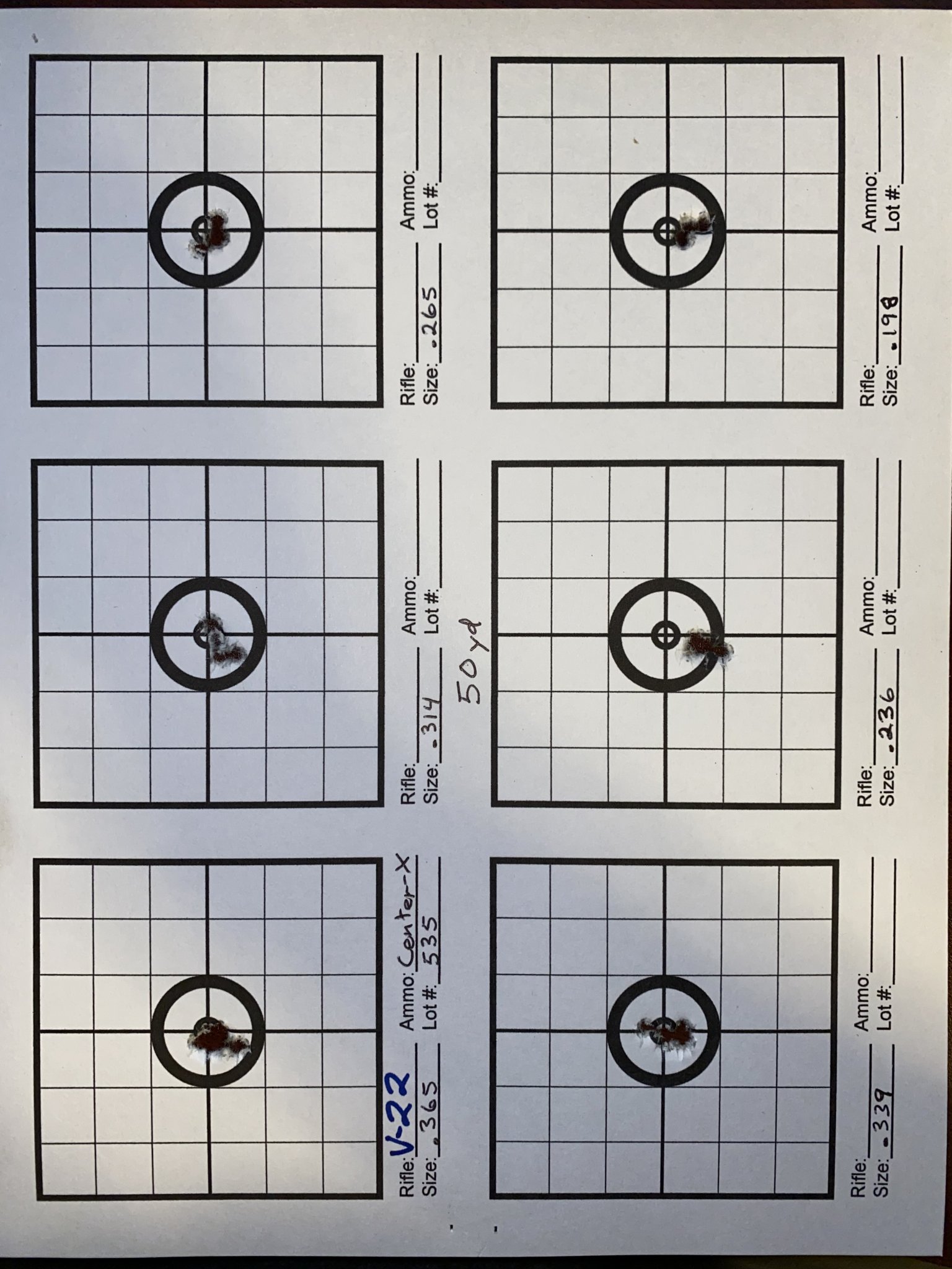

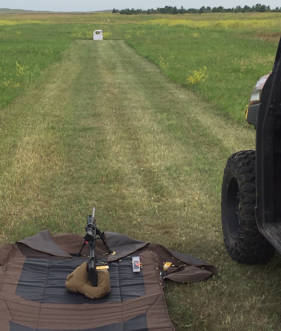

So on to the more interesting target with the Vudoo, this time with range photos.
My worst individual shot was the first shot of the fourth group. I aimed off center for the remaining 4 shots to recover the group and 0.286" average.
BTW, a big (y) to jbell for maintaining this challenge 🍻.
Jeff

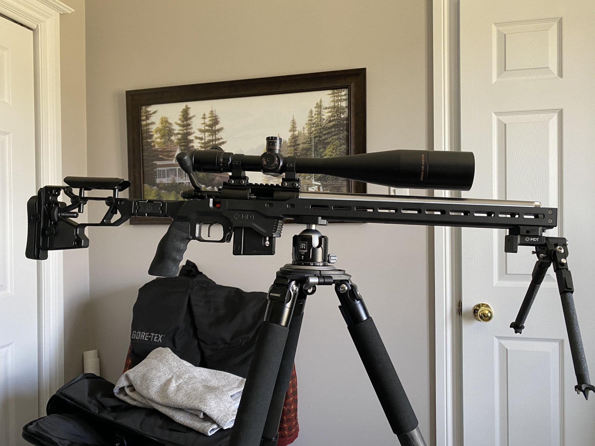

Your very welcome! I have your Vudoo and SR-22 on the 50 yard results. Is that a NXS you have on the SR-22? If so does it completely correct parallax at 50 yards? The few I had many years ago would not, I really like those scopes.
No, the SR-22 wears a 7-35 ATACR. No problem correcting for parallax at 20 yards at the indoor pistol range. I will eventually move it to the Vudoo as the Sightron 10-50 is not great for ORPS / CRPS matches (Canadian series similar to NRL22 and NRL22X). I have no complaints about the Sightron, it’s clear, tracks well and is great for shooting groups but SFP, coarsely graduated reticle and limited travel are limiting on many stages.
Jeff

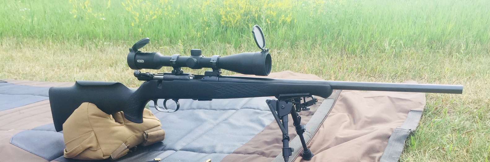

I am posting a tgt for a new (old) rifle that I have named "the Ugly Girl". She will eat anything you feed her and still put out like a crack-ho. She ain't much to look at but she is still a keeper. It is a Winchester Model 52B cira 1950 topped with an older Fecker 10x scope that is an amazing old optic. This target was literally the first 30rds that I put on paper with her after zeroing the scope on a dirt clod. The first shot on paper wiped out the "x" at the center of the bull.
50y with 2 piece rest/sandbag
Ammo was a blend of SK Rifle match and Lapua CX (I was testing random lots but she just kept pounding them into the 10-ring)
Best = 0.170", 0.325 MOA
Ave = 0.233", 0.445 MOA

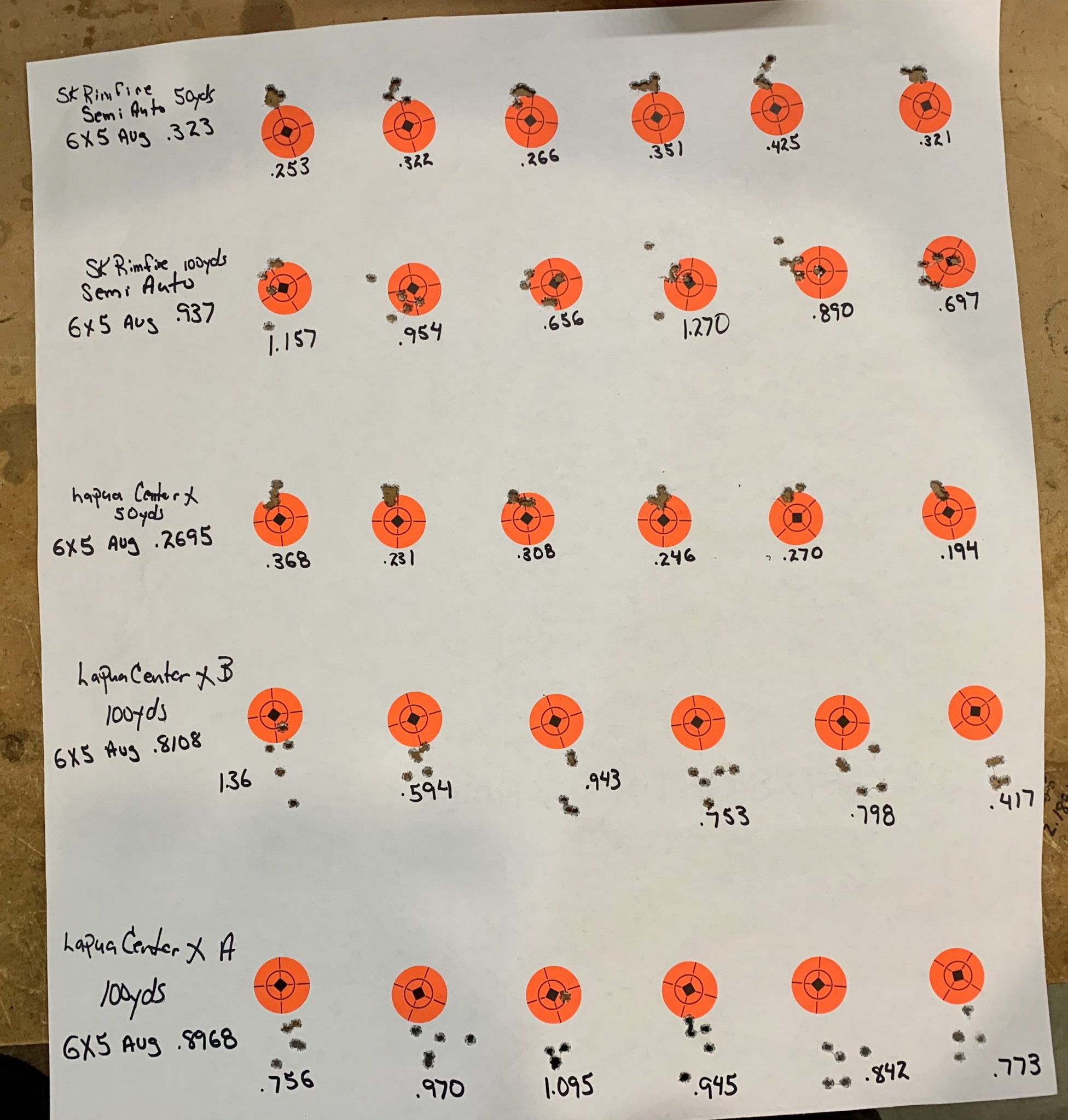

RimX
Green Mountain barrel M24 @ 18”
Bix and Andy TacSport single stage
Manners T2A
Vortex Razor AMG
Bipod and rear bag.
Center X
6x5 50yds .2695
6x5 100yds .8108
Still getting used to the RimX and getting back to just shooting after not pulling the trigger for close to 2 months.
Was really surprised at the performance of the SK Semi Auto.

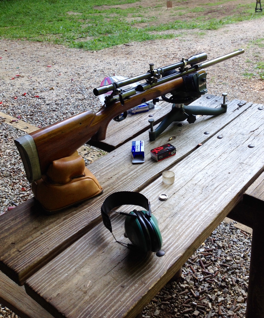

I did a 6x5 on the Remington 37 using irons today to get the sights figured out for silhouettes. I have a Redfield Olympic rear but couldn't get it low enough for 50 yards, I'm bottomed out. Luckily I had my Centra rear sight with me so I threw it on until I can come up with a taller front sight dovetail block.
Avg: .452"/.863 MOA
Best: .180"/.344 MOA
Centra rear sight/Redfield International front
Wolf Match Target
50 yards

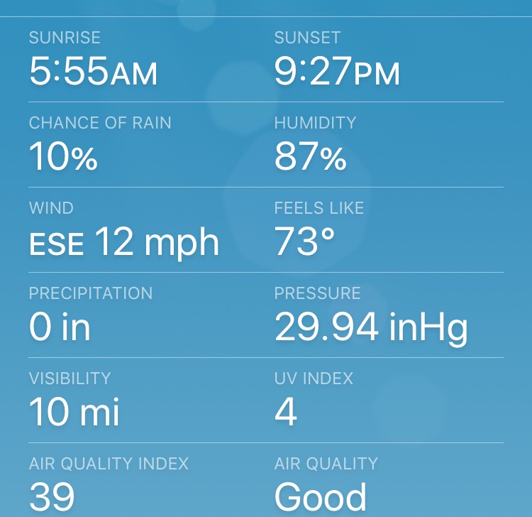

I'm posting this for comment more than a official entry. :) This was shot at 200 yards with my Vudoo, NF 7-35 from a bench, bipod and rear bag, SK Biathlon ammo. The top left target was the first shot. The dark black circles were easy to see. I'm pretty sure I could determine which bullets belonged in which group. Best group 1.95", average 2.80".
Then I shot the top target with the SH 6x5 target using the diamond as my aiming point. My cross hair covered the diamond and it was hard to see. I changed my scope setting trying to get the group inside the circle. I'm not sure which bullets go with which target.
Last I shot the SH 6x5 target using the circle as my aiming point. It was a little easier to see. I kept changing my scope setting trying to get the bullets in the circle. I can't even guess which bullets go where.
I learned a lesson. For me at least I need to use the whole 8.5 by 11" paper to collect all my shots. Plus I should quit messing with my scope in the middle of a string. :ROFLMAO:
Wind was about 2-3 MPH and didn't mess with me a lot.
I'm still learning. :)

A real good start. At 200 yards, being on paper is half the challenge. I shoot 200 yards as well, and I use 6-6 inch splatter targets, black rings with a red dot center. Very easy to see, and make windage adjustments. Plus, you don't have to worry so much about which rounds went with which bull. With practice, you can switch to a two-bull 8.5 by 11 as the next step, when you consistently hit the 6 inch splatter target with all 5 shots. Just a suggestion. Good luck!
