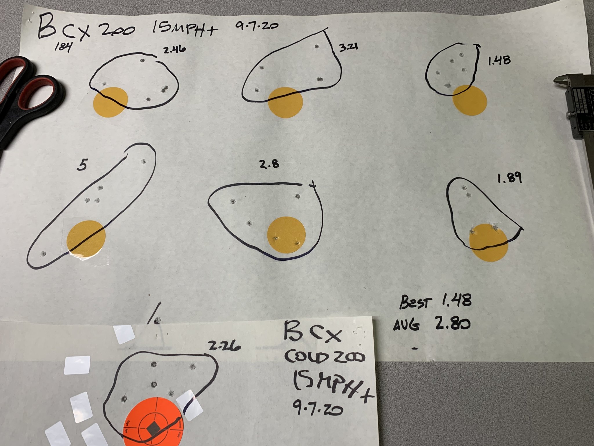

We have shot at 200 yards in winds up to 20mph+ Just so we could see what the .22 could do. Honestly we were both really impressed at how well it actually shot. We didn’t time our shots between gusts or anything just kept shooting. We had wind flags out but they were blowing in all different directions so we said heck with the flags in the future. Just shoot and adjust. We have been out at 300 yards 1 time and it was shifting winds at 10-15mph. We were laughing on the way to the range that day joking about how bad it was going to be. Again we were very impressed with how well the .22 handled the wind. Best group at 300 that day was 5.5 inches
It’s cold here now so no real tolerance for winds and cold
we will wait for nicer weather ( above 50 deg ) to shoot the .22’s or instead shoot other guns while we wait for it to warm up a bit. As I get older my tolerance for shivering at the range is getting shorter and shorter.
Here is a target with winds at 15+. If it’s windy out we just know we won’t be setting any records that day but we will still have fun.

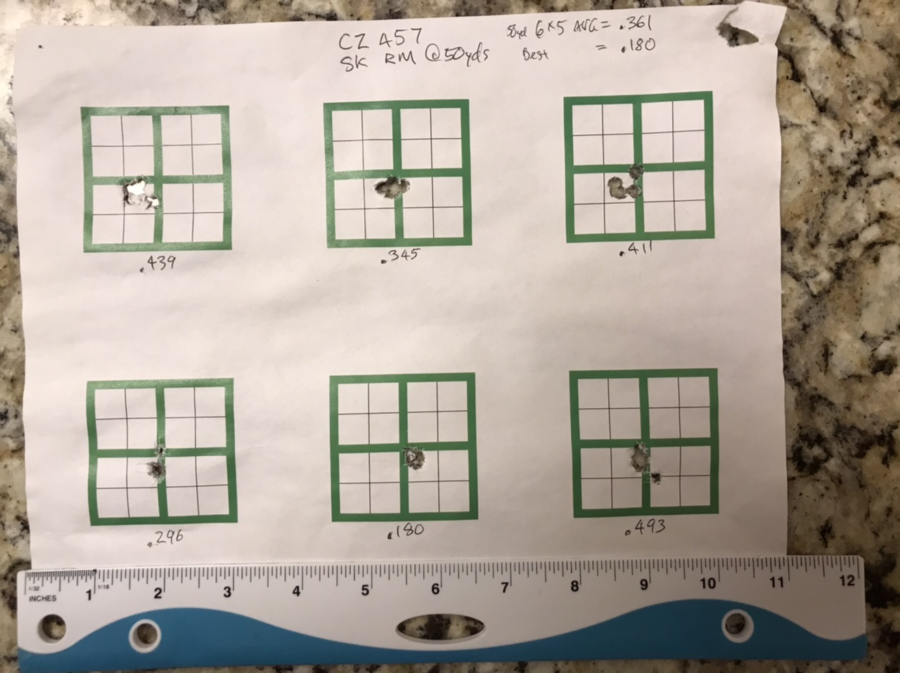

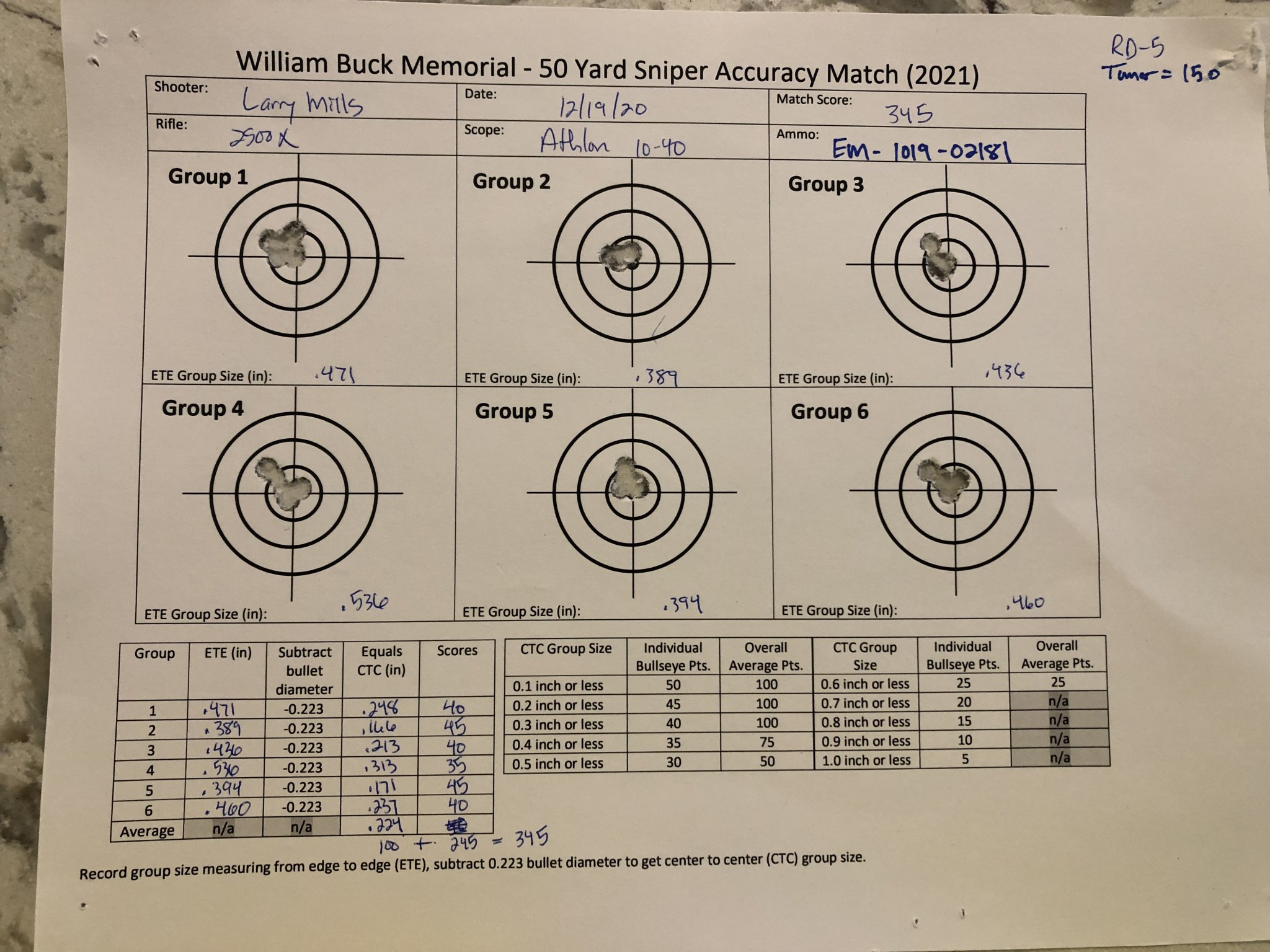

jbell, Rimfireshooter99 here, received a new rifle a few weeks back, been working on the tuner and testing some ammo lots, learning how to shoot it. I have a new 6x5 for submission from a postal match target I participate in.
Rifle is a 2500x, Shilen barrel, B&A trigger, McMillan stock, Athlon 10x40 scope.
Target: Average of 6 groups = 0.2246 (0.225), measured by ETE (outer edge of the black ring surrounding the widest shots in the group), then subtracting 0.223 to get the CTC results. Smallest group size CTC is 0.166.
Let me know if I am measuring correctly for the 6x5?
Also, I sold my other rifle I was shooting in the 6x5 so you can remove my prior scores, as appropriate.
Thanks!

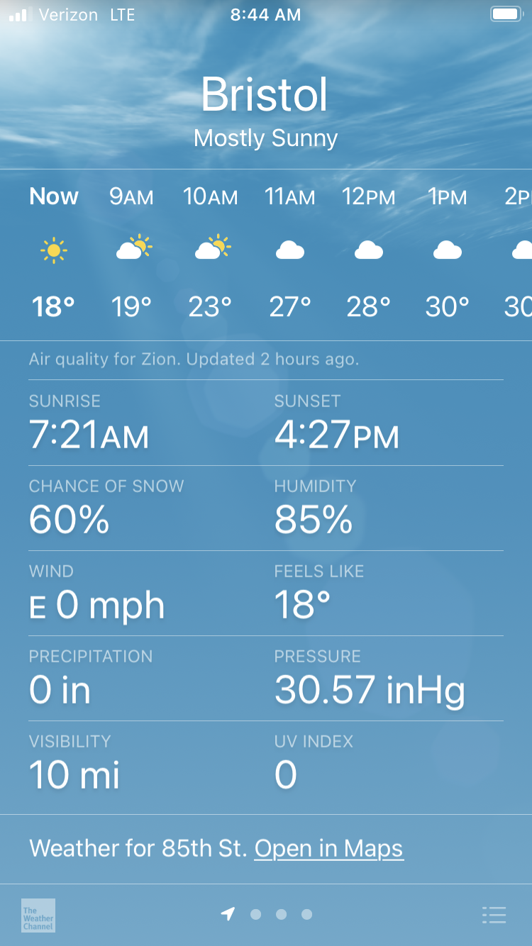

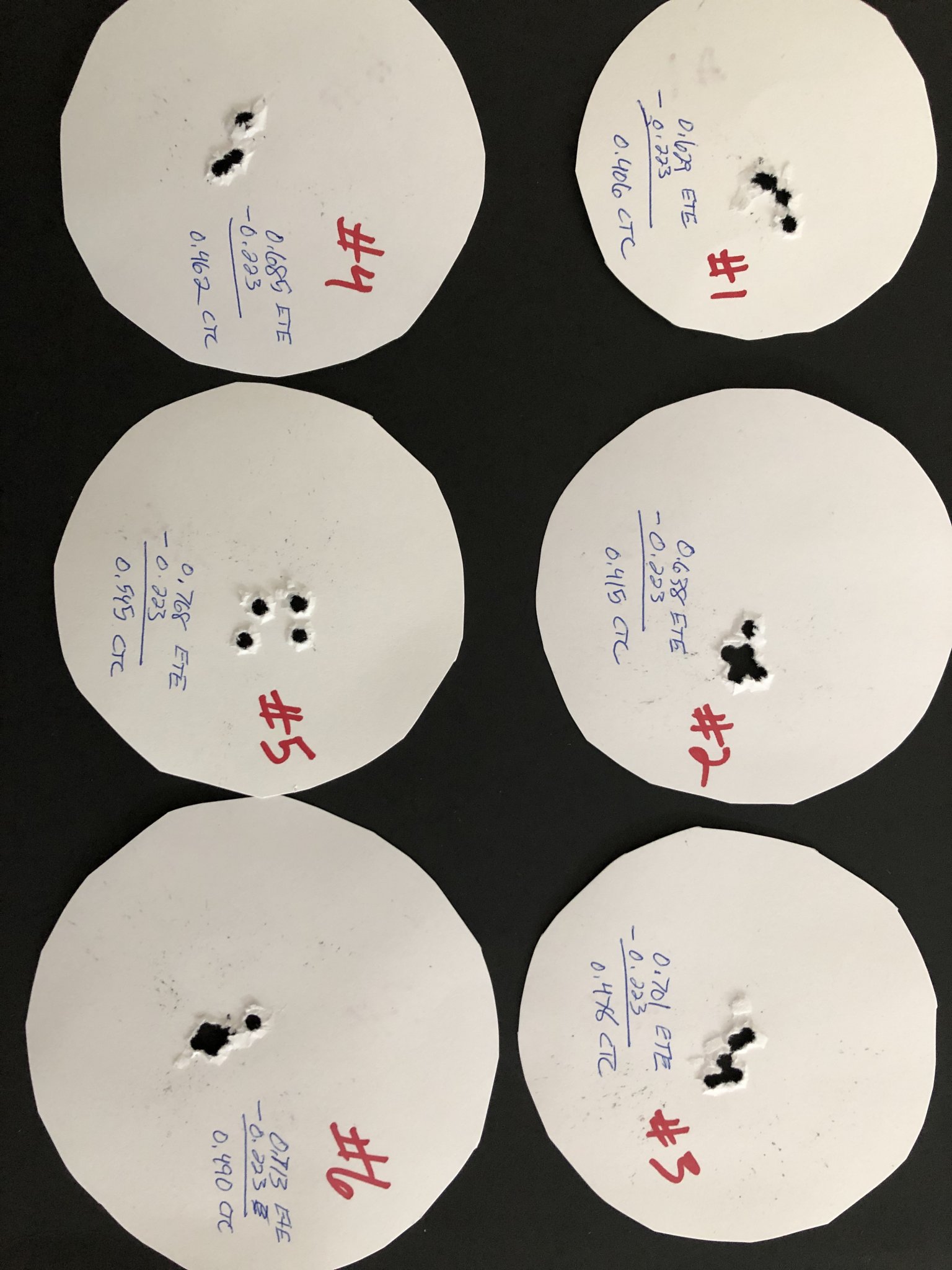

jbell, I am just back from the range again. This morning, in advance of a snow storm in our area, there were no winds, and I mean not a farts worth. Those days come few and far between. I shot the 6x5 100 yard, targets attached.
Same rifle, Caldwell BR front rest, rear Protektor bag.
Overall average was 0.466, best was 0.406.
#1 - 0.406
#2 - 0.415
#3 - 0.478
#4 - 0.462
#5 - 0.545
#6 - 0.490
Total was 2.796/6= 0.466.
Temp was 18F 15 minutes before the start of shooting (weather app screen shot included below). I did not do a cold bore shot, and the targets were shot after "warmup".
Dimensions were measured the same as my 50 yard targets, caliper to measure the ETE (brown ring around the farthest two holes in the group), subtract 0.223, equals CTC values, recorded above. Math was included on the back of each target (picture below).
One additional note, I shot Eley Match for both this 6x5 and the 50 yard 6x5.
Any questions, please let me know.
Thanks!
RFS99

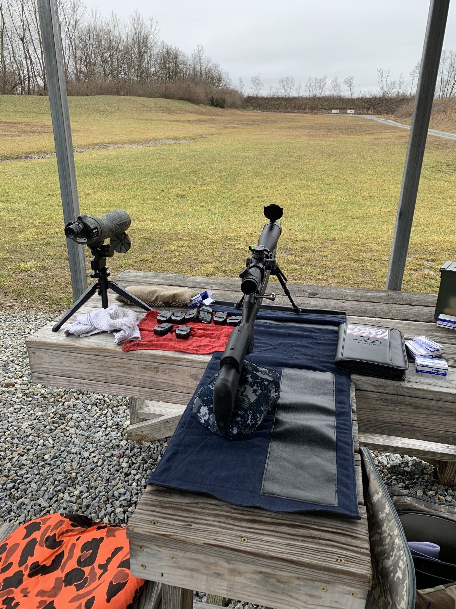

Been wanting to see what cold temps would do to the groupings at 200. I’ve been trying to figure out if I can get away with 1 type of ammo for 4 season shooting. Folks seem to say the Polar is the way to go for under 50 deg. I had to find out for myself.
Today was cold ( for me anyway ) at 36 deg
winds were 2-3
the benches were free of ice.
Tikka T1x
Sightron s3 6-24
Shot off bipod and rear bag
these are 3 runs at the 6x5
it does look like the temps open the groups up just a bit over what I’m used to seeing at 70 deg. I’m happy to see that it really isn’t that bad.
I did have to dial in 31MOA
I’m usually at 23-24 MOA at 200 when the temps are above 70.
Im shooting Lapua centerX lot 2355184. I purchase this blind so I have no idea yet if I can improve on these results. I’ll be lot testing next month and after today’s results will most likely focus on centerX and Midas and not worry about the Polar
best group today was 1.848
best avg today was 2.738
this is for sure off my best but not as bad as I was expecting in the cold. Also my first time shooting with gloves on.

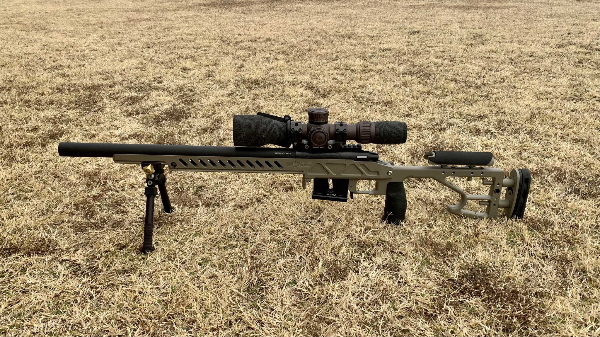

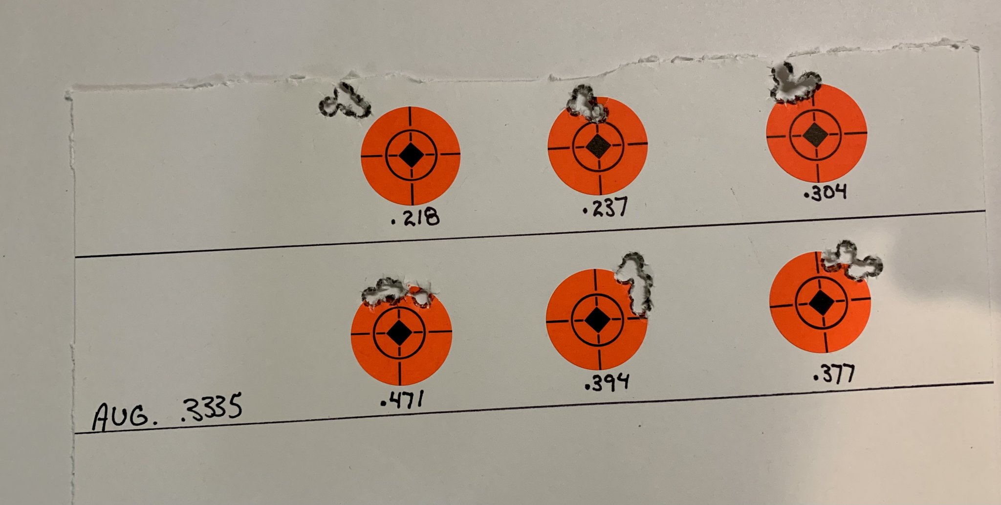

Here’s my first entry of the year. Nothing earth shattering but I’m definitely out of practice being this is only the second time to shoot in almost 2 months. Shot this after chronographing several different brands and lots.
only 400rds down the barrel so far.
RimX
Green Mountain 1.2 straight at 21.5”
Bix and Andy TacSport Pro
PDC chassis
Razor Gen II 4.5-27
Cal Gen 2 and rear bag.
Center X
Avg. 1074fps
ES 21
SD 6.2
40 degrees
DA 531
Humidity 28.9
Wind 2-5 from 11:00
50 yards bipod and rear bag
6x5 avg. .3335
