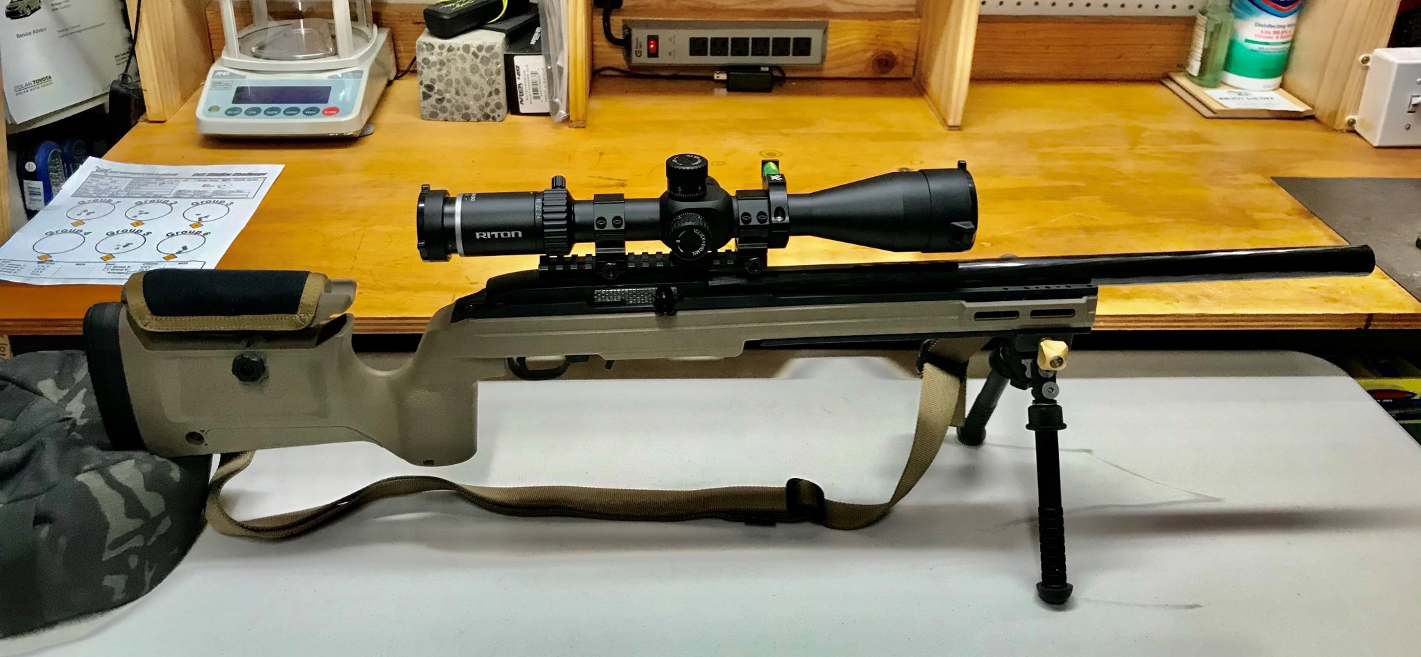

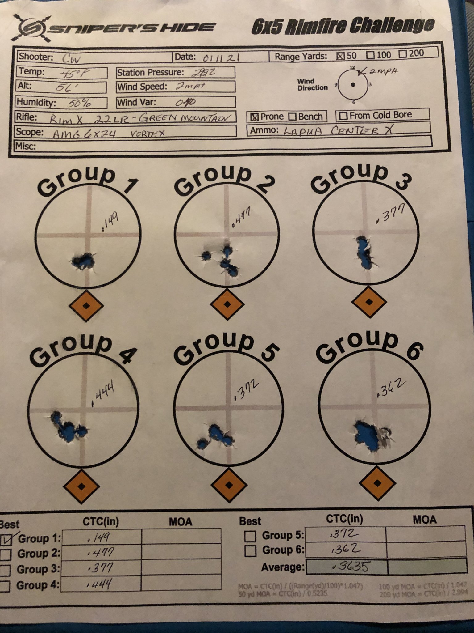

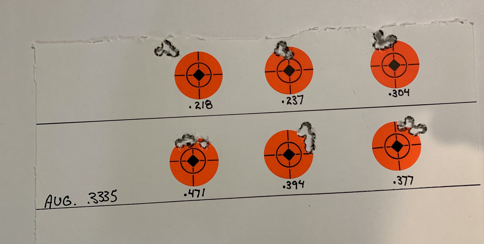

Here’s my first entry of the year. Nothing earth shattering but I’m definitely out of practice being this is only the second time to shoot in almost 2 months. Shot this after chronographing several different brands and lots.
only 400rds down the barrel so far.
RimX
Green Mountain 1.2 straight at 21.5”
Bix and Andy TacSport Pro
PDC chassis
Razor Gen II 4.5-27
Cal Gen 2 and rear bag.
Center X
Avg. 1074fps
ES 21
SD 6.2
40 degrees
DA 531
Humidity 28.9
Wind 2-5 from 11:00
50 yards bipod and rear bag
6x5 avg. .3335
View attachment 7518910View attachment 7518911
Excellent shooting. Good to know that Green Mountain's reputation from the 10/22 world also translates to RimX platforms.
I may have to give it some serious consideration in the future.
Cheers,
Travelor, nice shooting. But I have a question, I averaged your groups and came up with 0.264”. I took your raw group size and rounded to the nearest thousandth of and inch: 0.219” + 0.243” + 0.312” + 0.200” + 0.353” + 0.258 = 1.585” / 6 = 0.264”
I just wanted to verify before I put it on the results. **I always round to the nearest thousandth of and inch to keep it a bit more simple and b/c it is VERY difficult to measure a group to the ten thousandth.

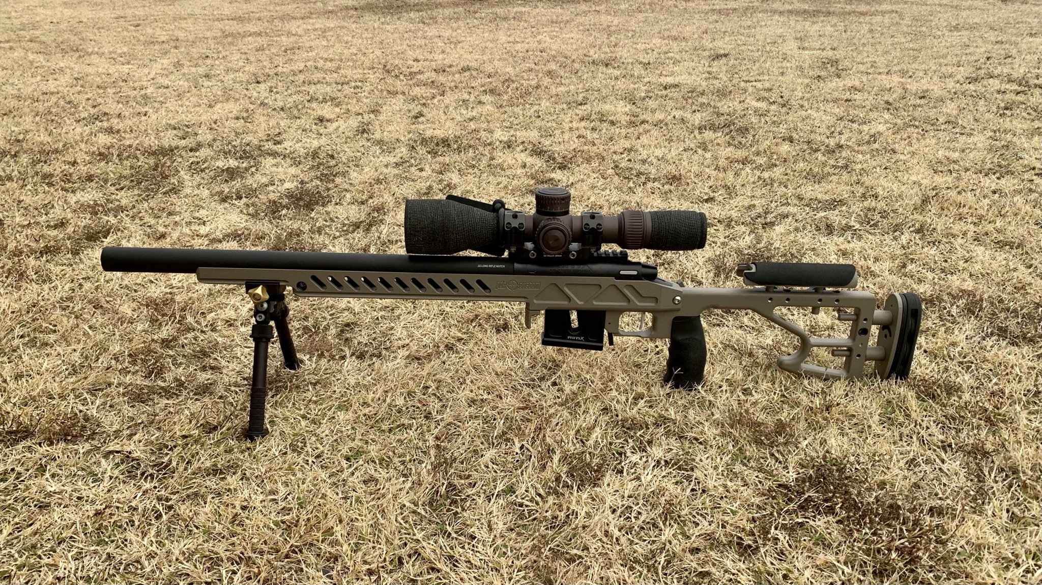

Happy New Year everyone! Had some decent conditions and a little time, so i got to do a bit of shooting today. Bad news is my better lots of CX are gone...Big step down in accuracy with the remaining lots, which are the top 2 rows
best 50yd 6x5 .247” .471 moa
best 50yd group .144” .275moa
100yd 6x5 .748” .715moa
best 100yd group .351” .335 moa
as always, please check my math!
Vudoo/March shot prone w bag and bipod, light winds got tricky at times. CX and Midas

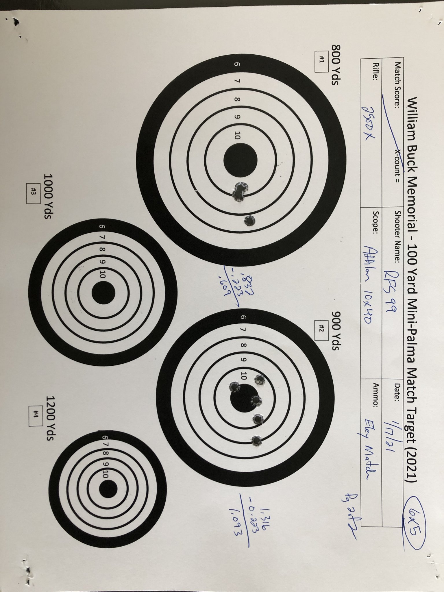

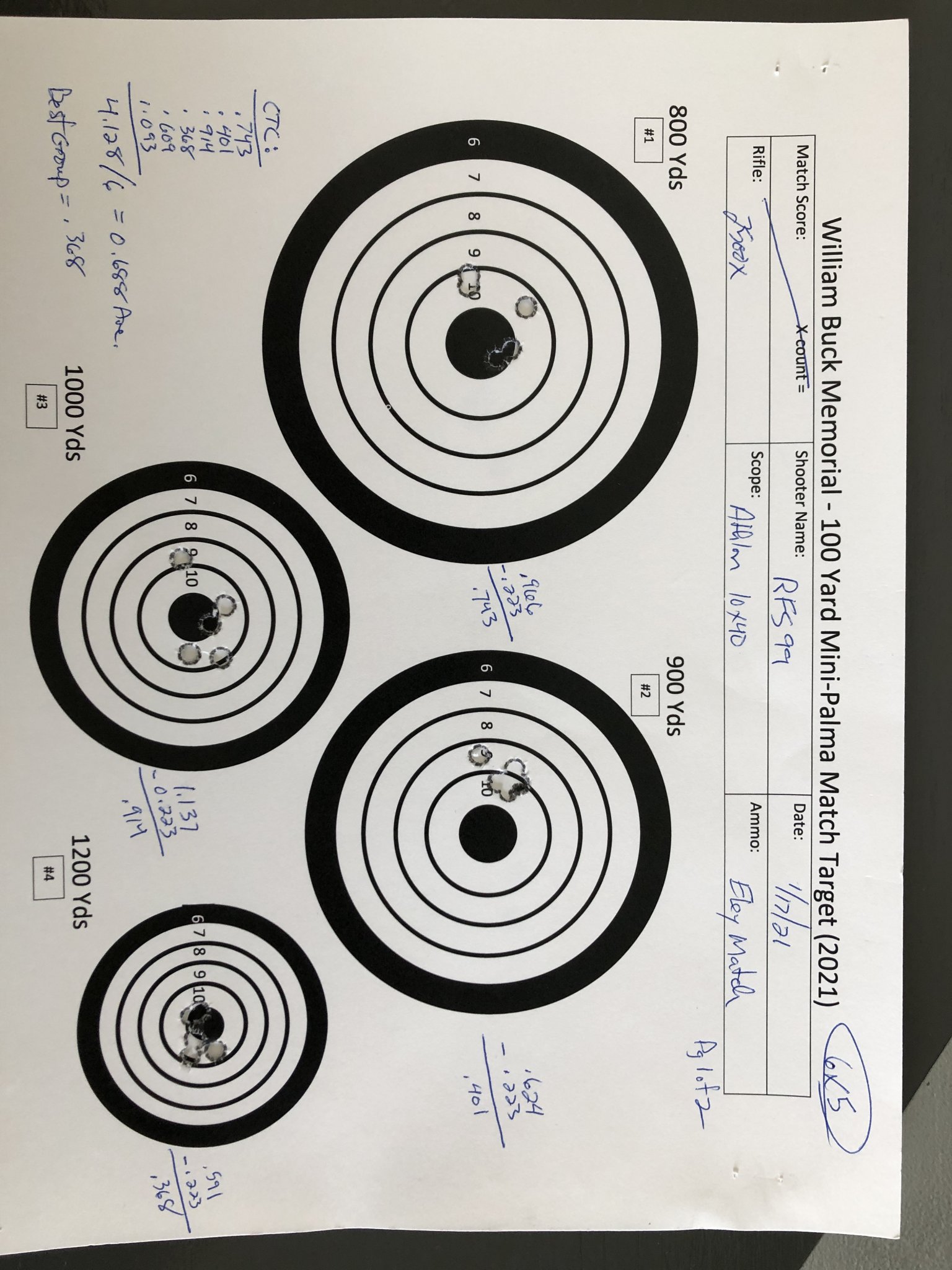

jbell, 100 yard 6x5 attached for your review. Temp was 32F, Wind was NW 3-5mph, Humidity 76%. Rifle - 2500x Custom KSS, Scope - Athlon 10x40, Ammo - Eley Match. Wind was a little twitchy this morning, switching directions. 3 of 6 bulls suffered from wind inflluence, spreading the group out a bit. I will shoot better when I get a steadier wind (or learn to read it better). Flags were not showing a cross-wind, but the target did...
Overall Average = 0.688, Best Group = 0.368.
Thanks!

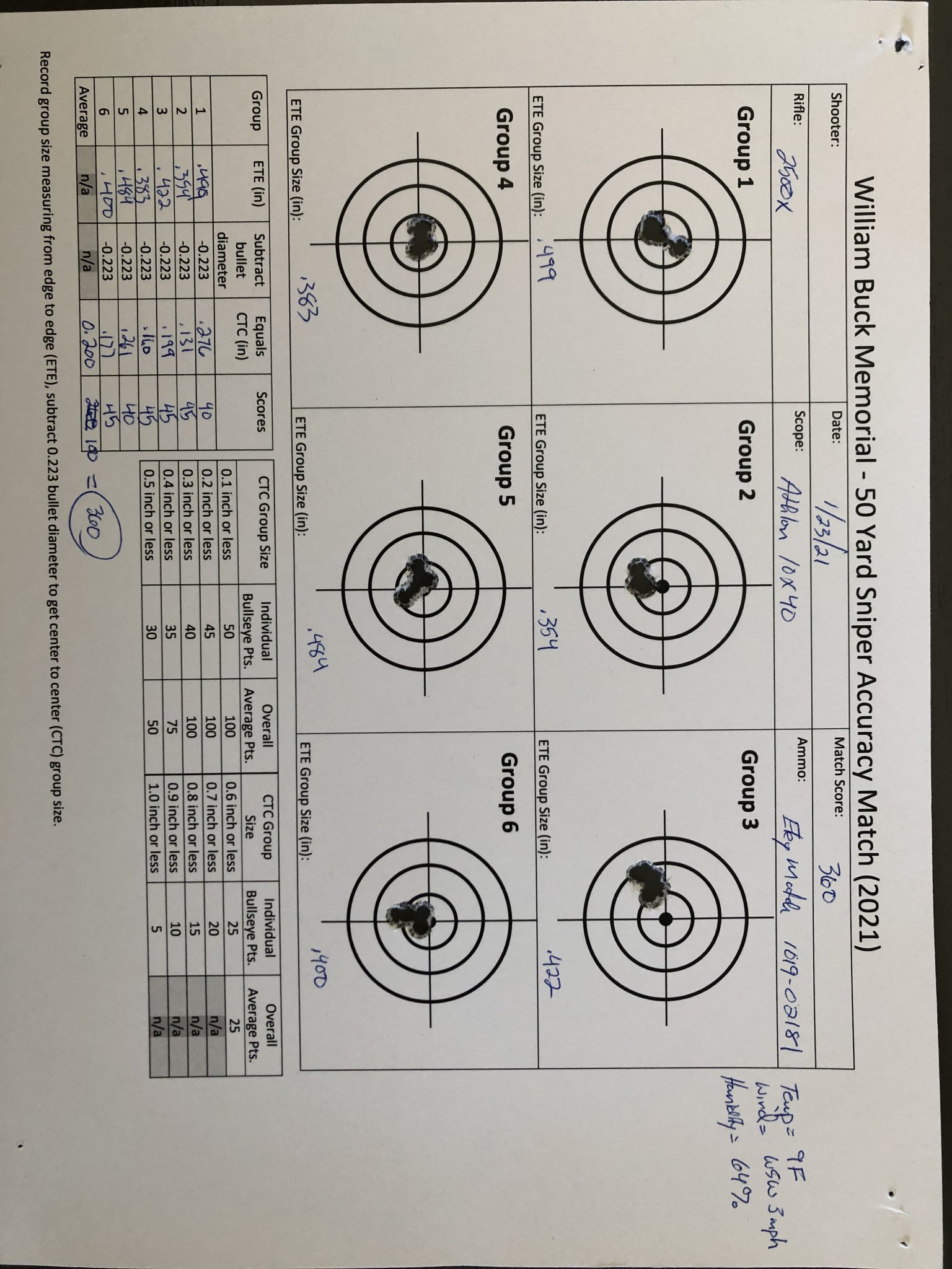

jbell, a fresh 50 yard submission for you. I did not improve on my best group, but was able to lower my overall average.
Distance - 50 yards.
Group sizes are .276+.131+.199+.160+.261+.177 = 1.204/6= 0.200 overall average.
Best individual group is 0.131.
Rifle: KSS Custom 2500x action/Shilen Barrel, Bix&Andy Trigger, Harrel's Tuner
Scope: Athlon 10x40
Ammo: Eley Match
FRest: Caldwell BR with PQP top
RRest: Protektor bag

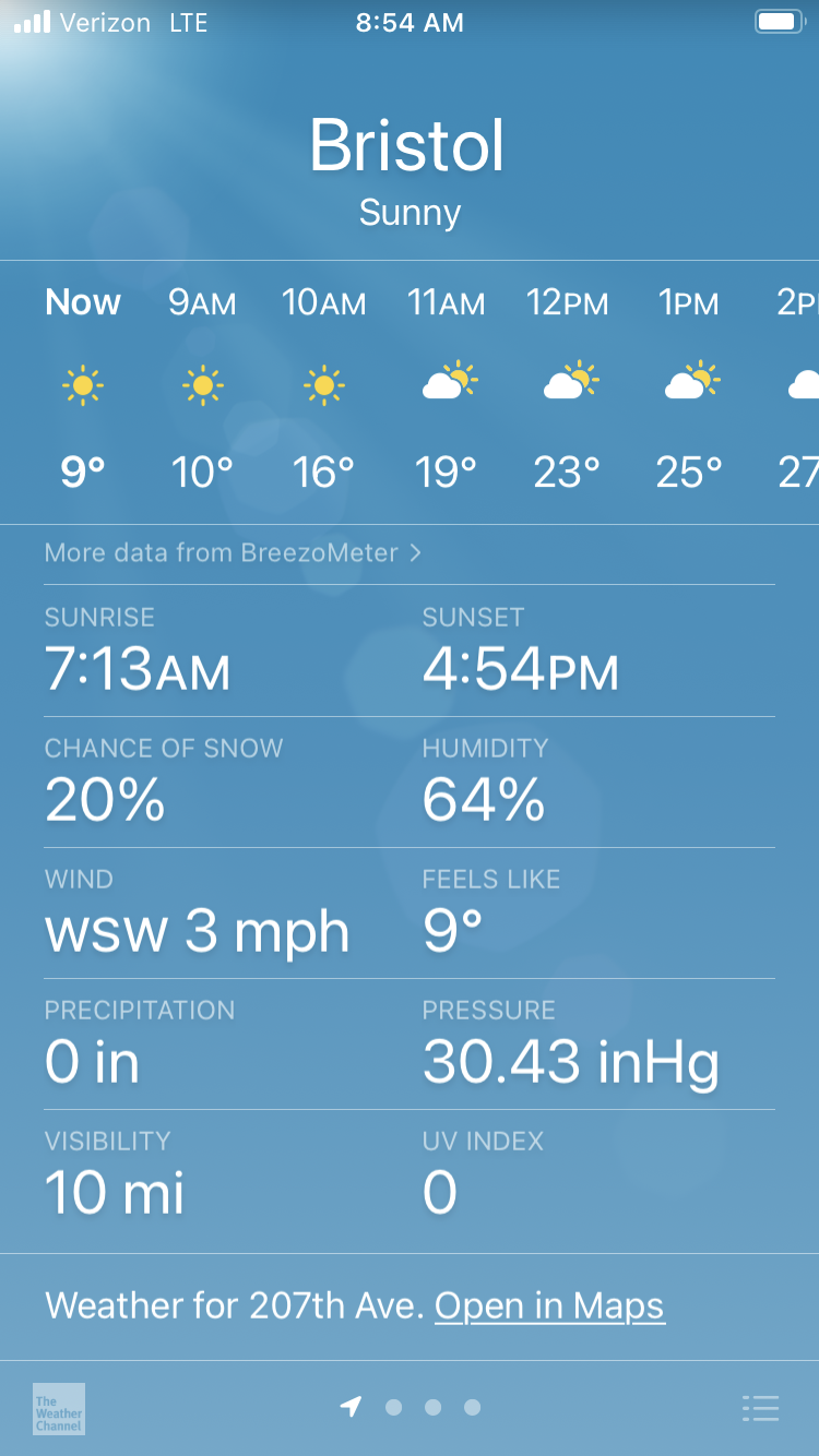

Temp was 9F, Winds WSW 3mph.
No cold bore in this group.
RFS99
Reactions: Mr. Wolf
That is damn good especially considering the air temp. I have it updated.
Thanks jbell. I think that's the coldest temp I have ever shot in. Eley Match seemed to hang in there though. I ran about a dozen rounds through the rifle to "warm it up", and that seemed to help. It was pretty consistent throughout the 6 bulls. Ammo was stored inside the house overnight, and then exposed on the table for 15-30 minutes prior to shooting.
Reactions: jbell

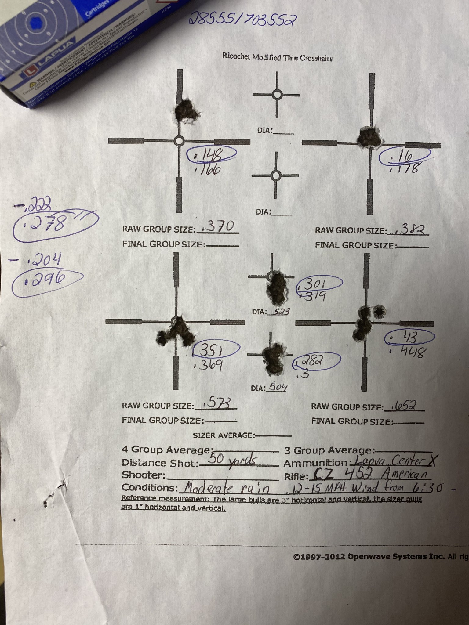

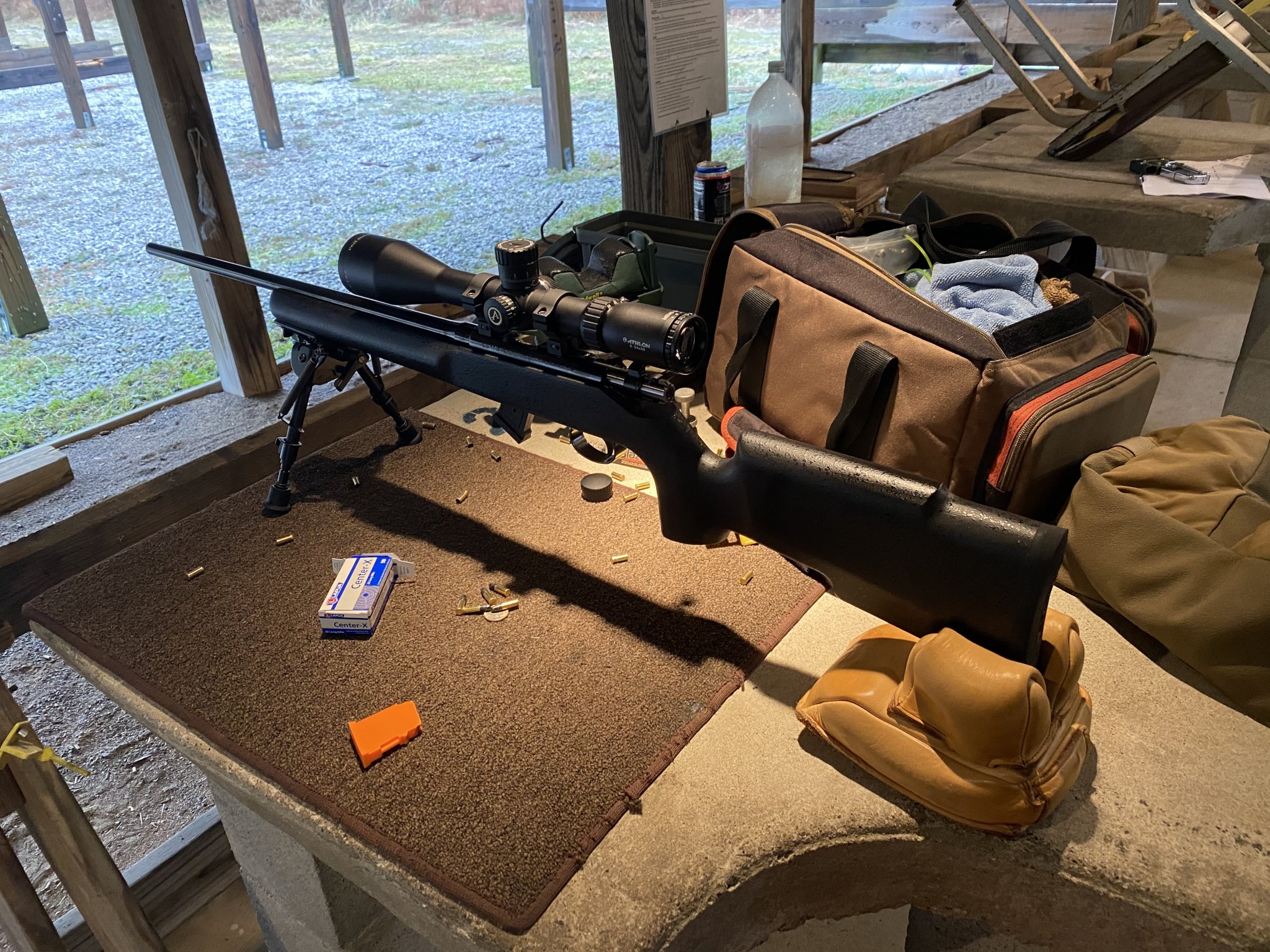

Rimfire is so unpredictable. I started not to go to the club today because of the weather, but did anyway. I wanted to try out my new bipod, ten round mags and bag I bought in preparation for my first NRL22 match. This is my first time shooting from a bipod. (I shot from prone for the first time today too.)I was in the process of setting a 50 yard zero. My first shots (3) on the upper left was .4 Mils high. I decided to shoot two more shots before adjusting the scope since it was looking to be a good group. It was a heck of a five shot group. I saw I had enough in that box for a 6x5 so I adjusted and kept going. This is my best one to date and I’ll probably never best it. By the last group I was nervous, trying not to blow it. The target stand was rocking back and forth and I had wait for it to stop moving. The target was so wet I was afraid it would tear apart when I was taking it down. Anyway, I beat my previous entry.
CZ 452 American
Boyd’s Pro Varmint stock
Athlon Midas Tac 6-24
Lapua Center X
.278” average
50 yards.
