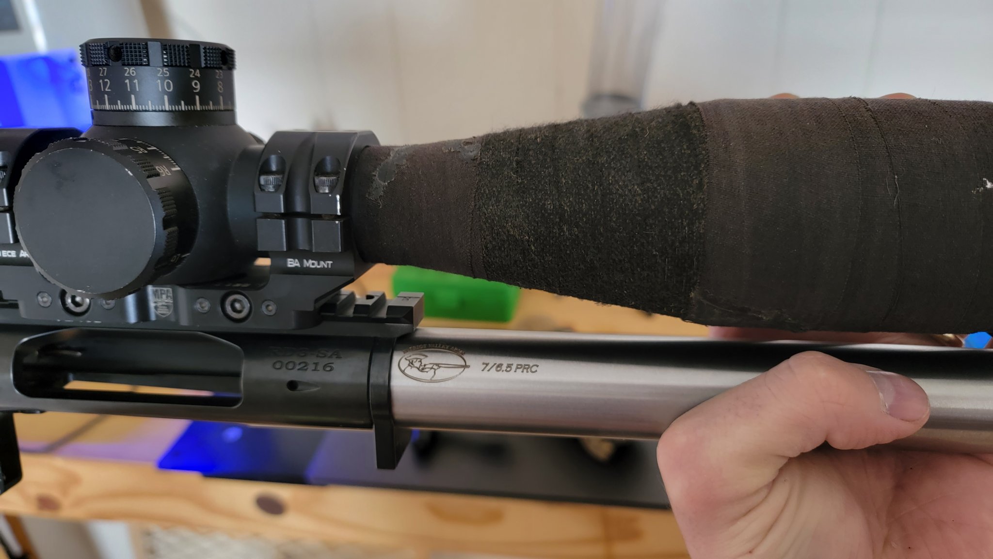

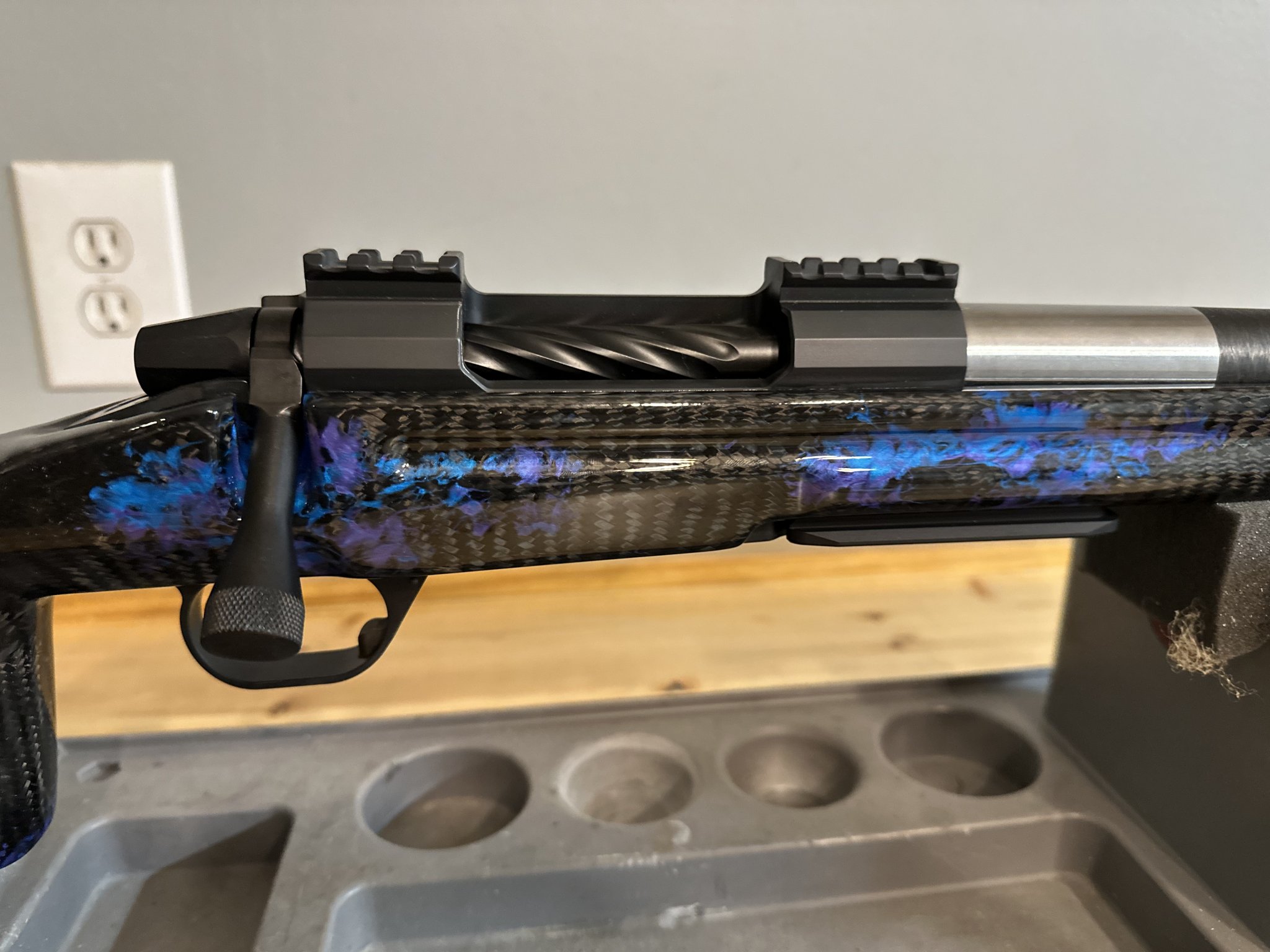

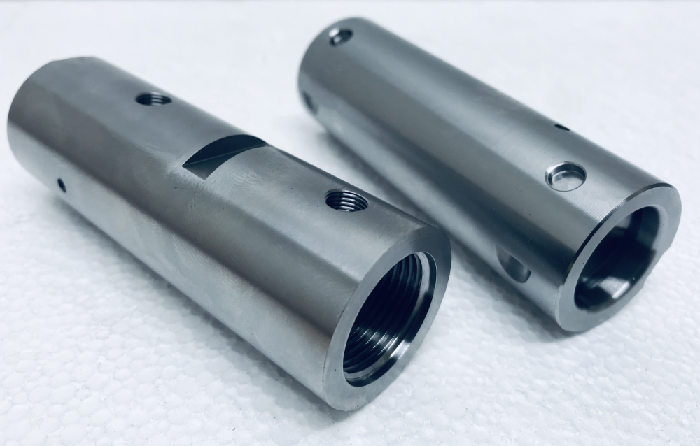

I'm getting pretty close. I've got my bolt face and supressor mount. All I need is to get my die and start testing.
The barrel threaded on nice but the start to the threads was iffy. PVA Said that it was odd but shouldn't hurt anything. That's all I'll say about that. I know they would have fixed it if need be. They've been good to work with and I wouldn't hesitate to recommend them. Can't wait to see how the Osprey barrel shoots.

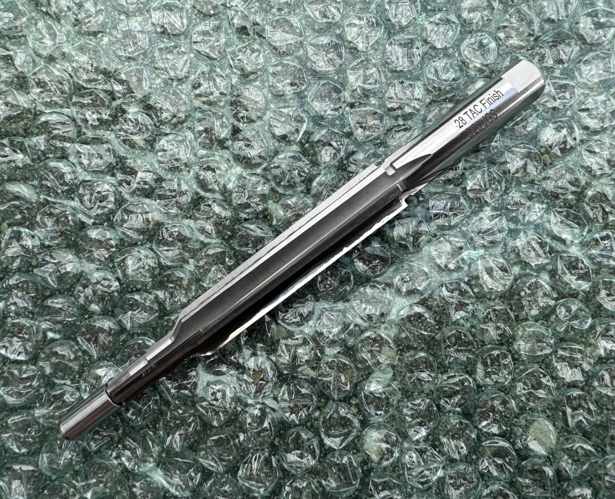

The reamer used on mine was from PVA and Josh has talked extensively about not sharing specifics because they are his own design and work. I trust he's flushed out the flaws and made a sweet reamer.

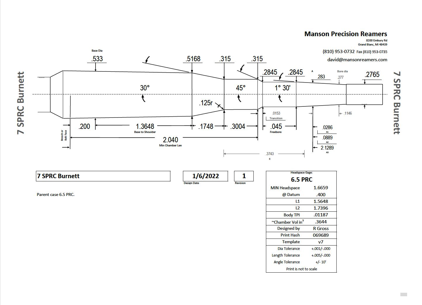

Do you think they would sell me the reamer? Or is it exclusively for their own chambering?
Alternatively, even reamer drawings that work for this build would work!

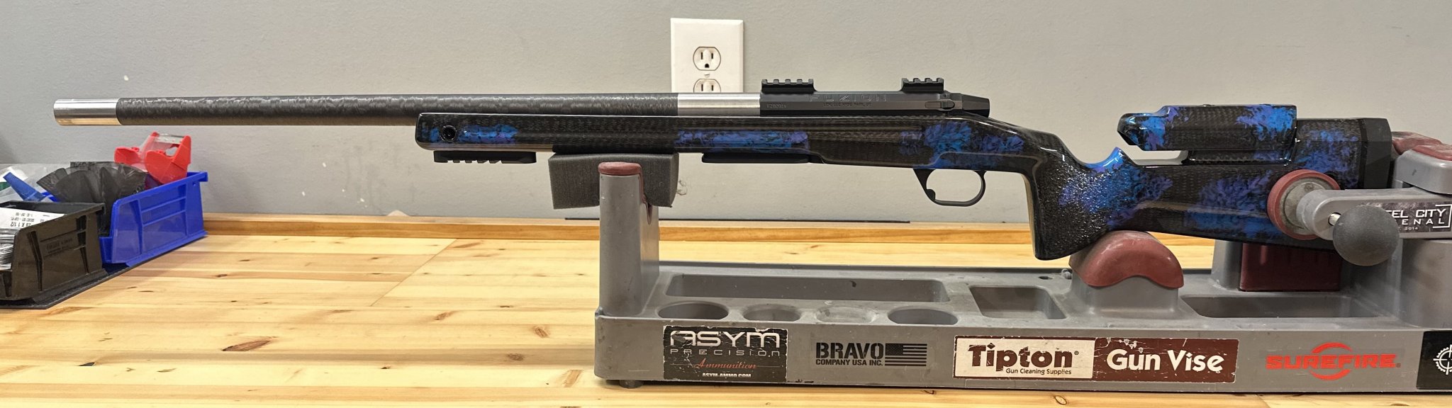

I did one, a 7mm-6.5 PRC. Well, I guess the appropriate way to say it is "doing" one since the barreled-action has been at the Cerakote guy for like 5 months so I haven't fully put the rifle together yet! Mine was designed to use a SA (I had just traded for an Archimedes so I just switched the BF to 0.532 and off we went) but the bullet I originally wanted to run, the 190 Hybrid, was way to long. I switched to the 180 Hybrid and, while sitting a little deeper than I'd like, it's acceptable at just below the body/shoulder junction. I know, not ideal but it'll work. I'm also building a little stock of 166 ATips. They're of course lighter than we want to see in a SAUM-ish case, but they performed well in a 7mm-08 I had and out to a mile I think they'll do okay in this new gun. Plus, I can get them far more readily than the 180s. Actually, given the 2.95" OAL restriction of a binderless SA magazine, I pretty much think of this as a grownup 7mm-08, and I'm okay with that for now. I may sell this in the future and move to at least an XM so I can really get all the ability of the case. I may also do a single feed-only 190 Hybrid load but we'll just have to see.
7mm-6.5 PRC: 180 Hybrid > 166 ATip > 7mm08 w/ 166 ATip
One of my core tenets in precision rifle is the brass. I like the concept of the 7/65 in part because Lapua is making brass, as are other good manufacturers. Hornady is still one of the only 6ARC suppliers I've been able to get brass from and I pretty much hate it. I'll be following this thread to see what direction other folks go with the 7mm-6.5 PRC concept
And for those interested:

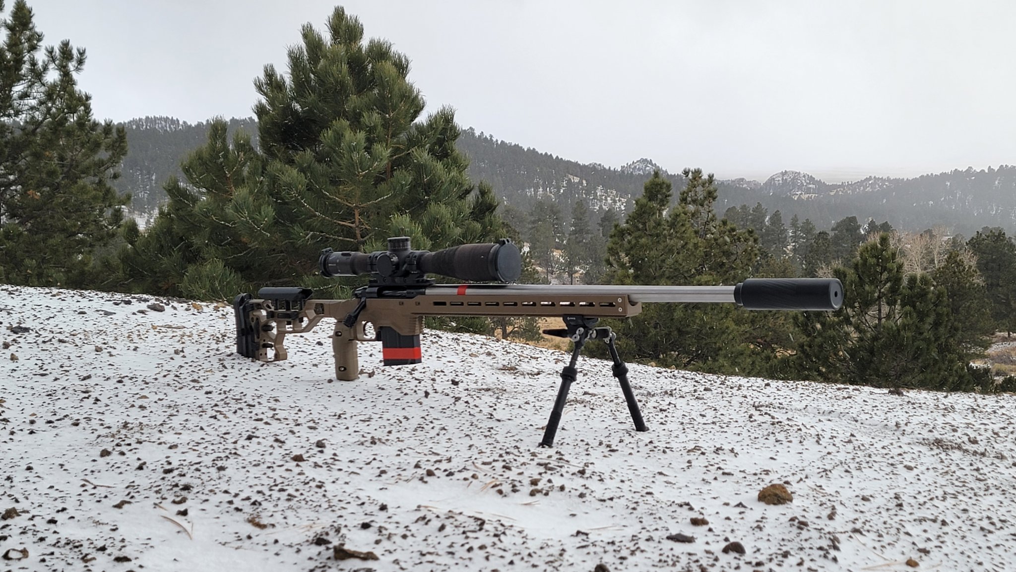

Action: Archimedes SA
Barrel: Krieger MTU 28" 8tw
Stock: Bravo w/ a bunch of goodies on it
Trigger: B&A TSP
Brake: ?
Scope: SB PMII in Badger rings
Dies: Whidden custom set based off the reamer print above
thanks for sharing this - was this the reamer you used in your chamber for this build??
Answered my own question.

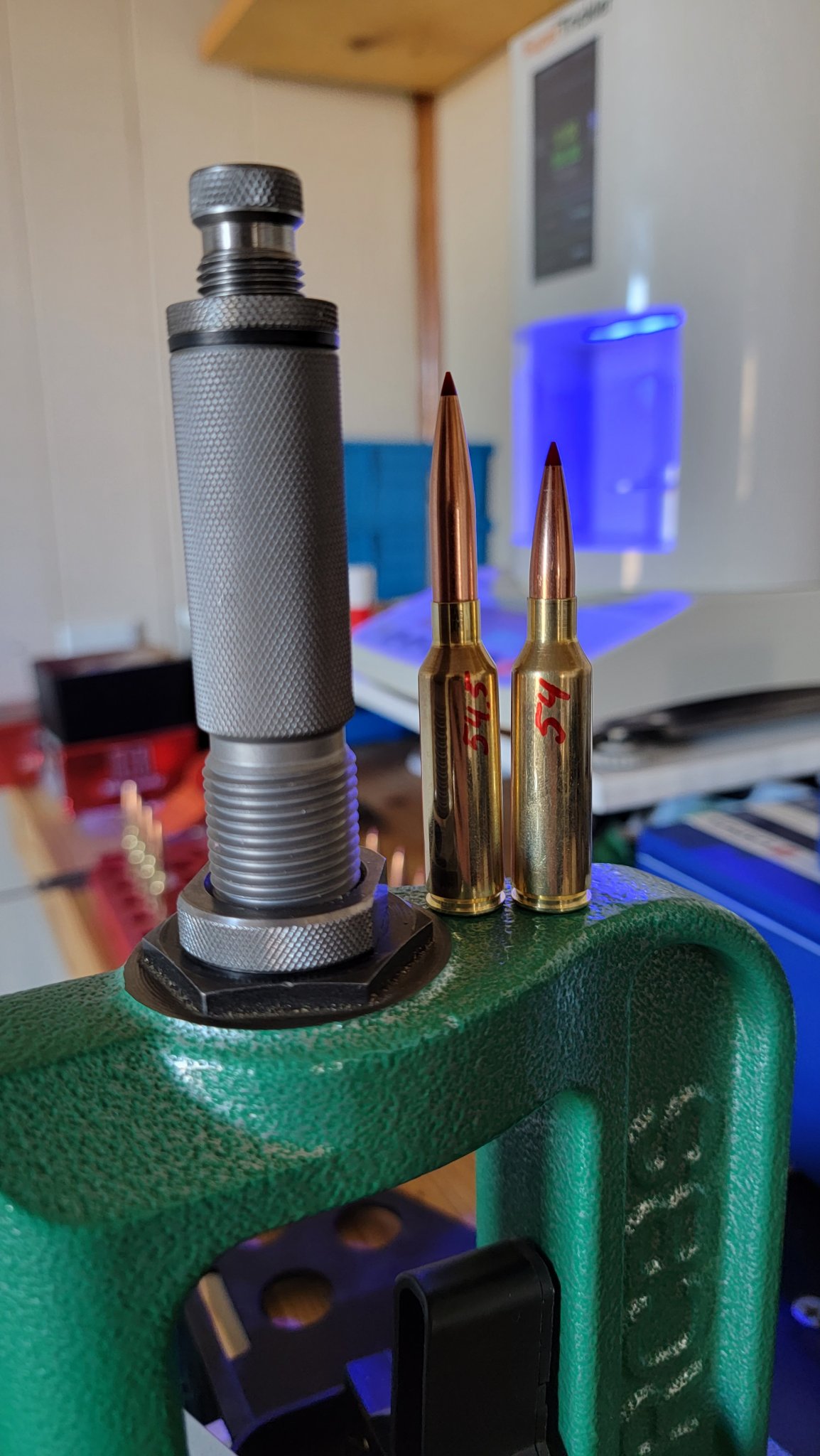

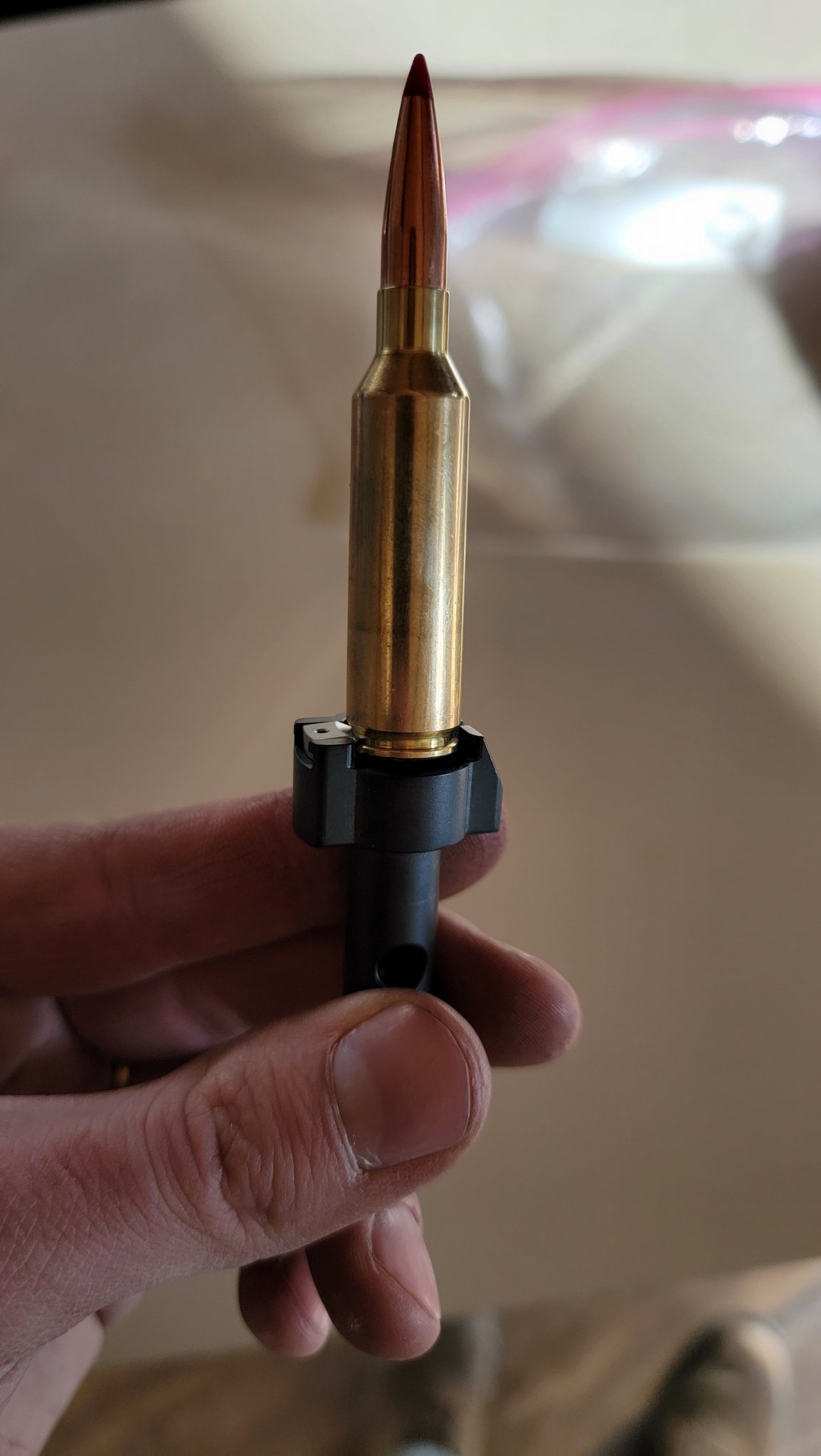

Took a 6.5 Creed brass and type S die.
Use a .284 mandrel and opened it up, Turned it, and ran it through the type S die with no bushing. The neck measured at .300".
The bushing for my .0135" thiccc necks is .308" so I'm guessing I'll be sending my die off or finding someone local to open it up.

Did you have custom dies made, open up the shoulder, or was this a non-issue?
Sorry it's been a bit but to answer your question, yes I had a custom set made by Whidden based off the reamer print above. Easy button

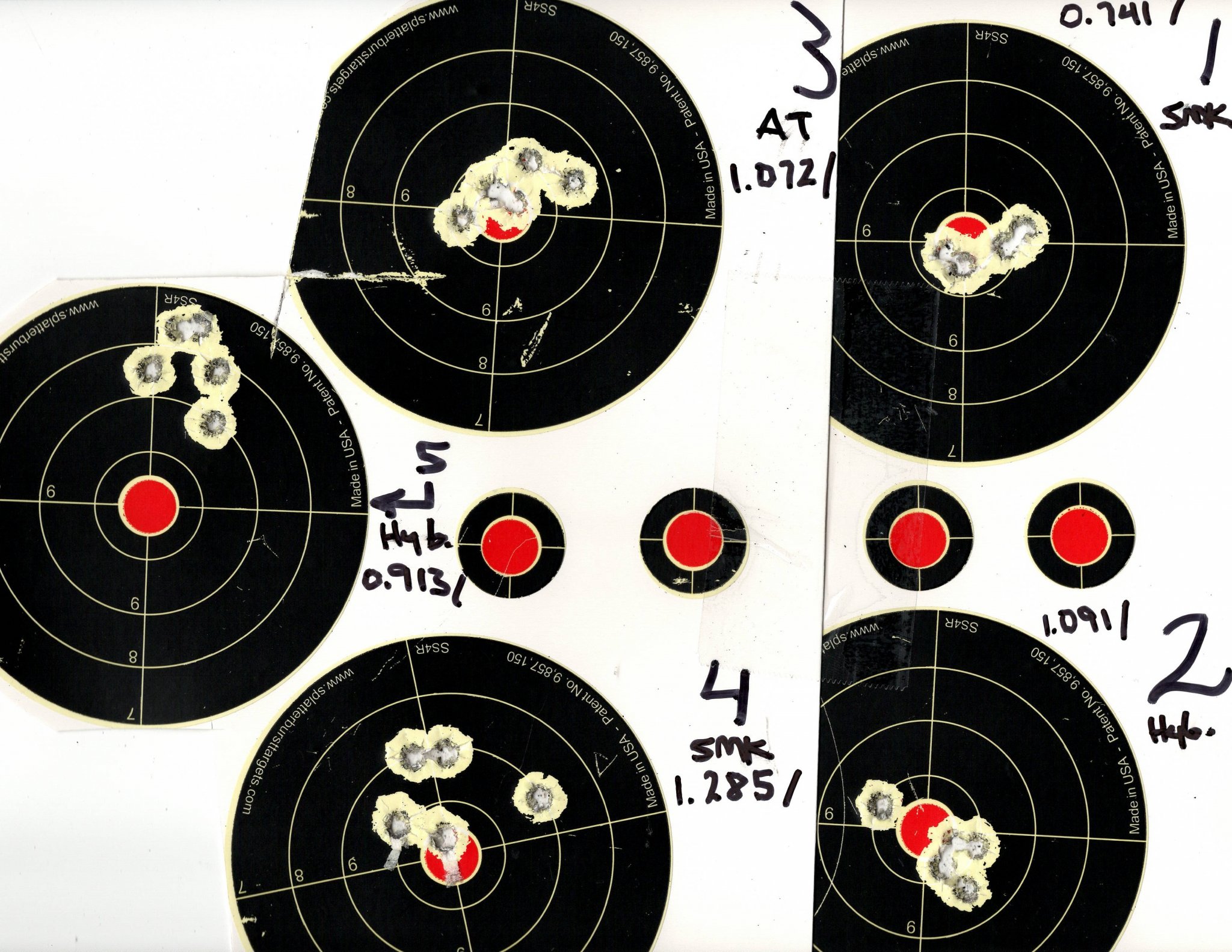

Quick update for those interested.

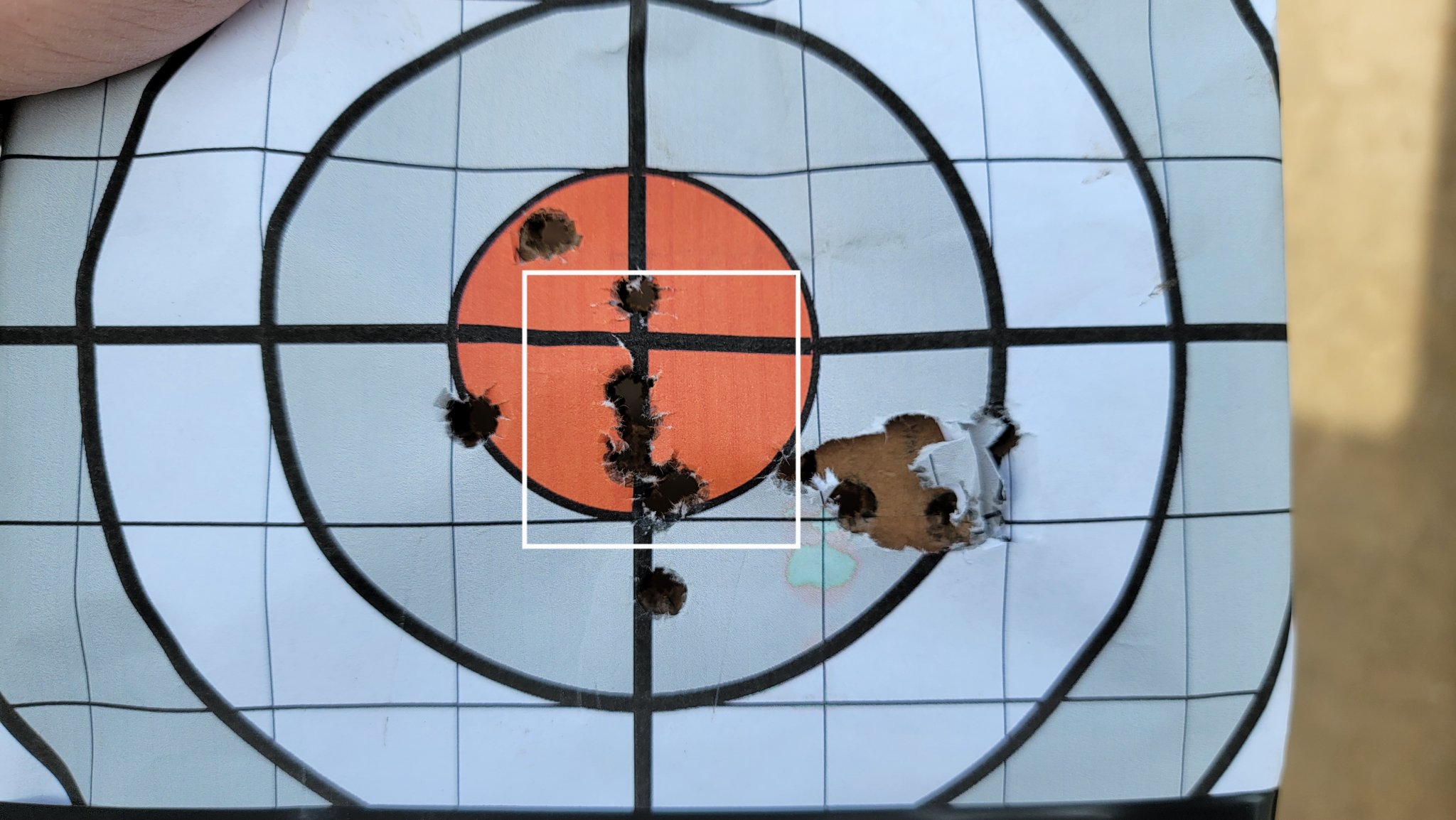

When I actually started to develop a load, I ran into accuracy (really precision) issues. I couldn't get anything to group. I'm including some target scans for reference. I put five in a hand size group at a mile, but somehow I couldn't get the gun to group worth anything at 100 yards. The prevailing theory is that maybe there's something going on with the stock, though I completely tore the gun down to see if I could identify some funny business, no such luck. From the targets, you can see that at times it'll put three I n a hole, then throw flyers that wideln the group to 1.5". So, I bought a MPA chassis off a Hide member and changed it out. I have yet to shoot it since, probably Thursday or Friday.
If that doesn't do it, my next suspect is the brass. The K&M tool I used to removed the doughnut from the inside was not very precise and I'm concerned that I / it introduced inconsistencies in the neck. I may open a fresh box of my Lapua 6.5 PRC brass stash and start over. The only way to address the doughnut consistently is turning the outside of the neck. I dont have the tool(s) for that operation and quite frankly don't really want to go down that hole at this point. So, either I invest in the neck turning tools, find someone to do it for me, or...wait for it...turn this puppy into a 7SAUM and save this 7/6.5prc project for another day. I have SAUM brass, a reamer, and very few patience left so we'll see. Also, I thought this would be closer to SAUM speeds than what it is. It's not a deal breaker, just a note. I've always said this is a 7mm-08 big brother and/or 7SAUM little brother. The jury is still as to which it favors more.
More to follow...

Have you tried another scope? Next thing to check is your striker assembly and spring to ensure consistent and reliable ignition.
I should also note that the targets above represent 3 bullets (166 ATips, 180 Hybrids, and 180 SMKs) and H4831SC. I have also tried N165 but I don't have any of those targets. Recommendation for the next powder to try? Just one condition, I have to be able to get it lol
N560 or N565 depending on what pressure signs vs. case capacity you observed with N165.
Superperformance maybe an option. H1000 could work or could be a little slow or over on case capacity.

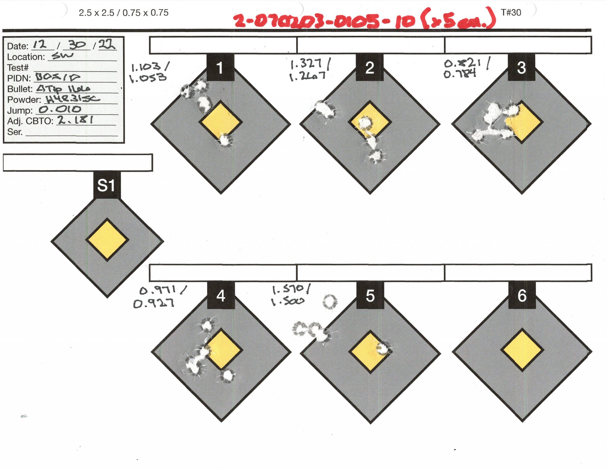

Made some progress today! This project has been a lot less plug and play than I first had thought. With that said, I wouldn't change a thing. Found a great guy in my area that was happy to help me out. I brought my rifle with me while going out to his place to work on the 6.5 PRC die.
Last night I decided to load up 55gr of IMR 4350 under a 162 eldx. I chose this because it wasn't dangerous, had some speed and landed in a pretty tight group in my 100 yard ladder.
We chucked the die up in his lathe and had it opened up in no time to .321" at the neck shoulder junction. Fired brass measured .319" with his micrometer.

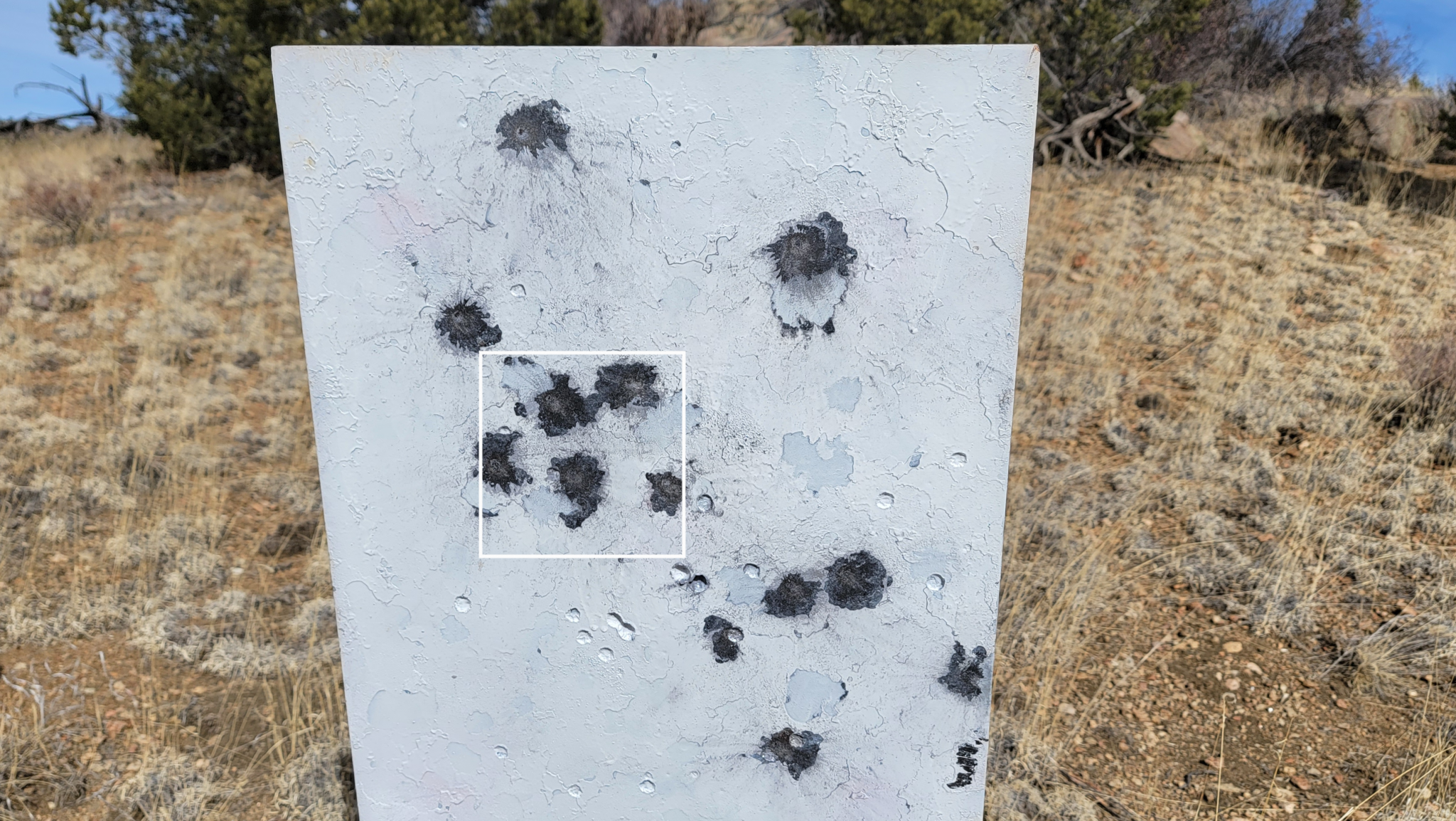

We took our rifles out to 765 yards and had some fun. Shot some off the tripod and then I laid down and tried to see how this random load would shoot.
Needless to say I think this PVA barrel is very forgiving. 10/10 would recommend.
Just eye balling it, looked like about 2.5" tall and less than 5" wide. I'll take it.

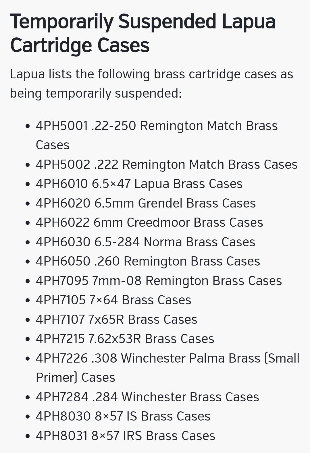

Like you said 284 win does better in a LA but also lapua just suspended production of 284 brass.
ADG Makes saum and sherman brass but the sherman brass costs just as much (maybe more) than the lapua 6.5 PRC brass. I haven't shot ADG so I can't speak to its quality.
The guy helping me out let me shoot his 284 win, the top three hits above my rifles group. It was pretty cool. Very similar.
Makes sense, good cartridge just curious as there were a couple right around the performance. I have several in that range and decided to try out the 7-300prc as a larger jump up. But that is a good all around as the barrel will last longer.

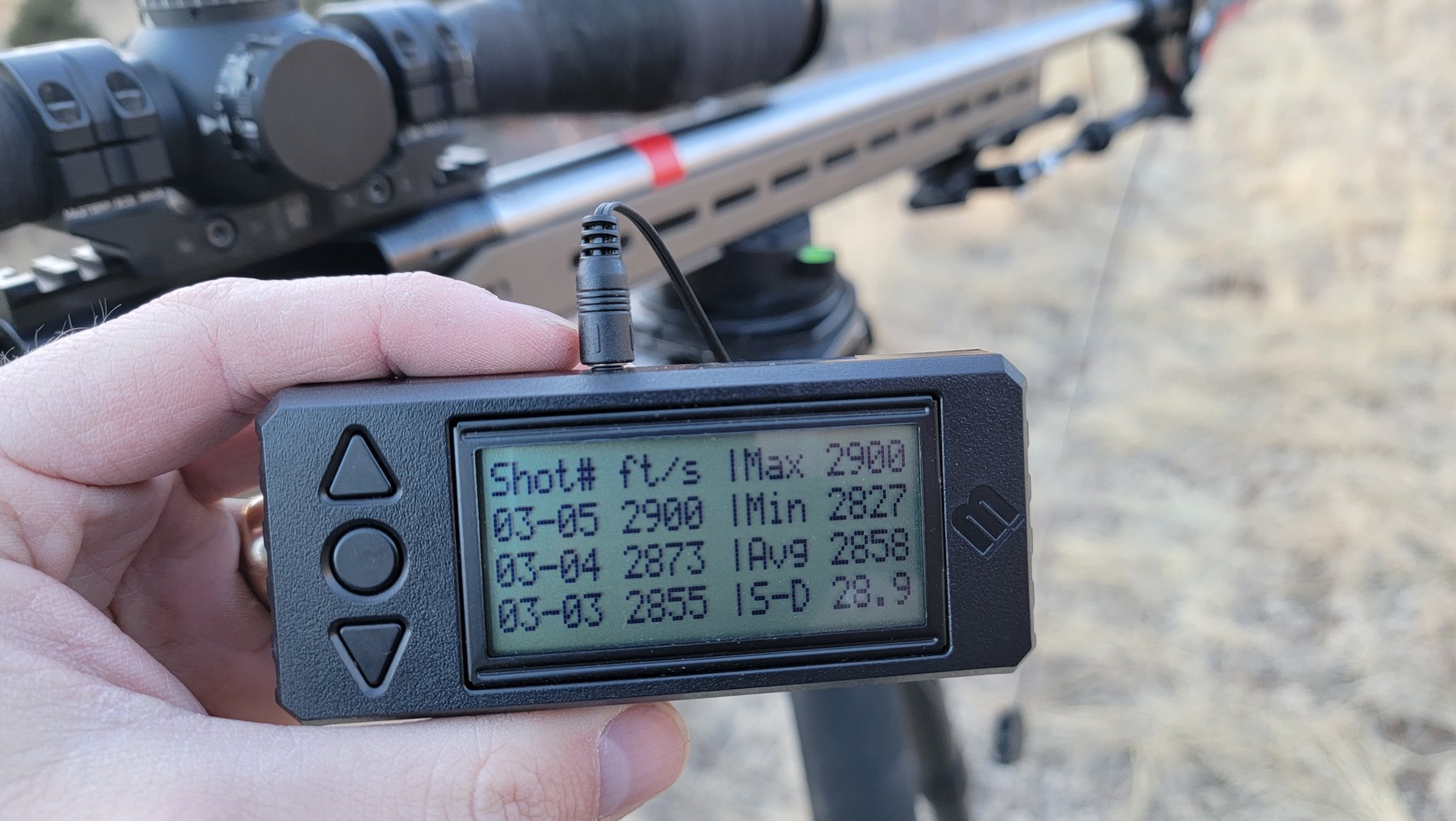

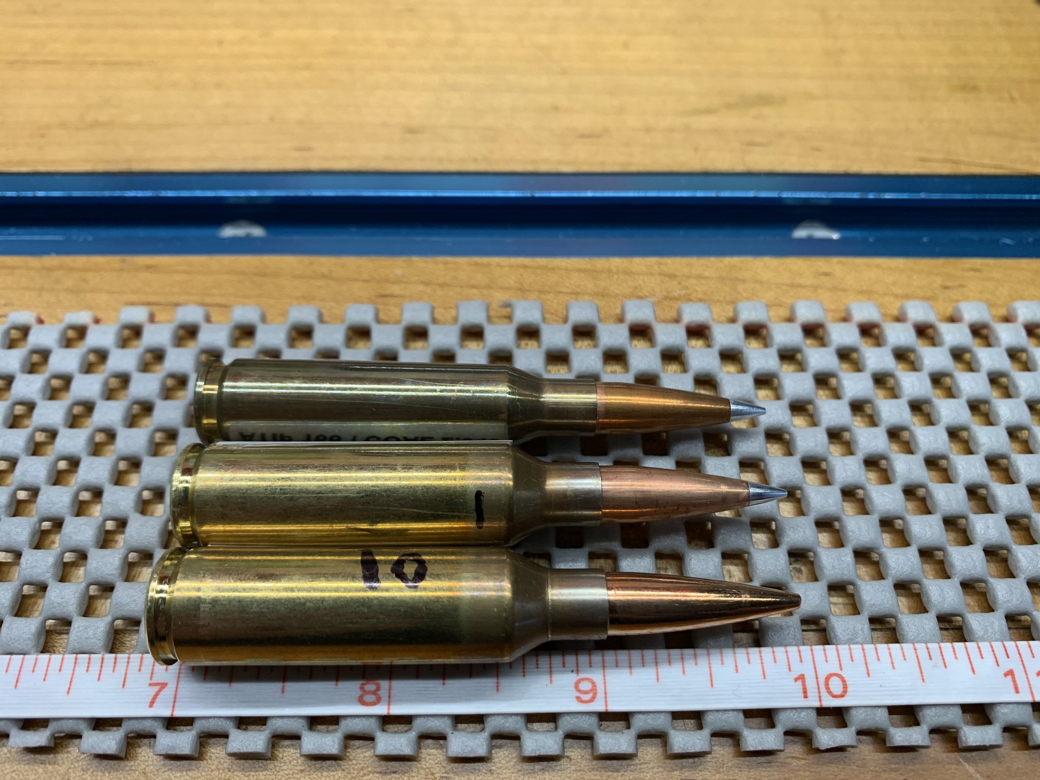

First time out with the lapua brass and it didn't disappoint.
180 ELDM. N555
Loaded 50gr up to 59gr but didn't make it all the way.
These things are Loooong.
No pressure signs at all but I stopped because I like my face. I was expecting to hit 2800fps and maybe 2825fps.
56.5 was at 2900fps.
Accuracy testing next.

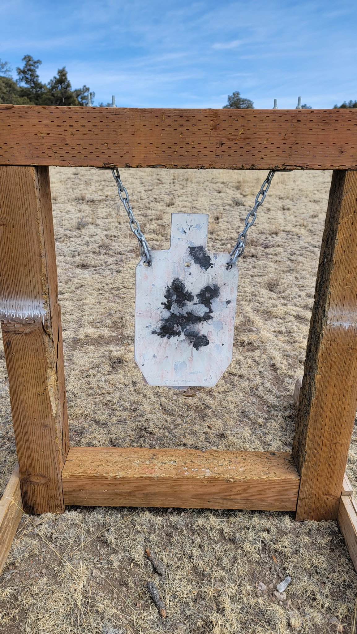

Well, not all days are glorious days.
Nothing all that exciting in this velocity range. But I took 55.7 out to distance just to see. These loads were 180 eldm and N555. This combo should have me around 2860~
This is a 66% ipsc so about 12" wide. 675 yards.
The top shot was my sighter the next 8 were my group. About 1 MOA. Not ELR material...

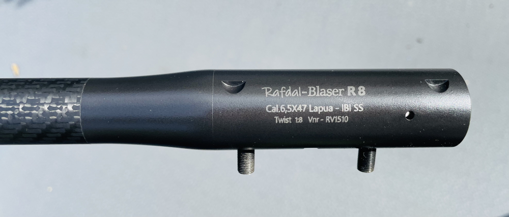

First question: How many rounds do I need in the magazine with an overbore barrel burning magnum for hunting or elr?
If 3 rounds are enough a Blaser R8 is a short "223 micro action" that will handle 338LM, 375H&H and 500 Jeffery.
The R8 will handle anything from 22lr to 500 Jeffery.
Measure the distance from trigger to the muzzle and compare the R8 with any traditional bolt action. The R8 is about 4" "shorter" than a traditional long bolt action. The R8 can have a 26" barrel compared to a long bolt action with a 22" barrel when both rifles have the same OAL.
These barrel extentions cost app $250 and any barrel and caliber can be fitted to the R8:
Here's a custom IBI carbon R8 barrel made with a barrel extention:
Here's a R8 in 338LM. Notice the distance from trigger to chamber end of the barrel. The R8 is effectivly about 4" shorter than a traditional long bolt action

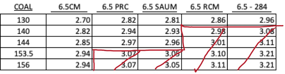

I was comparing 6.5PRC to 6.5-284 from the guy i quoted
But yeah PRC. SAUM. SS/SST/Max/Mega. 7RM. 7LRM. 7PRC. All roughly the same. Slightly different case lengths and action lengths...but not a whole lot

Having the same COAL dimensions is a factor of the magazines they are designed to work with. Of course they are the same because they are very similar cartridges for similar use cases. IIRC the 6.5 RCM (PRC) was what George wanted from the beginning but the SAUM case was more readily available so thats the route he went until Hornady was on board with the PRC.
The 6.5 PRC was designed to "blueprint" the 140 hybrid. You can see the SAUM and PRC... are within identical with production toleratnces of ± .001. This is because the GAP 4s was designed to blueprint the 140 hybrid properly.
You will note that RCM doesn't blueprint the 140 hybrid properly, its 4-5 thou over.
Moving to 7MM...equivalent shape/BC bullets are LONGER in relation to larger diameters.
So, there's no way to make "good" 7MM bullets fit since you only had .001 cleance on the 6.5s
Cheers.

Got my “28 TAC” (7-6.5 PRC with variation in some specs; especially freebore) reamer in. Now then barreled action will go to the smith next week:
- Big Horn TL3 Medium
- 22” Bartlein 14 Carbon Fiber,
-Left Hand / Gain Twist
- Manners LRH Black and Blue, high gloss
Once back it will be pillar bedding and custom Cerakote on everything but the action. Yes, the Black and Blue LRH will get overlay Cerakote graphics to complement the base color. Gotta cover the “purple” that is mixed in.
*Note - pictures with LP Fuzion medium action. I sold it for the TL3 so I can replace bolt faces later if desired.
Reactions: 260284
180 ELDM. N555
Are these loads at SA mag length or are the 180s too long?
I’m in the process of obtaining some reamer prints for the 7x6.5.
This cartridge already has a lot of variants and improvements. Something I found very interesting was on an Eric Cortina video where he was saying that the original version of this cartridge was producing clickers, and therefore his 7 prcw (Alex wheeler design) has an improvement with a slightly larger 0.200” line diameter.
I thought this was very interesting, and wondered if anybody here has a reamer print of this spec?
JGS Reamers knows the dimensions to change that addresses the clicker and stuck case issue.
I worked with Alex in developing my prints specifics.
Thanks for the reply. Hope im not breaking any group rules here, but would you or Alex be willing to share or sell me the prints with this improvement? I’m outside of the USA, so ordering reamers and shipping to me is quite a big deal?
