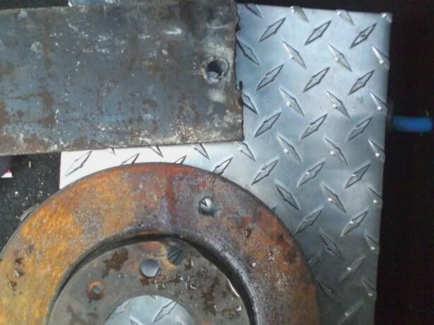

loaded 20 rounds the other night 6@ 44 gn 6@45 and the rest @44.5. all were really accurate. and none showed signs of overpressure or keyholing. so it looks like i'm goin with 45 gr. i was only shooting @50 yds but i'm blind as a bat and have the iron peep sights. aside from a couple fliers i saw under 1" groups. annnd as a bonus...
vented rotor and 3/8 mild steel. went through like butter.
