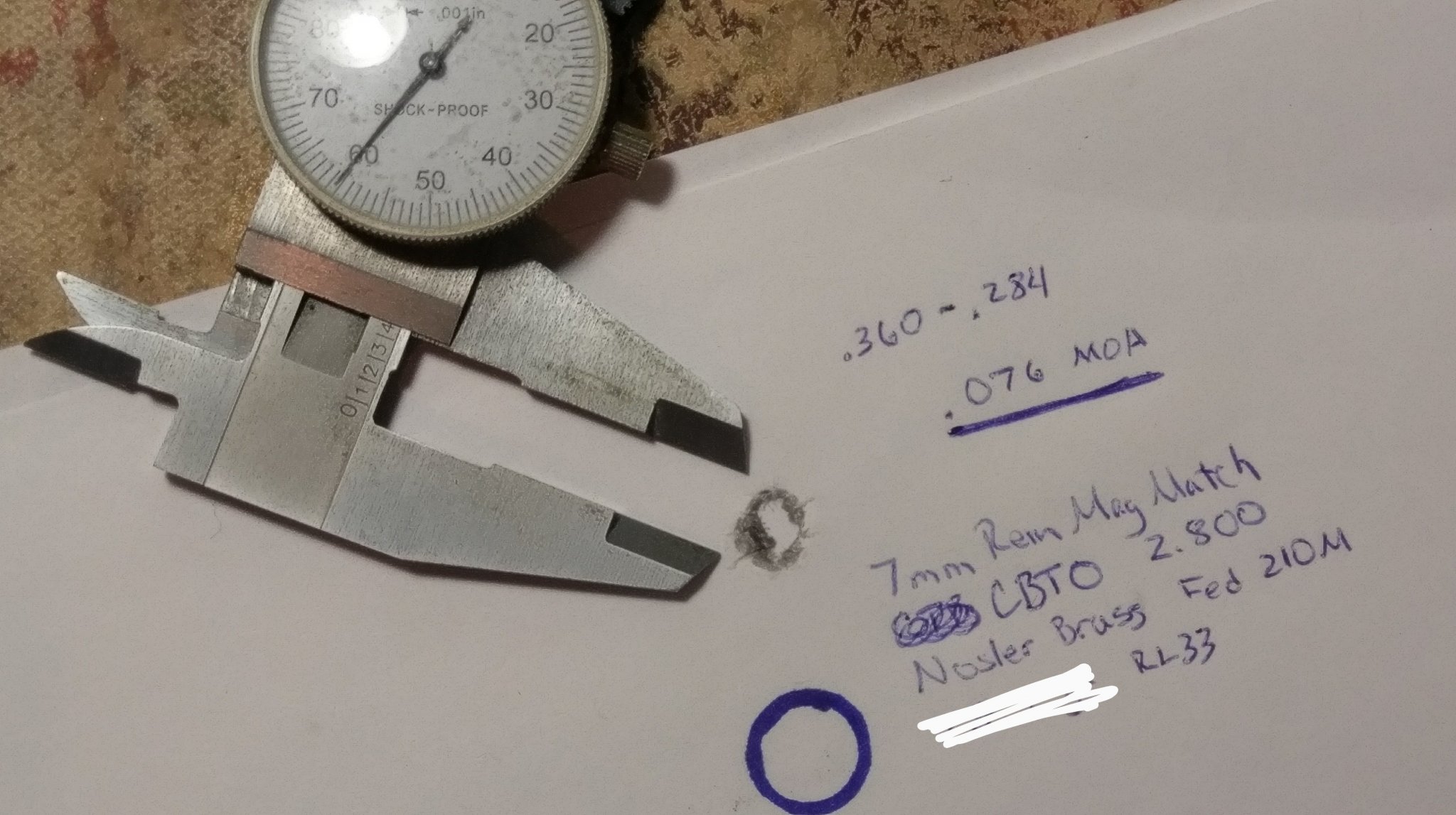

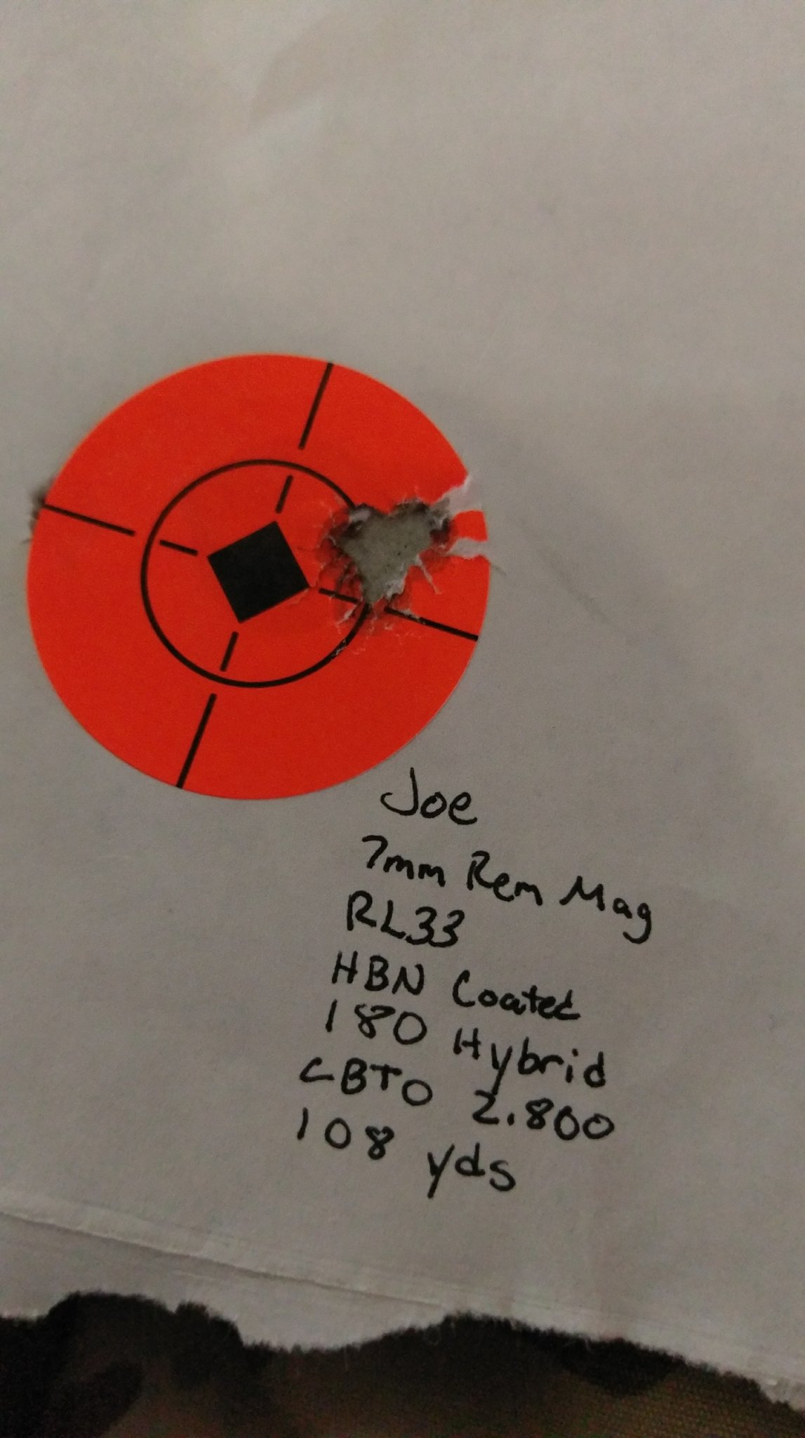

These are both 3140 with 180 hybrids in a 23" pipe.
280ai less powder....sure.
more efficient ... probably.
But to be honest...I don't consider 180s to be "the heavies" either. Not anymore. When I built this rifle, 180 was one of the only commercially available in the 180 class *(I think matrix made a 190) but now there's LOTS of options and I would consider a 180 bullet to be on the low end of the heavy class.
I'm not pissing on the 280ai...but the whole point of the post (almost a year ago) was to determine if a 7 PRC would offer improvements over my existing set up...which it clearly does not. Especially when...for my use, it would require a new bolt.

View attachment 8238610View attachment 8238605
3140 from a 23" pipe, that's a lot of speed for the setup, def an exception rather the norm. What powder? Rl26, N570, N565? If using are standard single base powders like H1000 or Retumbo, that's def a very WARM load, and I wouldn't recommend anyone persue that velocity in a shorter barrel 7rm. But hey man it's your rifle, it obviously shoots well. You're running at 28 nosler speeds. I know my friends 26" 28N topped out with 180hyb at 3220 w/ Retumbo. Bartlein/Lone peak build, not junk or oem rifle. My 26" 7lrm which holds 3-4gr powder than a 7rm, runs nicely at 3100 with 180s from a 26" pipe. Maybe now that I'm pushing 40 my desire to run on the ragged edge just isn't there anymore.
:cautious:...the powder is literally written on BOTH pictures.
Reactions: 4O6shootist
My apologies, yes rl33 is a high energy dbl base powder, gives 100fps more than single based. Have fun and rock on. Rl33 is quite dirty and temp sensative, until you get the pressure up, for some oddity it's more stable and clean there when I used it in my 300nm imp. Idk if that's your experience in the 7rm or not.
I've not seen any issues with being excessively dirty, no more than anything else I've ever used, and significantly less than most Vihtavuori I have experience with. It's not exactly what I would call "Temp Sensitive" but there are others that are better, but for me, the juice is worth the squeeze.
