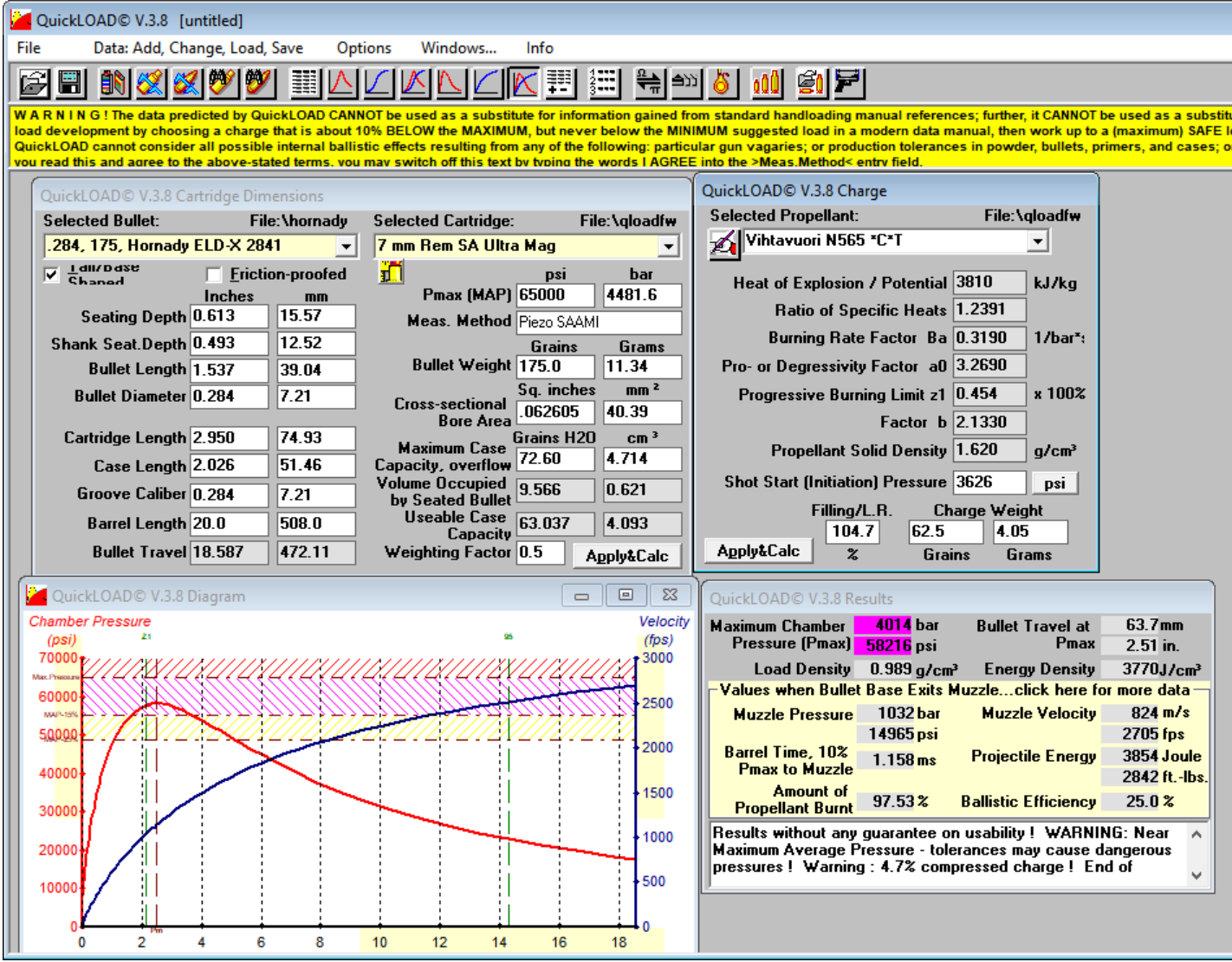

Looking for opinions on powder choice for a recent 7 SAUM build. Was leaning towards either 4831SC or N565, don’t have either in my inventory. Only have 50 rounds through the barrel at this point, and loads have consisted of the following.
Impact NBK short action
20” Benchmark CF 1:8.4
ADG brass (virgin)
175 gr ELD-X at 2.950"
N165……..mainly loaded with 58.5 gr for barrel break-in.
WLR primers, and have shot a few 210M and BR-2’s.
Ran a small ladder with WLR primers to see where I ran into pressure. 60 gr (2700 fps) produced a heavy bolt and ejector swipe.
59.4 gr using the BR-2 is showing promise and averaged 2616 fps with single digit ES & SD’s.
Any help is appreciated and also open to suggestions.

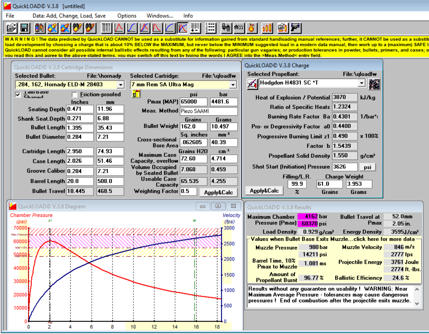

N560 will also do quite well especially out of a short barrel.
If you’re coal limited to short action at 2.950 I would seriously consider the 162 ELDM.
The 162 will come out faster, with less recoil and more optimized burn rate out of a 20in barrel by using a faster powder. The BCs are also pretty close.

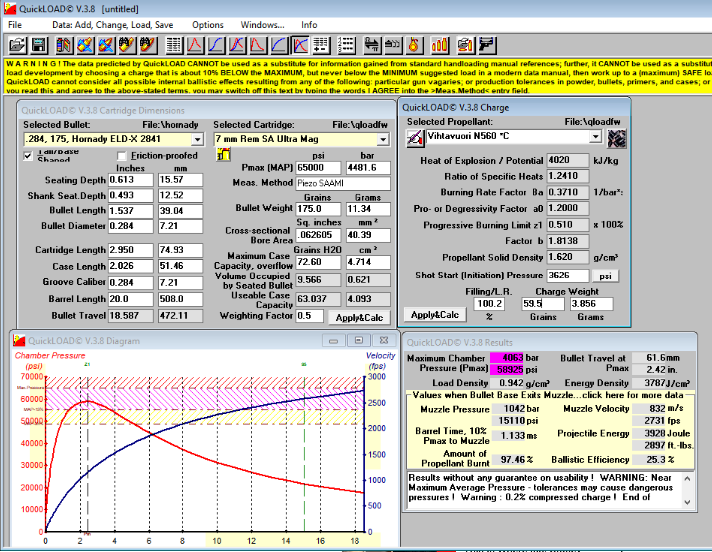

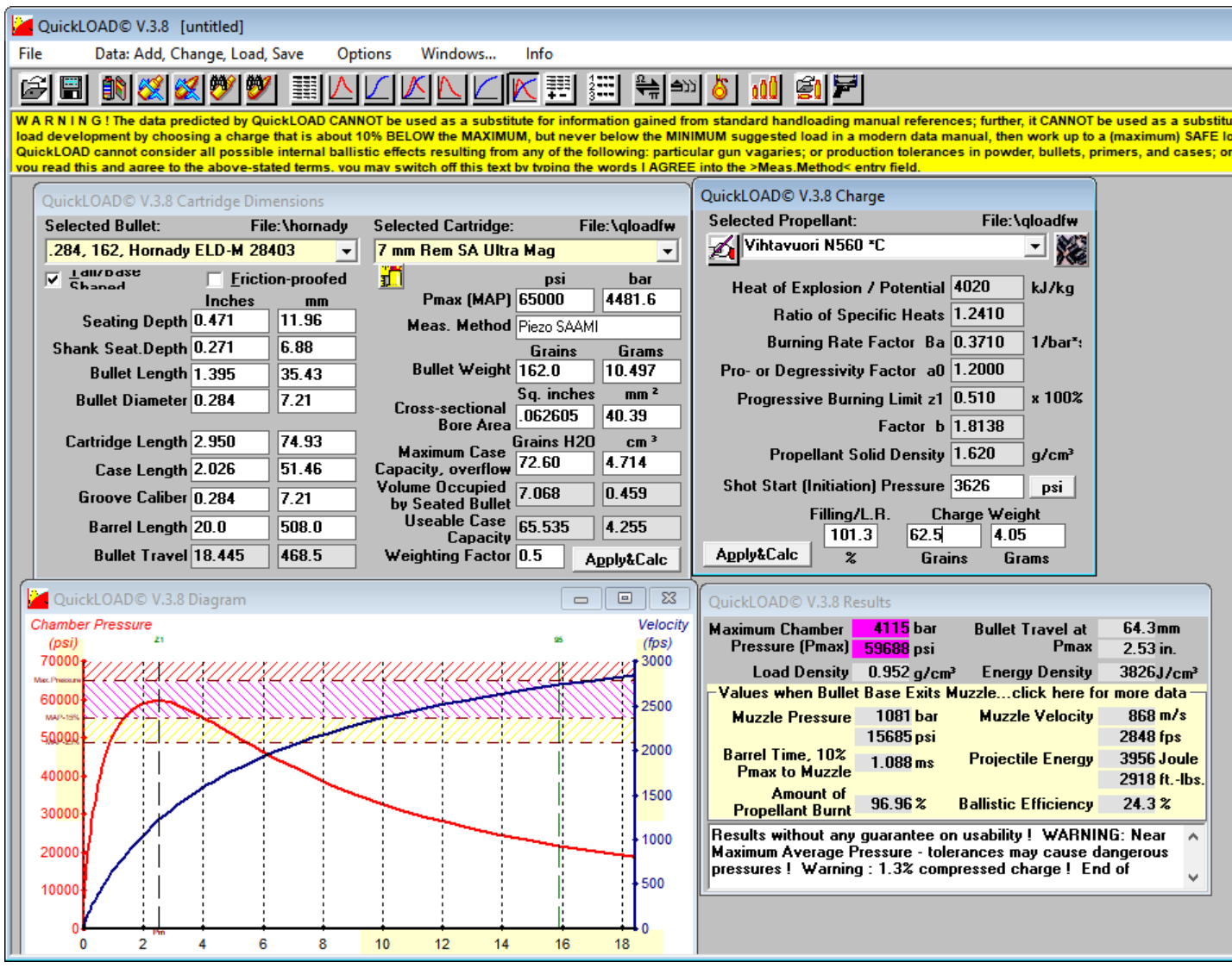

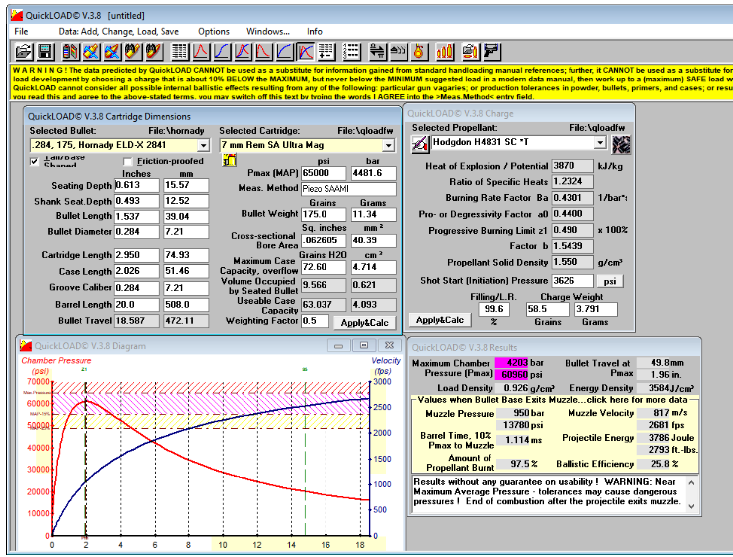

This might help you get started. QL shows bit more speed out of a 20in barrel with N560, both in the 162 and 175.
Just for reference, QL shows 62.3K PSI at 60gr for N165 so it does sounds right that you'd get heavy bolt and ejector swipe.

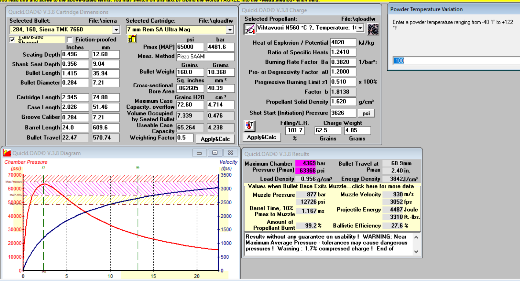

N560 working very well with the 160 in this cartridge. Old RCBS Chargemaster and x2 ADG brass. 100-125FPS faster than H4831SC. No pressure on any loads at 45F approx 2500' DA. Primers were CCI BR2
162 ELDM 2.945in 62.5gr 2995 FPS SD 7 ES 18 1/2 moa 5 shots
162 ELDM 2.945in 63.0gr 3025 FPS SD 4.8 ES 12
160 TMK 2.945in 62.5gr 3003 FPS SD 4.3 ES 12 0.30 moa 5 shots
160 TMK 2.945in 63.0gr 3024 FPS SD 7 ES 19 0.20 moa 5 shots
160 TMK 2.945in 63.5gr 3050 FPS - no groups.
166 ATIPs 2.985in (single feed) - 61.5gr 2925 FPS - no groups.
Most likely just settle for the 62.5 160 TMK load as it's only going to get warmer and 3000FPS is more than enough for this 24in build.
Quickload gives me 63K PSI for this load at 100F which sounds about right

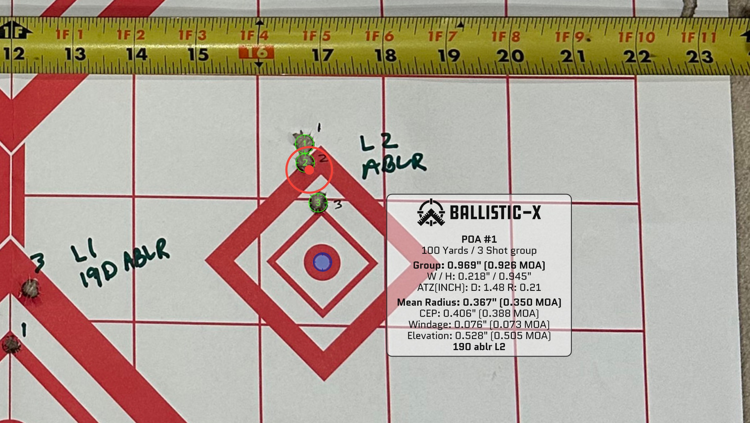

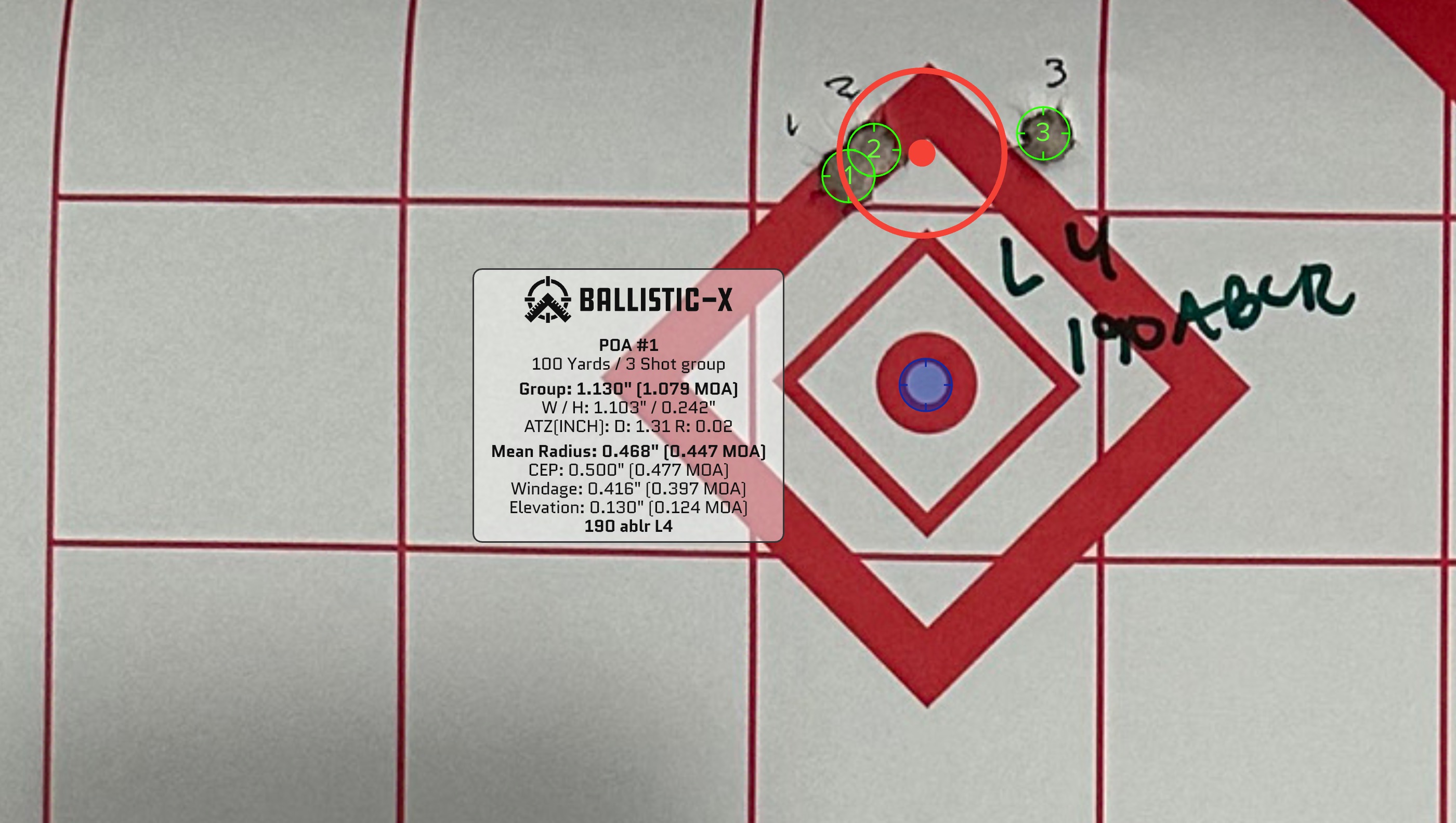

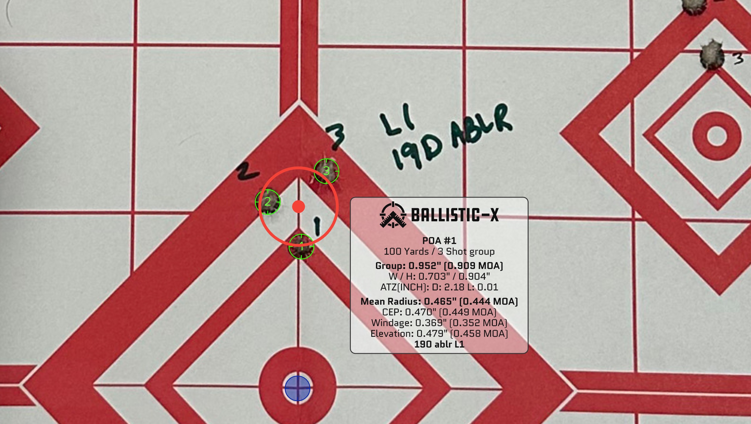

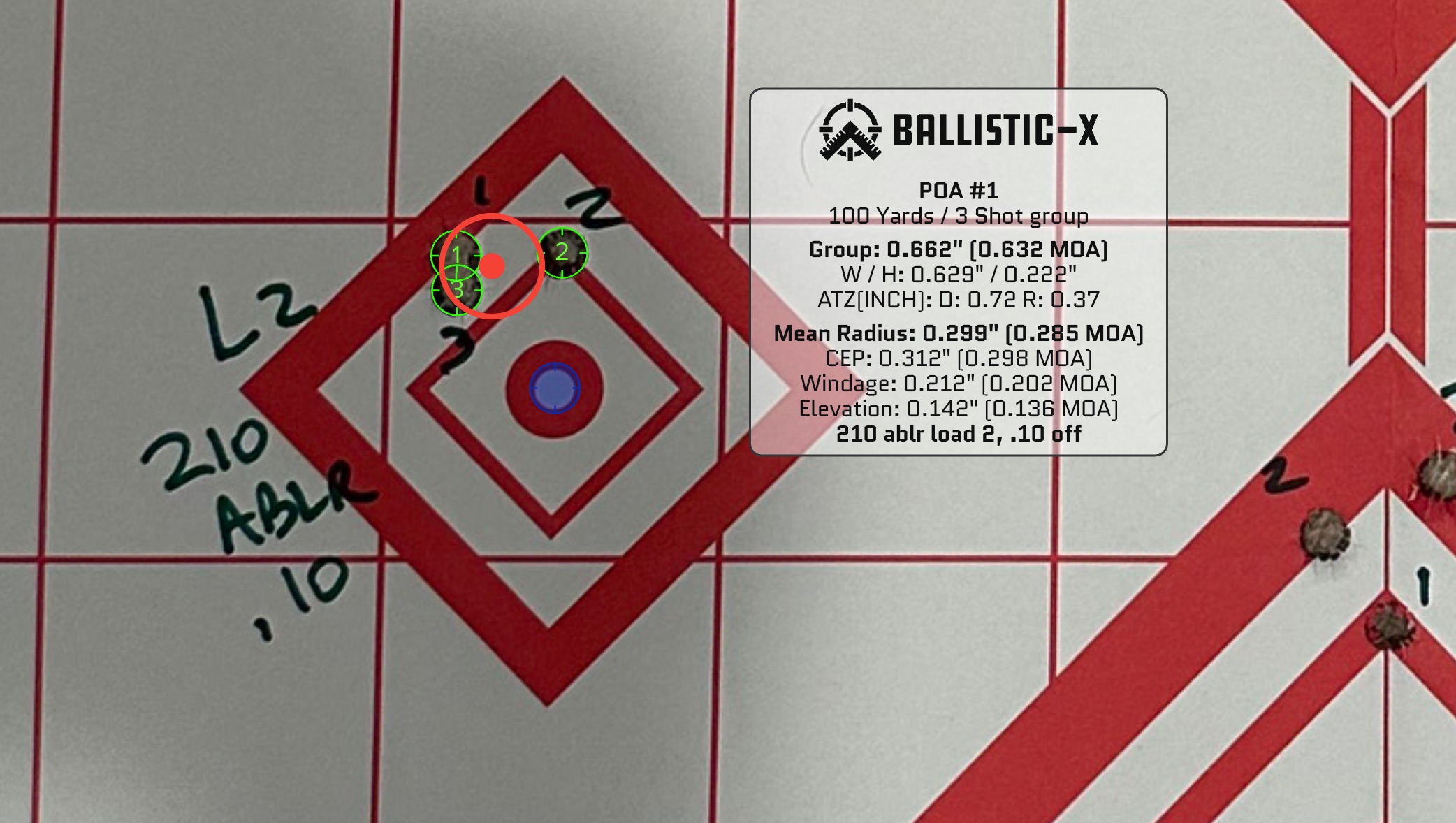

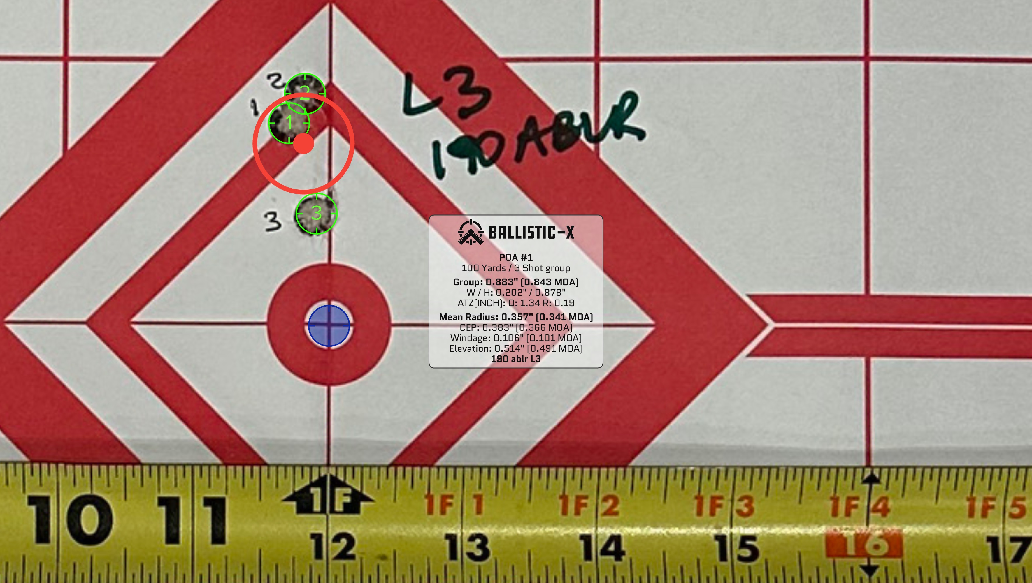

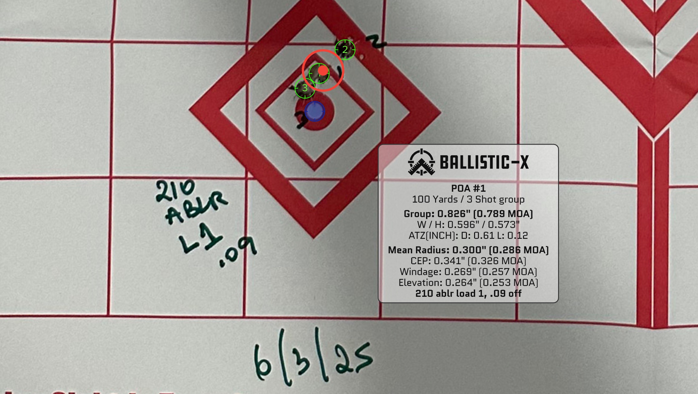

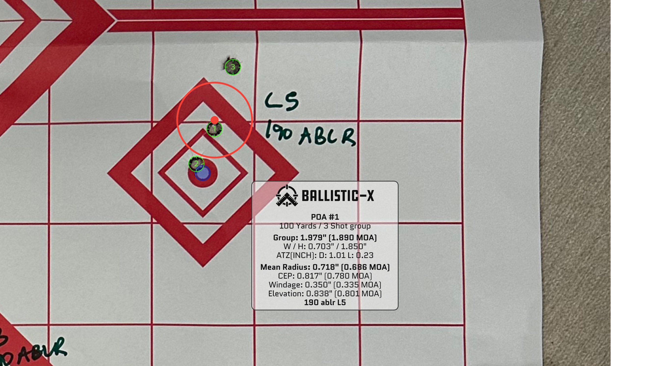

Testing R26 in my 20” barreled 300 WSM with 180 and 200 Accubonds, 200 Partitions, and 190 and 210 ABLR’s. So far I can get to 2800 with the 210’s, but it’s a 1.5” group. In my rifle, the best I’ve done is backing down to 2700 fps and running them .10” off. I have not length tested the 190’s yet, but loaded these test groups .1 off since the 210 likes it. I need to test further to see if the groups hold up or I got lucky. I got everything to shoot around 1 moa except the Partitions, but I’m looking for a consistent 3/4”. This barrel coppers up in the last 6” worse than any custom barrel I have; not sure if that’s hurting my groups yet though, just a bitch to clean.
Here’s the 190’s .1” off. Different charges of R26.
Not terrible, but just kind of meh. I can still hit an elk at 500 with it, especially if the .66” group can be replicated, but for the money, I had higher expectations. My cheap Aero 6.5 fluted barrel on my Solus shoots a lot better and cost 80% less and doesn’t copper up at all.
Good luck with your load development!
Not terrible, but just kind of meh. I can still hug an elk at 500 with it, especially if the .66” group can be replicated. My cheap Aero 6.5 fluted barrel on my Solus shoots a lot better and cost 80% less and doesn’t copper up at all.
