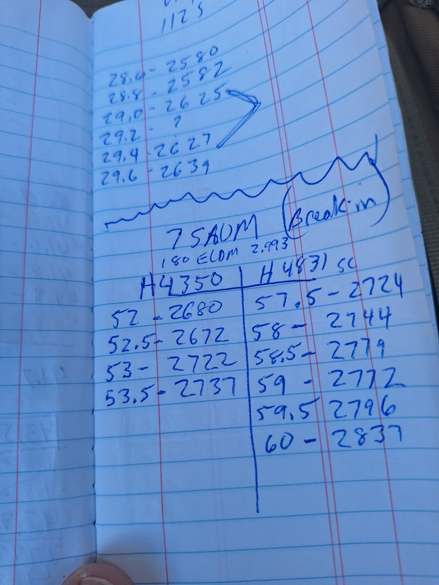

I know every barrel is different, but does anybody have a general idea of speed and Powder charge (H4350, H4831sc and possibly N565) with 180 ELDM I could start at with a 24” Proof CF in a SA Origin?
Finally got a chance to run out real quick and put 10 rounds down the barrel just to check pressure and speed.
I loaded 6 rounds of H4831sc and 4 rounds of H4350 with 180 ELDM at .020 off lands.
No pressure signs whatsoever, but don't really care to go much higher/ faster than 2837.
I know the barrel will break in and speed up a bit but not looking for crazy speed.
I just want consistency and accuracy as this will be my long range Elk and Deer rifle.

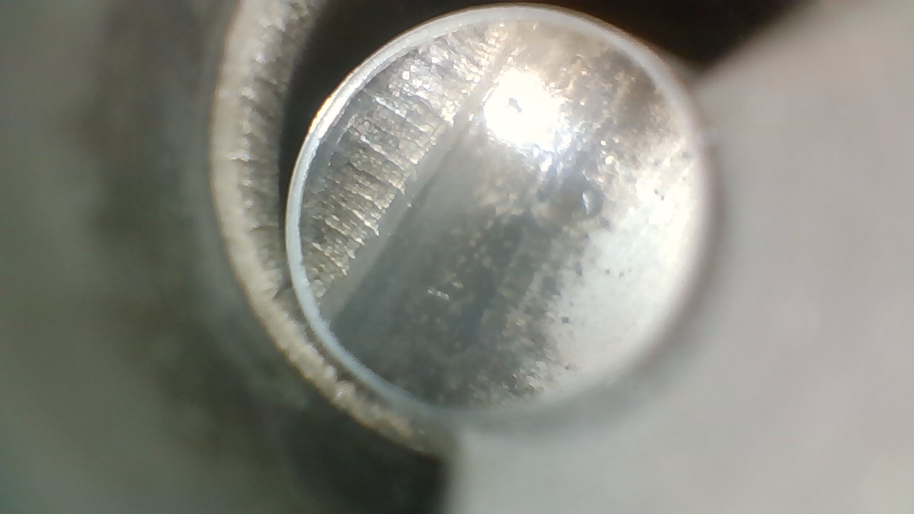

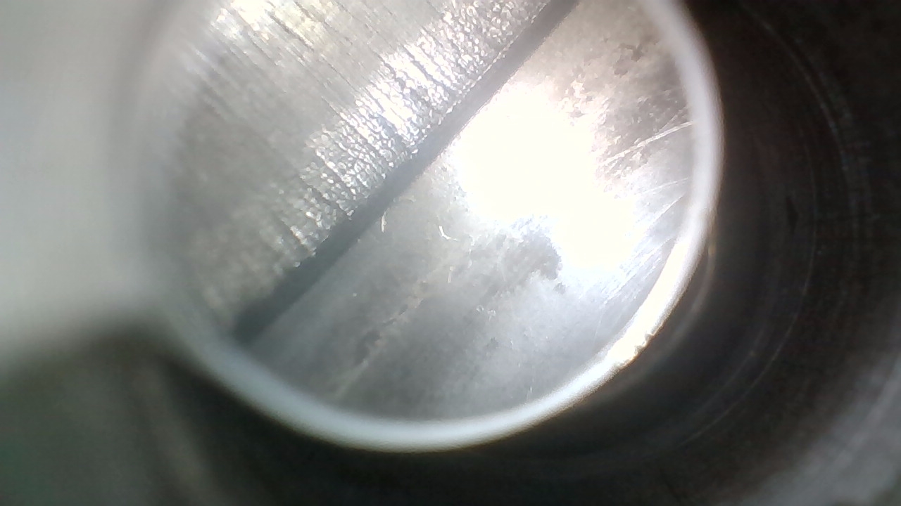

So being new to short magnums this wasn’t something I was expecting. I had sudden velocity variations and excess pressure signs. I’m of the clean less brigade and the rifle had seen 100 rounds by me. This was a secondhand rifle with several owners and I bought it on this understanding with a view to shooting it to see what it was like before a re-barrel. I have two bartlein carbon blanks ready and waiting. Luckily I own a teslong borescope and identified the issue carbon ring. I spoke with my gunsmith who told me it’s a known issue with the short mags. Scrub it out and you should be ok, I’m yet to shoot it. But thought it would be well shared. Before and after photos attached. There will always be wear and tear.
