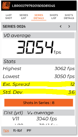

Played with the load today. Shot over my chrono and by my buddies labradar. Found my best load for the 162's. 3210 fps average with 13 ES and 6 SD according to the LabRadar. 3218 fps average with 12 ES and 6 SD. This was at 64.1 grains of H-1000 .005 off the lands. Shot 2 groups of 0.25" @ 100 and one group of 0.20". Going to 1,300 yards next weekend will report back after that.
The 65.5 grain load (same as the 3327 load from last week) was 3301 FPS average 31 ES and 13 SD with Labrador and 3319 with 28 ES and 13 SD on my chrono. So no malfunction on the chrono's part. Just a slick barrel I guess. 3 groups were all between .3 & .45" No pressure signs at all.
Going to go with the 3210 load due to the group size and SD. Loading up 50 for next weekend. The other 50 will by my 180 Eld load going 2930. Depending on how they perform I'll narrow down to the more accurate load then try for 1,760, 2,000 and 2,500.
