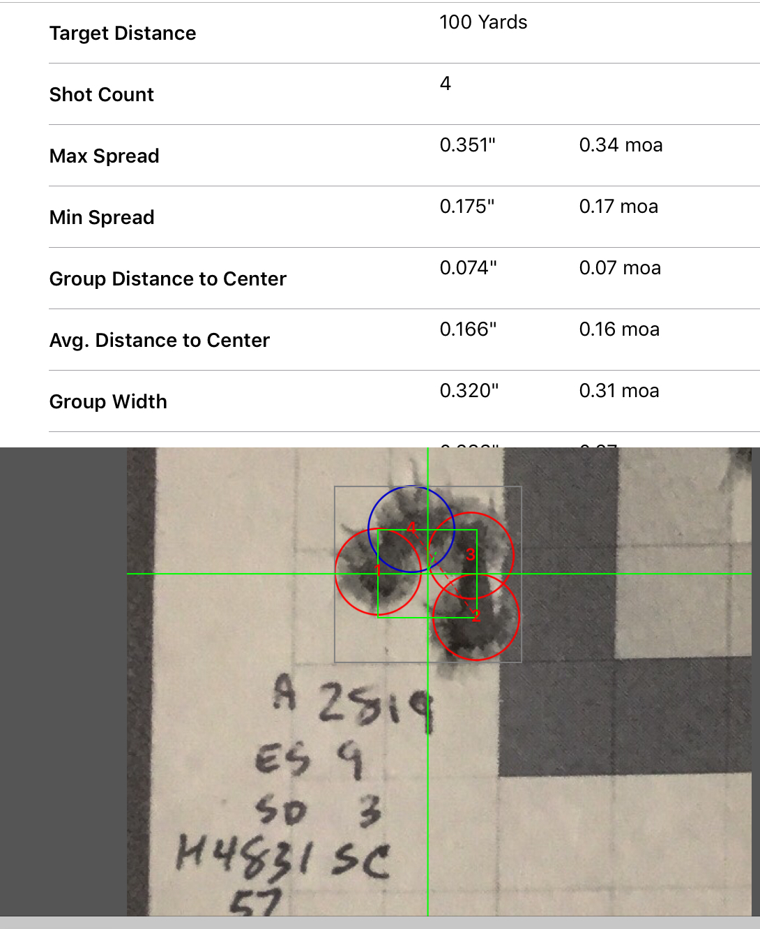

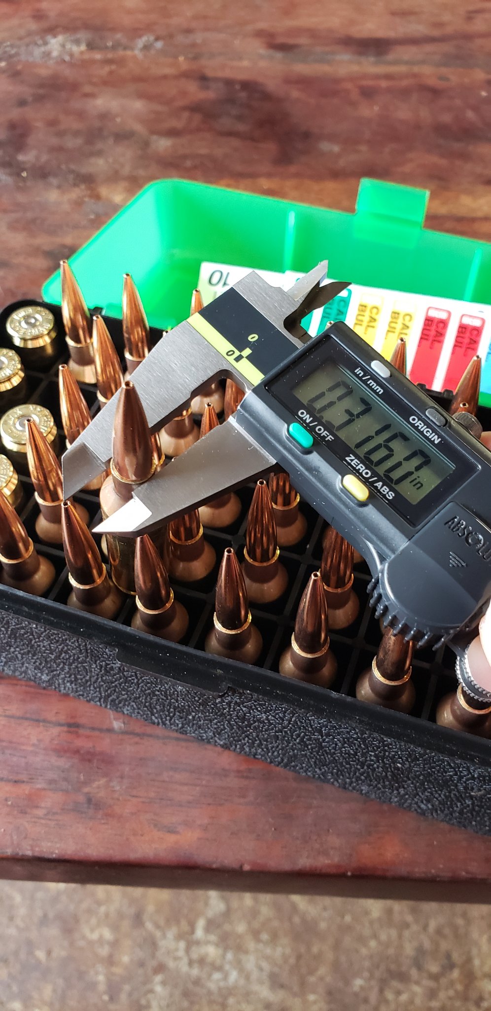

This is with a .188" freebore reamer, case OAL of 3.020". If you push the bullet in the case more, lighten up, farther out, maybe up charge.
First one start, 2nd upper end.
I shoot 180 hybrids 8 off the lands, 210M primer.
Crap, they are backwards, not redoing.

im loading 180 hybrids with n565 now. 60,7 grains, 79mm col. getting aruond 904ms on a 74 cm barrel. i tried 180 eld but it wout not gruop a bit, got pressure signs aruond 64 grains with the 180eld, and aruond 62 with the 180 hybrids.
im using norma brass and a tikka action with a lilja 1-8 barrel
Reactions: gnatmm
180 ELD-M
Norma brass
Fed LR magnum primer
57 gr H4831SC
COAL 3.08" (0.02 jump)
MV 2819 ES 9 SD 3
26" Benchmark barrel/DTA-SRS

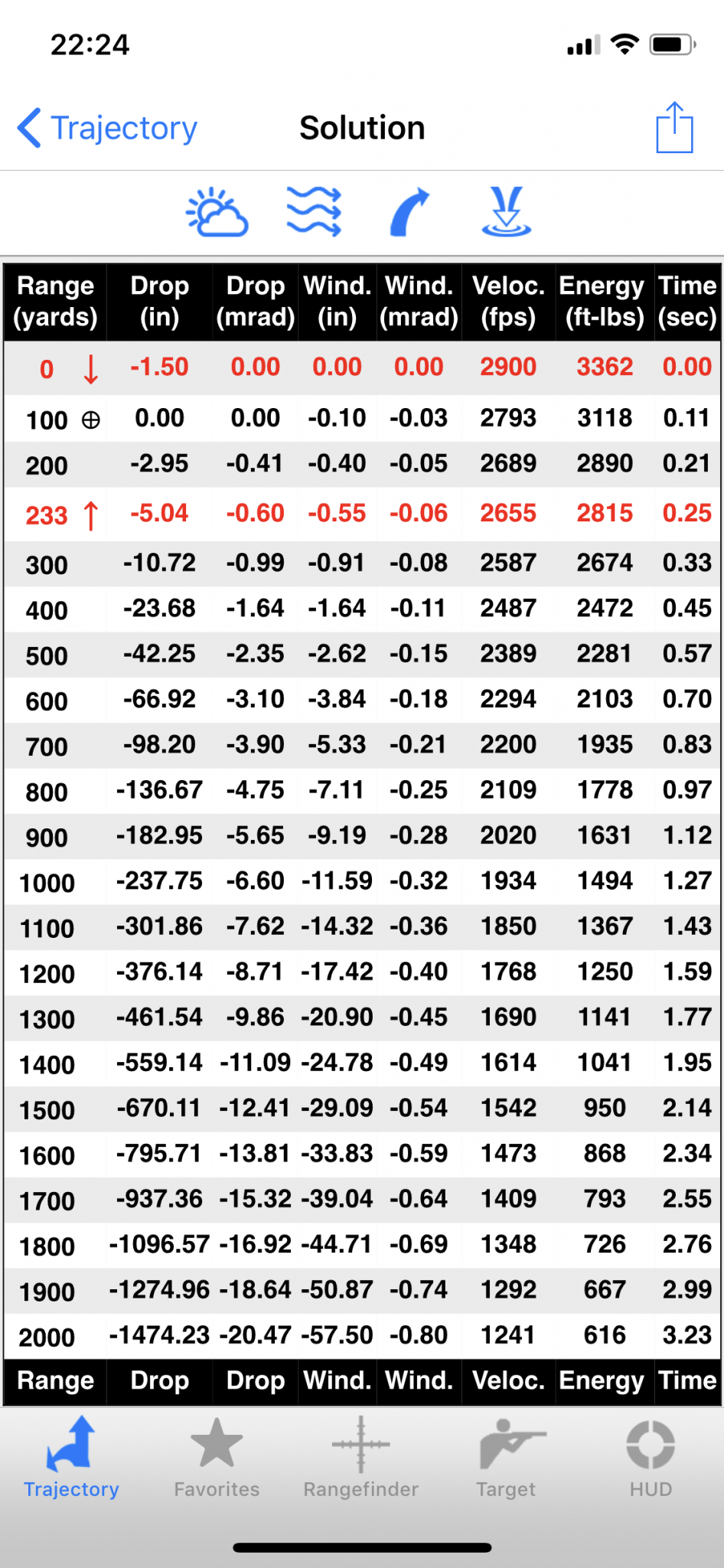

Here is my data for my 7saum with h1000 running 2900fps. It’s plenty with those bc’s

at 2.920 that bullet has to be way down inside the case. as much as I wanted to, I didnt have any luck with the 180eld in my short action. I assumed it was because the bullet was so far into the case. actually past the shoulder
I don't have any issues. I shoot 197 smk at similar numbers... out to 1600 havent had issues. This is a .040 FB...

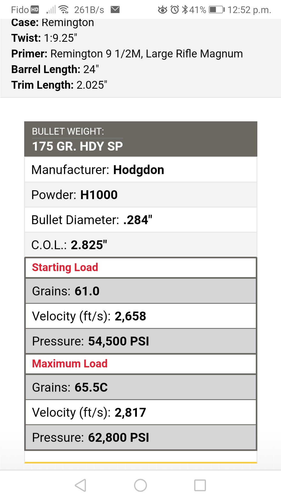

Are your H1000 loads compressed?

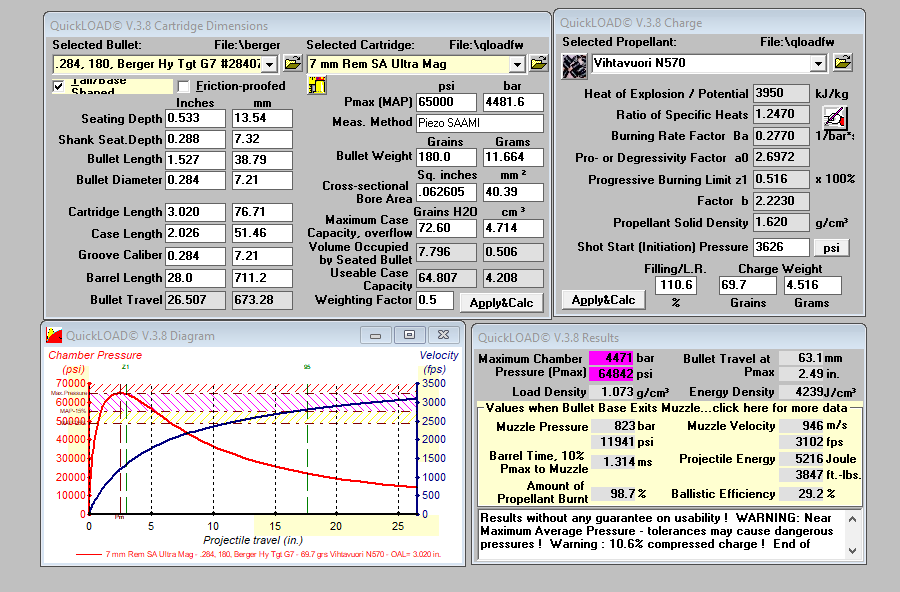

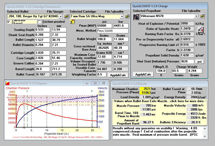

Hey can anyone with Quickload run numbers for H1000 and 175 Eld-X and 180 Berger?
I noticed some of my brass at 64.5 load had some faint "smileys".
This was virgin Rem brass full length sized brass.
I am going to bump the should back and size neck with Lee Collett.
Going to back off a full grain and work up to 64.5. after 1st firing.
Primer pockets on 64.5 gr load seem just as tight as factory case.
Loads at 65 and above had stuff bolt lift and pockets were noticable loose.
yes.
barrel sped up a lot so now to get 2900 with 180’s load is now not compressed. It just barely pushes on powder which I think is perfect.
2900ish with H1000 and 7977 really shoots well with low SD so I’m staying there.
I did get to a bit below 3000 before I had pressure starting to show.
From Hodgdon reloading data...65.5 C is their max load for 175gr.
I got to 64.5 of H1000 loaded long.
No way I’d get it in at mag length.
Velocity was 2940 but that was well before the barrel sped up so it would be 3000ish now.
