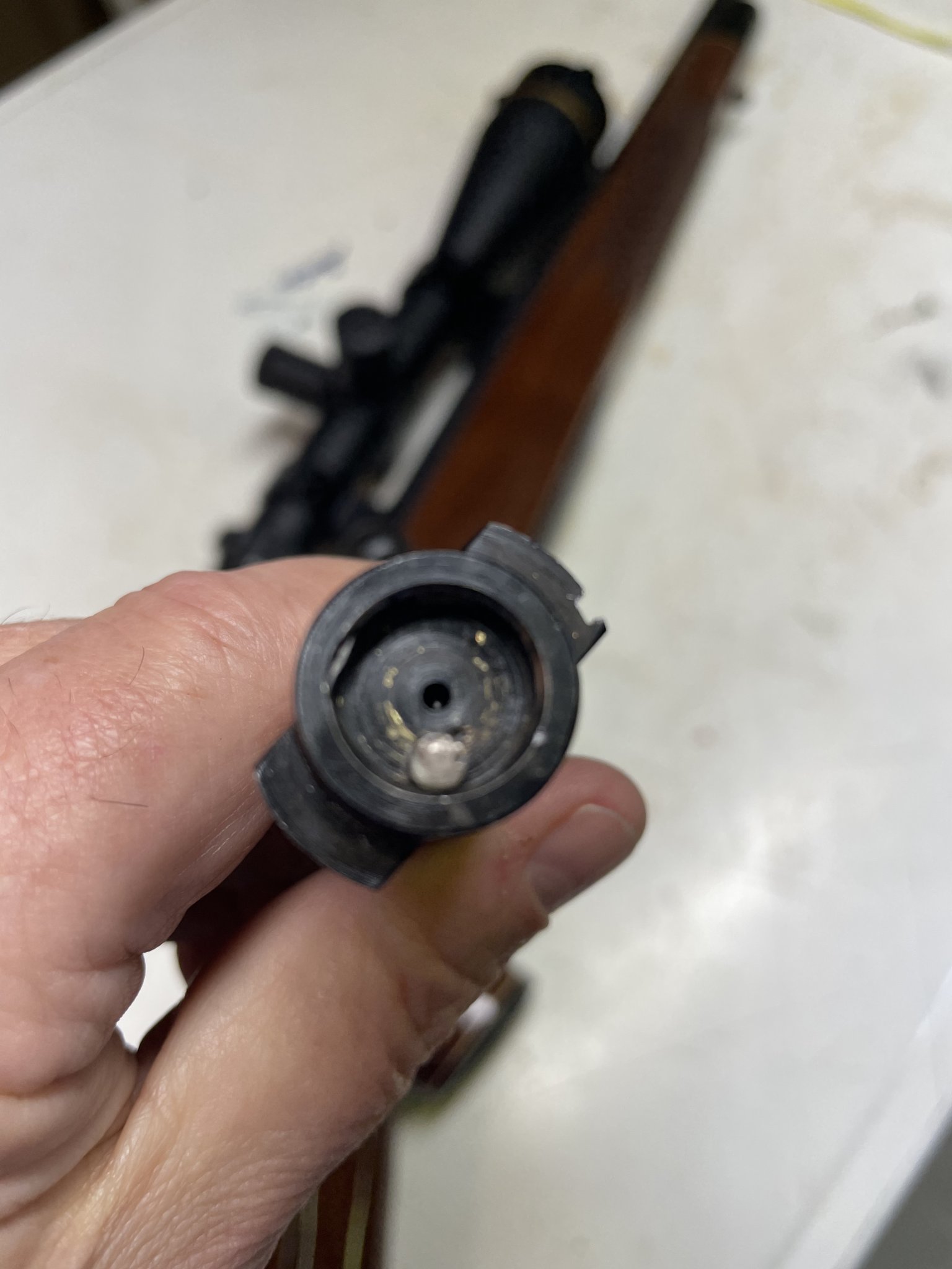

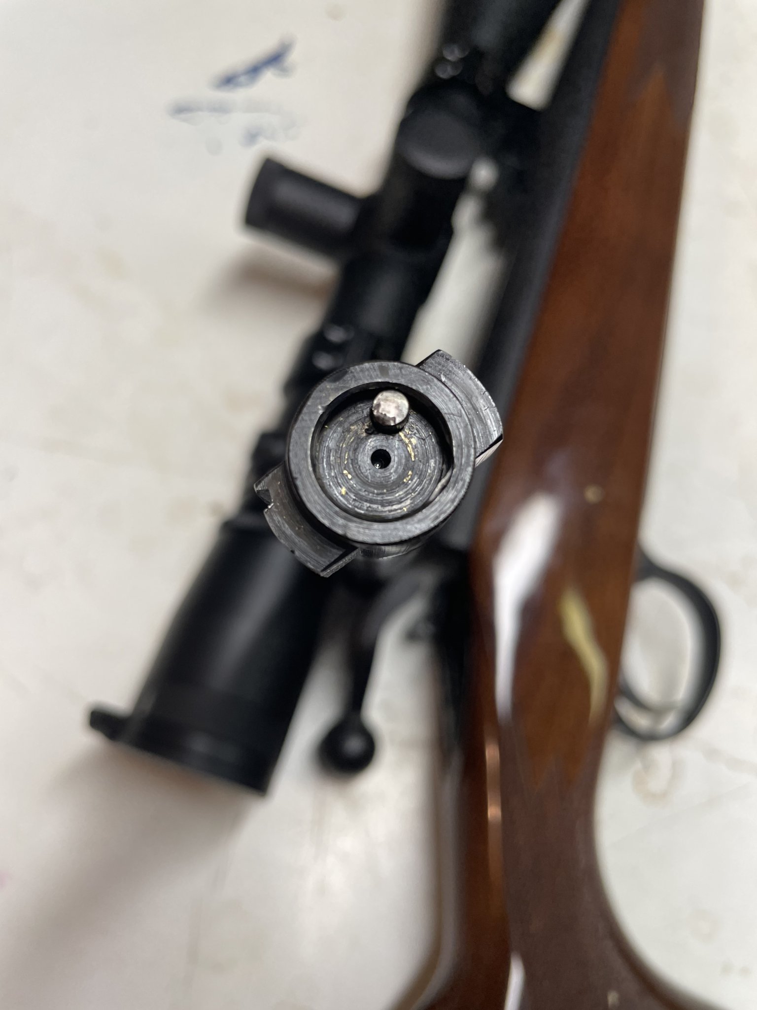

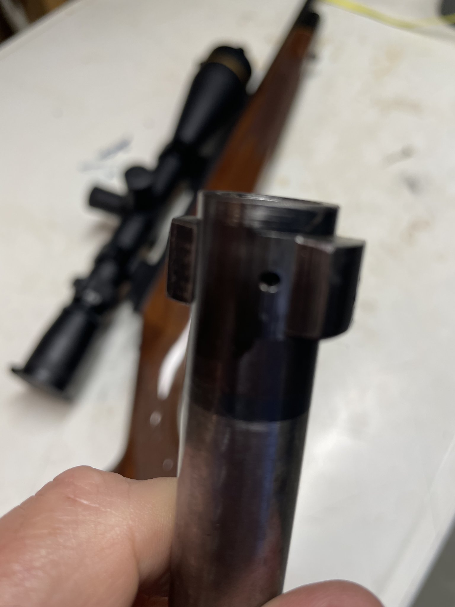

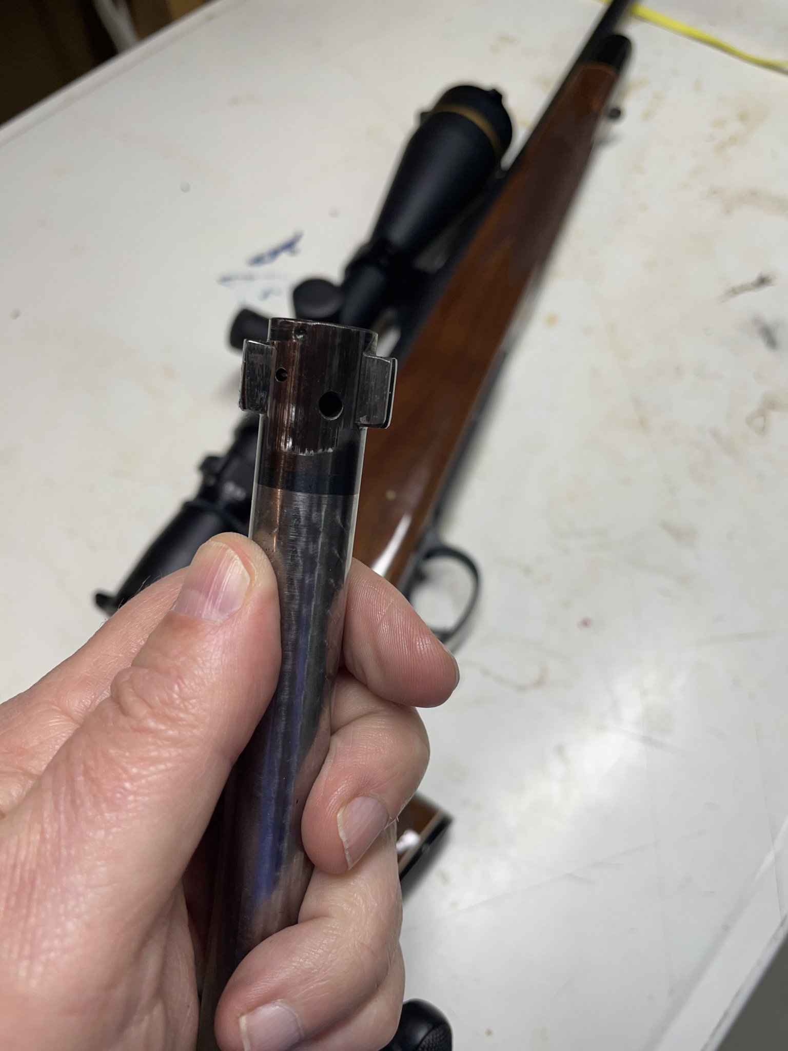

It looks like your primer leaked and now it sounds like your ejector and spring are damaged. What does the bolt face look like?
You say you have to tap the shell casings out with a cleaning rod now? Is the extractor still in the bolt?
I think the extracted is gone? Right?
Replace that bolt, gunsmith will know specifically what to do but in those pics, bolt face, ejector, everything looks trashed.
I’m not a Smith but prob not that expensive and no big deal. Maybe a few hundred total (just a guess) (bolt plus parts, head spacing, etc).

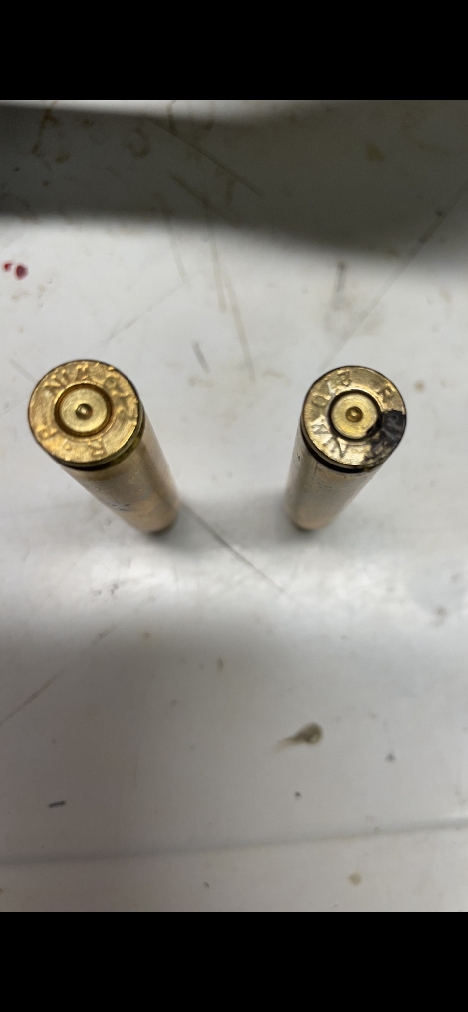

The case on the left has a major ejector swipe. That load was WAY over pressure, do not shoot that load anymore!!! The over pressure load has damaged the ejector and transferred brass onto the bolt face. New ejector and spring plus clean up the bolt face at a minimum.

Ok it was a factory 270 Remington core lokt load… just foulers and it did this damage
