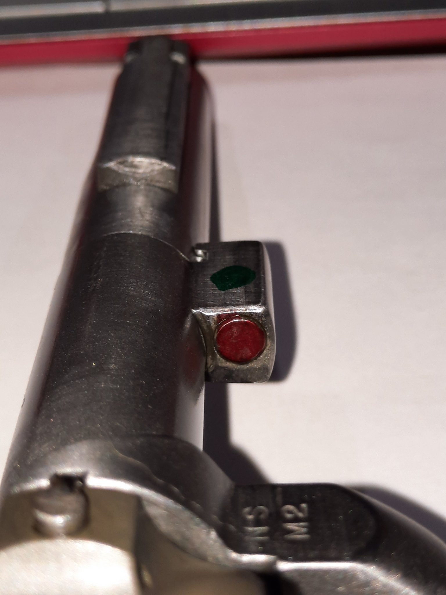

As I mentioned before, my 1922 has a hardened plug illustrated by a red dot in the last image. It's bolt is soft.
Is it a forging? No idea but it isn't hard.

My 1922 lug is ~ .285 sq. inch of cross sectional area in direct single shear. It has rearward force is under 1K pounds given the 24 psi. max
chamber pressure for .22 LR bullets.

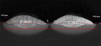

Virtually anytime people talk of welds, don't they complain about lack of penetration and weld that sits on the surface like dog crap?
Whom here has any life experience with GTAW? Do you guy's have any idea how much control you have over the heat and the weld depth
when using GTAW?
Do you know that a simple change of shielding gas can change your depth. Do you have any idea what a copper chill is? Or a heat sink?
The stand off or CTTWD has an effect as does the direction of weld path and tungsten diameter. The electrode angle and speed
and even the shape of weld. A weave pattern penetrates less and can cover a wider area.
Imagine moving a propane torch back and forth to control the heat from becoming excessive. GTAW is simply electric heat.
Polarity makes a significant difference because the energy flow is directed into the part or from the part into the tungsten electrode.
We would want to go from the part into the tungsten to minimize the heat and arc blow. I can use a 1mm tungsten and weld at low amperage,
like 10 / 30. I always use the adjustable rheostat and high frequency. The rheostat is just like your gas peddle in your car. It allows you
total control through out your amperage setting. Take a look at a ten or fifteen amp fuse in your fuse box. Look how fine the filament is that
blows..... the welds HAZ would be very shallow by design and technique.

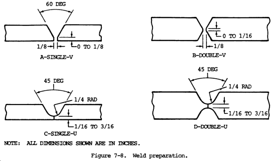

To get good penetration takes a lot of prep. They don't spend all of that time and money to get penetration if they didn't have to.
Look how much pipe they have removed to get full penetration at the weld root. Thats both ends at every joint.

It's only a guess but I would imagine my 1922 bolt to be ordinance steel like 4140. Annealed 4140 has a tensile strength of 95,000 psi.
It's shear is less.
Lets use the weak annealed 4140 material, nothing exotic.
4150 is 106 ksi. in the annealed state.
4340 tensile is 135 / 160ksi. in the annealed state.
when using GTAW?

Said in jest or not, Im2bent is correct, I would make it a surface weld with very little penetration using various techniques.

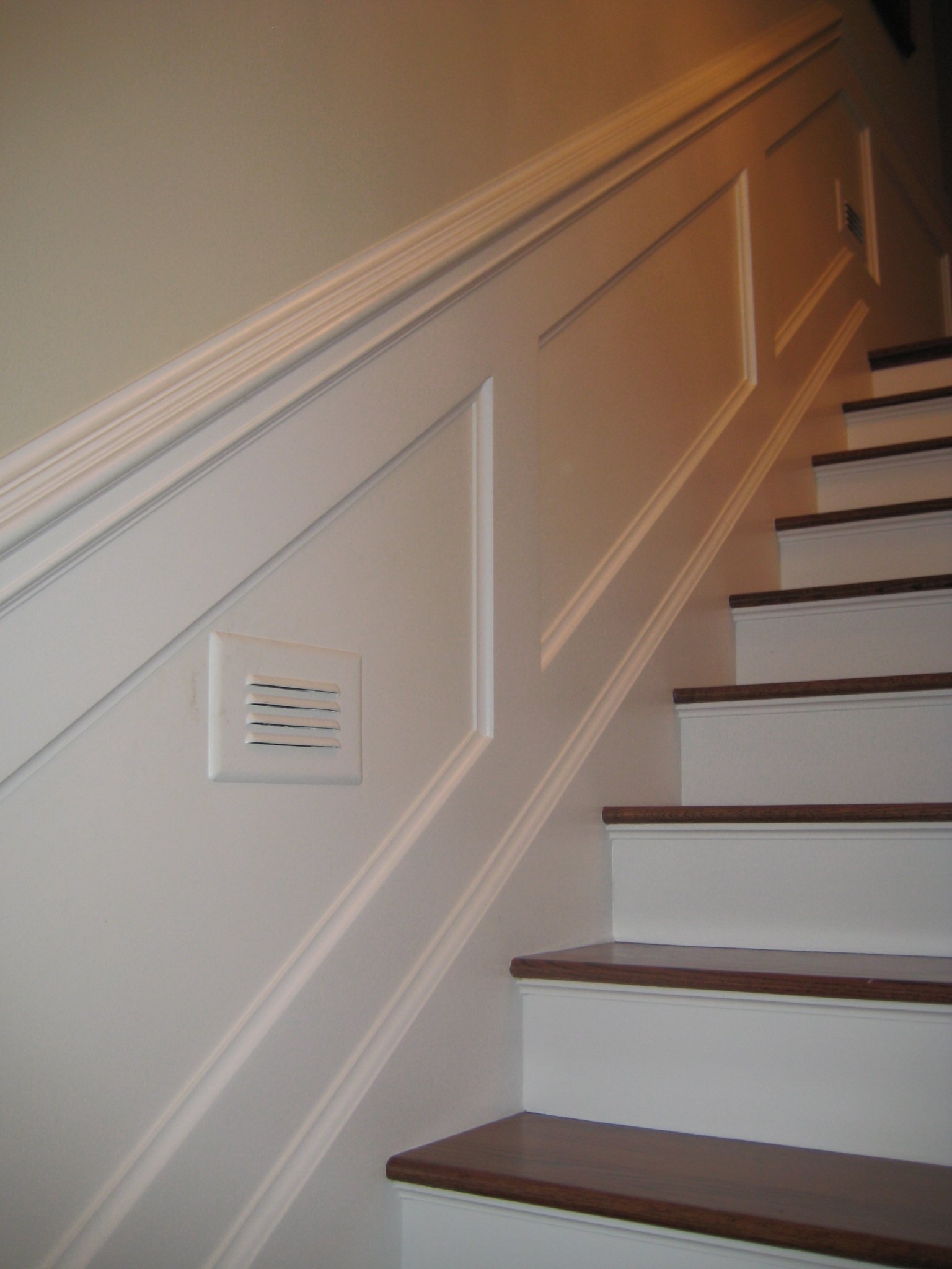

My wainscoting has splines, beach biscuits, glue and lots of 20 gage pins. most of It started as 49" x 97" MDF sheet.
About 400 feet of it. Scribing four sets of stairs was interesting. The top step on this one was an inch high.
I'm not a wood worker... I just do things because I can. Hidden under my base board is the original base. The home was

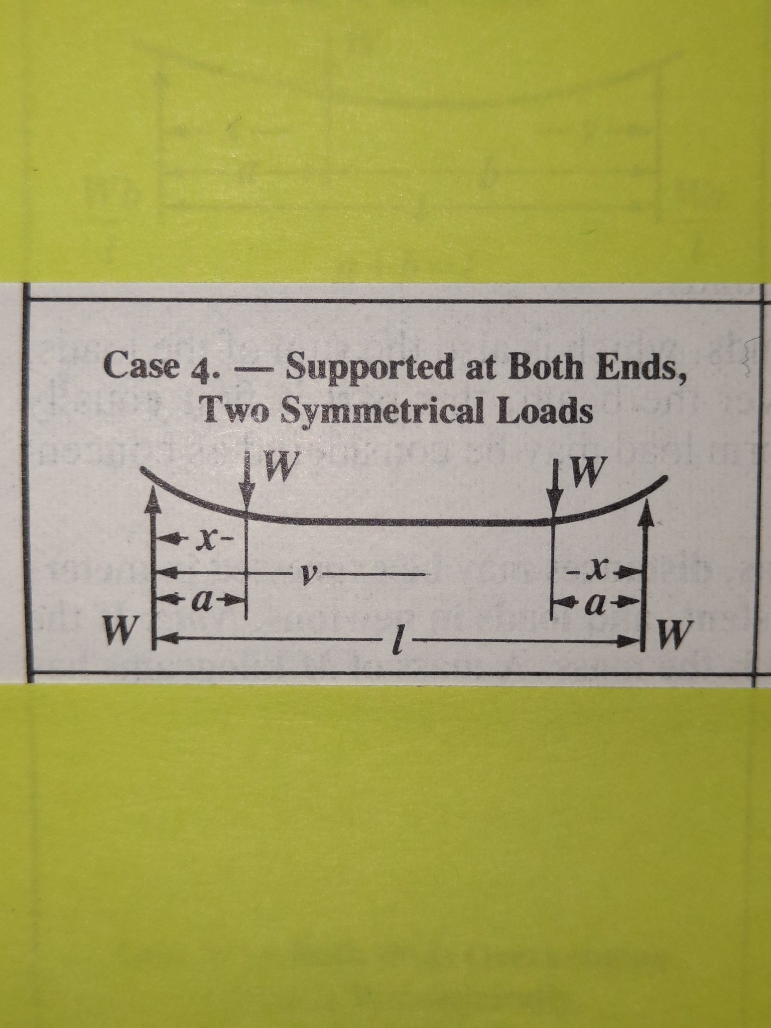

The 48" long x 2.5" diameter CRS shaft from this problem had a maximum deflection of .125" That is simple math...
is that too much?? Who the hell knows?? When that shaft broke and dropped an 8000 pound tool after being in the field for only
two months, it's a good bet it was over loaded.

be that way. Any one with any math skill can use case #4 and verify my maximum deflection at center dimension.
L = 48" .... W down = 2000 each side..... a = 5" Maximum deflection at center is .12". That's a memory from 2002 but it's accurate.

allowable deflection based on good design practices is .010" per foot. He would respond.... I know that. He doesn't know that. Over 90% of the
1000 designers and engineers at COMAU don't know that. Finding and doing the formula is pretty straight forward.
If you knew how many designs were based on, that looks good enough, you would be shocked !!
when using GTAW?
I don't think some small weld beads to build up the surface height would be difficult or cause problems. .030" tall or less would more than he
needs. How do they thermal spray weld the journals on that crank shaft without getting distortion or causing metallurgical issues?
Still, this is an academic discussion because it wont help the OP other than give him something to mull over and read on the web.
4.5 million $ and not mine. :-(
