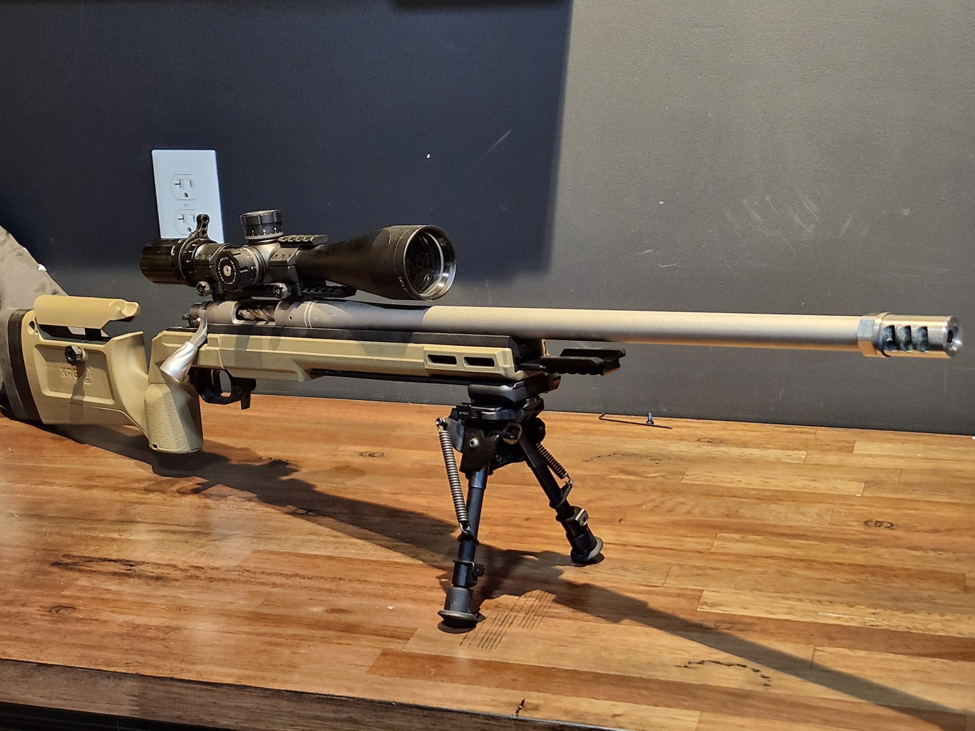

Ok you guys have me curious now to find out what mine is for sure. I bought a PSS from SH years ago that has been worked over a little bit. It's stainless, 20" barrel, oversized bolt knob, fluted bolt, and I'm not sure what else was done. It has an "S" first in the serial which I believe is a '98 model if I recall correctly.
It's a 1/2 MOA rifle with FGMM with me shooting and I'm not the best at shooting groups. I have it in a Bravo chassis and really enjoy this rifle. But where do I go to find out exactly what it is? Also, did they make any in 20" or was it cut down?

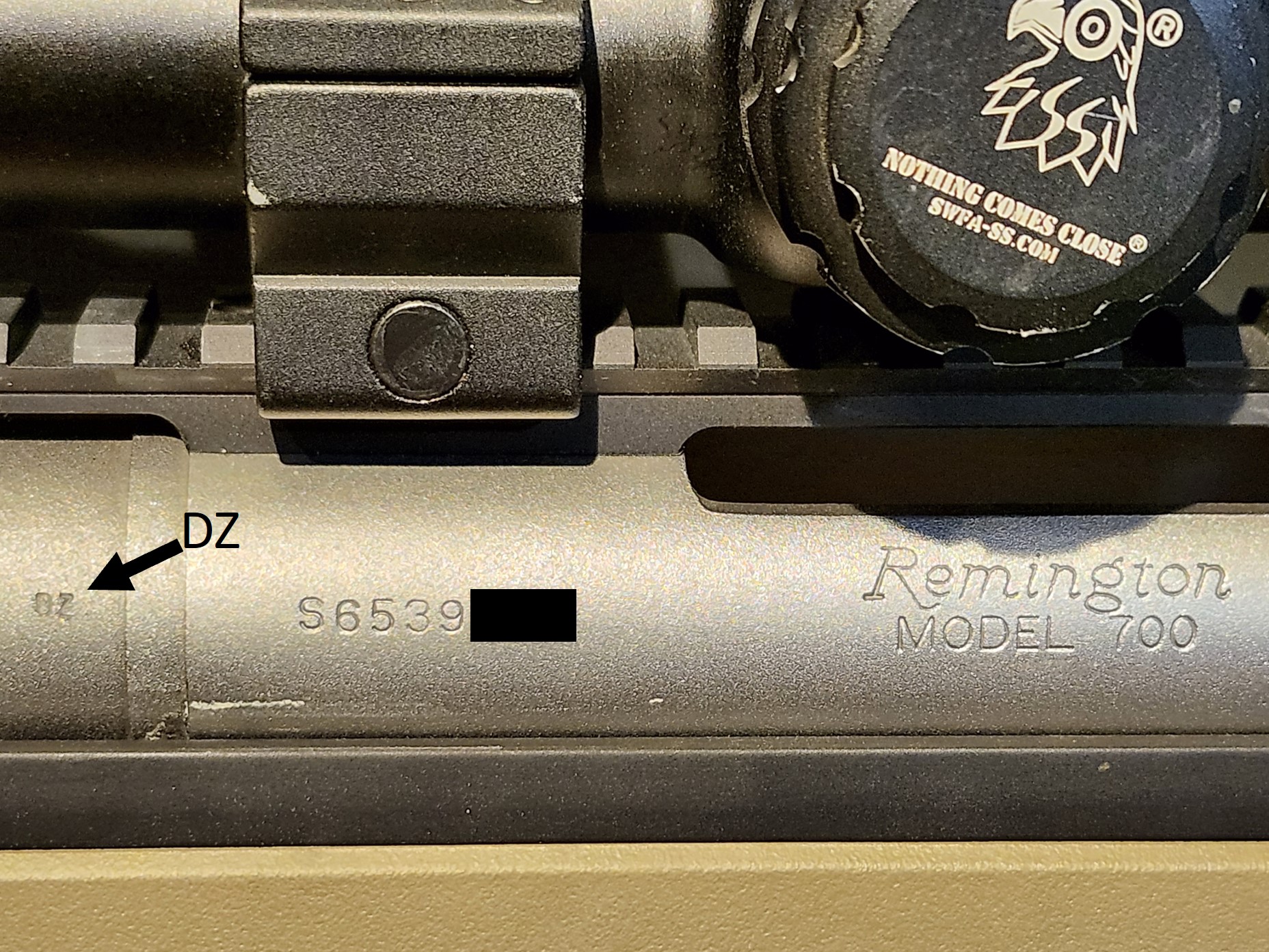

Going by that, mine might have been made in Sept 2005. It has DZ stamped in the barrel and S as the first character in the serial. I'll get a couple pics up...

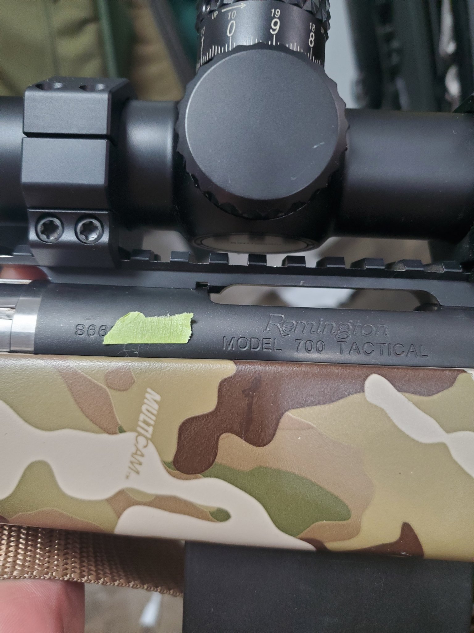

I had several xcr LR and they all started with S also and have the square cut out on the bottom of the reciver like you said. 99% sure they didn't even make them in 1998.

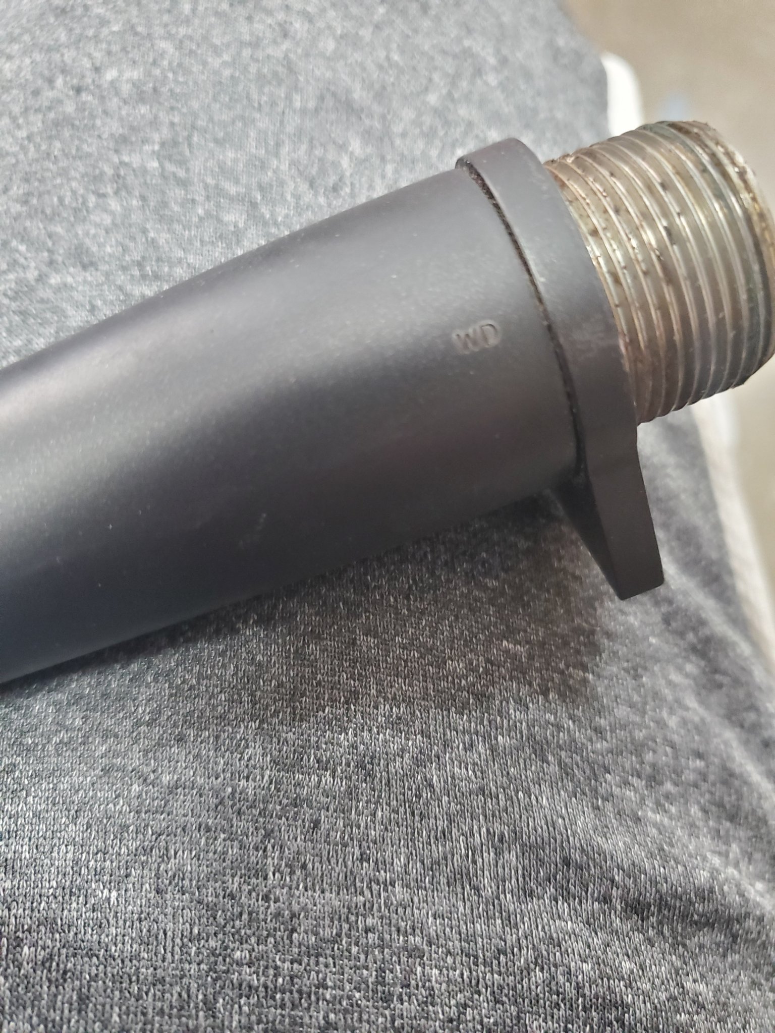

I hust dug out the old barrel date code it WD.
Was all the new RR stuff after Remington changed hands? Did they change the way they did serial numbers at that point?
I hust dug out the old barrel date code it WD.View attachment 8342747

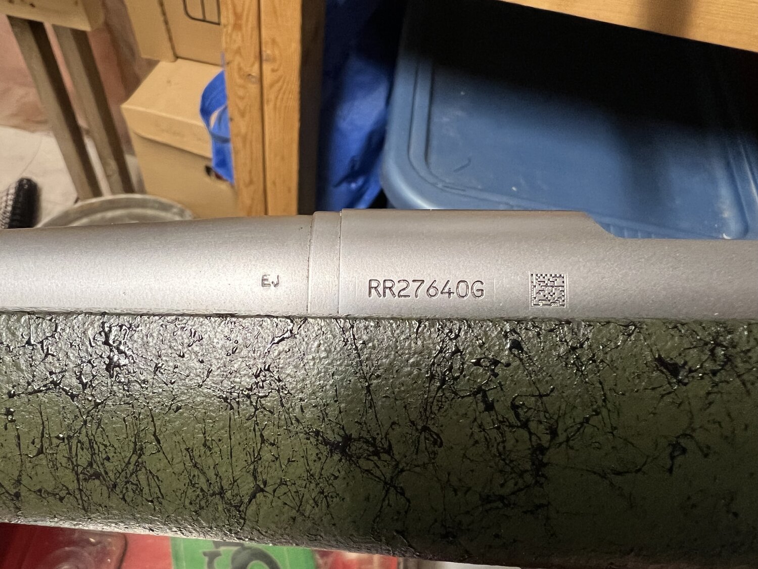

Look at the photo I posted. That's an RR receiver date coded to 2015. And it has a QR code

The barrel date codes are different than the serial numbers. So an S prefix on a 2 letter barrel date code would denote a year, but an S prefix on a serial does not. There are stainless actions that do not start with an S serial. The 5R Gen II’s were notorious for it. I have never seen a S prefix rifle that wasn’t stainless though, and I’ve seen my fair share. Some of the 5R Gen II’s actually have S prefix serials.

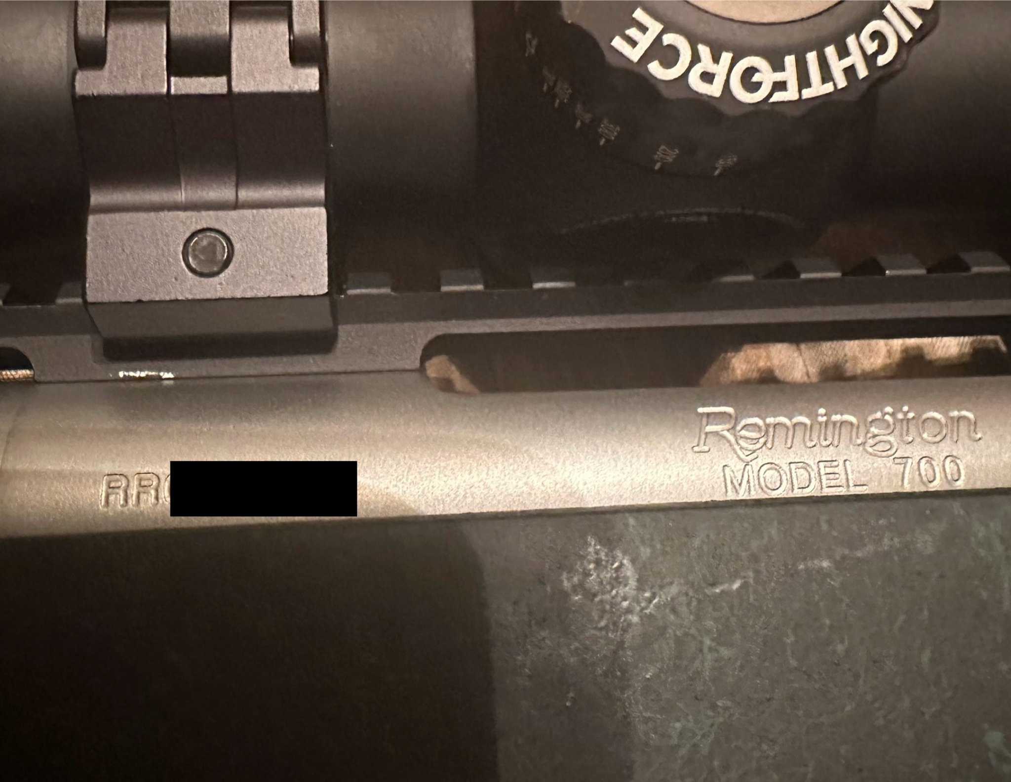

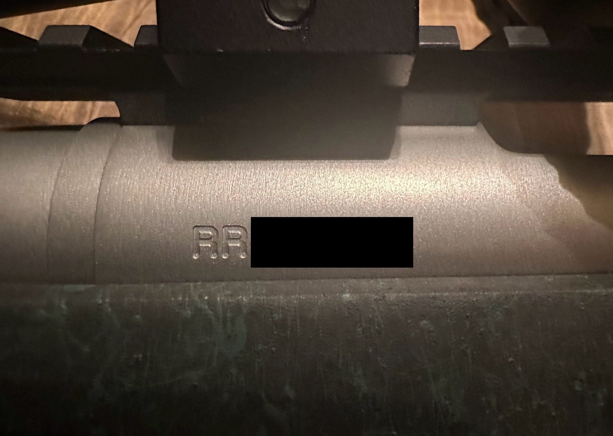

All that aside, the best way to tell is this:
(The receiver pictured is an RR prefix btw)
At the end of the day it’s all generalities though, Remington was notorious for doing whatever they wanted whenever they wanted and not maintaining consistency even within models.
Show us one.

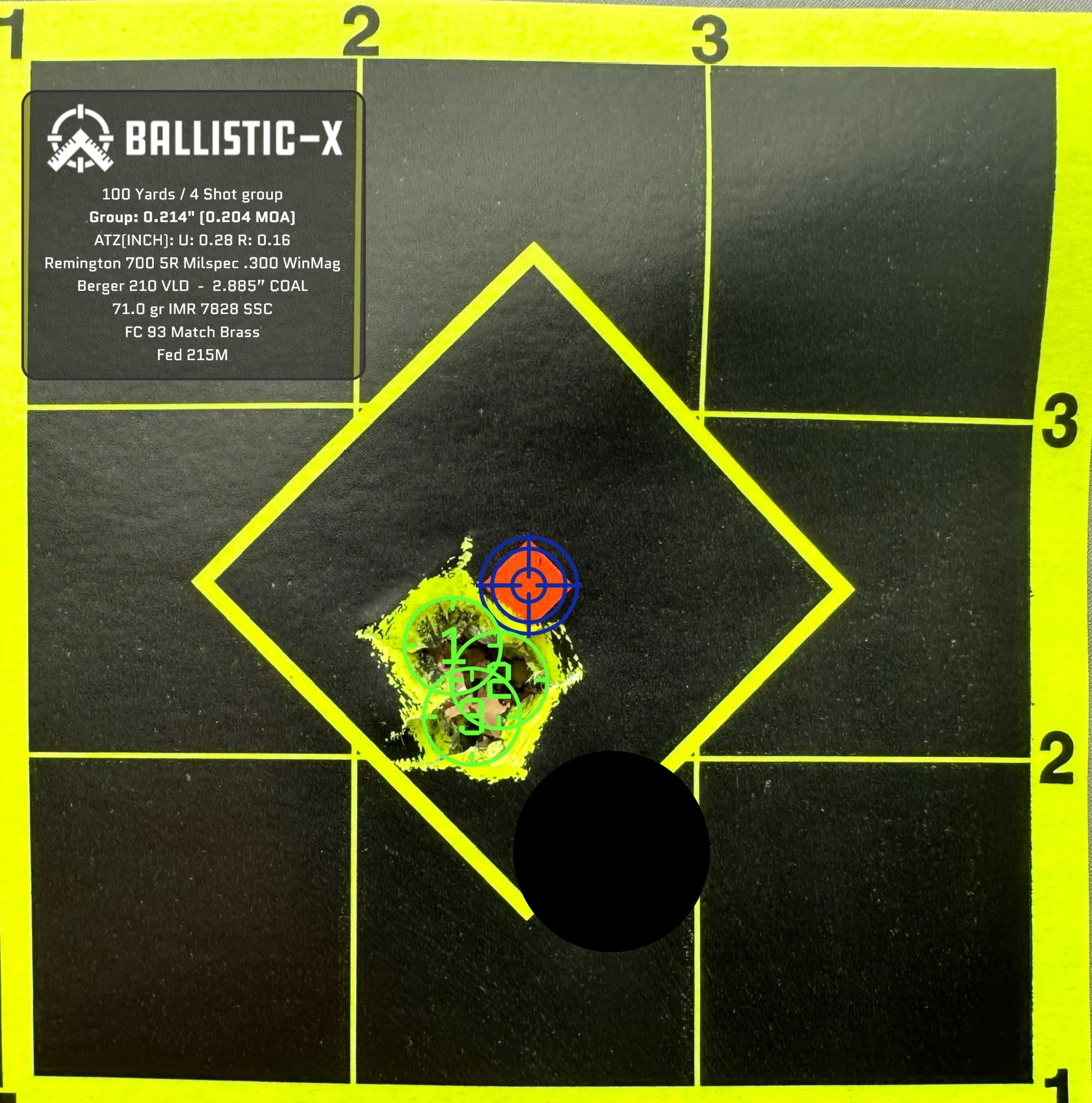

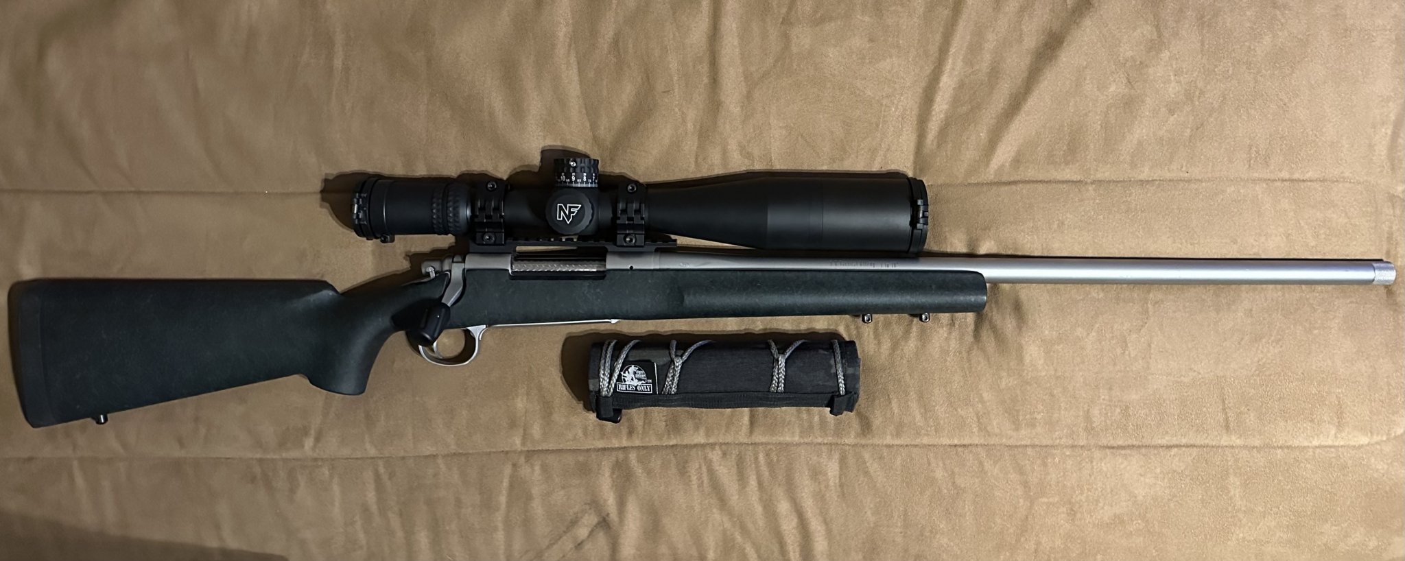

Here you go…. Circa 2010(ish) Gen 1 5R Milspec 26” .300WM with an RR coded stainless receiver.
So, according to what was said earlier, that means this is actually an M24, but with the green HS stock and new RR (Replacement Receiver) 700 action built by Remington’s M24 Shop in order for them to send the Army’s registered actions back to them, right?
Well, that would certainly explain the regular 1/4” groups @ 100. 😂
And little did I realize until today, that setting it up with the 20MOA rail, and NF ATACR F1 5-25 MIL-XT was actually somewhat “correct” for the build.

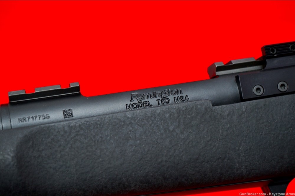

Anyone got a magic phone that reads QR codes?
This is one of those re-issue commercial M24 builds with the RR- prefix, G-suffix, engraved Remington 700 M24:
Any modern smartphone should be able to read it. I think you just have to hold it up like you're taking a picture of it, with the camera app open, and hover it in front of it, and it will automatically pick it up, and ask if you want to open it up, or it might open automatically, depending on how it's setup... Give it a try.

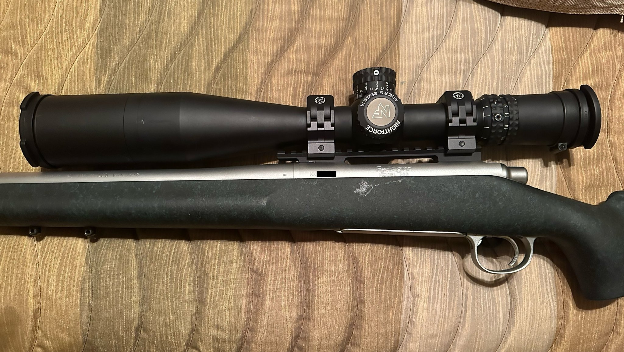

View attachment 8343103View attachment 8343104View attachment 8343105View attachment 8343112
So barrel code KH, hard to read but that's what I see, gun made May, 2013. RR prefix serial number doesn't indicate year of manufacture.
