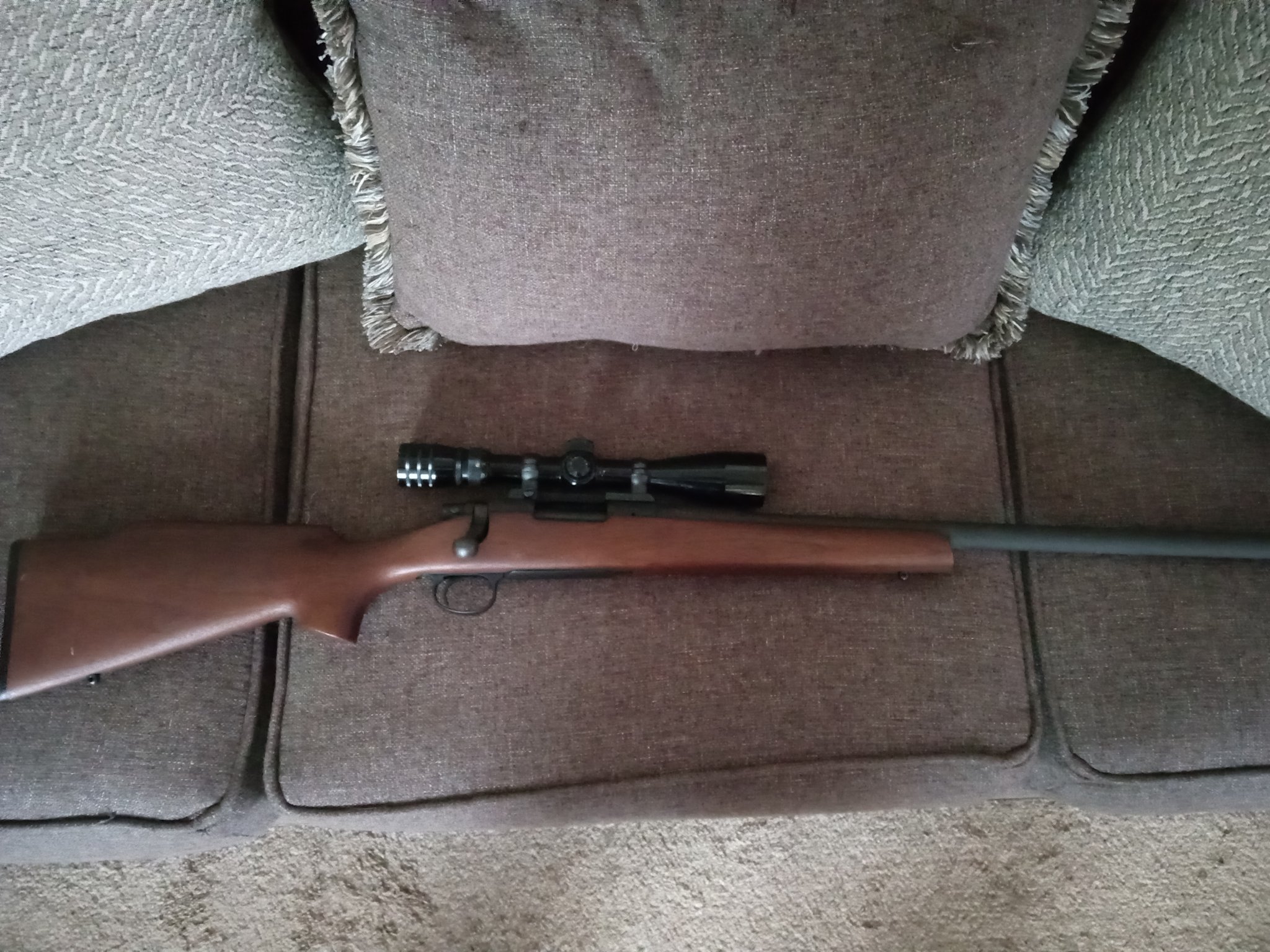

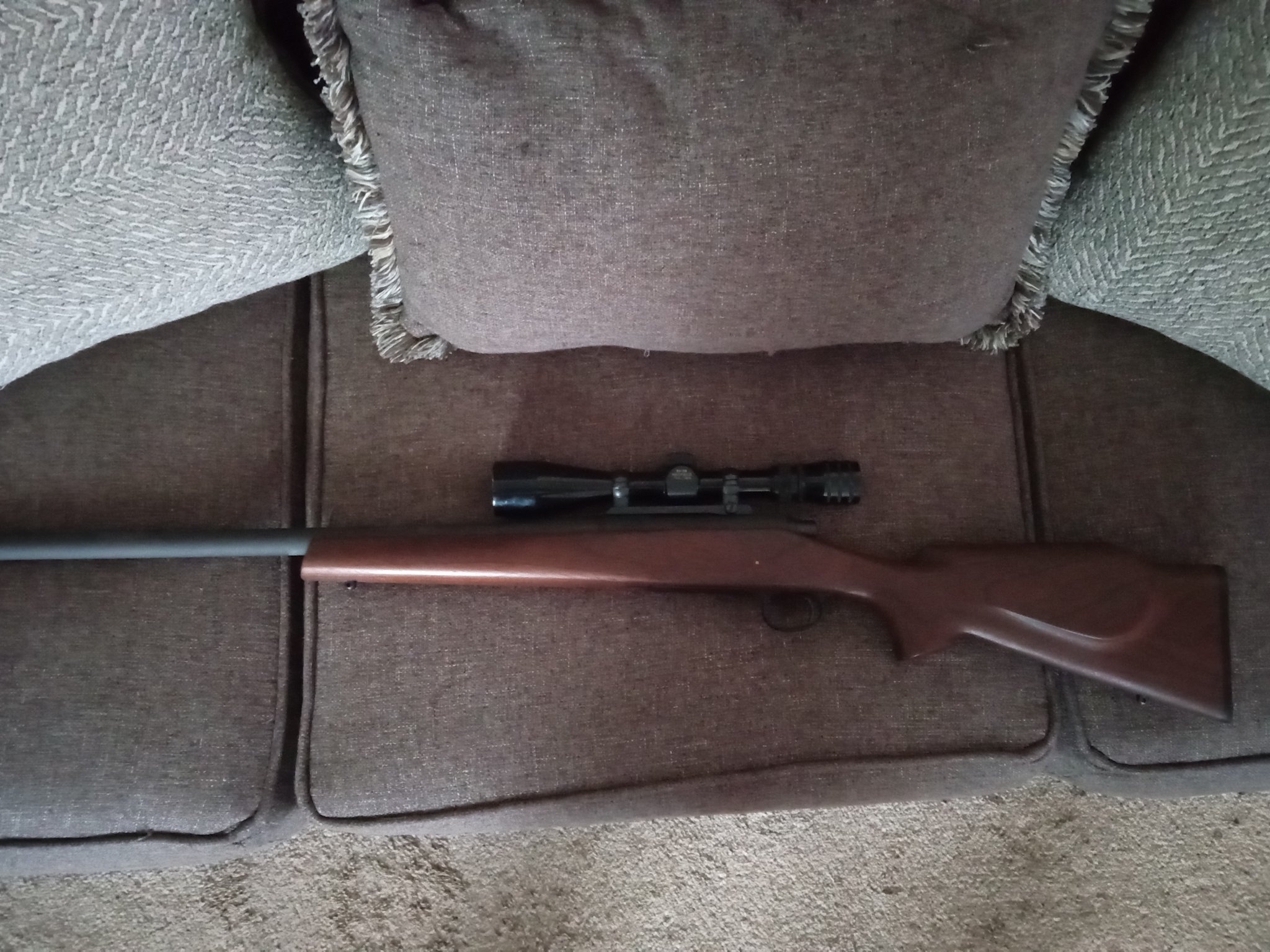

Here's a couple pics. I threw an old Redfield Tracker 3-9x on there I've had for years. This is just temporary to put holes in paper to see how it groups @ 100 yds.

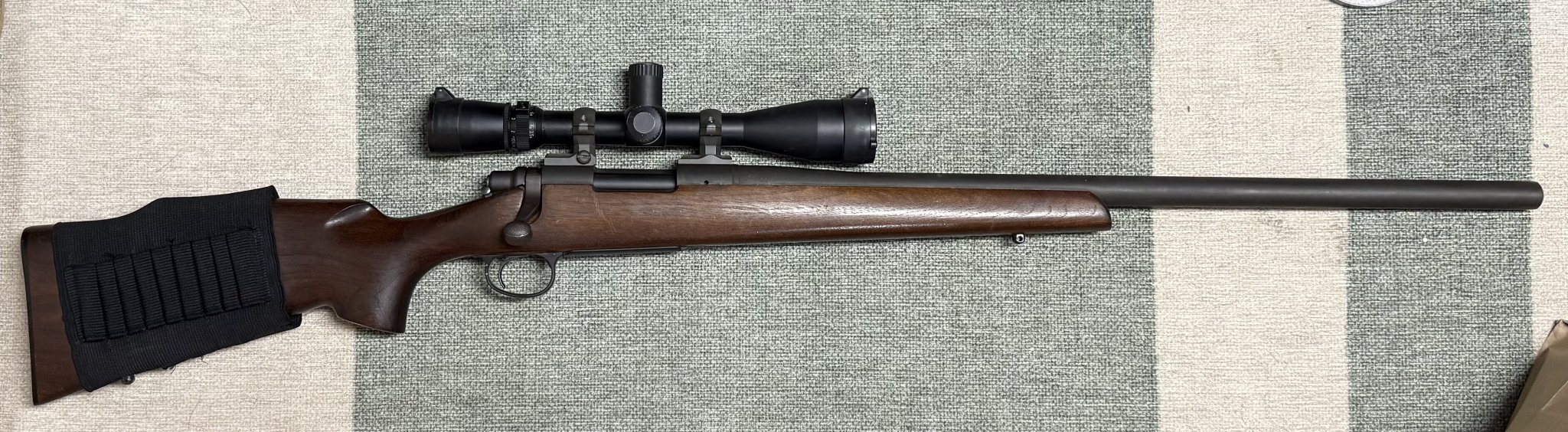

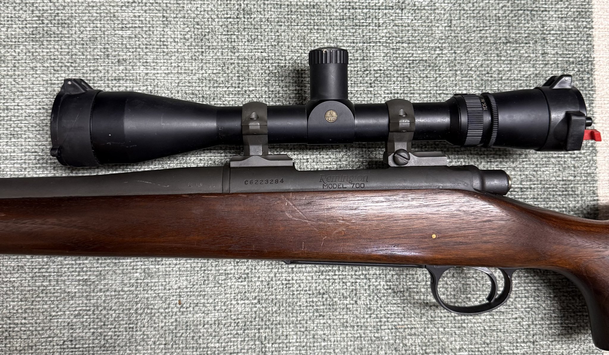

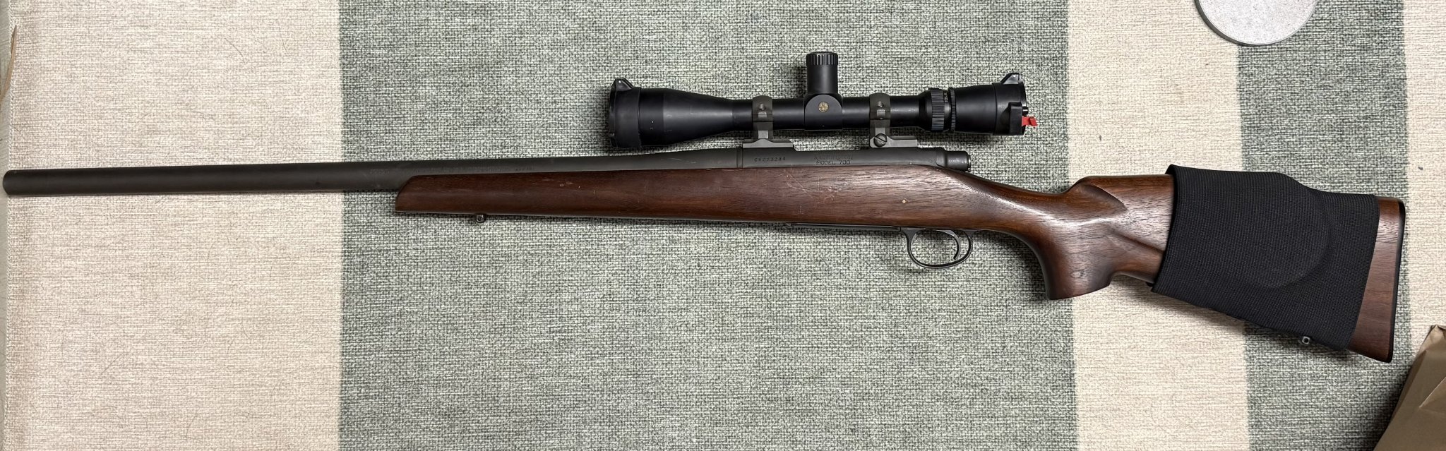

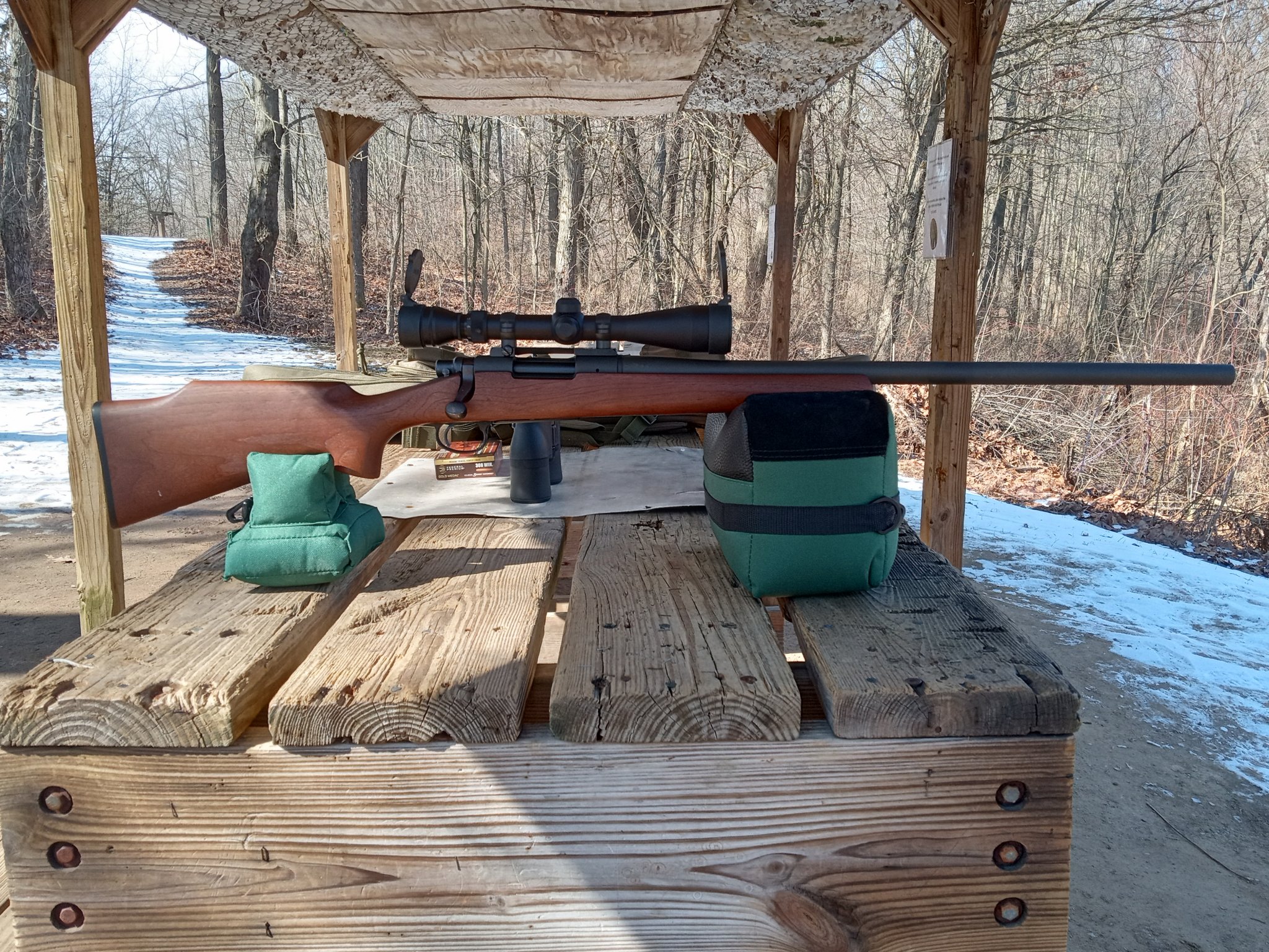

Happy George Washington Day....Range Day...I replaced the Redfield Tracker with a Hi-Lux 3-9x (I know, I know, but until I can find and afford an actual Redfield Accurange 3-9x, this will have to do....even if it is a sin) But much better results today. The first group at 100 yards wasn't bad, just a little high to the right. After 1 adjustment, it shot a decent group on paper. I'm happy with it. Stock is unbedded, rifle front sandbagged off the bench. Federal GMM 175 grain. Comments?
Comments?
I would post in the SH Vintage Sniper forums for help on the parts you are looking for.
The only other thing I would do, is take Denatured Alcohol and wipe the whole stock down real good and then recoat it with linseed oil. It will bring back some shine to it and reseal the wool from moisture.
Other than that, she looks really sweet and shoots well for her age.

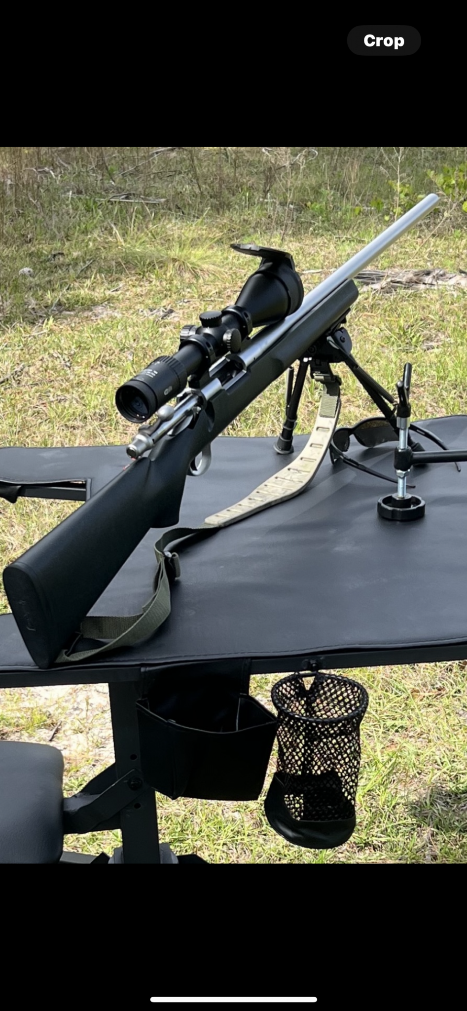

Any info on this one ? I’ll get some better pics and the serial number when i get home. It’s got a 20 inch barrel in 308. View attachment 8377185
Is that stock black, or dark green? If the stock is dark green, that is a 1st Gen 700 5R Milspec in .308 Win.
If it’s a black stock, that is most likely a 1st Gen 700 5R Milspec, but someone either painted the stock black, or put it in a different stock…
it’s Green everything is factory on it except the trigger i put a Geissele super 700 in it. I couldn’t find much info on it so i was wondering
If it’s green, it’s a Gen1 700 5R Milspec. They are typically shooters. The only times I’ve ever heard negatives about them is on the internet. All the ones I own and have shot were tack-drivers.
