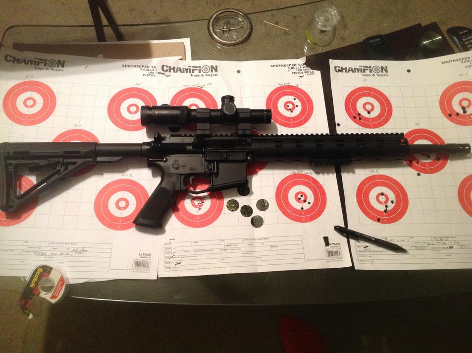

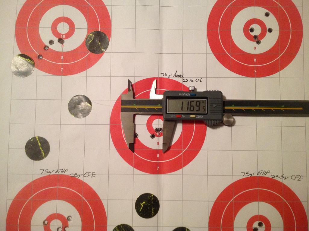

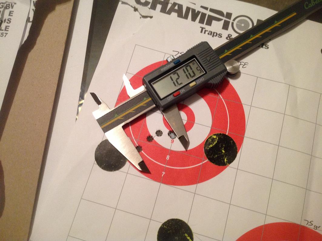

    Loaded up 10 rounds to magpul max length of 2.275. I did 5 with 22.5gr of CFE223 AND 5 with 23 gr I had a flyer with each but it shot well, no pressure signs. More development to come.
    What pmag are you using that allows you to load to 2.275? Most I can ever eek out of pmags is 2.25 and still fill them up(20rd). Got any pics how they look in the mag or even out?
    I went ahead and ordered one as well in the 15rd flavor. Ive got some berger 80.5s as well to try that would benefit from a little longer COL.
    I think it is a older pmag. I only did 5 at a time. So I have no idea how they would work with 20. It was tight, I think the nose was touching the mag or just barely kissing it. I loaded them up and then took them out (5 at a time) and didn't see any deformation of the tip. I am going to order a PRI mag just to get the extra .025-.035. I got sub moa out of both the groups today. First group is actually only a 4 shot. Shot the first out of that mag at a gong at 300.
    1-4x viper pst scope.
    5 shot group with 23gr CFE223. I am relatively happy with those results. I only had a 1-4x scope, and with the new PRI mags I will get the bullet a lot closer to the lands. I have a feeling this is going to be a good combo. I will have to load some more up and take the chrony with me to verify.
    On a side note my SCAR 17shot like shit with the first loads on the lower end of my ladder. I only got through half of the ladder with the SCAR but everything was 1.5-2 moa with CFE223 and 168amax. I found a sub moa node with varget and 168 Amax so I know I can do it. The node with varget was also towards the top of its ladder right when it just starts to compress it 42.6gr.
    Nice work daddy. Those are at 100yds with a 1-4x Viper PST you say? 1.2 MOA with a carbine and 4x scope ain't too shabby.
