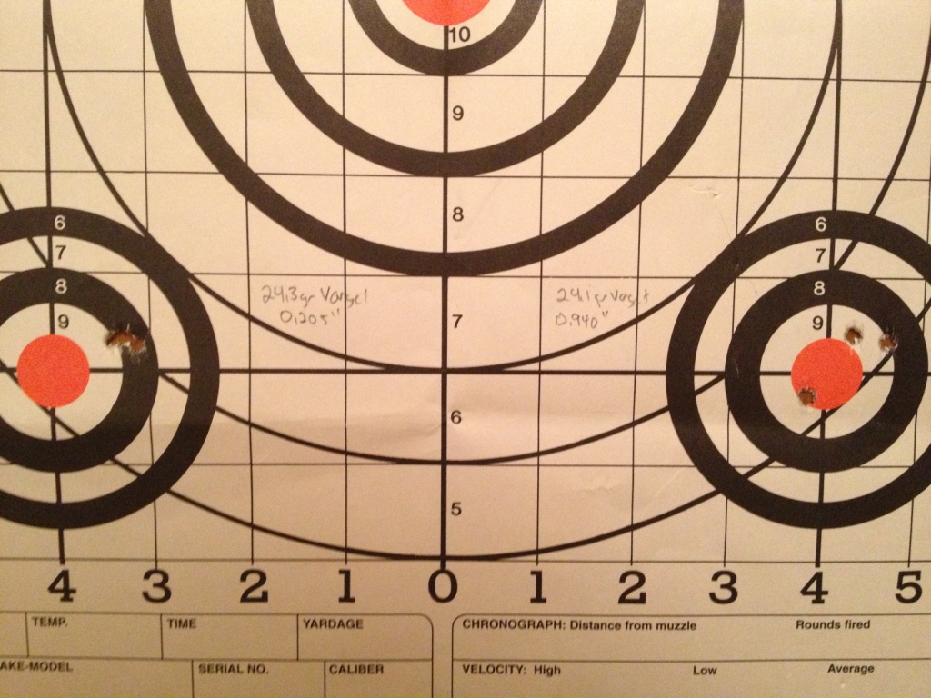

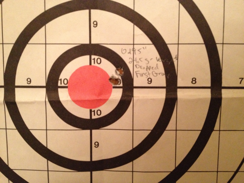

The gun is a Mossberg MVP with a ton of freebore. The bullets won't contact the rifling until 2.400" and they're loaded to 2.260" to fit in the AR magazine. It's a 1:9 barrel and the stability calculates out to 1.4 where I'm at, usually ~28.5" of barometric pressure and 30 - 100 degrees. I only get 2740 fps from a 24" barrel.
The 77 smk seems to transition pretty well. I use this load for shooting an IDPA target at 1070 yards. 24.0 - 24.5 grains of Varget is one of the goto loads for this bullet, but you'll probably want to start in the 23.0 - 23.5 range.
