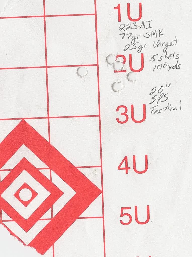

2.345 Varget
77gr Sierra matchking
20" SPS tactical chamber reamed to 223 Ackley
HS precision stock. not beded
trigger about 2 lbs
AAC brake M4-2000 mount
<span style="font-weight: bold">1X9 twist factory barrel</span>
This rifle always has a M4-2000 on it. I took it off because if was 100% sure that the 77gr SMK would go through the paper sideways at 100yds.
The group show potentil. I loaded 5 rounds aith a random load of 25gr Varget. I am going to start load development and hopefully get this group to shrink and see what it will do at distance.
I normlly shoot 69gr SMK out of the SPS tac. I took t out to 725yds and to 1000 today and it does great for a inexsesive rifle.
