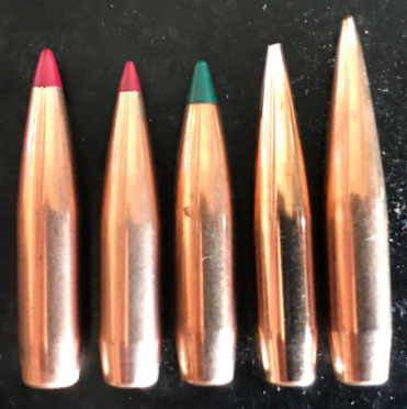

Projectiles from Left: 162 ELD-X, 162 ELD-M, 160TMK, 175 Elite Hunter, 183 SMK.
The node seems to cover both rifles, from around 2800 - 2865 or so with grouping sizes similar throughout that range. Going back through my notes, I had some tiny groups with 46.2gr of RL16 and ELD-Ms.

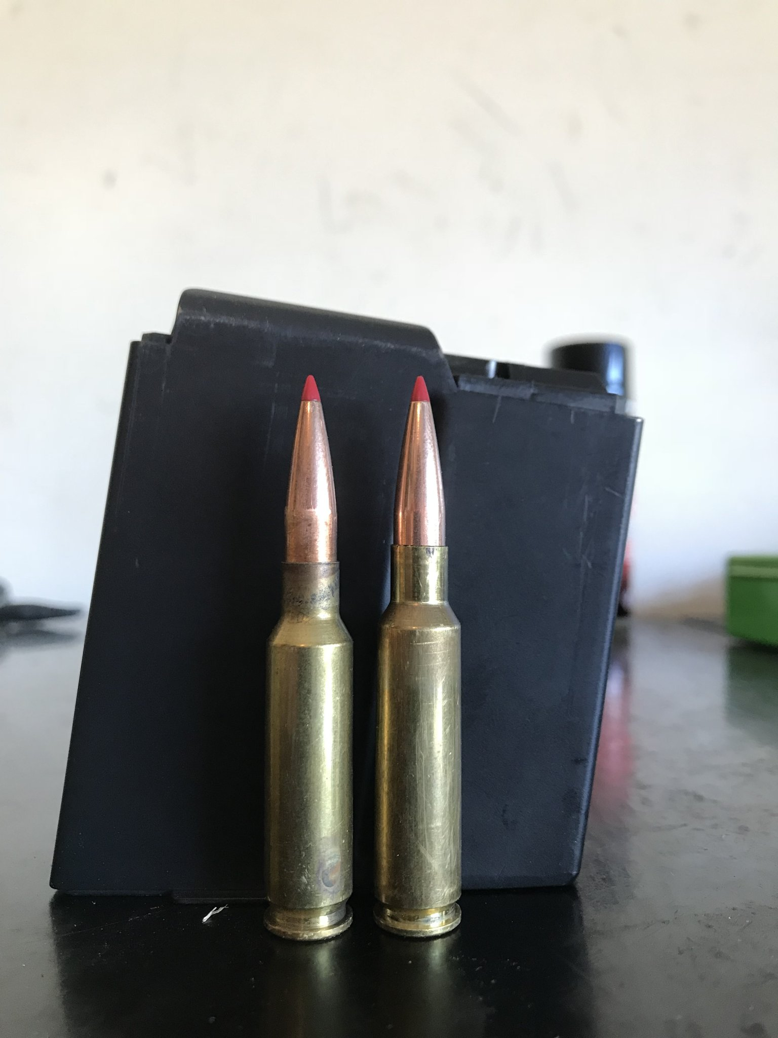

This is a mockup of a 7mm Creedmoor vs 7mm SAW:

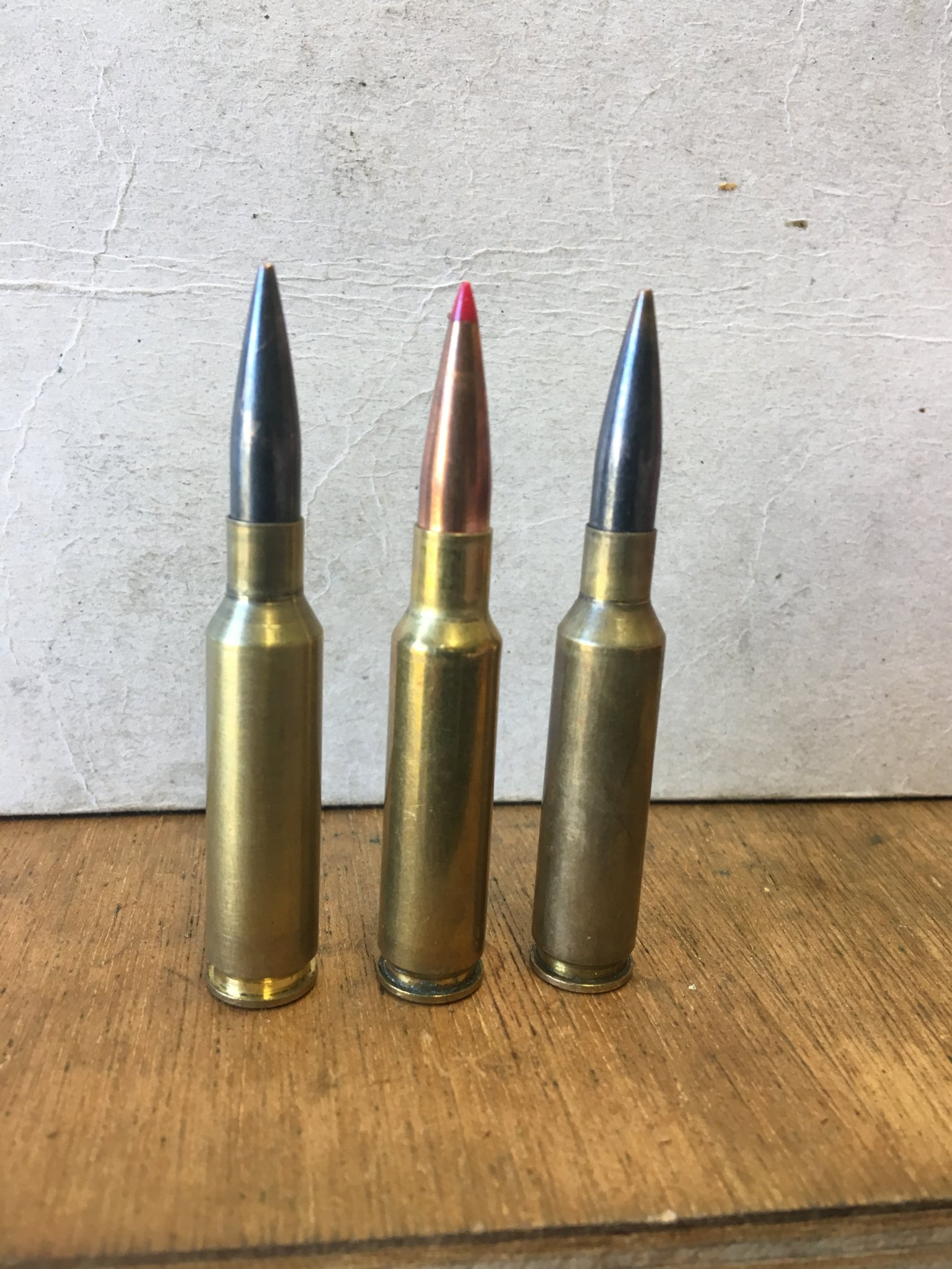

This is the 6.5 SLR flanking a 7mm SAW:

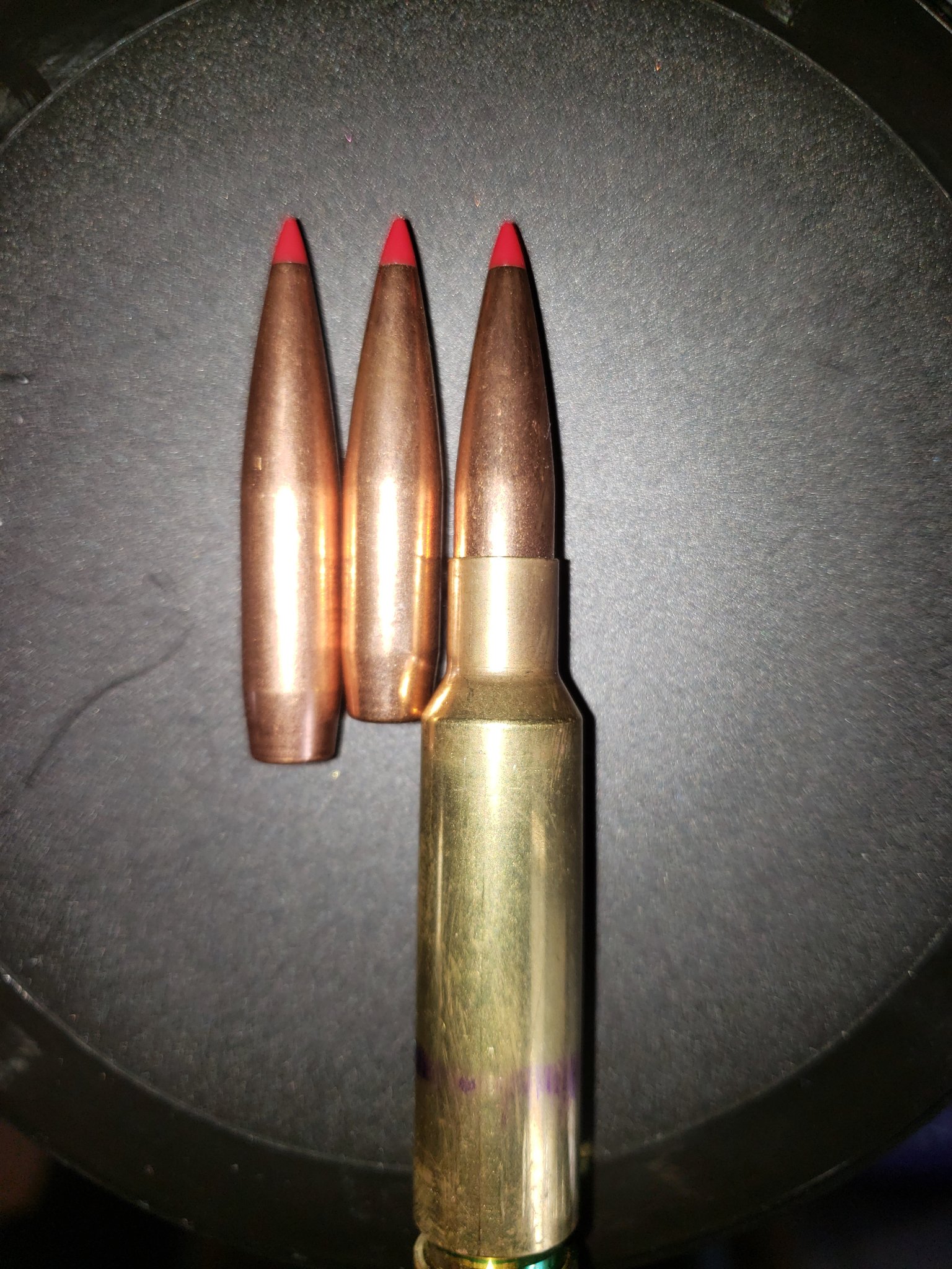

pic is a 180, 162, and 162 loaded to 2.935 coal
Reactions: Simia Dei
