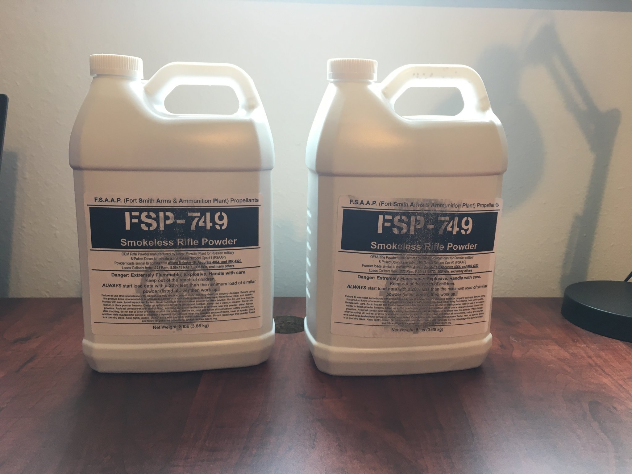

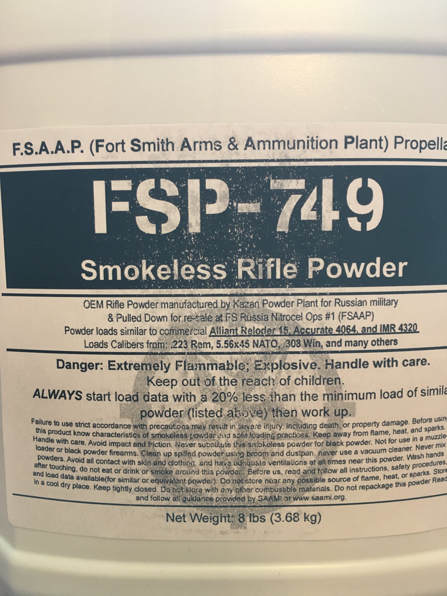

With powder being so difficult to find right now, I decided to order some FSP-749. This is pull down powder and supposed to load extremely similar to Reloder 15. This came in two 8lb jugs but I only want one of them, so I am selling the other 8lb jug. I am not willing to ship.. local sale only, I'm in the Denver area. $175 for the jug.

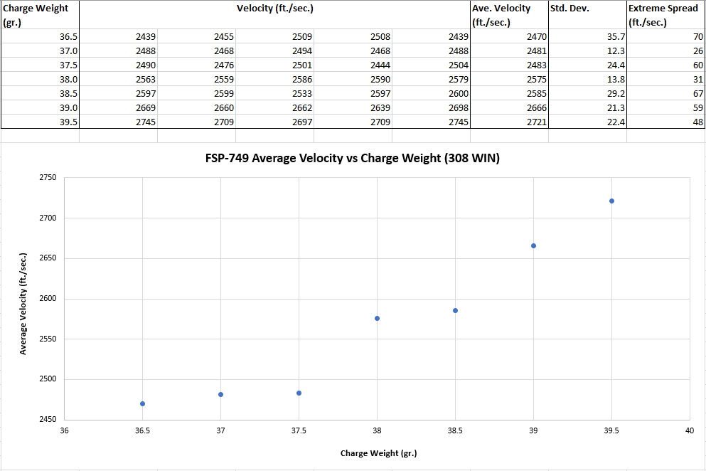

Had a chance to get out today and test some 308 loads using this powder. These are out of a 24" barrel, using GM210M primers, LC brass, 175gr SMKs with ~2.810" COAL. See the graph below. Started seeing very minor pressure signs at 39.5 grains. Also worth noting that anything above that will likely be a compressed load.. that is using FC brass at least.
As always, start low and work up. This data is for reference only. Also, the 8 lb jug is still for sale.
