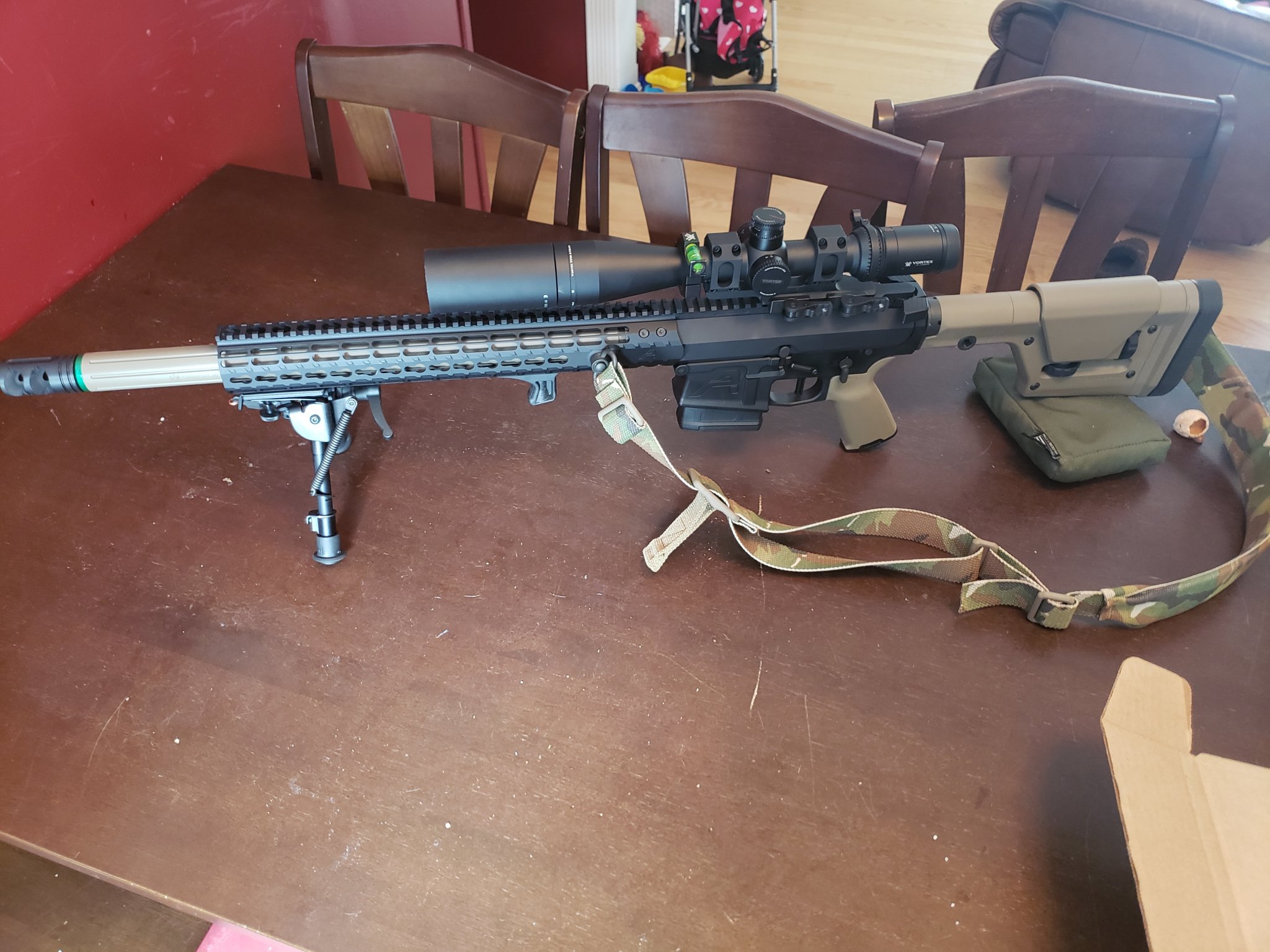

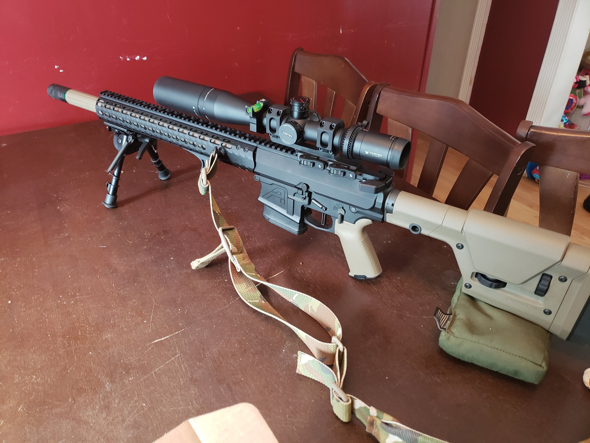

And because everyone loves gratuitous gun porn.....here she is

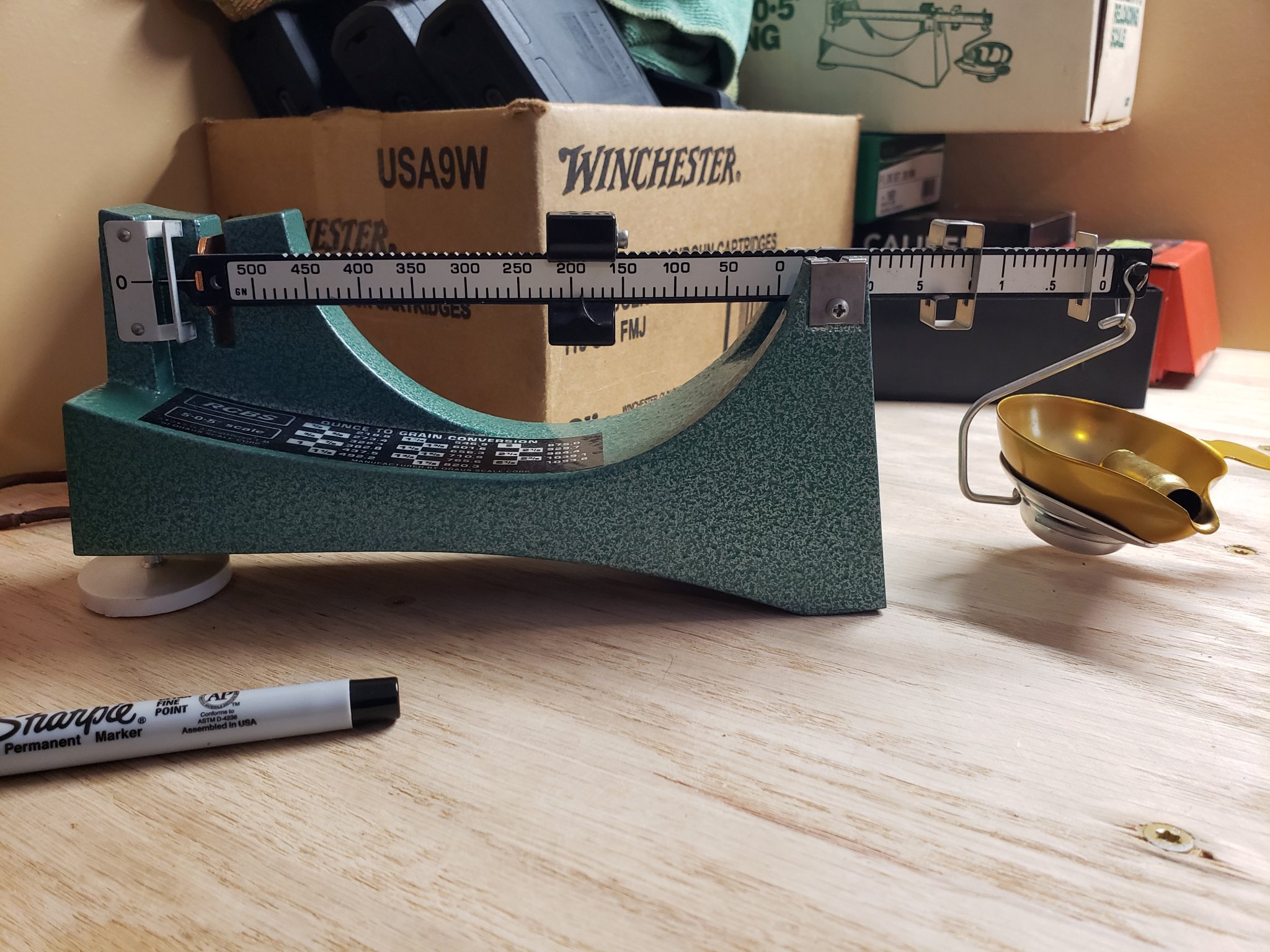

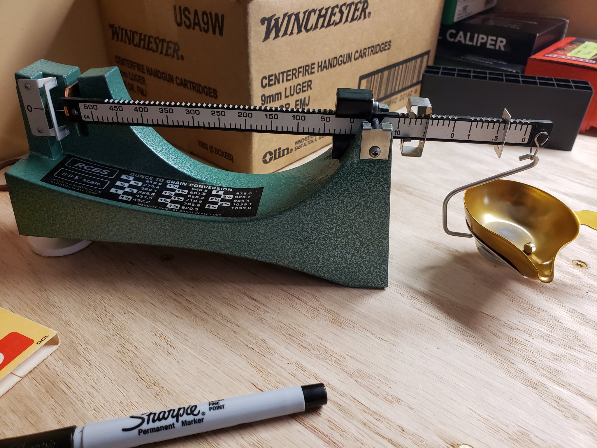

I am currently loading ammo in question. I weighed cases for you @918v. They're all primed, so I weighed the primers too. They've all been fired twice, if that makes a difference.
Primed case: averaged 190.2-190.4
CCI 200 lrp: 5.4
If my math is correct, give or take .2gr, it appears I'm using 185gr cases.
It appears the "match" brass is the 165gr case. I had some on hand. I am, and the only reason for my choice in Varget, had been its consistency across calibers and platforms. I'm able to load .223 69gr Matchkings with 24.1 and average 2600 from a 16", and I can load for my .308 rifles with it also.
