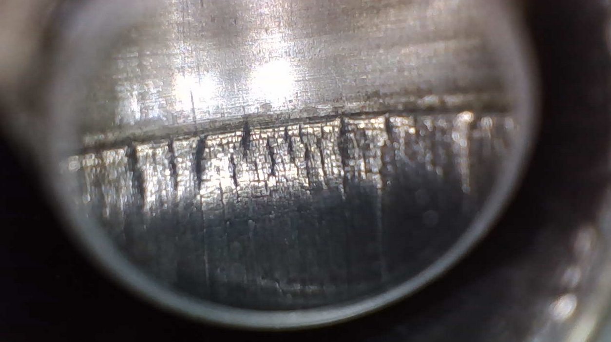

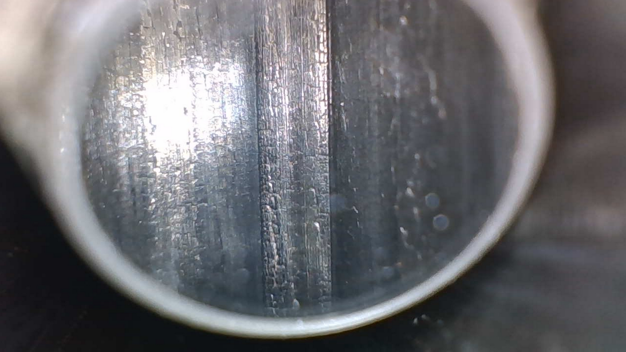

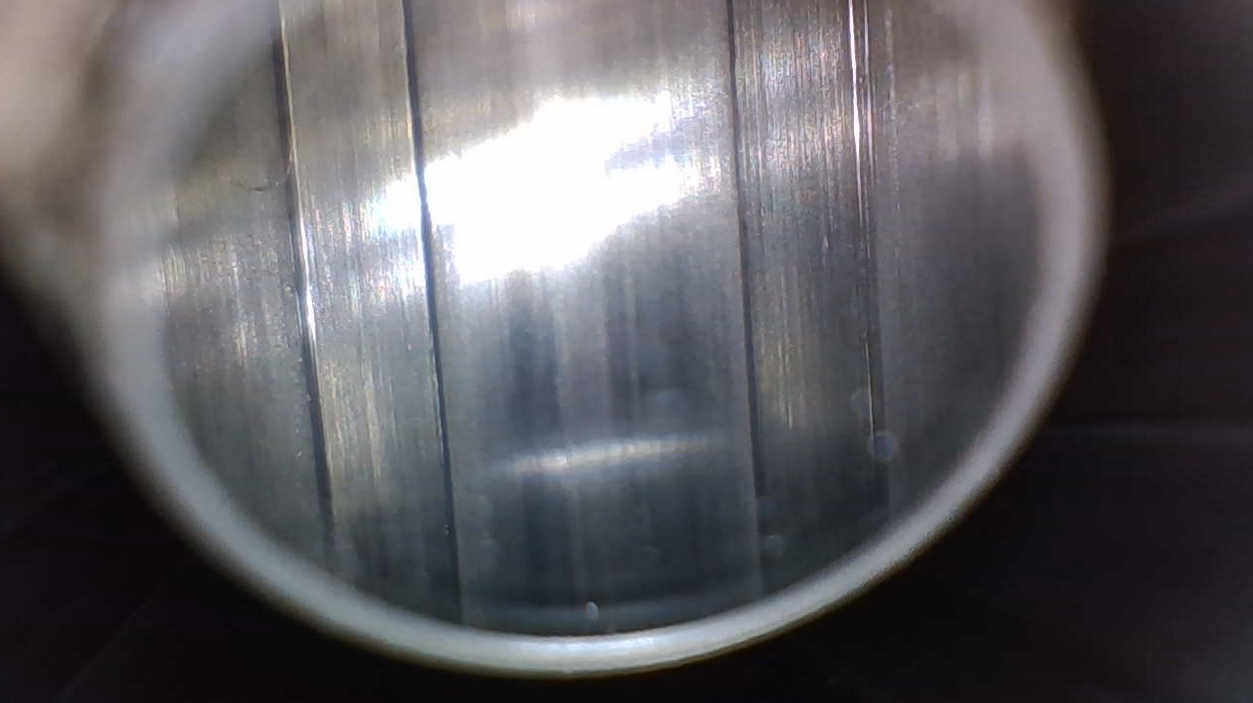

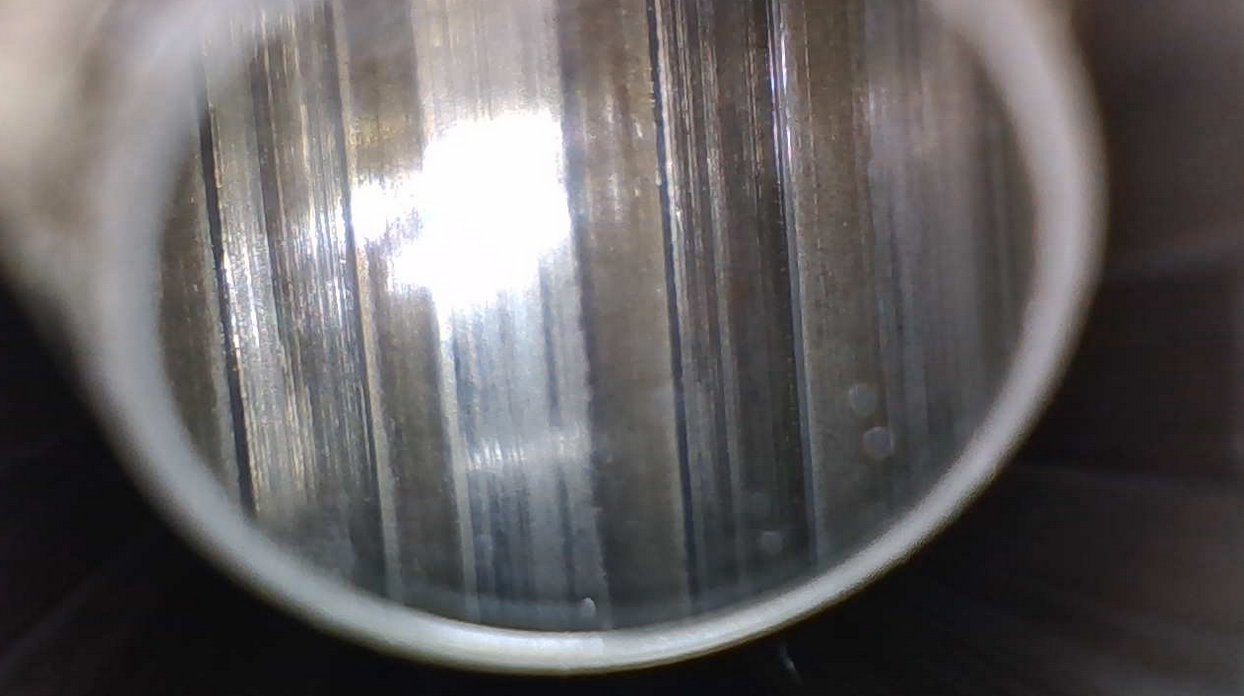

LAST UPDATE (before shooting) ...
I used Iosso, opting for the instructions on the label. Ran 3 Iosso patches slowly through the bore. Then I put Iosso on the Iosso-recommended nylon brush and did 10 cycles. A couple of dry patches, and then Bore Tech C4 until clean. Finished with a soaked patch of CLP, a few dry patches (totally clean), and done. Then I bore-scoped. Results ...
  1. Bore "feels" much smoother when running a dry patch through ... a noticeable difference.
  2. Throat looks similar, but seems slightly better.
  3. 1-2 inches down the barrel seems cleaner but with no change in cracking.
  4. Midway and just short of the muzzle looks better when compared side-by-side.
Time to shoot it, and see if the groups improve after a reasonable cold-bore and micro-crack-filling grace period.
Here are the post-Iosso pics for comparison:
At the throat ...
1-2 inches down the barrel ...
Halfway down the barrel ...
1-inch from the crown ...
Good luck with it but I’d be prepared to pull and replace the barrel at this point. 1200-1400 rounds is when they start to go in the win mag. Even earlier (much earlier) if you like to hot rod the heavies.
if you don’t keep an exact round count log, I’d start with your next barrel.
Good advice. New barrel is on the way (8-10 weeks) from McGowen. Squeezing more life from this one was a pandemic side-project. Definitely need to start keeping track of my round-count.
