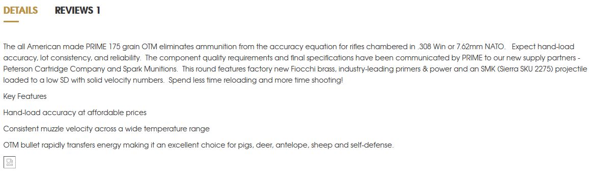

Just saw the sale email today. I thought rifle ammo was going to be Peterson Brass, but looks like Fiocchi for the 308 at least? Is that correct, or was the email worded goofy?
If you look at their website, and read the details...the .308 uses Fiocchi brass.
but it also says Petersen is a supplier. Hence the confusion. Now, maybe Petersen is doing the loading, but why would they load something that they had no components in especailly when it reads like Spark is doing the loading? Or maybe im just reading too much into the copy and they used the generic copy even though it doesnt 100% apply to the 308 ammo. Guess it really doesnt matter, i dont even shoot 308. Just trying to learn what this new breed of Prime is.

i suppose there might be pictures of it in the wild but my point is that prime very clearly describes their 223 ammo in the 223 details but doesn't in the 6.5 cm details,,,,, that is what the mystery is, why not put the same details out there. i've bought quite a bit of prime ammo, still have a bunch but why do people who want to know what their ammo is comprised of have to hunt down the details of the 6.5 on a forum or out in the wild,,,,,be a lot easier for customers to just read it on their website, like the 223 and even 308.

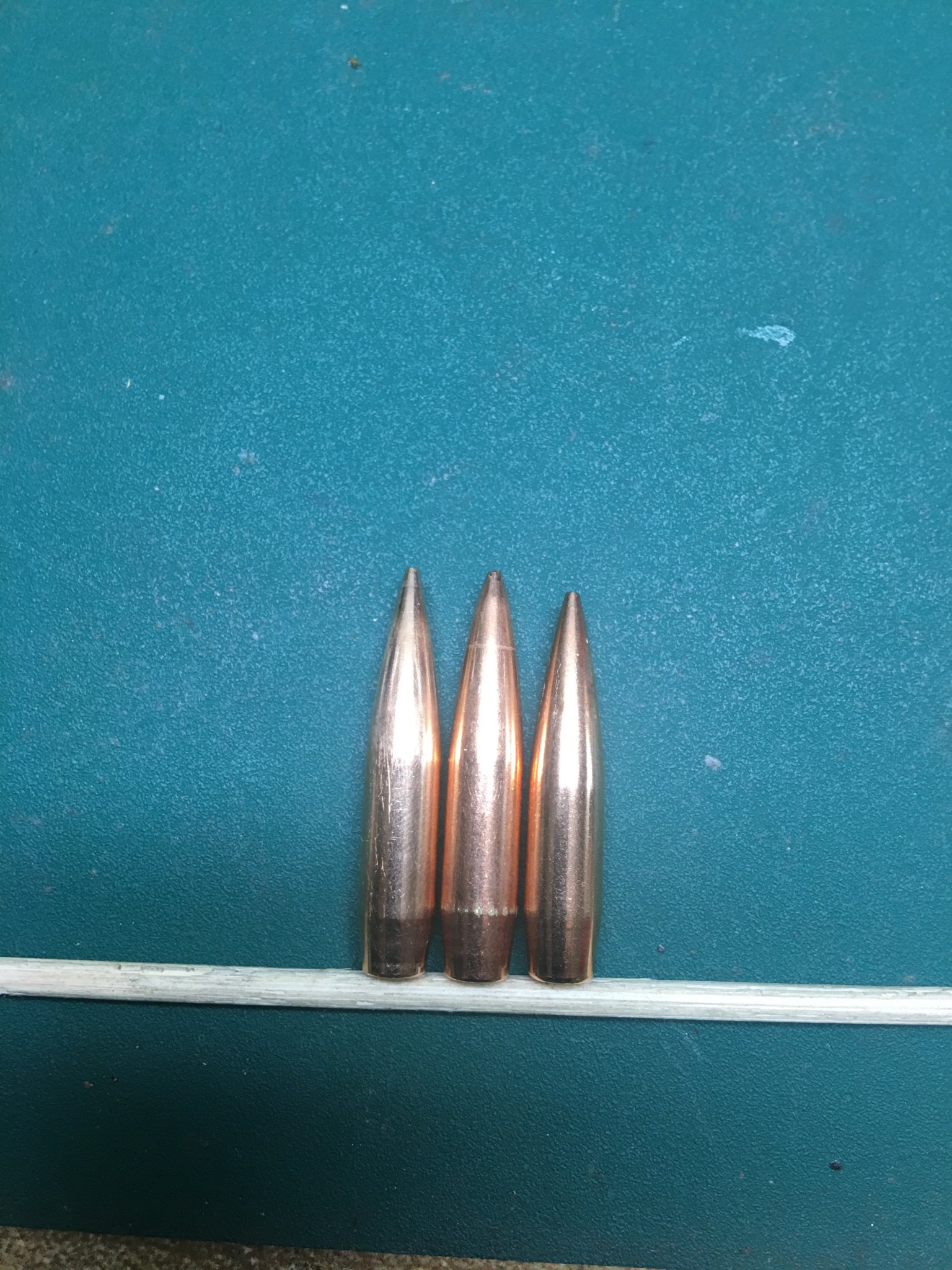

I haven’t bought any ammunition for myself in years but I thought I’d try some of the new 6.5CM prime and support a company that supports SH.

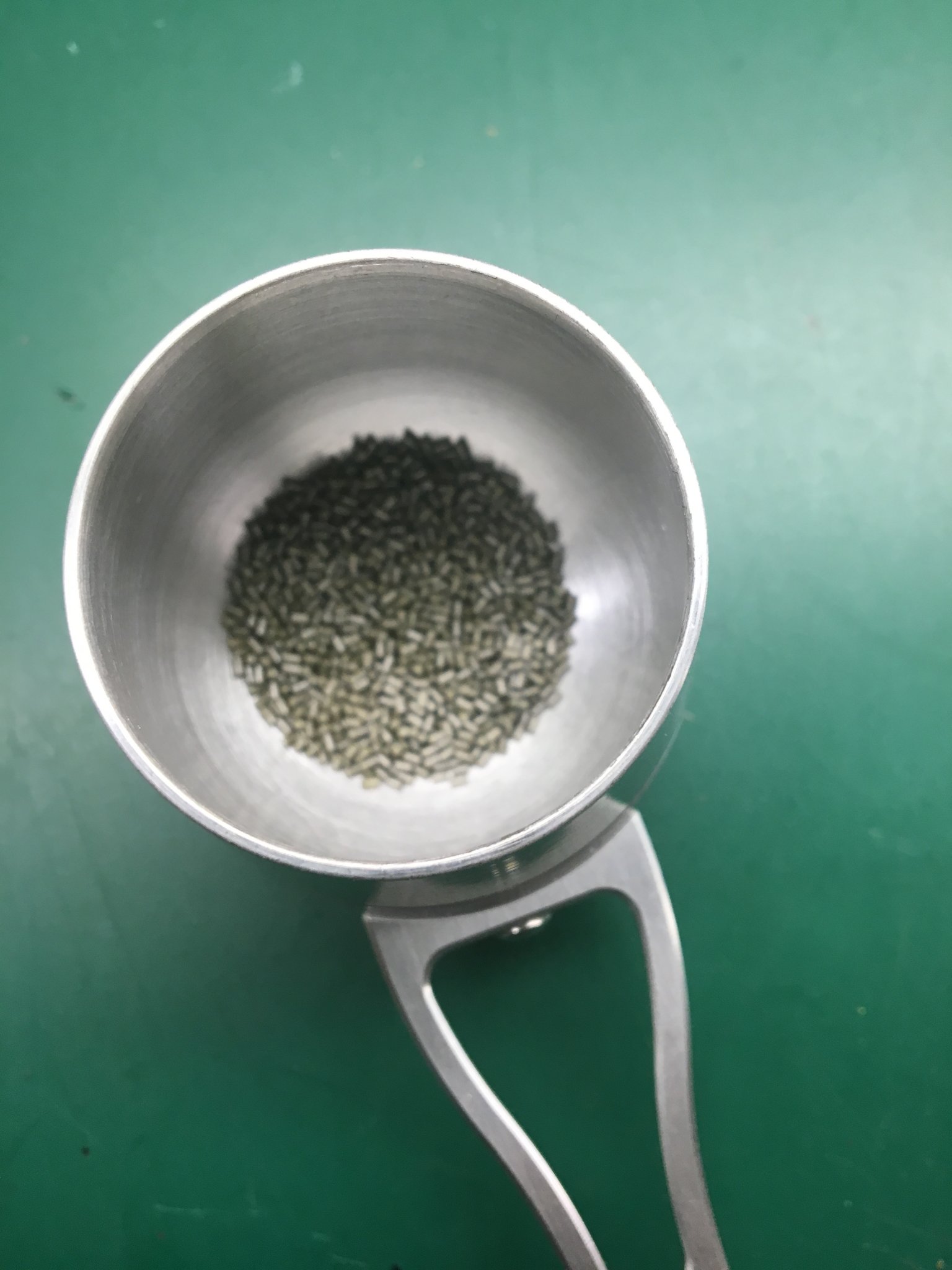

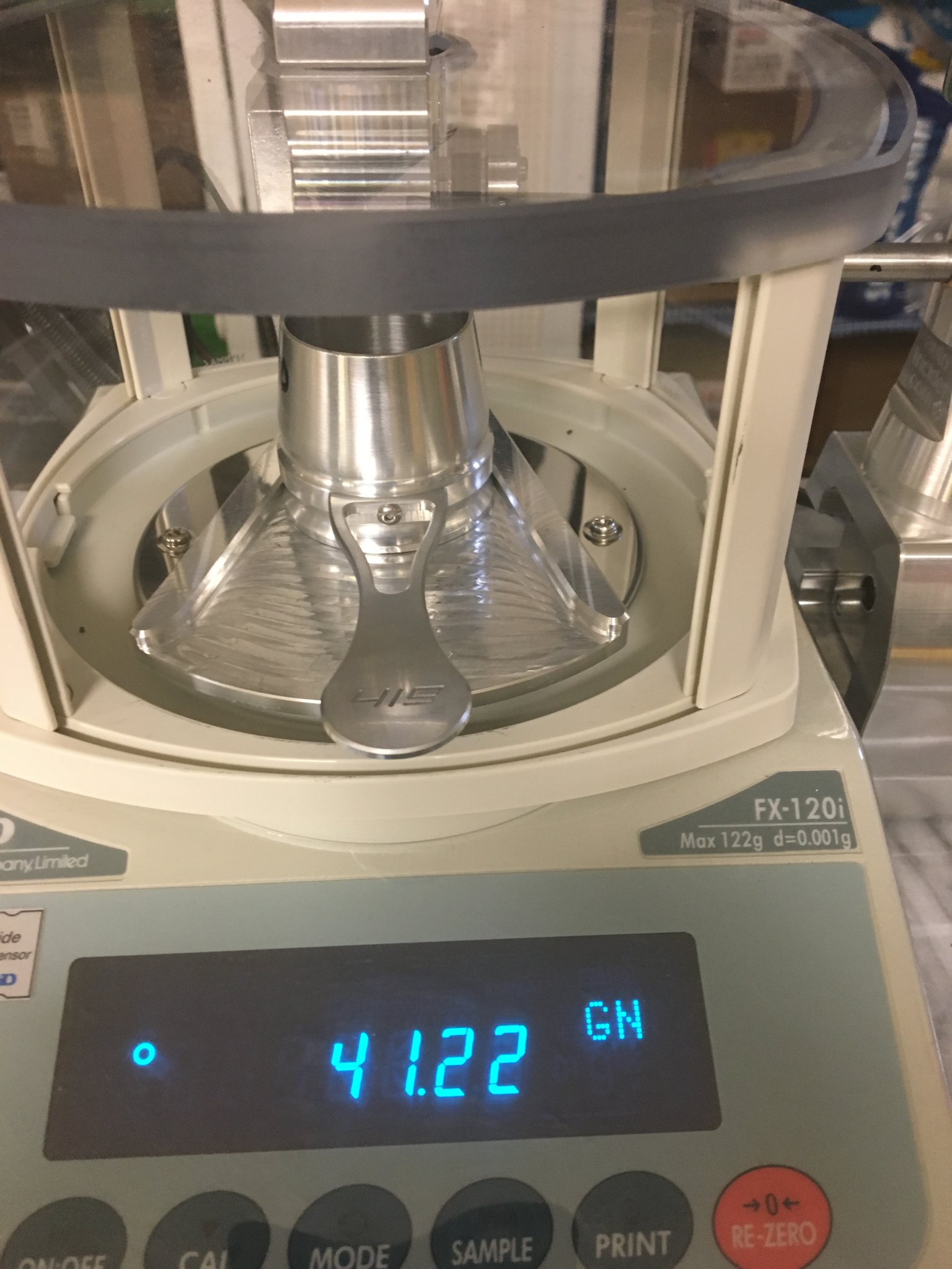

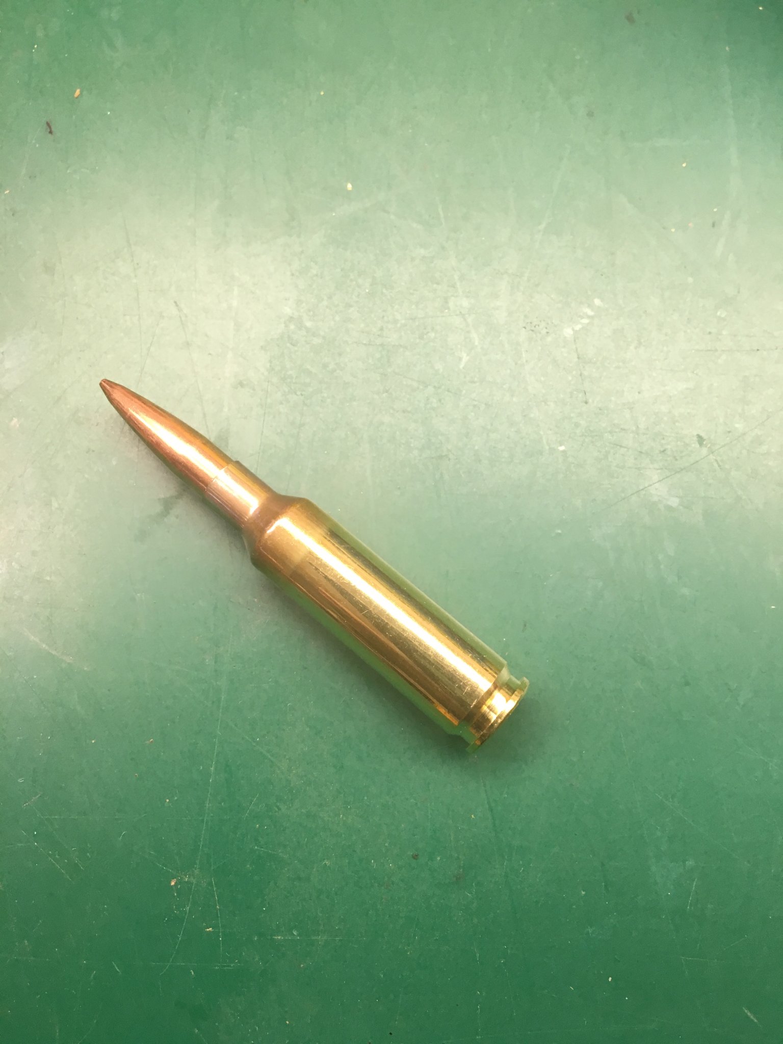

Here are my unscientific findings:
Peterson brass, white metal colored primer. Shipped directly from Pennsylvania, where Peterson Cartridge company is located.
2.788 COAL
2.182 CBTO
Appears to have 41.2gr of Propellant (additional .02 is from me, moving too fast in front of scale)
Propellant appears to be H4350. I say it appears to be.....
Left: 6.5mm Berger 130gr AR Hybrid OTM. Center: 6.5CM prime projectile. Right: 6.5mm 130gr Norma Golden Target
Performance: 27.0MOA to 1000 yards DA was 1800 (26” 8 twist Rock barreled M700) At one point I fired 20 rounds as fast as I could work the bolt at my 15x25 IPSA plate; had 17 hits. @Defender3 was spotting for me.
Ring on center projectile is from comparator.
2.788 COAL
2.182 CBTO
good info, thanks! just from the picture, i would have to say they are not using the berger, wouldn't you?
i mean, to me it's no big deal what projectile it is, just wanna know cause it is easier to put into a ballistics program
Reactions: Pusher591

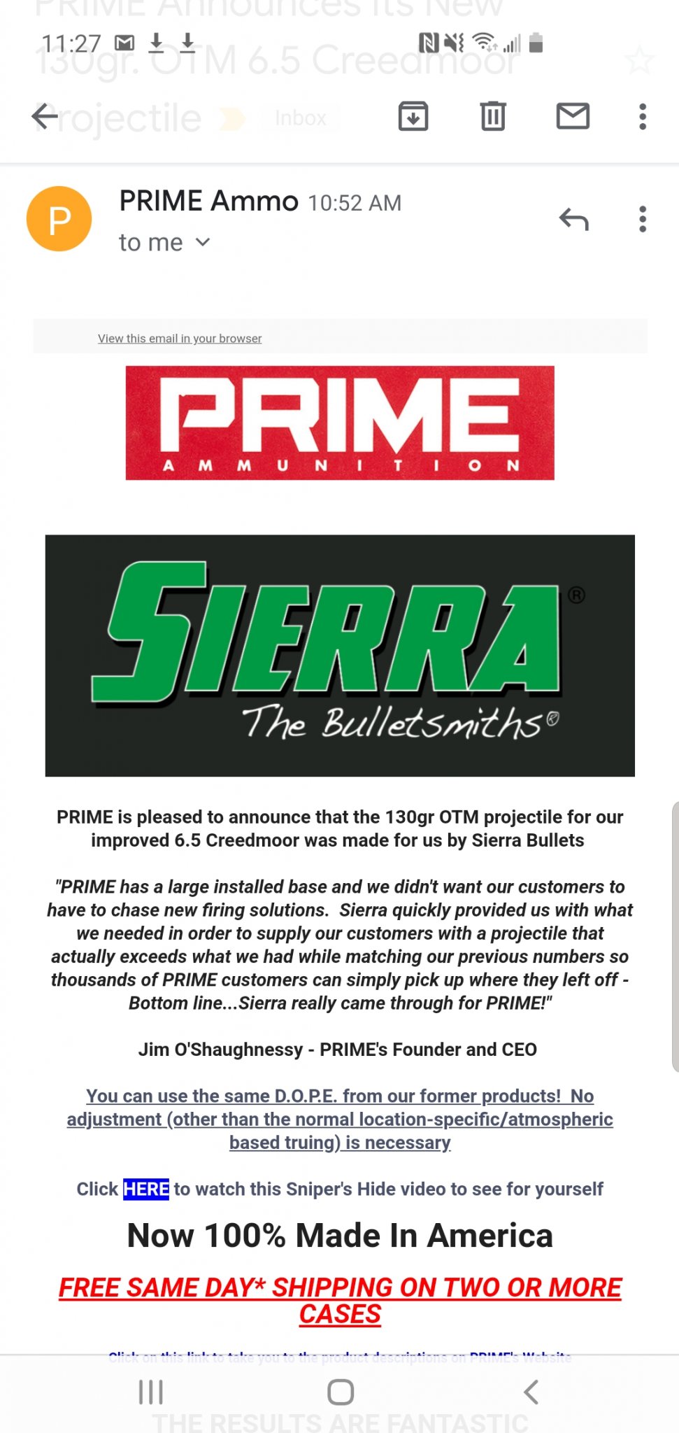

ok, got some info
the projectile is a new bullet which is a 130 gr sierra match king, unpointed and is almost ballistically the same as the old norma bullet.
the best ballistic choice in the kestrel is to use the old norma gold target ( the same as the old prime ammo) and it should be about right on.
the new bullet will be sent off to AB and will be added to library in the future.
and as we all know by now,,, peterson brass for the 6.5, 6mm, 338, 260 etc but fiocchi for 223 and 308.
i think prime might update their site as well with this info.
Maybe Prime has added the pointing process to there ammunition specs and are doing it prior to or during cartridge assembly.
The projectile sure does look like a boat tail SMK style profile, so that’s not surprising to me.
You said unpointed, but the pictures all look like they have been pointed.
i was relaying info i was told by jim which is that the bullets are not specifically pointed to increase bc for target/match type stuff
and i am sure that prime does not do any pointing, the way it was explained to me is that the bullets stay the way they come from sierra.
he said the "point" (ha ha) of the new bullet was to be close to the old norma so that folks would have little to no change in their dope from the old ammo. (that was one of the goals of the new bullet anyway)
jim told me it was ok to quietly post this info and that he was more than likely going to put it in the detail section of the 6.5 ammo.
i will say that i ordered some smk's in 6mm 107gr a while back and they look pointed to me but i didn't order pointed nor did i know they came like that, but they sure looked a lot more pointed than some 150gr 6.5 smk's i had been shooting ( in another gun obviously)
Reactions: lash and seansmd
Even in the picture of the projectiles above? Looks unpointed to me. The only pointed bullets I have had are jlk’s so my sample size is small.
that is the same with me, i ordered some jlk's pointed and they are darn pointy. i also don't think the picture above shows the new prime bullet to be that pointed.
The pictured point looks exactly like the 183smk 7mms I just bought and loaded. If I ordered "pointed" and they arrived as such, I'd want some money back. It's definitely a different profile on the tip, but far from a pointed bullet.

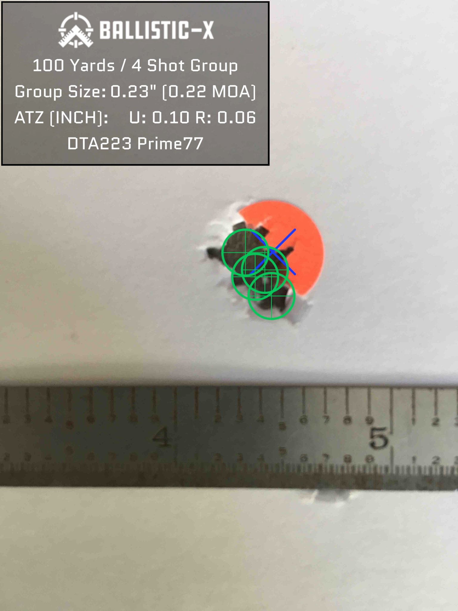

Ok guys just went to the range with DTA223 and some new prime 77SMK. Well they did it again. Out of the park.
I will be getting more as my money allows.
Thanks Jim good job and glad you are back.
