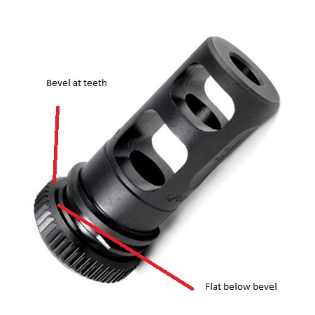

The top of the beveled surface where the teeth are cut usually have a little "extra" material there, not quite a bur but you can feel it. Gently stoning this may help those that are close to clicking tight. You can also stone that beveled area by hand and use machinist blue, very carefully, and it takes a long time, but you can get a really good tight lock that way too. In either case, you want it to be close to locking (really loose) if you are gonna do it by hand with a stone. It'll take forever otherwise, and be harder to keep true. I did this with one that was really close to locking, and it locks up really tight now. Nice and true too.
Other people have hammered fender washers into the same bevel and cut to fit over the brake with emery material glued on, and attached to a pipe such that they have a hand held sanding disc slipped over the barrel/muzzle attachment, and they then rotate one or the other, depending on how they made it and set it up.
Any way you do it, it's critical that you keep that surface uniform; use the machinist blue and put the can on often. Access to a lathe and doing it as described above is by far the best way to go about it. When I have to fix my other mount, the 7.62 mount that wiggles so much I can see the can eclipse the bore, I'll have to have that one done by lathe.

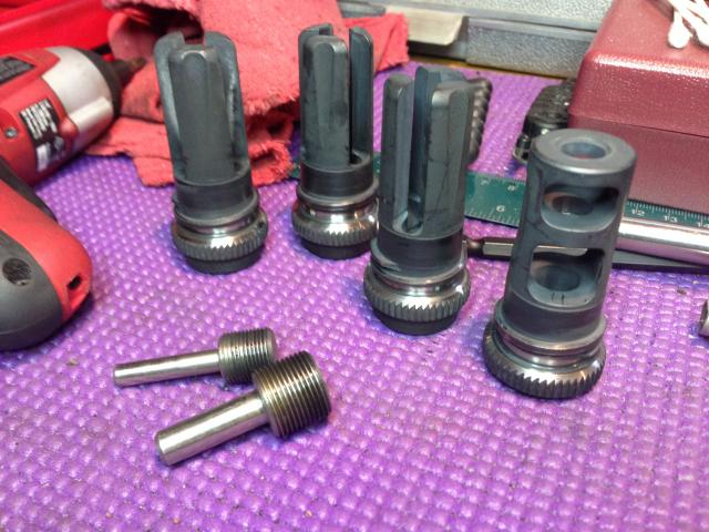

Ok, I just went through this so I'm going to share a tip that really helped me. Carolina Shooters Supply sells some thread alignment tools for $7 each. They are meant to slide in your barrel when using a hand tap. I used the tool to screw inside my AAC wobble-mount then I mounted it on my drill. This allowed me to turn the break while using a file and emery cloth. I would take a little off, pull it out of the drill and lock the shaft in my vice and screw the suppressor in place to see how much more was needed to get to the next tooth. It took me 30 minutes per mount (I had 4 to do) but eventually I got there on each. Don't get frustrated, that 45 degree edge is hard material, you need a sharp quality file and patience.
Here is the link to where to get the thread alignment tool. They make them for 1/2x28 and 5/8x24 SAIGA AR15 TAT THREAD ALIGNMENT TOOL 223
