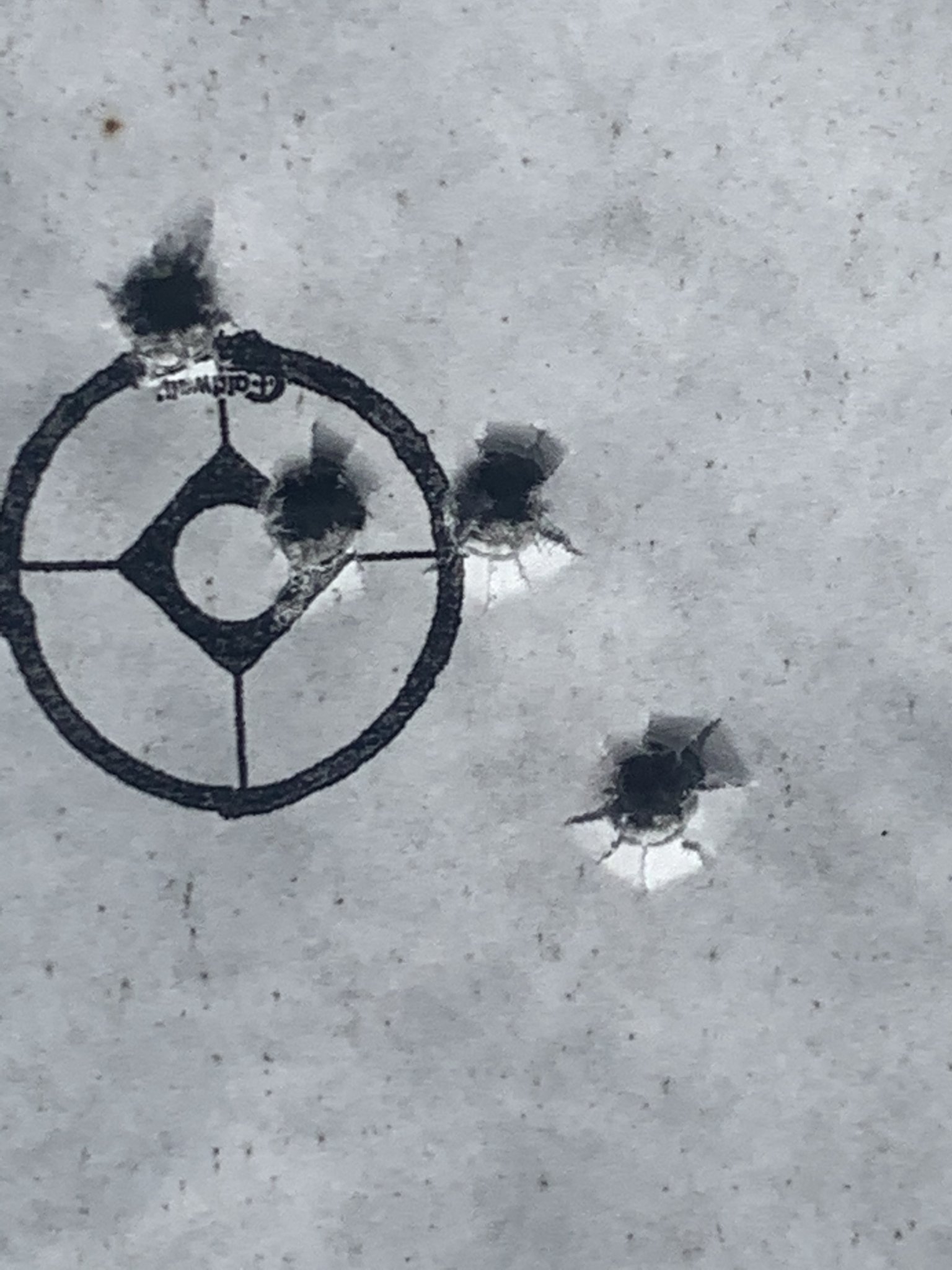

I have two AAC suppressors, the AAC SD 7.62 and a AAC SD 5.56. I could never get the accuracy and repeatability from the 7.62 that I wanted for long range shooting. Since the conversion I’m very happy with it. I have repeatable zero, accuracy and quiet enough for me. I don’t see modifying the 5.56, however I’m not using it for the same purpose.

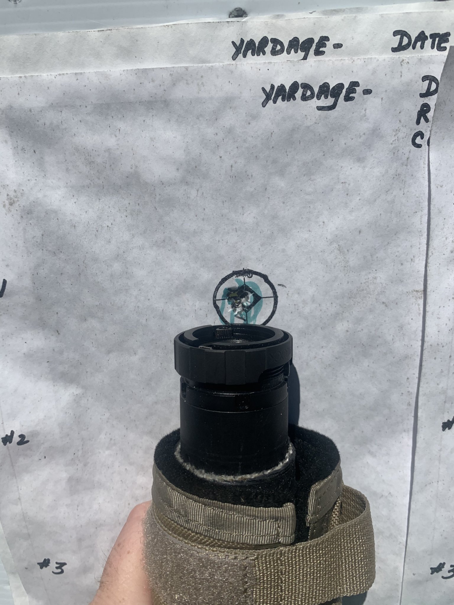

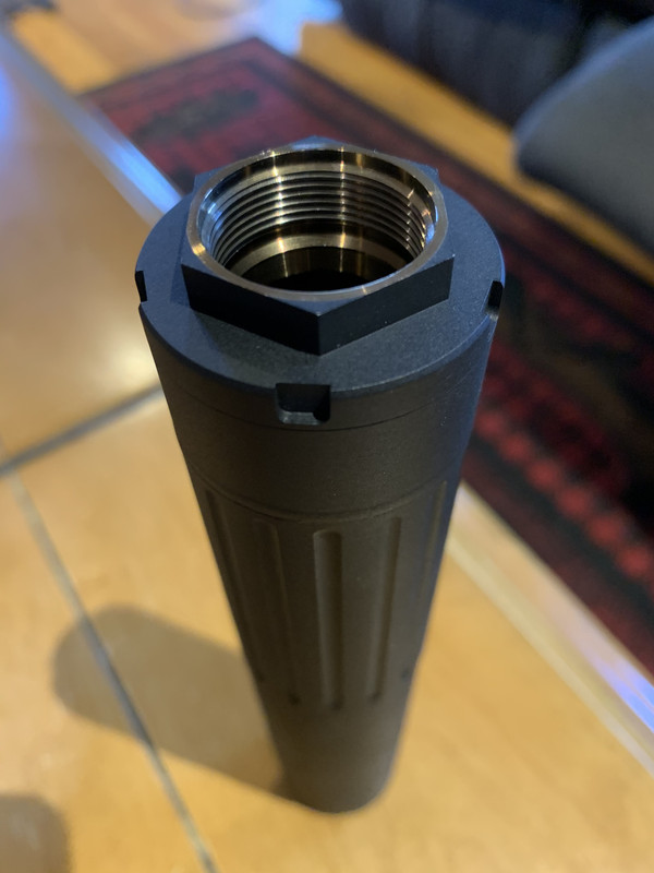

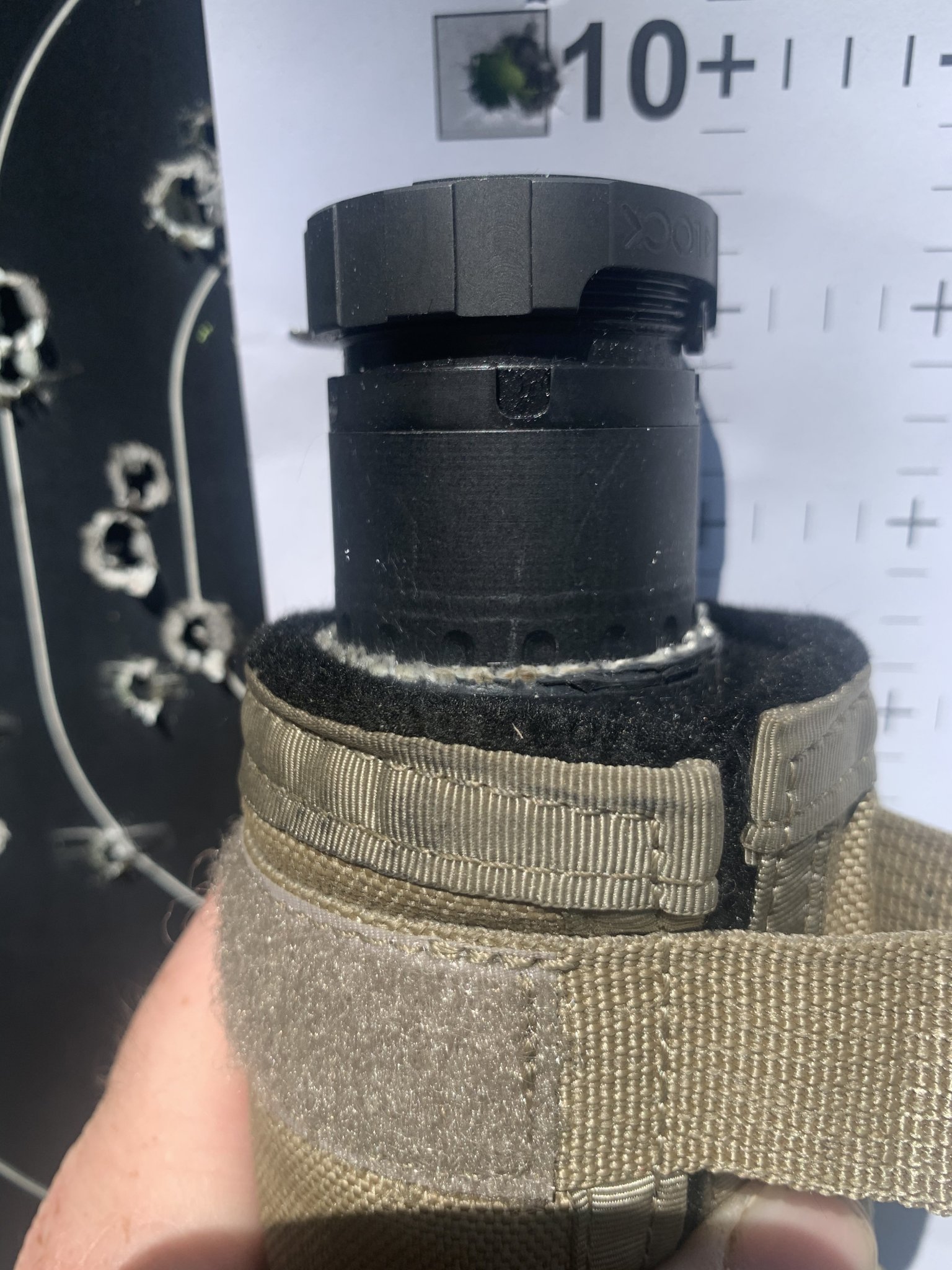

Ok guys and gals update time so I got the can and it looks factory everything mounts up very nicely and the communication was great as well so befor I sent the can to get fixed I was using aac51 tooth mount and I had Polished it and got a really tight lockup between the can and the brake withe the can off the gun it shot perfect but soon as I would put the can on the gun it did this and this is bout as good as it would do even when I would work up a load for the can it wouldn change matters so now that I have the can fixed this is wat it is doing now and I rolled the cover down in the pics so u could c the weld it looks factory to me the can locks up very nicely on the brake every time and it will go back to same hole groups when I take it off an Put back on Now it does have a poi when it is off the gun but that is expected as it did when it was factory as well needless to say I’m very pleased wit the results and I would recommend Any one who is on the bridge of doing it to go ahead and do it it will b well worth it anymore questions just ask

To add hilarity to my situation...the same day I got a call from Ecco that they were ready for me to send my can as they reopened the books...AAC sends me a return label asking me to send it in for review. Well, I'm not sending it to AAC because the mount itself as a concept is flawed and them looking at my can will do 0 to fix that, so keymo swap it is.

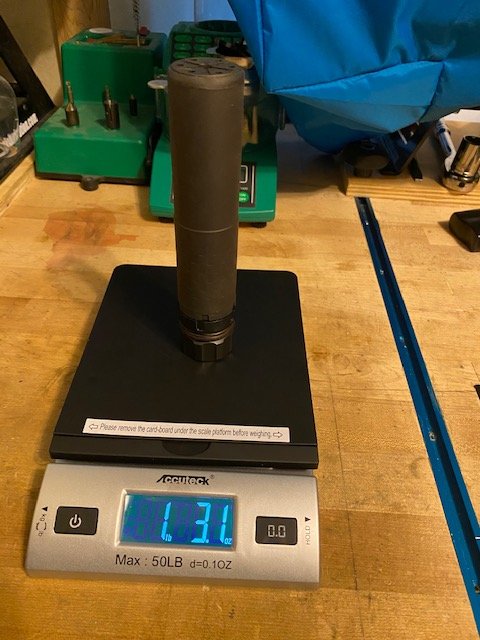

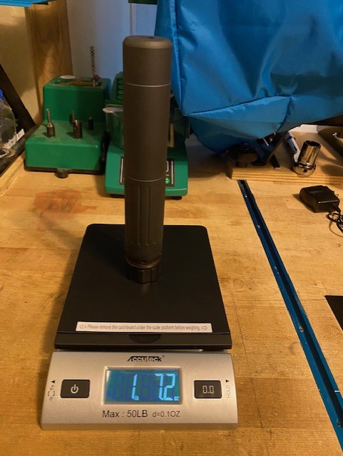

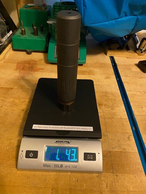

Just got my converted cans back from Nick at ECCO Machine today! I didn't weigh or measure them before sending them out as I was too excited to rid myself of the 51T mounting. Here is what they weigh now so to give you guys an idea. they seem to be heavier and longer than I remember but that definitely could be attributed to the keymo. Looks like possibly adding an inch and around 3oz to these freshly converted cans.
SDN6 23.2oz
M42K 20.3oz
Saker 556 w/keymo adapter
SDN6 and M42K

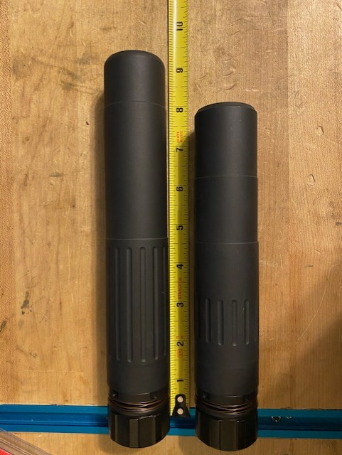

I measured and weighed my SDN6 before sending it in.
7.5”
20.8 oz
Reactions: Docsherm
So it looks like it adds a little less then an Inch and a half. Not too bad. I will take it for the better mounting system.

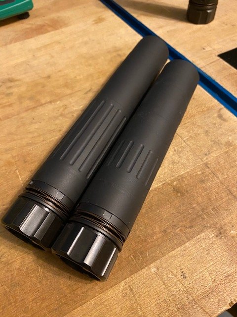

Got my SDN6 back today from the plan B conversion, it looks great. They refinished it in moly resin.
before conversion:
20.8 oz
7.5” long
after conversion:
21.6 oz
8” long
