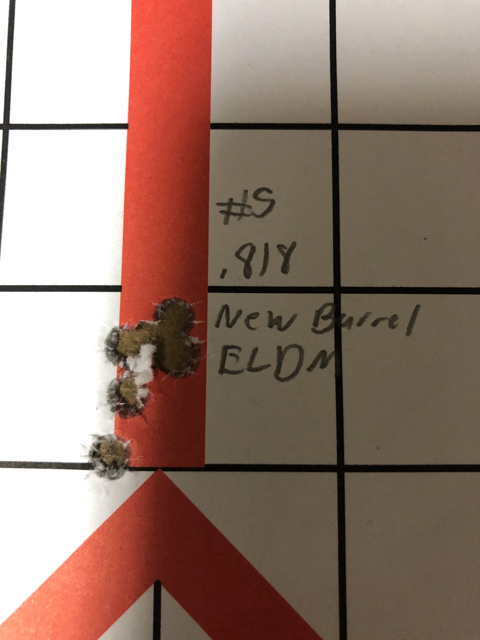

Prime 3-shots after I cleaned and reinstalled the barrel. It still needs to speed up and only had about 100rds at the time:

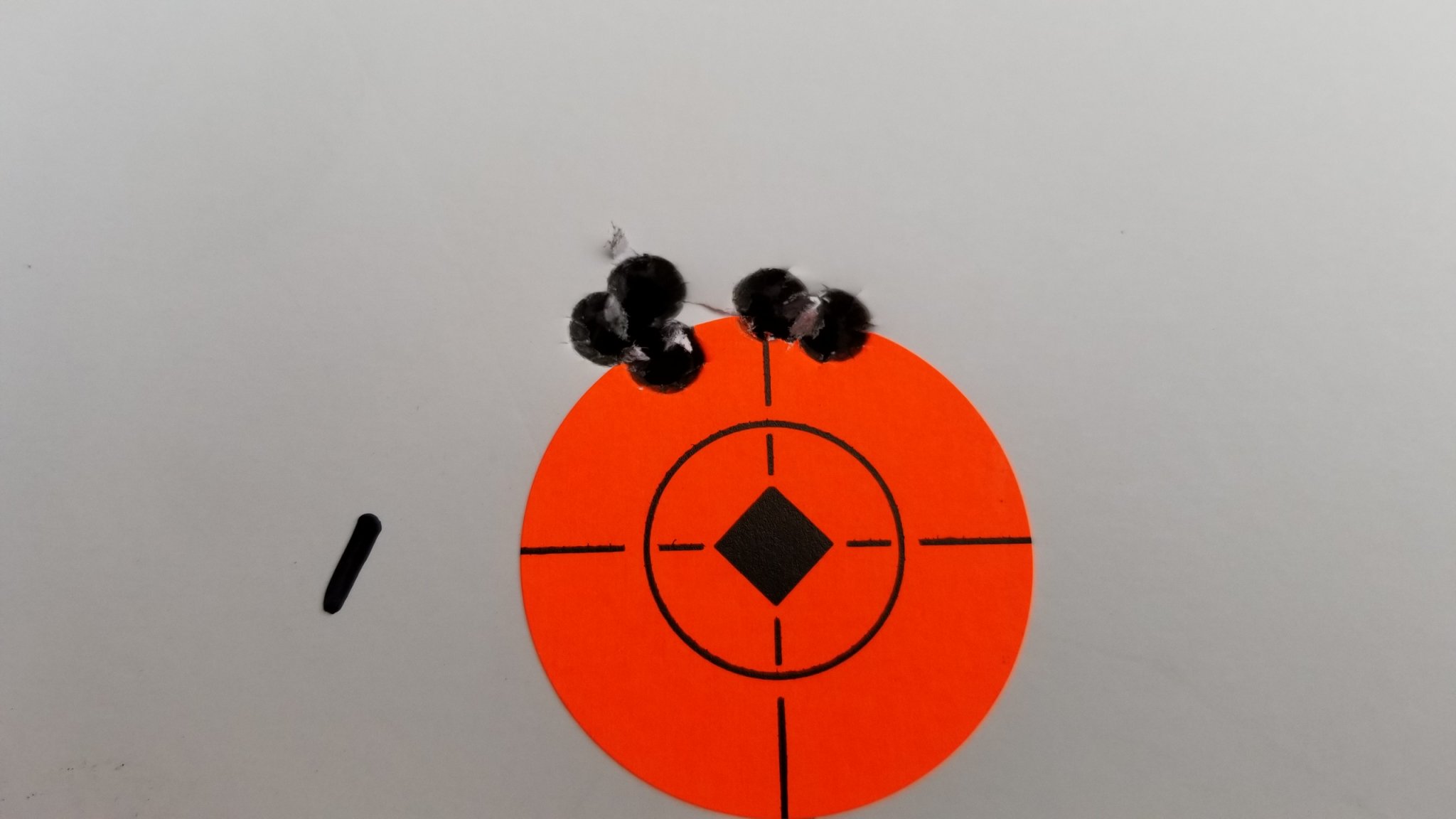

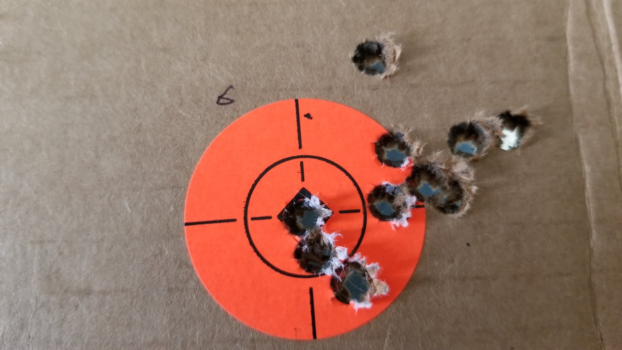

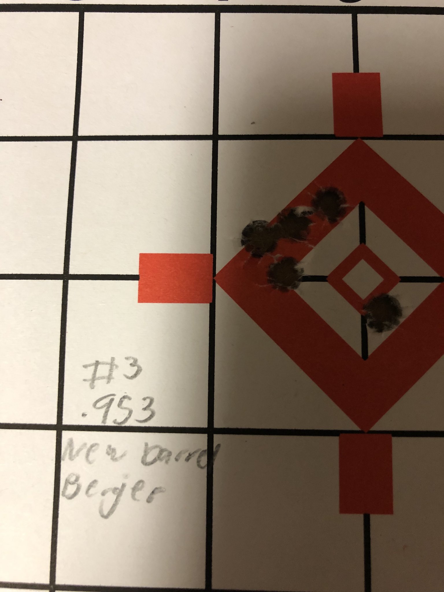

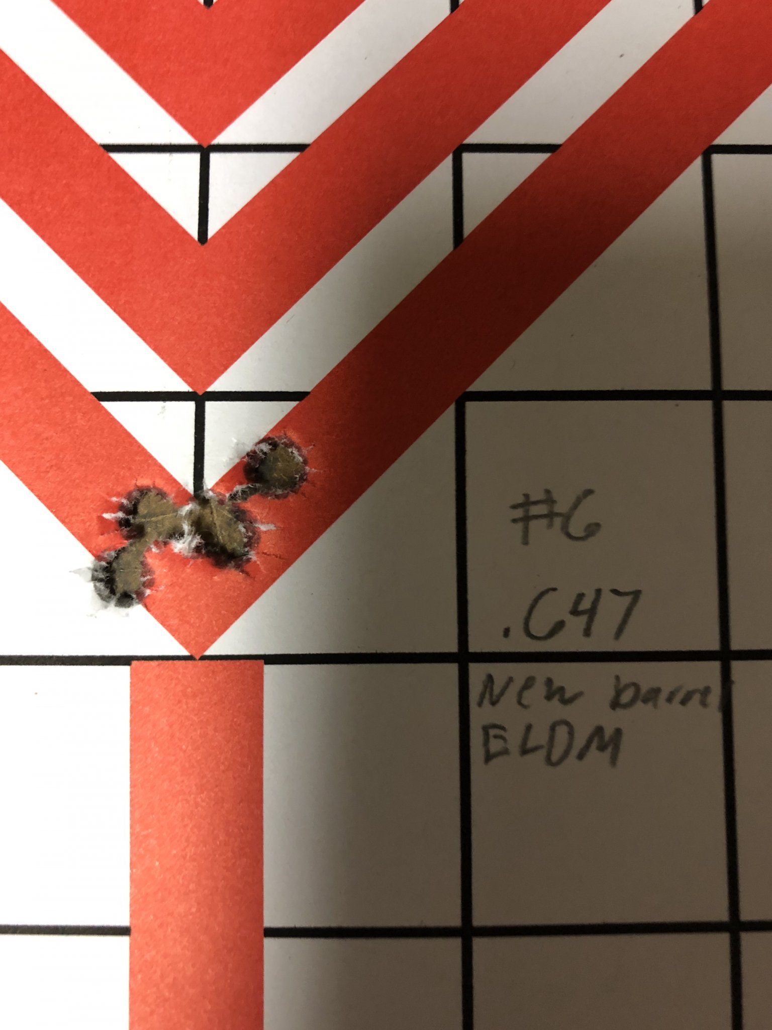

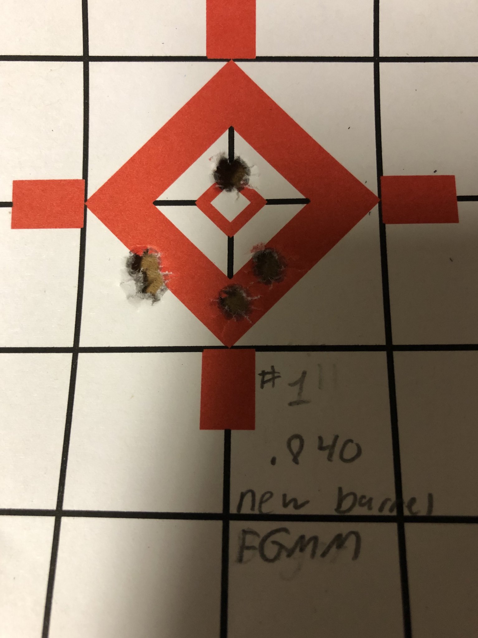

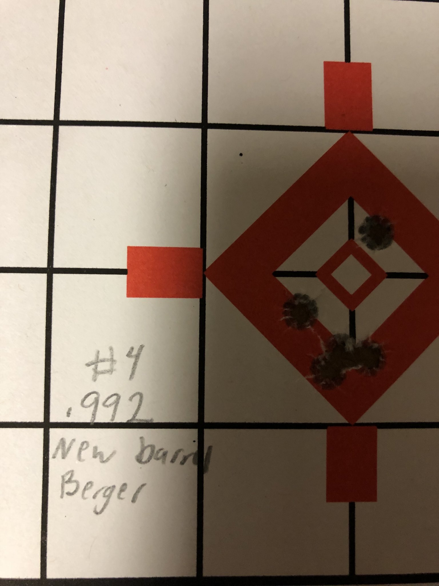

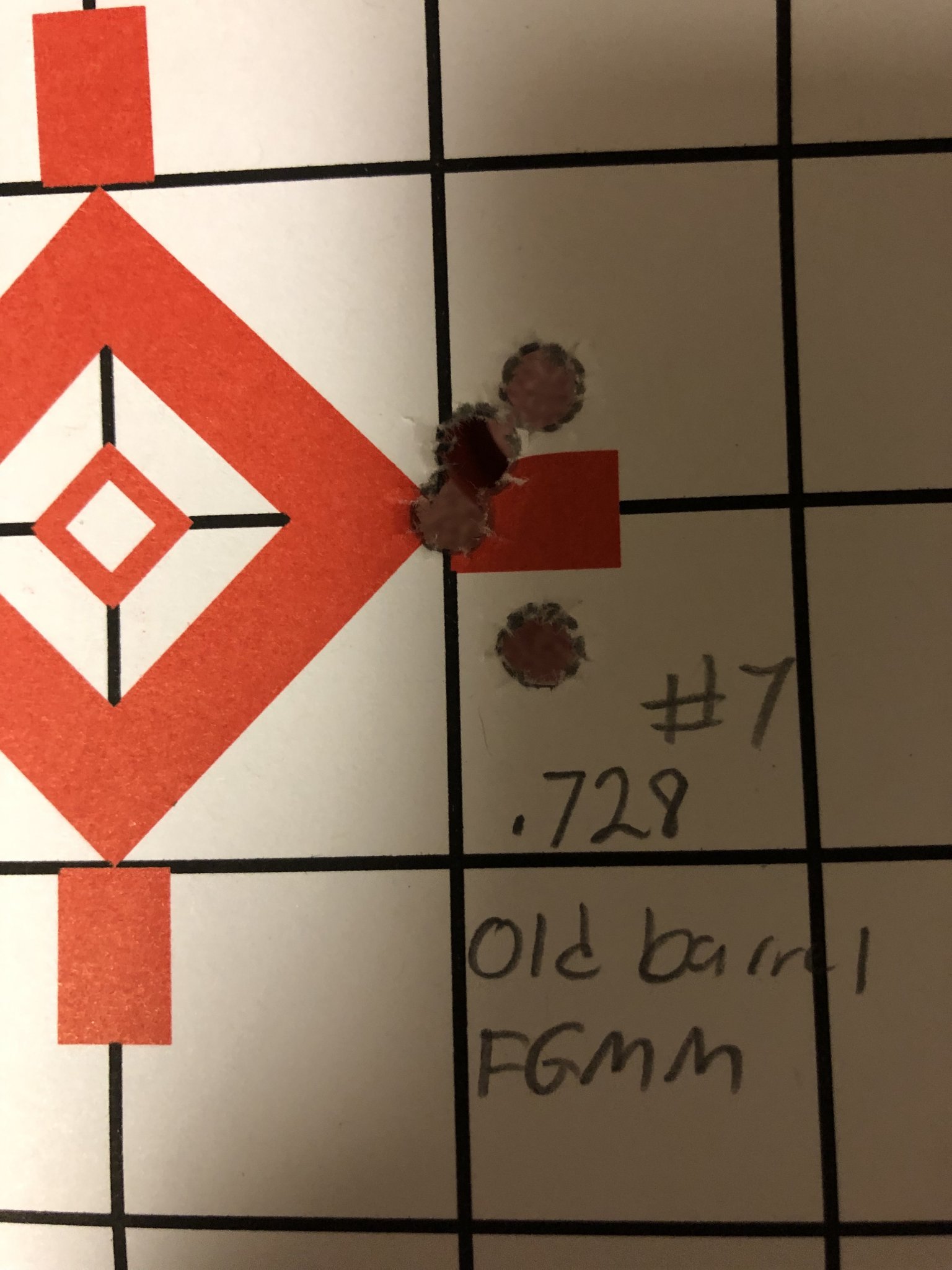

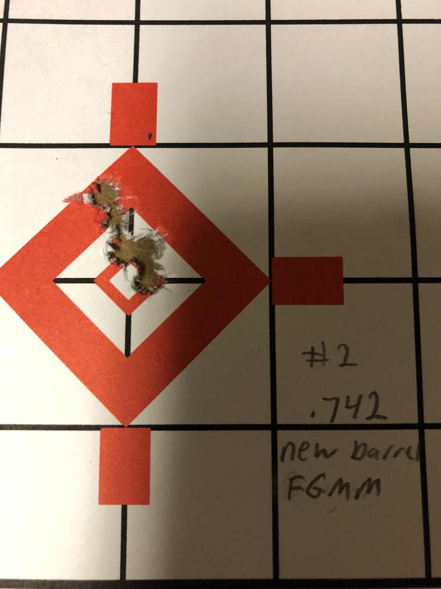

Groups with the other loads and the surefire brake:
Other groups with the Bergers and FGMM:

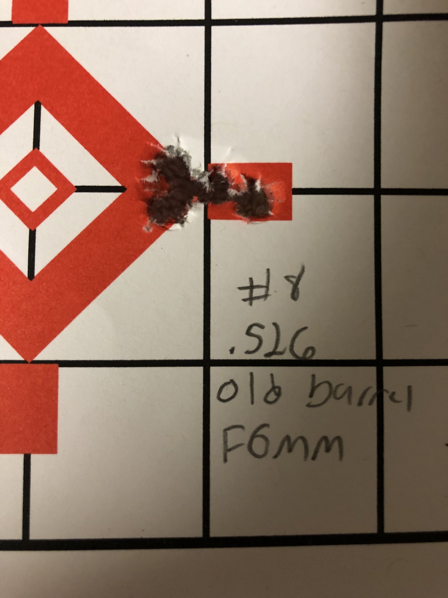

The Prime and Hornady after removing the brake and reinstalling the barrel:

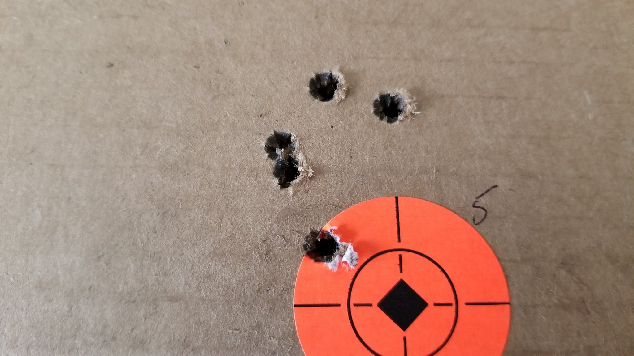

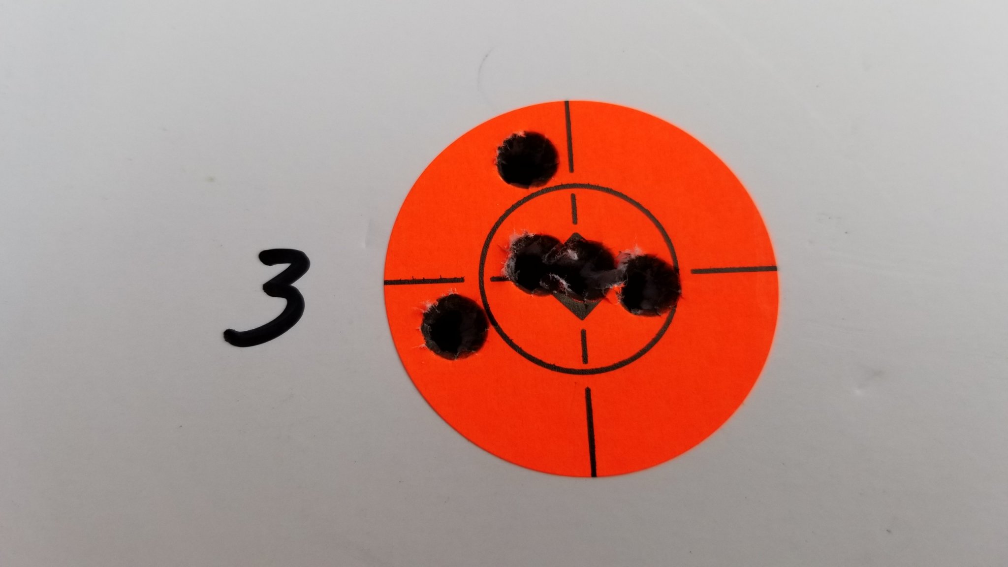

ill look for some pics but i tried 3 boxes of each copper creek (with lapua brass):
mile high gradious 260 barrel
berger
scenar
SMK
berger shot like pics above (sold the remainder to some on the hide a few months ago)
scenar shot the best/very good. 1/2 moa
SMK was acceptable .5-.75 moa

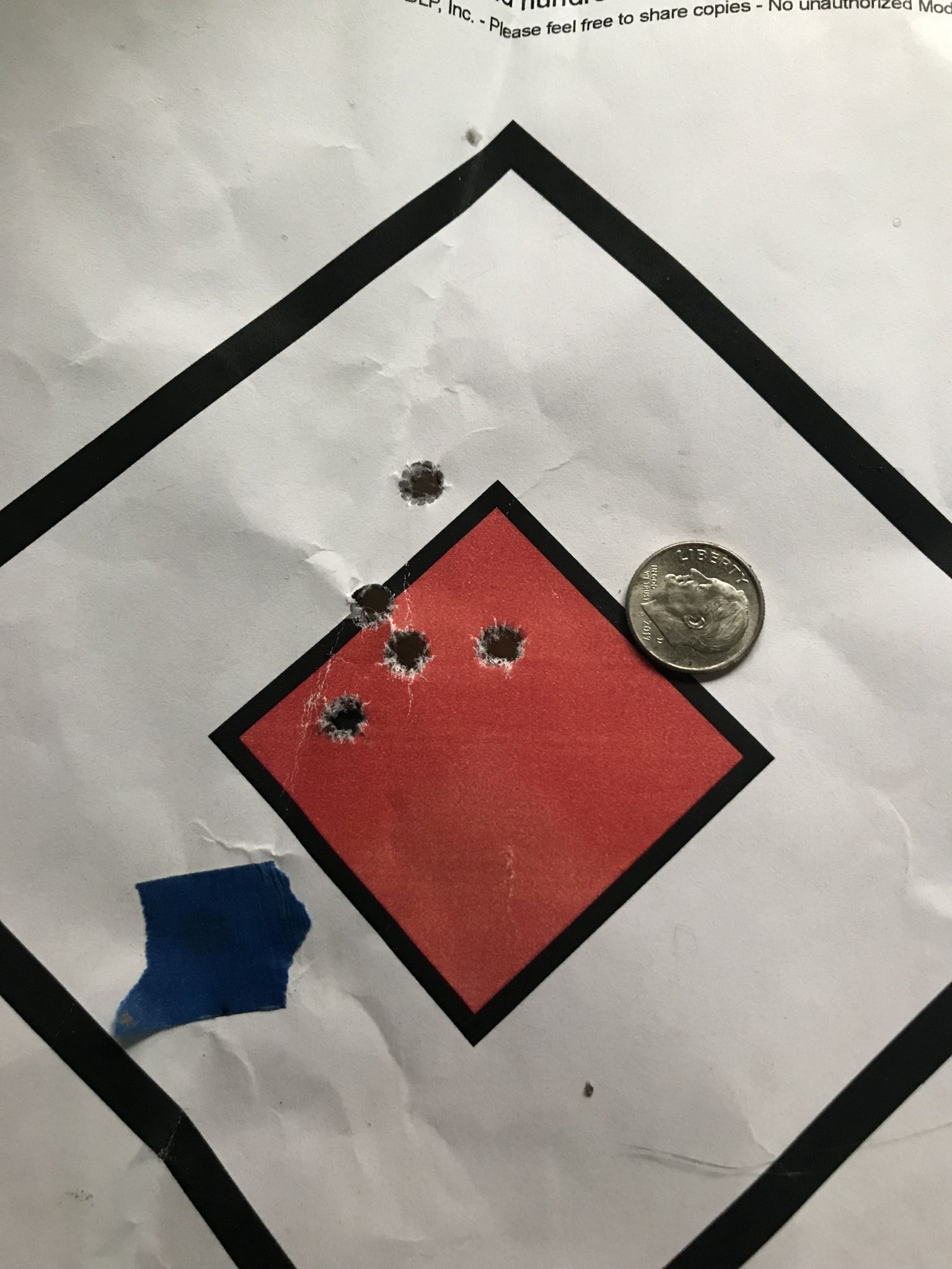

So far, no issues with my loads in it either. Here's 10rds of 139 Scenars over 42.8gr H4350 at 200 (2800fps). Measures 2/3moa:

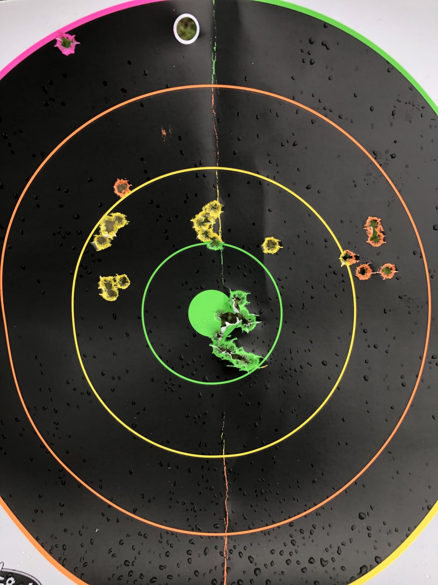

The temp strip was working well. I fired string and then used the magnetospeed rifle kuhl to drop the temp back down to 95 degrees. This temp was after a 6-shot string on a 78 degree day.
The results, I should have done better but I was rushed to see my wife off to of all things, Yoga Camp.
