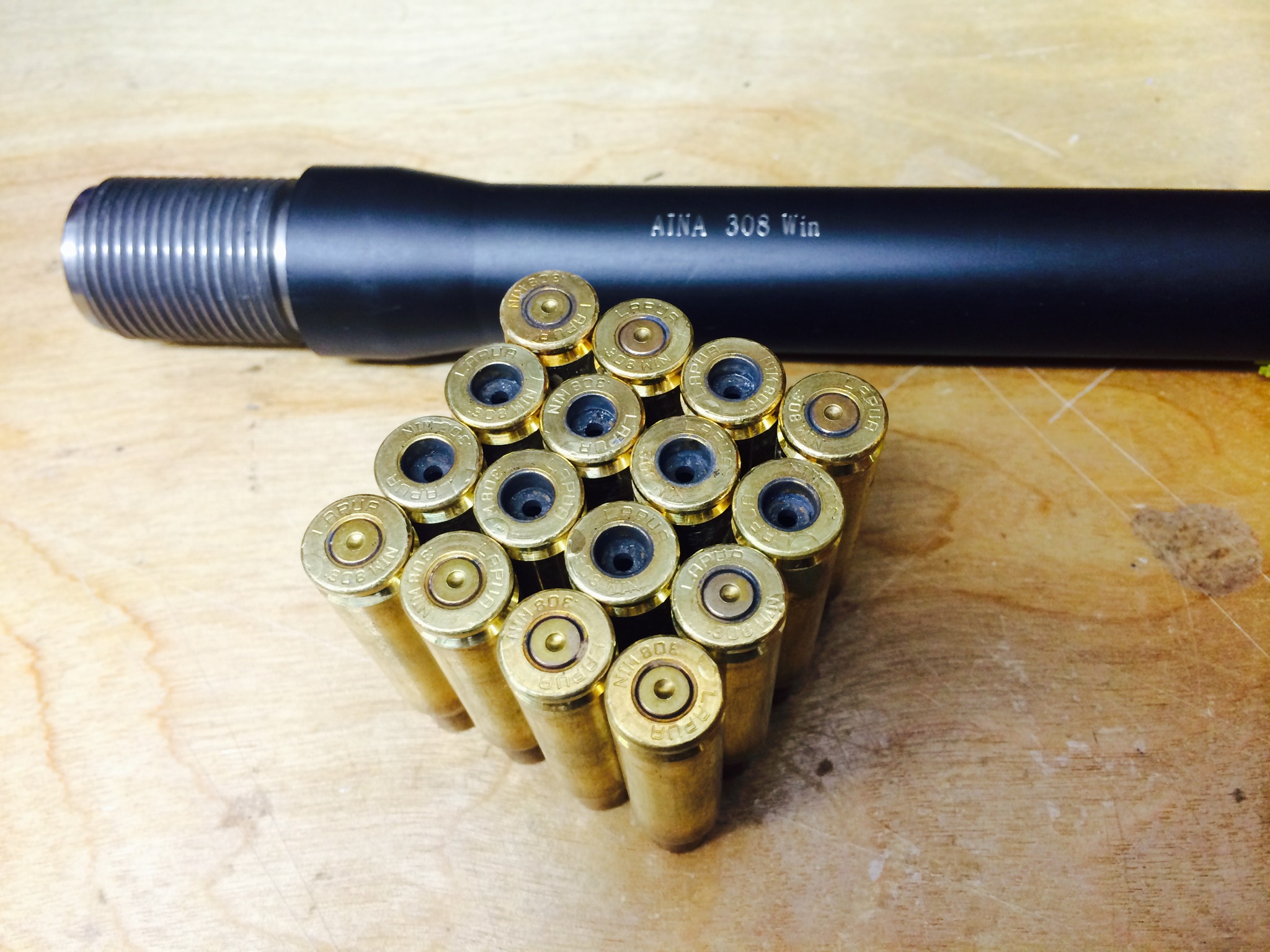

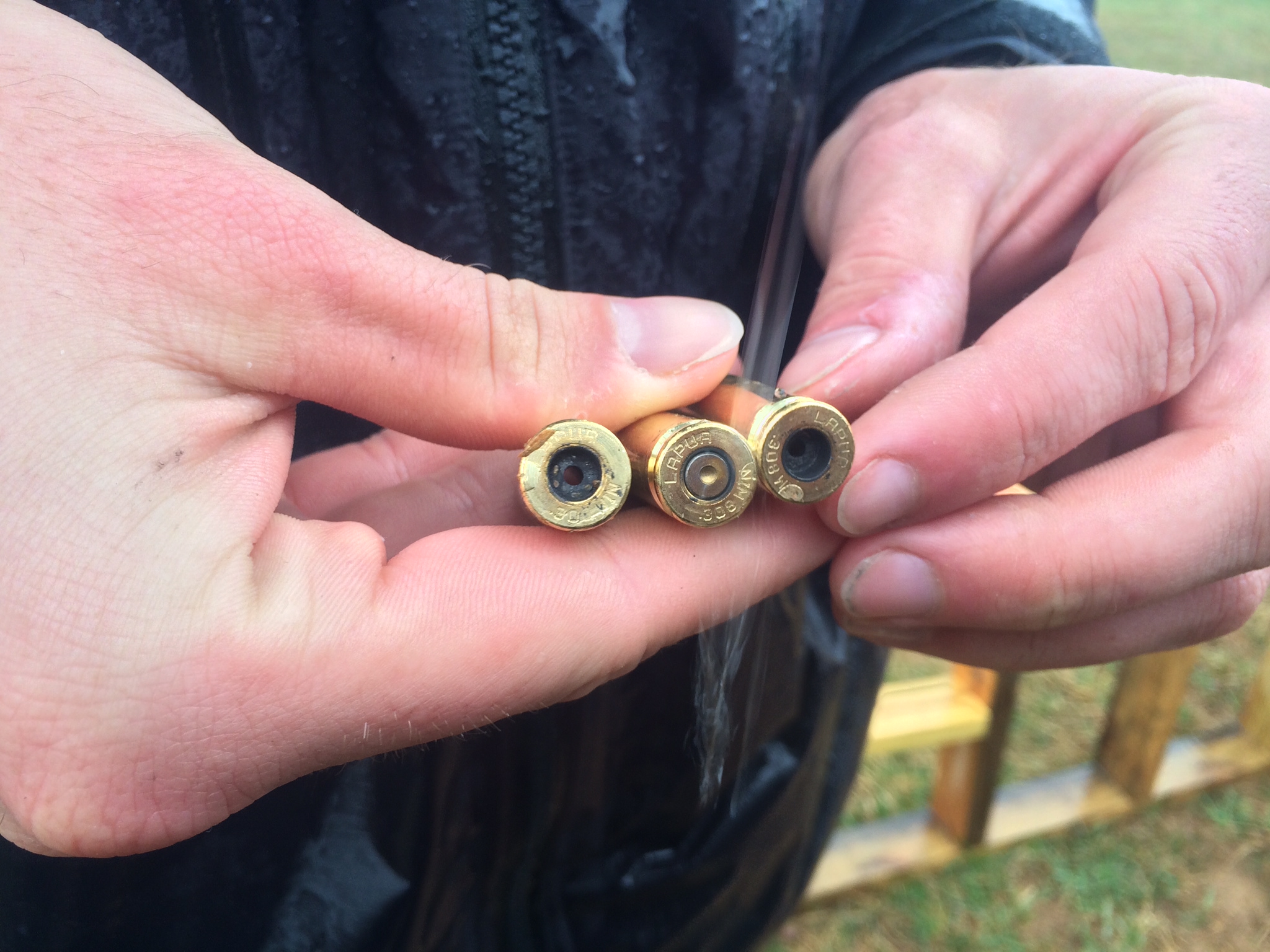

The only AI that I have ever seen fail at a match was my own after I pierced enough primers with high pressure ammo and small primers in my large pin AXMC to finally jam the firing pin up with pieces of primer cup. I knew this was a problem with large pins and I fucked around and found out.
On another note I was shooting another AX one day years before that with very hot loaded ammo in heavy rain and it was blowing the primers out of the cases and several went into the bolt lug recess and that gun was literally eating primers and did not stop functioning. They are beasts and there’s really nothing else that even gives them a run for their money.

Here’s a nice little timeline of that day from the ol iPhone photo bank. The conditions driving out, the conditions there, a few of the pieces of brass during while we were laughing out asses off that this gun was still working, and then the aftermath of how many primers that rifle ate and didn’t skip a beat.
I like Surgeon actions and love impact actions, but they WILL NOT run with an AI when the conditions are shit. I’ve shot matches where my rifle was caked in mud and it didn’t stop working when others were struggling to get a single round off.

The SH reloading mantra: We start at book max and work our way up! 😂 Fukushima then we work our way up to Chernobyl loads.
That was 45gr of Varget behind 185gr Juggs. Maybe slightly over pressure but not that much. You can be well under max pressure and introduce water into the chamber and pressure goes up. I’ve had pressure signs shooting in the rain with FGMM which is far from hot ammo.
The key takeaway here is that the rifle didn’t give a shit.
