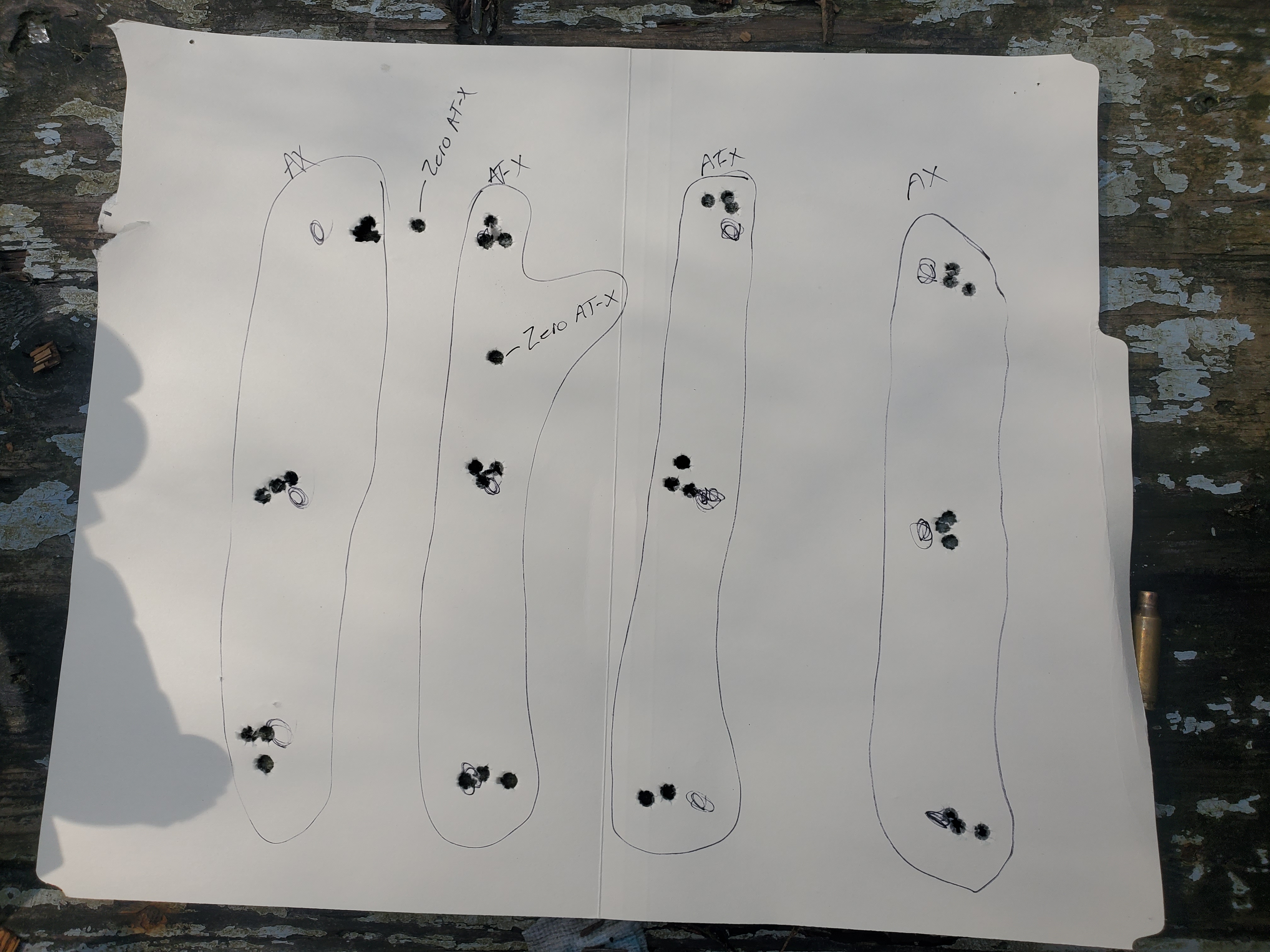

Here is from today. AX with an AI Proof that has ~1,500rds and AT-X with a new 0 round Bartlien AI barrel. I was taking calls and clicked the wrong way a couple of times if your wondering why your seeing the groups shift around. I have a couple of fliers in the mix, but overall they both seem to shoot better then I can.
The AX has been broken in. So it's smooth and since the grip fits my hand the original AX looks better then the AR grip on the AT-X. the forend feels better in the hand and it has a ATACR 5-25, which a lot of people crap on, which I prefer over the Vortex Razor Gen3 6-36 on the AT-x. The difference isn't huge, but I grab the AX just about every time I go out unless the kids are coming and need something to shoot as well.
