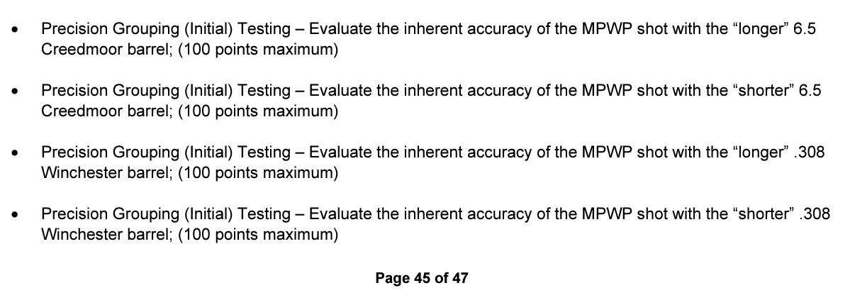

What is this part number - the bag rider ?
What caliper the border patrol get ?
I won’t make a comment about it must be for shooting g people trying to prevent border invasions
Only 6.5 CM and .308??
Per this document:

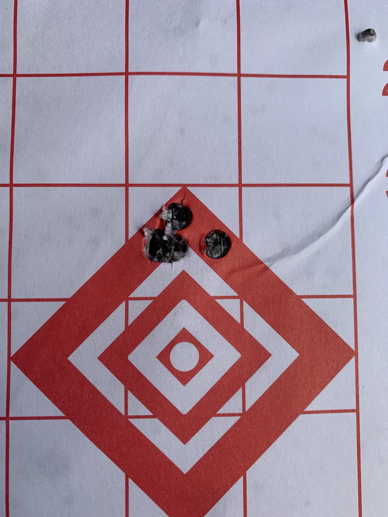

Mine did this as it’s very first attempt at a group, if memory serves it was 6 rounds, and I’m pretty sure the “flyer” was my fault.

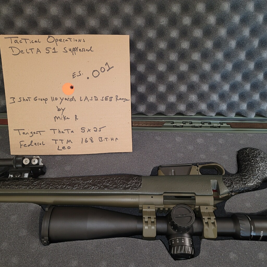

You could always go over to the TAC Ops thread. Same thing as what @RUN8 said but with smaller groups.
I don't own either. I'm Tikka budget and left handed.
No shade meant on you at all. You're better than I am.
This is what I'm talking about. Factory test target.
That’s gonna be a tough act to follow.
I suspect my AT-X is probably sub 1/2 MOA capable on a consistent basis with the right ammo. Sadly the rifle operator is not…

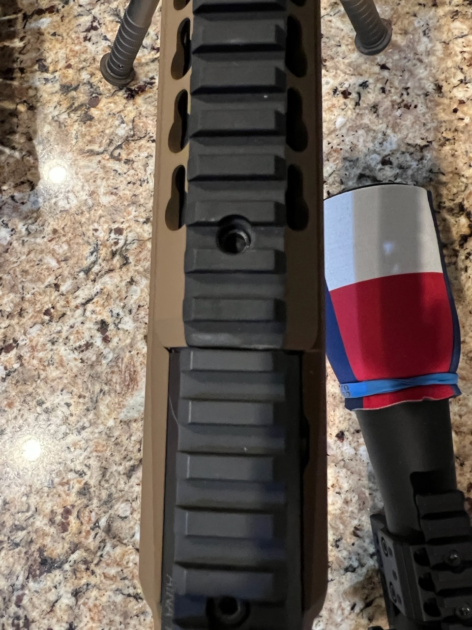

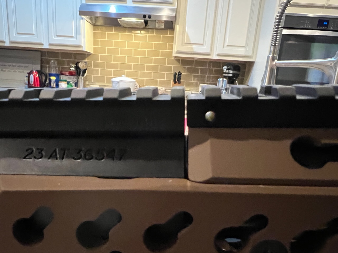

Anyone who removed the action rail, do i hit it with blow torch for the bolts?
Heat is to break adhesive. By design spec of the adhesive companies, you don't need heat to standard grades of threadlock like 242/243 (loctite "blue" ).
Certainly you can ask/confirm with AINA, or one of the retailers like Eurooptic or Mile high, if needed, as the issue is if the OEM uses stronger adhesive from the factor. Eg, epoxy bedding or something like red locktite, intended for a semi-permanent instaltion.
Also, +1 on soldering iron (not a torch !) if heat is needed.
Reactions: xxflyingturtlexx
Soldering iron is good idea and cleaner work, thanks for the advice.
I called AI and techs were out; the lady on the phone took my question and few min later to my surprise called back. She said she spoke to assembly line and they just use small amount of 243 loctite. Taking the rail was a breeze. T15 bits 3 nice taps and they came loose.
I realized i did not have any 243 at home and will torque everything tomorrow. I also installed 12 oclock rail. I still need to tighten the gap a tad I don’t know how much more room i have left.

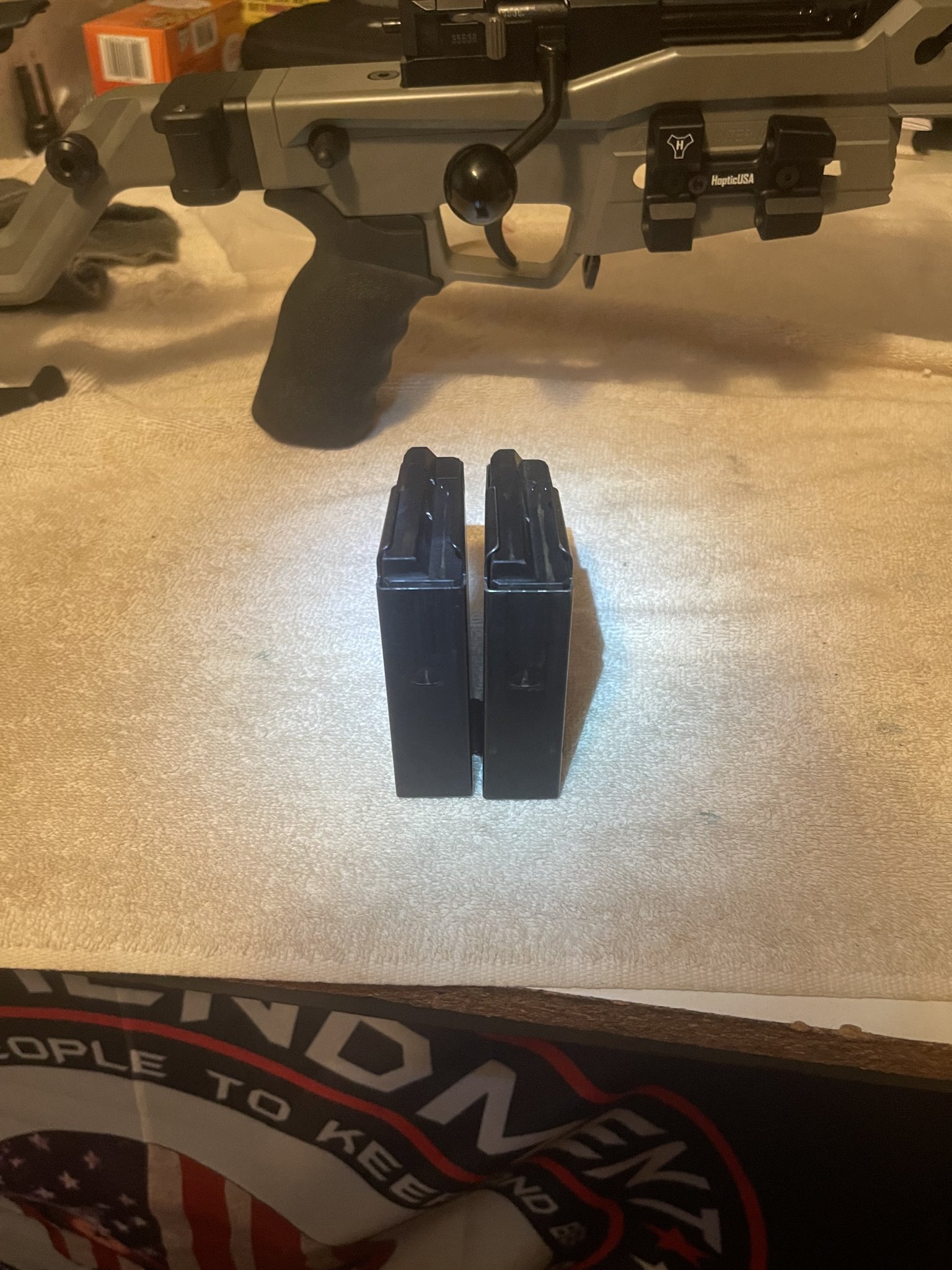

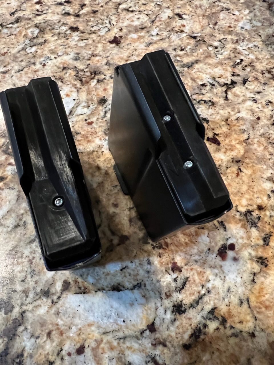

Also received mags from Mile High and the followers are not same as the one came with the rifle, do i buy new followers? I told them it would be for 6mm while ordering on the phone….
(One on the left is what the rifle came with)
I want new followers for all my AW mags, no answer on where to get them yet. In your photo the L follower is the newest design, R is the same old stuff.

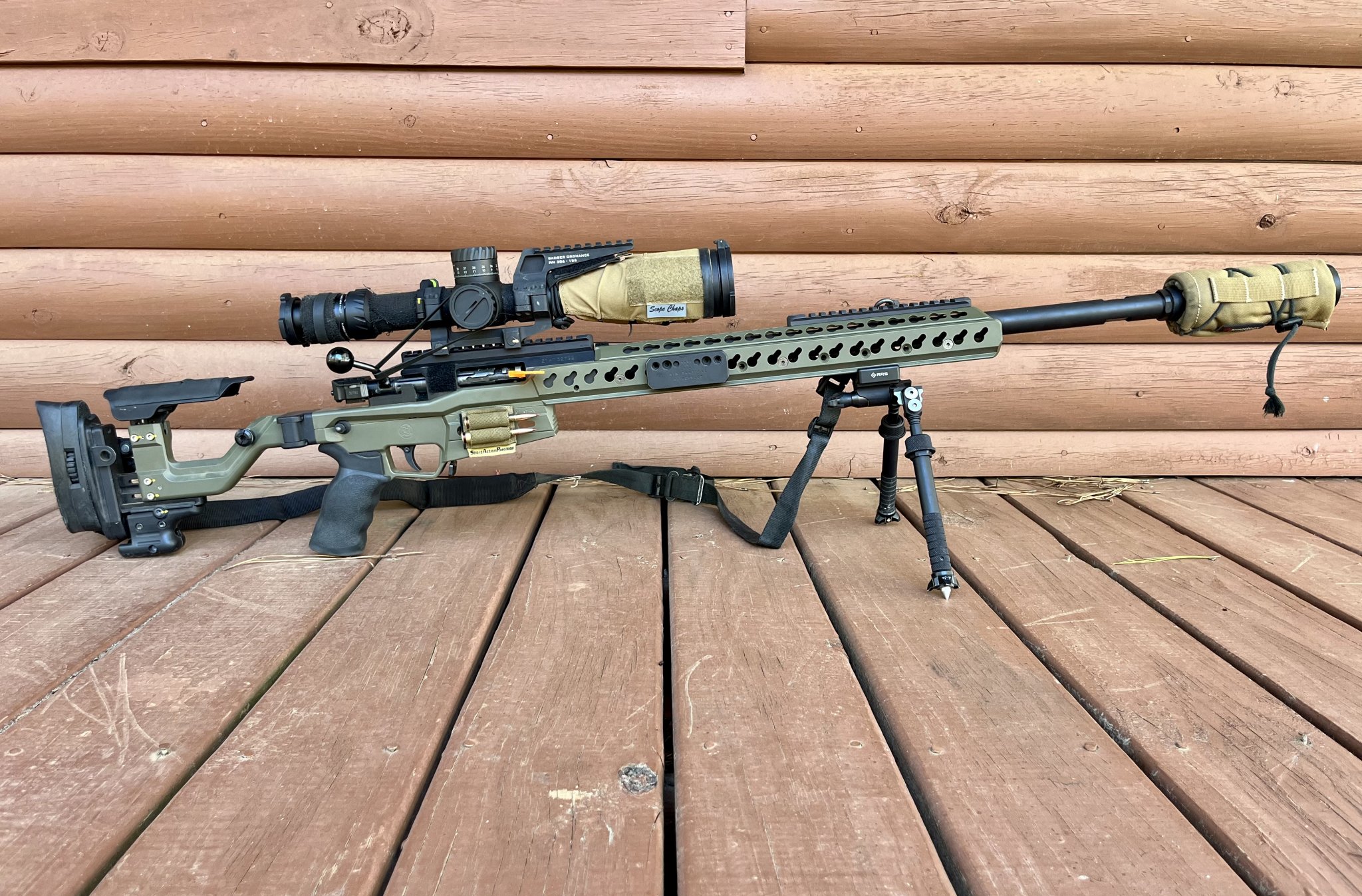

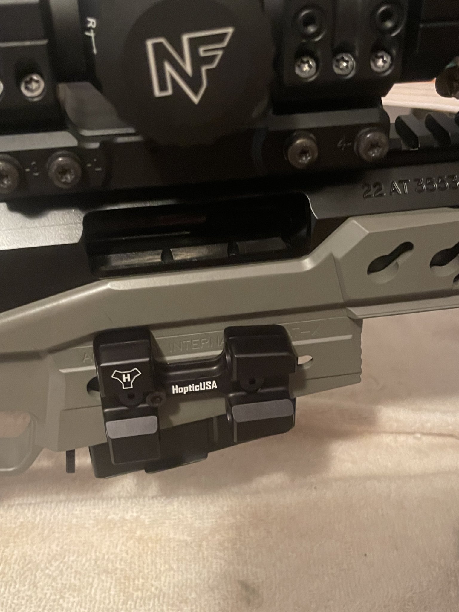

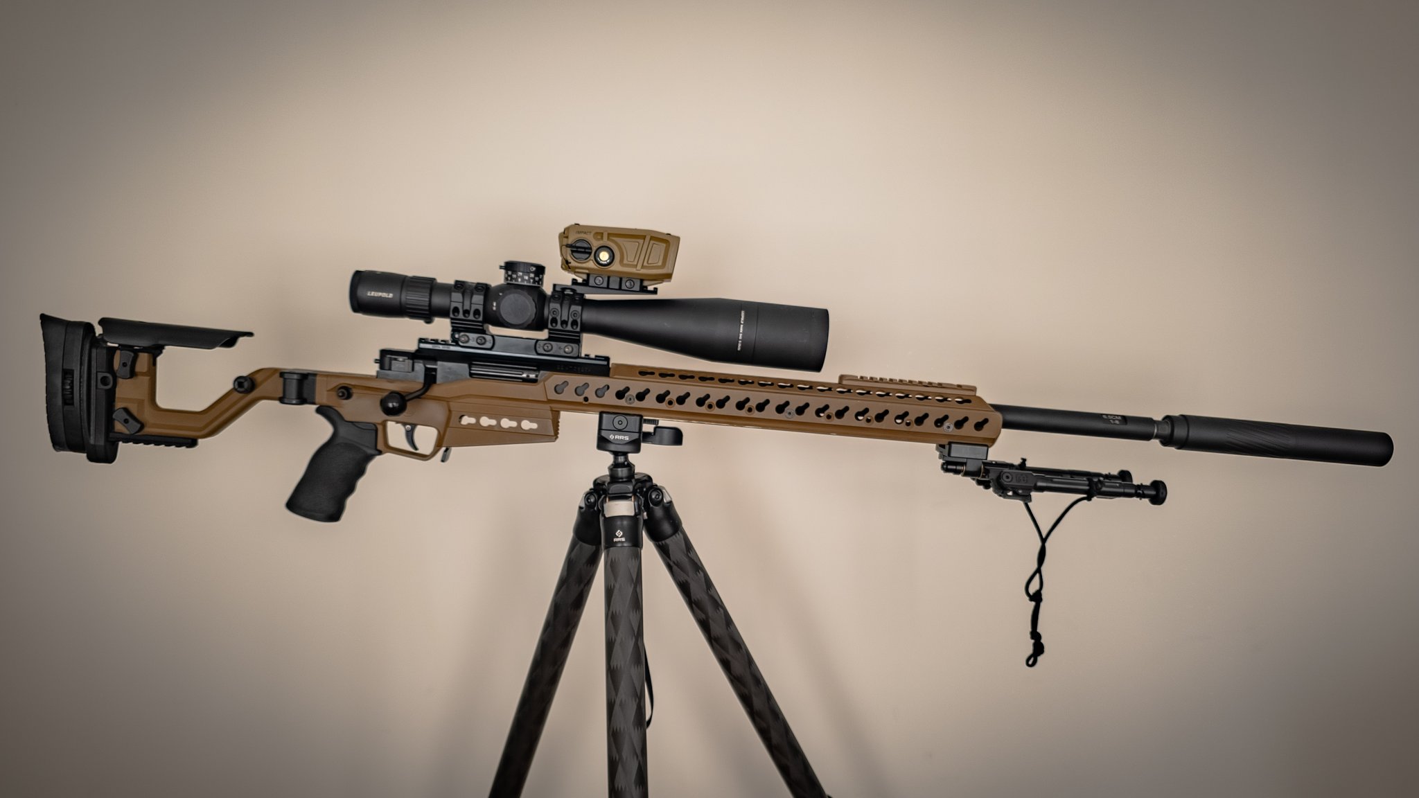

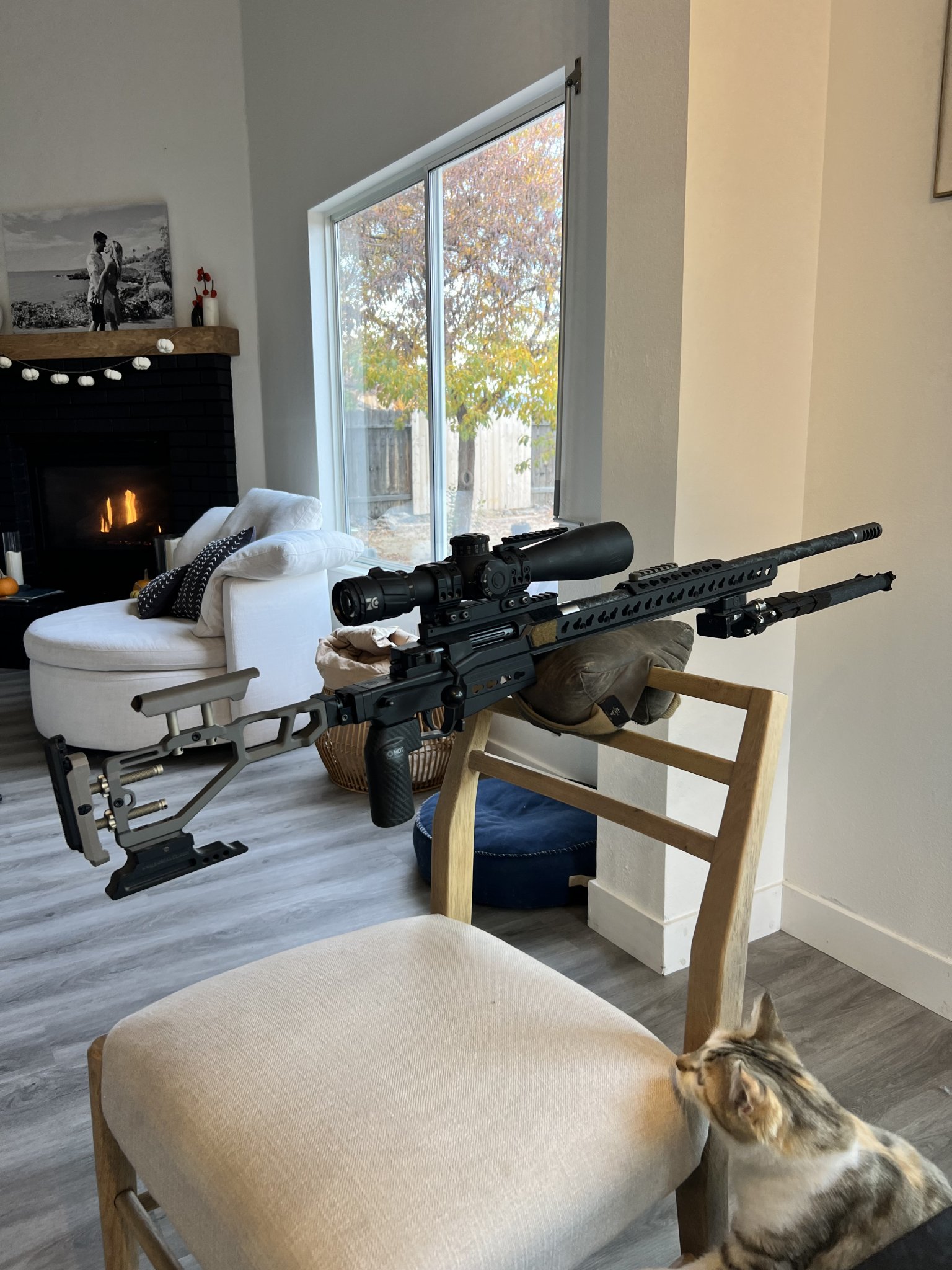

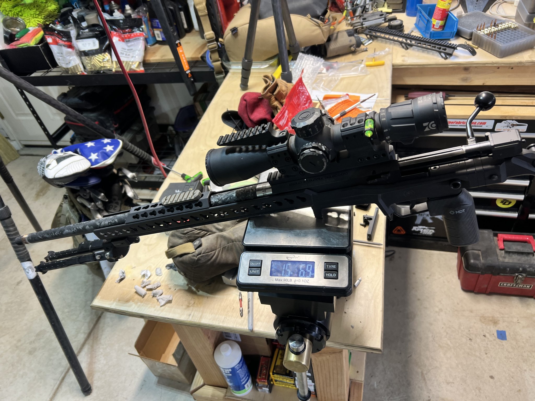

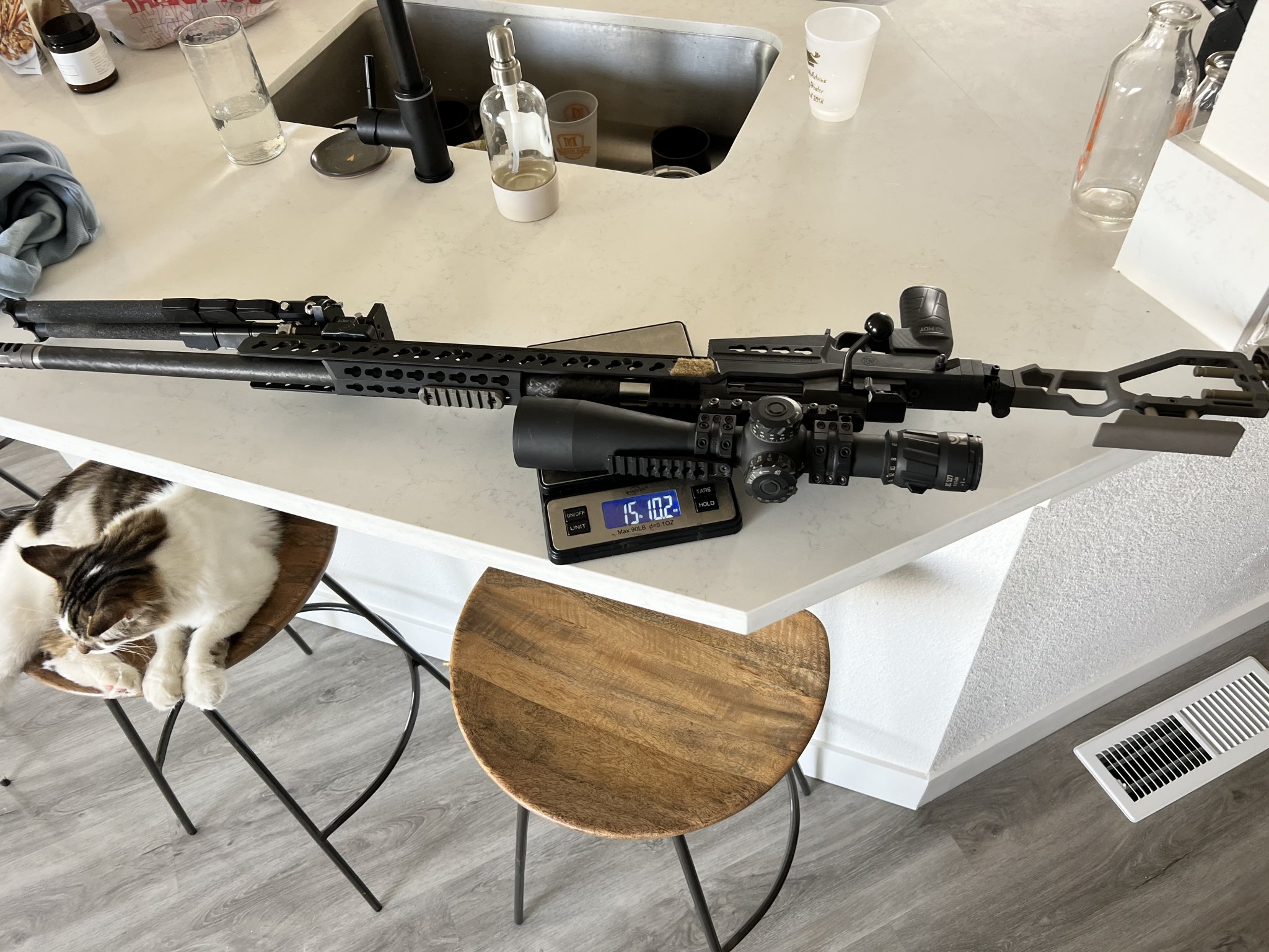

It is possible to get these down to under 16 with a triple pull. Plenty of room with the factory stock and light weight double pull also.
Triple pull
Zco 5-27 spuhr 1.5”
Short top rail
26” proof 6.5x47
mdt carbon grip
Q fix stock with custom adapter.

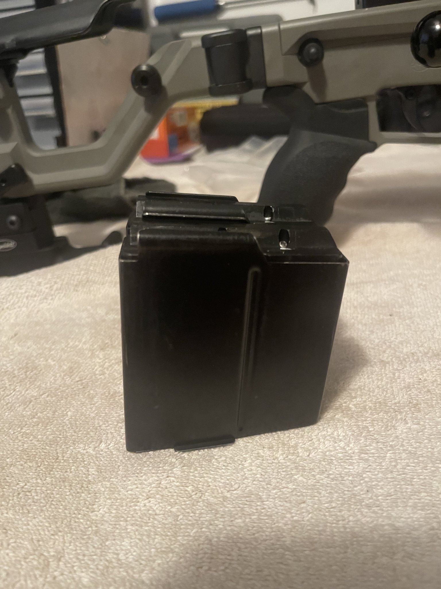

Question:
I recently traded for a ATX. Came with a mag identical to my AT/AW mag. I see it listed on mile high that the ATX mag is the same as the AX
Both mags pictured are rock solid in my AT. Both however in the ATX lock up in the gun but if you grab the mag in the front you can pull it down slightly. Basically the tip of the bullet hits the feed ramps a bit lower. Mag locks there and you need to hit mag release to reset to normal height
Is this because it’s an AW mag and will an AX mag do this
