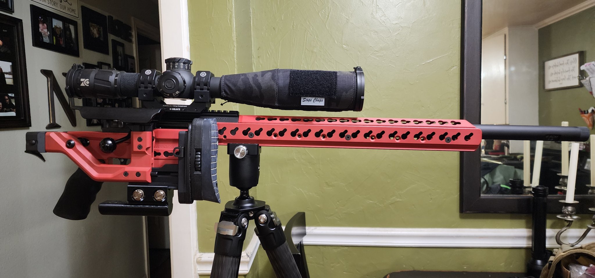

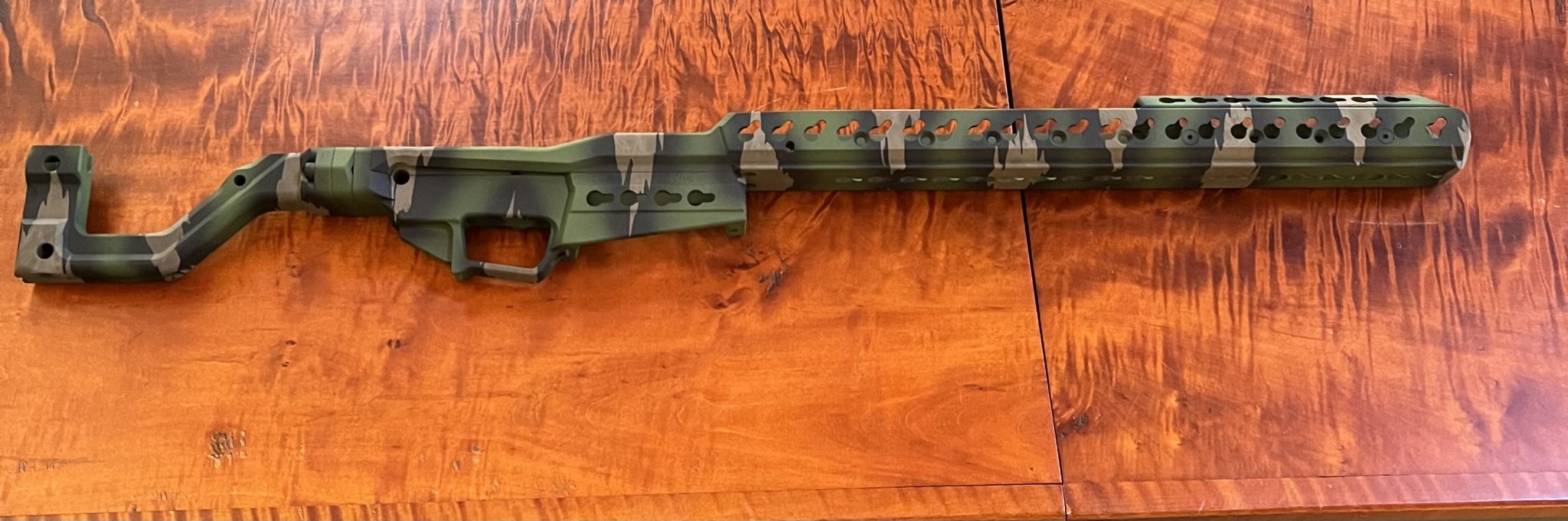

Slung some paint!

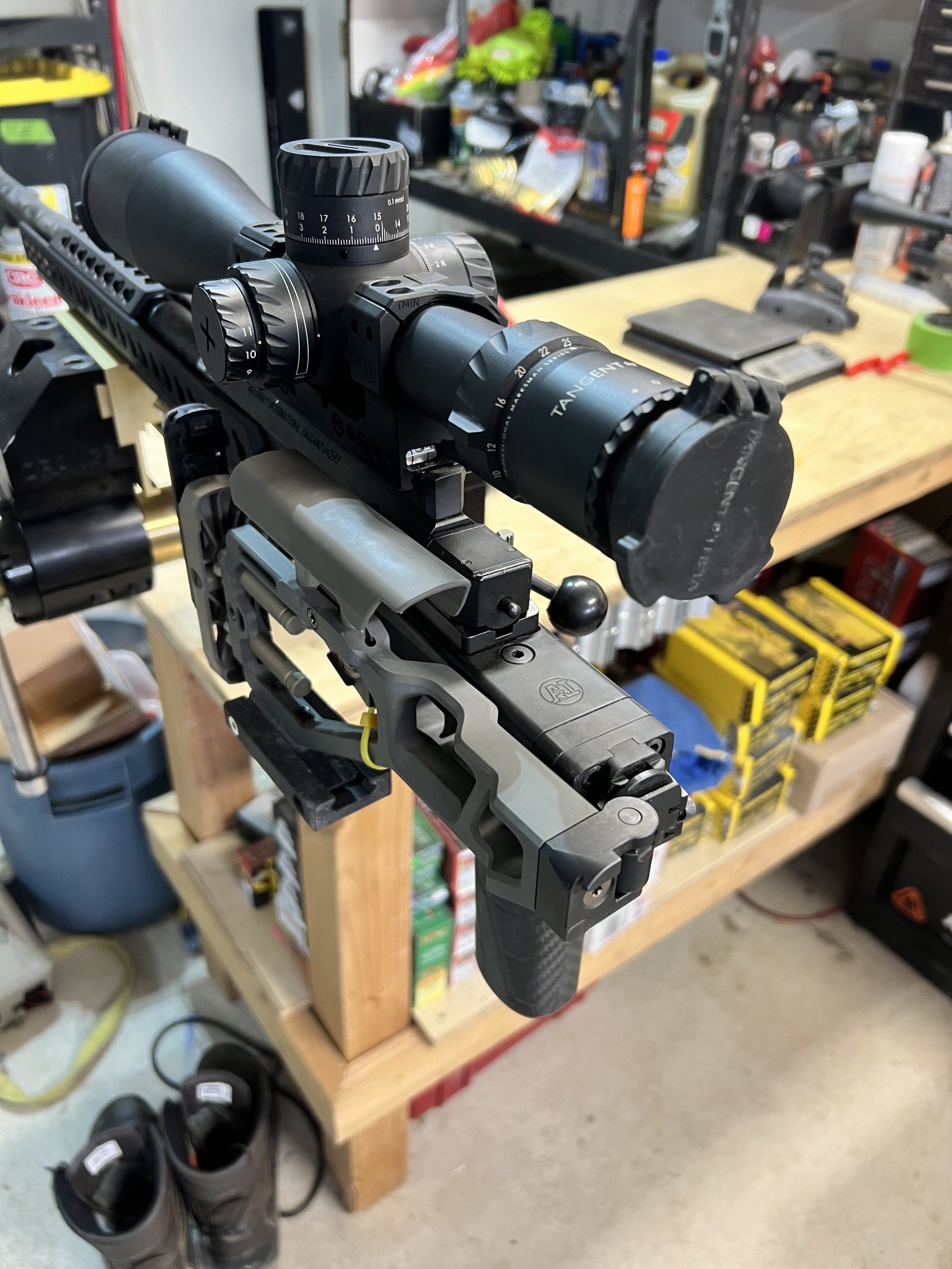

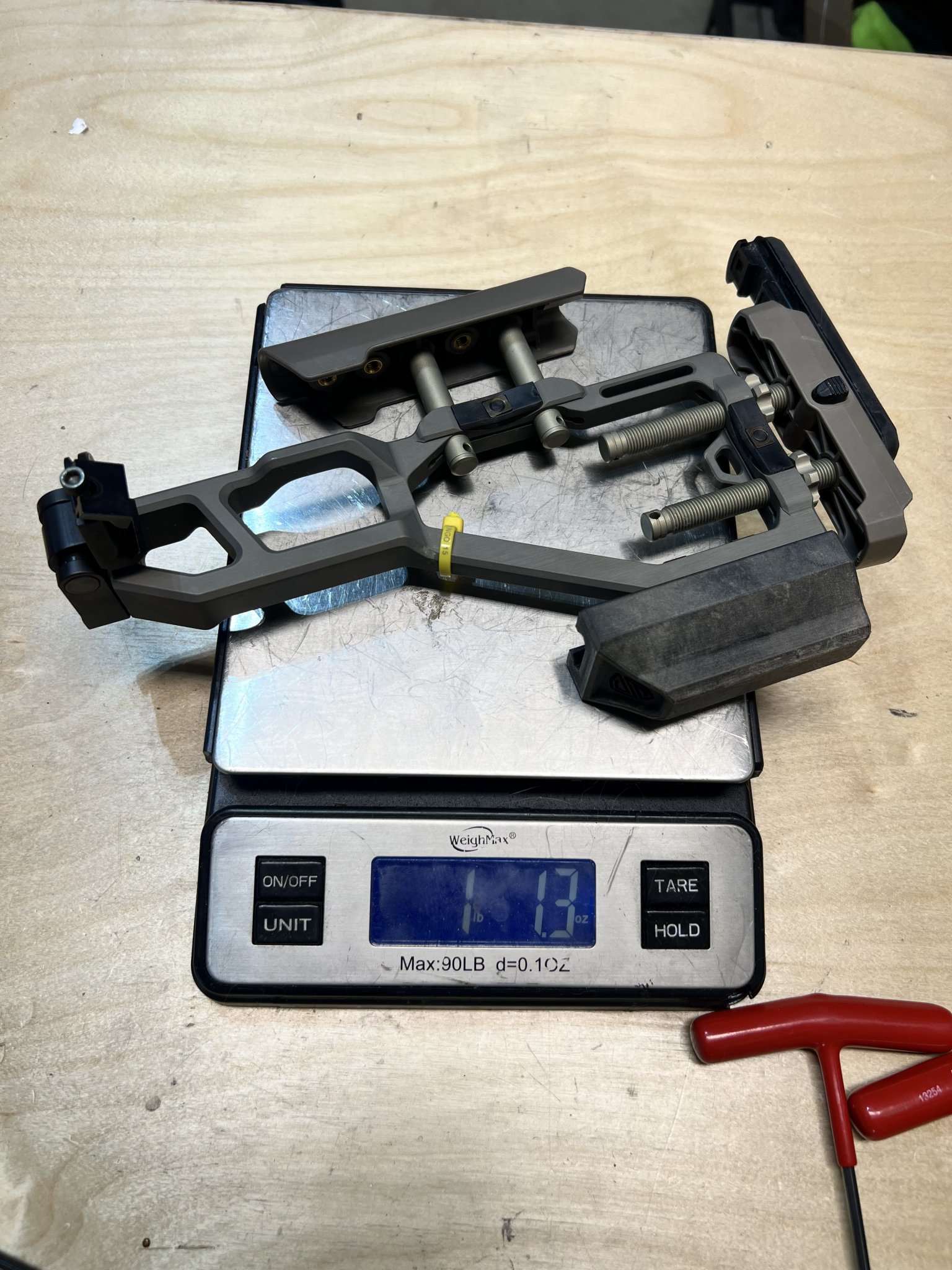

Nice - I stripped one of the screws trying to take the low action rail off trying to put the high rail on....what kind of apes put those on?
I think the screw heads are soft and loose. I bet it didn't even take much force to strip. On advise of this thread I didn't even bother with the hex heads and tapped a T15 bit into the hex head and then they backed out without any issue.
Reactions: goatboy and bnaples

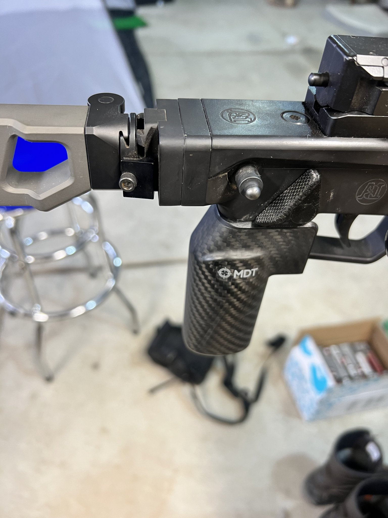

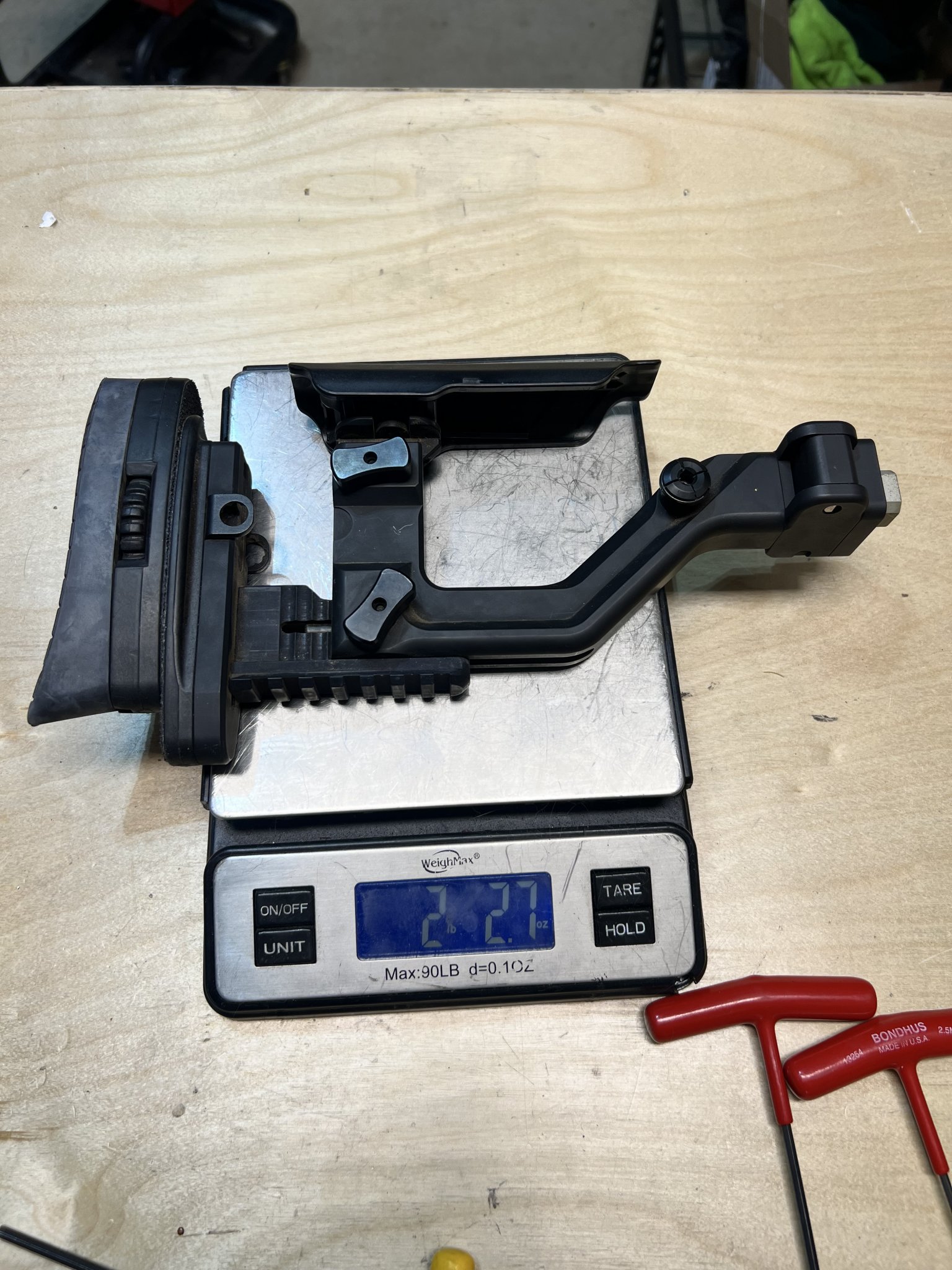

Did you machine up an adapter to use the Q stock? That looks fantastic.

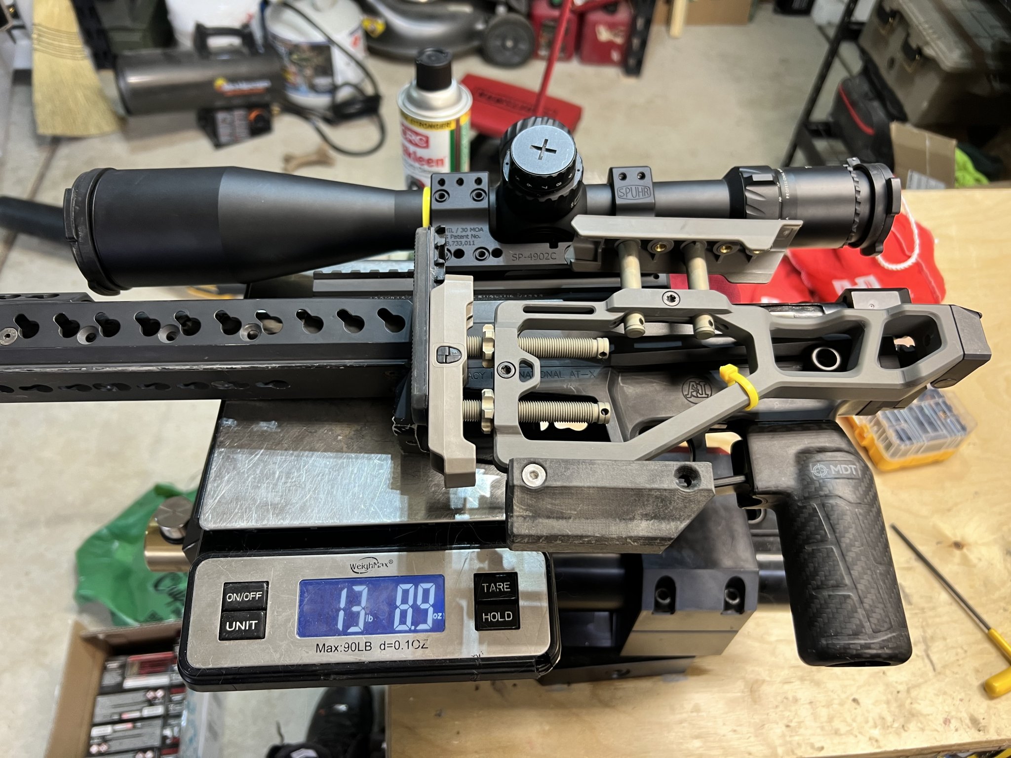

This is with the high rail and a short top bridge. I left the bag rider on the stock. It’s about 1.6 oz so not much to it.
