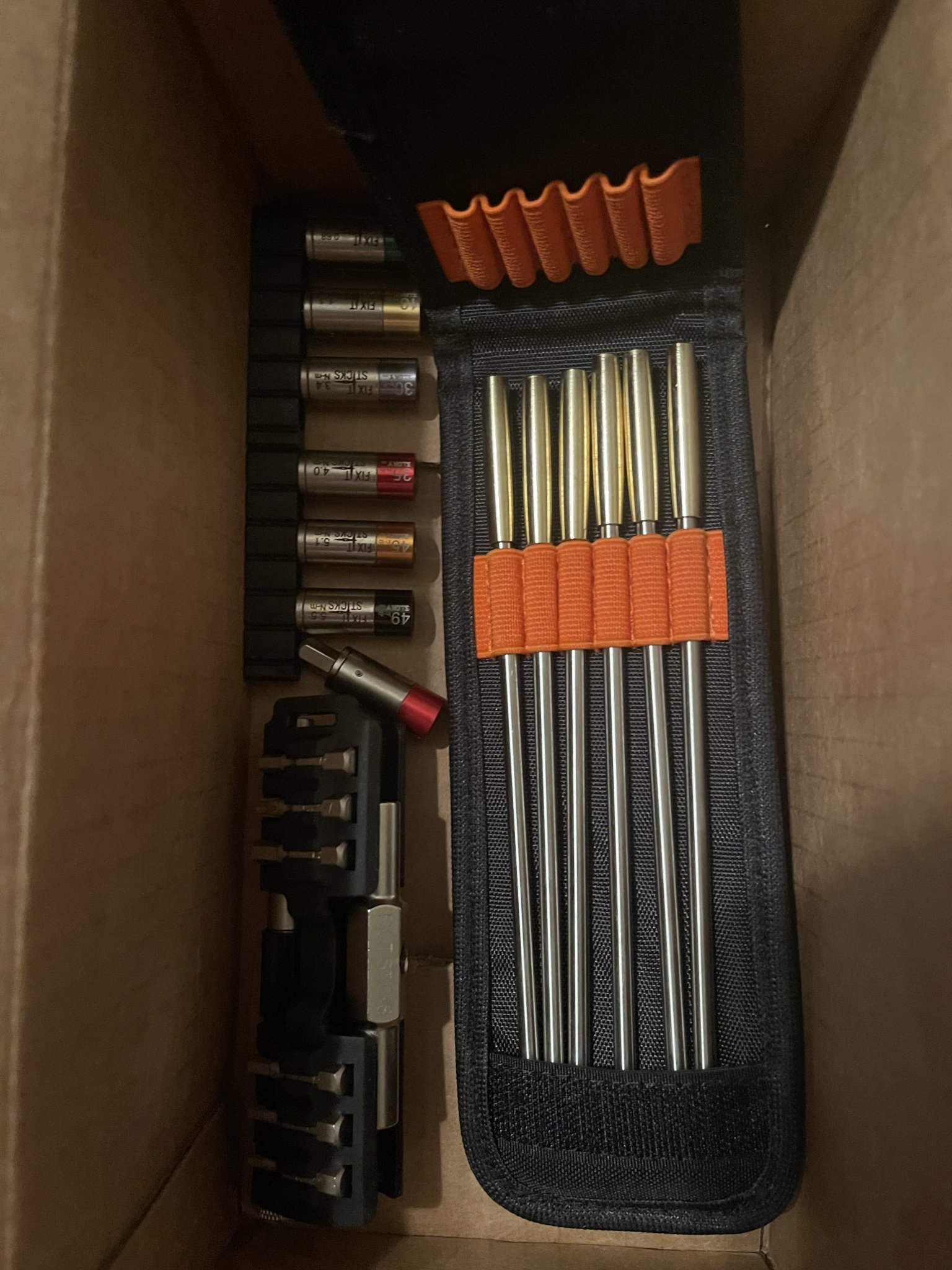

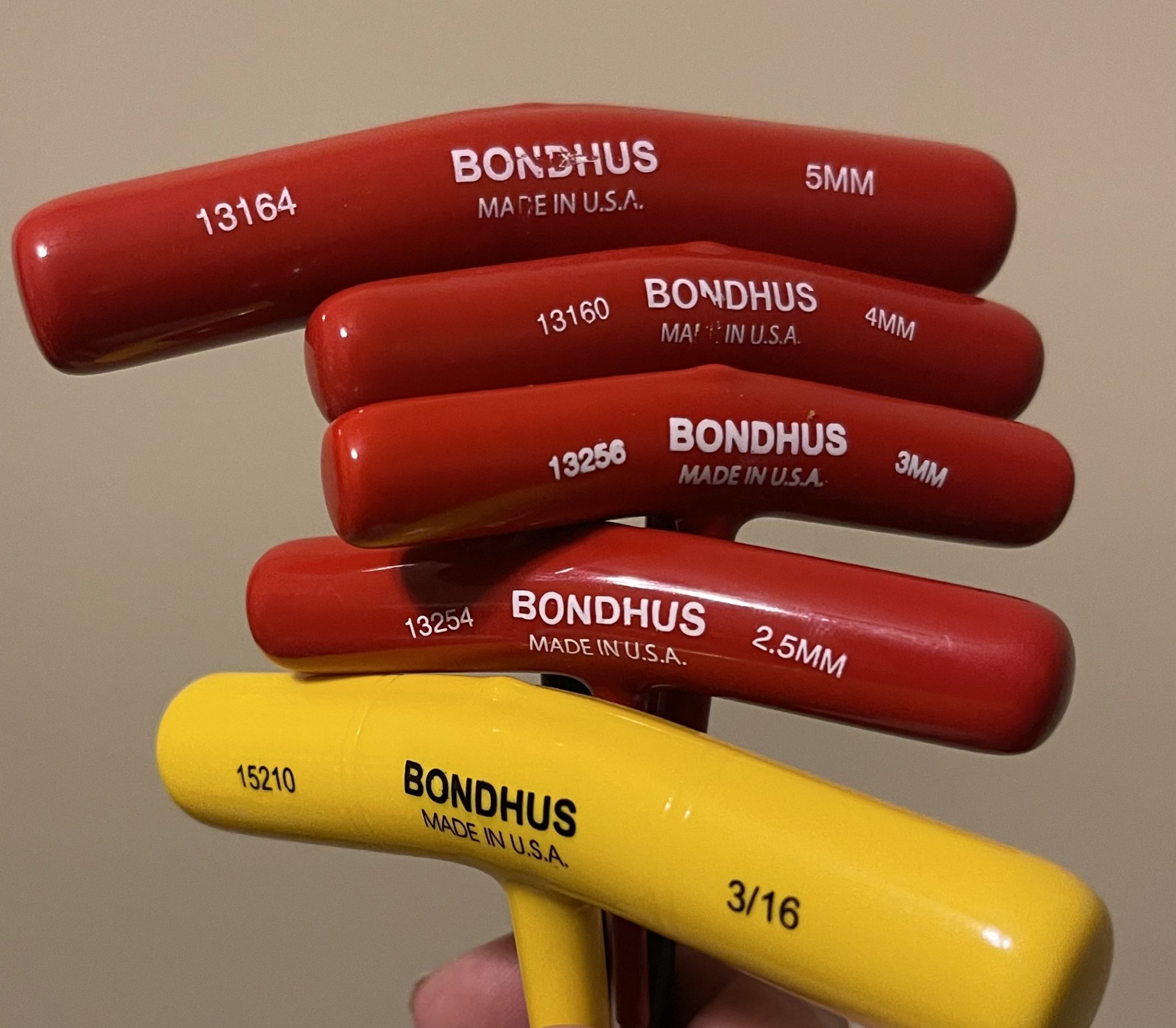

I’m working on a “kit” for the X. Basically all the tools you need to disassemble and reassemble as well as tork it all down.
Getting T handle stuff for coarse work, and fix it sticks for the torque.
I’ll update with pics and complete list once it’s assembled this week.

I have to admit, when I first read your post I was thinking "Why is he buying wrenches for his ex-wife?" 😂
Really interested in this, I was thinking of doing the same. Look forward to seeing your setup and list.
It might not be any less expensive than just buying the long range kit from fix it sticks.
But I wanted a specific set that only has exactly what I need for this rifle. Just cause……well…..I don’t know. But it made sense at the time.

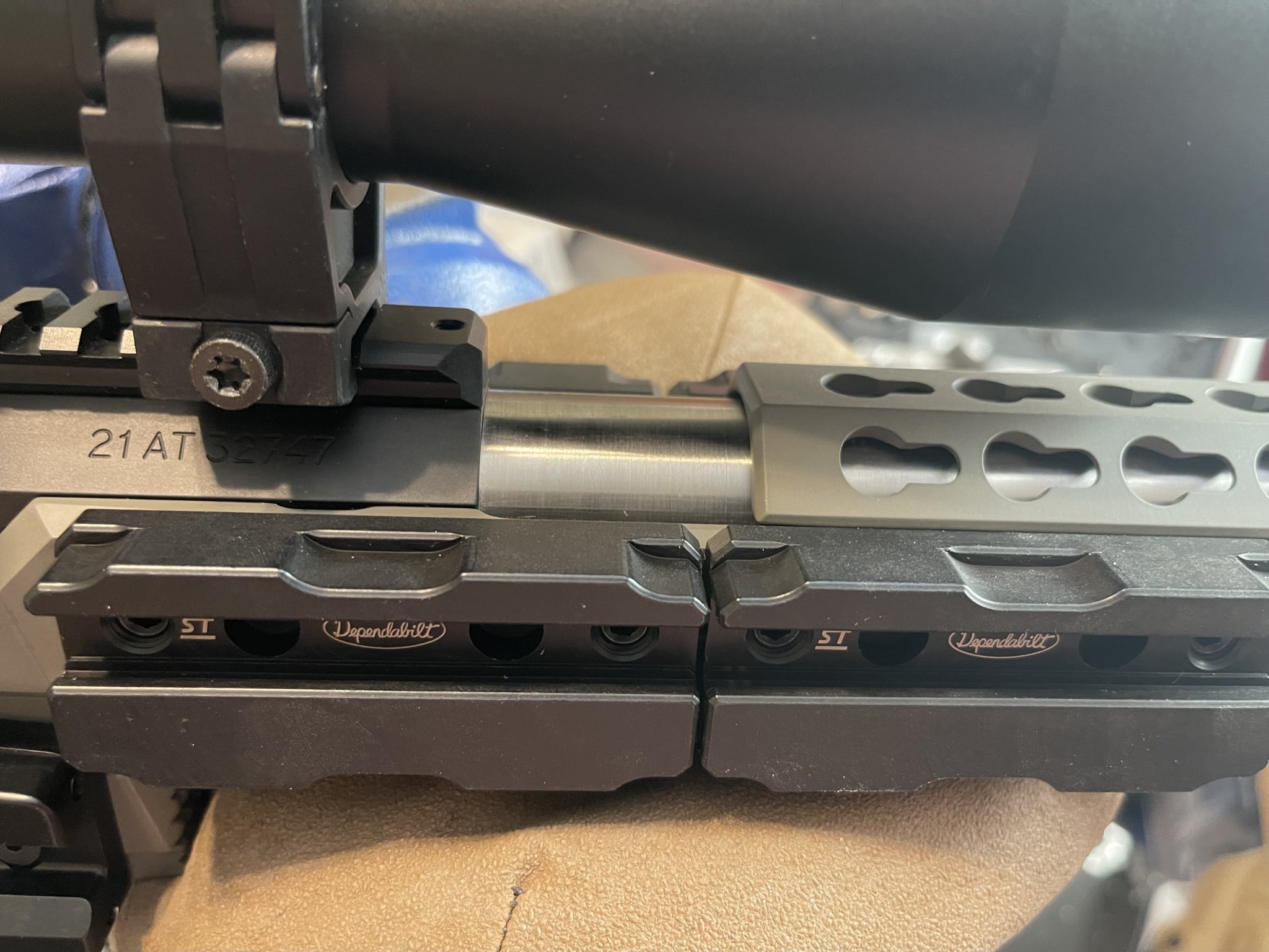

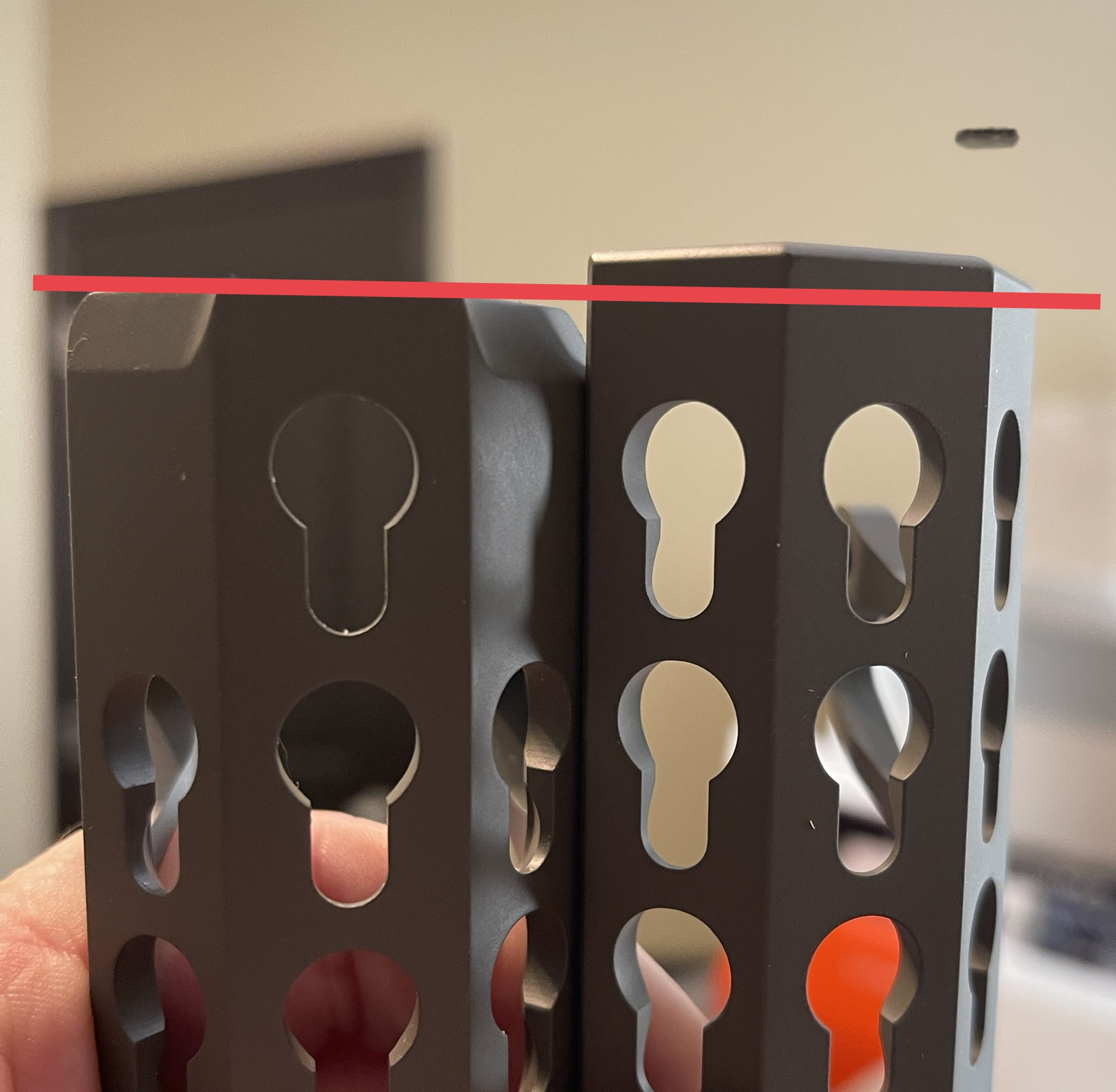

Small suggesting for future short nvg rail production:
Keep the rear the same length and contour as the long rail. I picked up a short to run 1.25” without turning barrel to 1.20. Since the only part that touches is further away from action during recoil.
The area where there is a gap is where I rest my thumb at times when grabbing front of rail.
I’d imagine others do as well. Not a huge deal. But seems like easy way to give end user more mounting options.

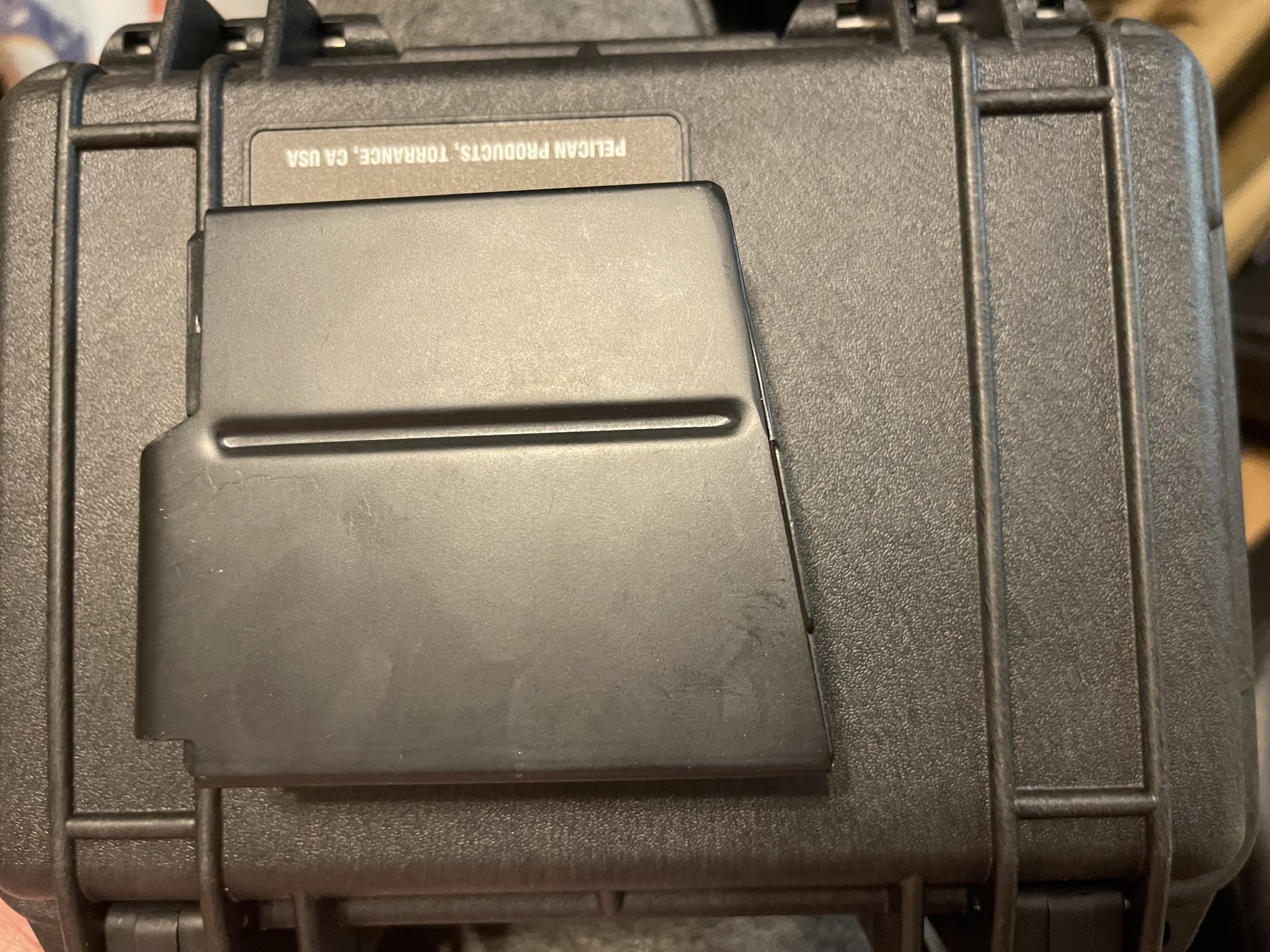

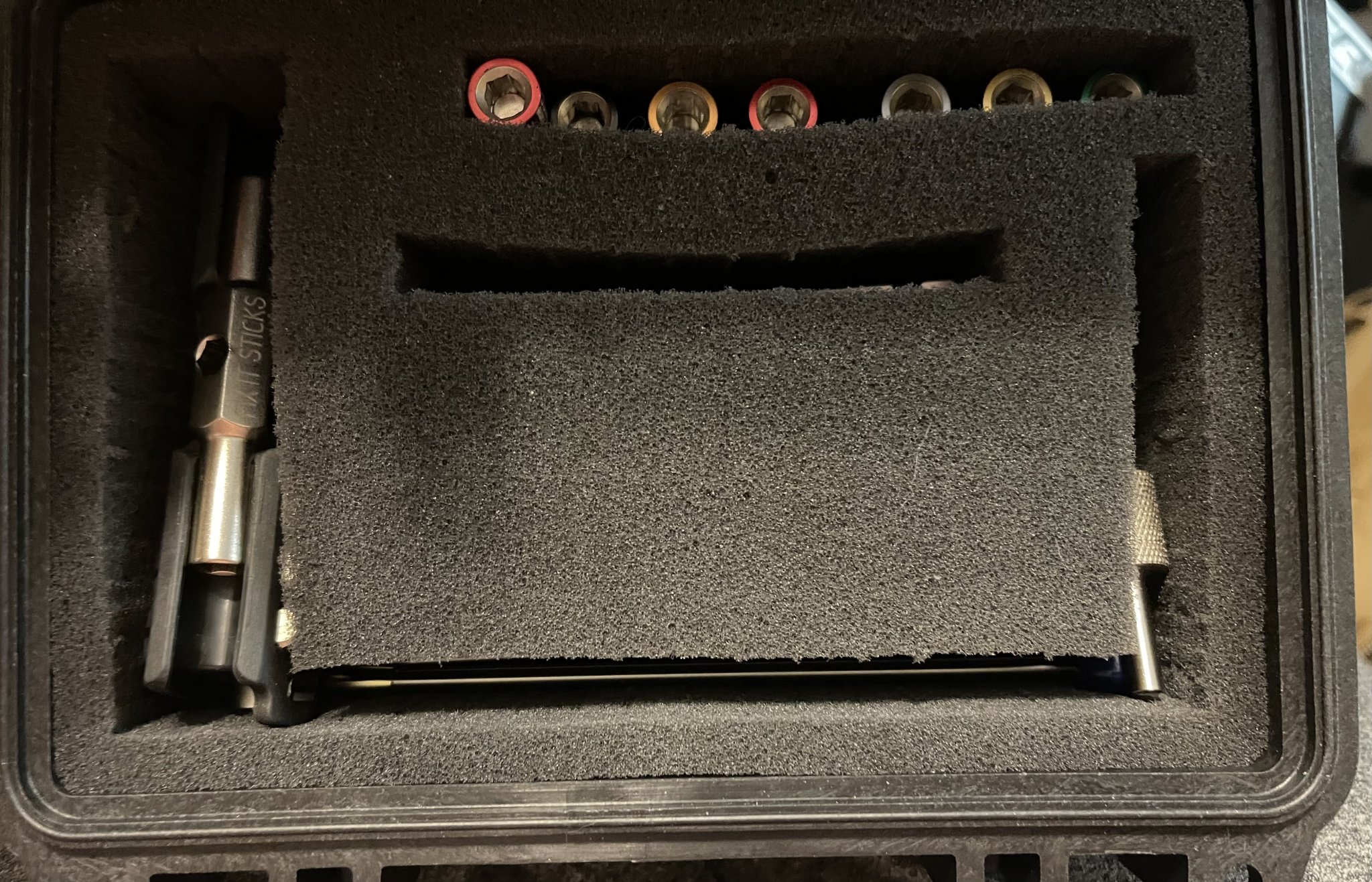

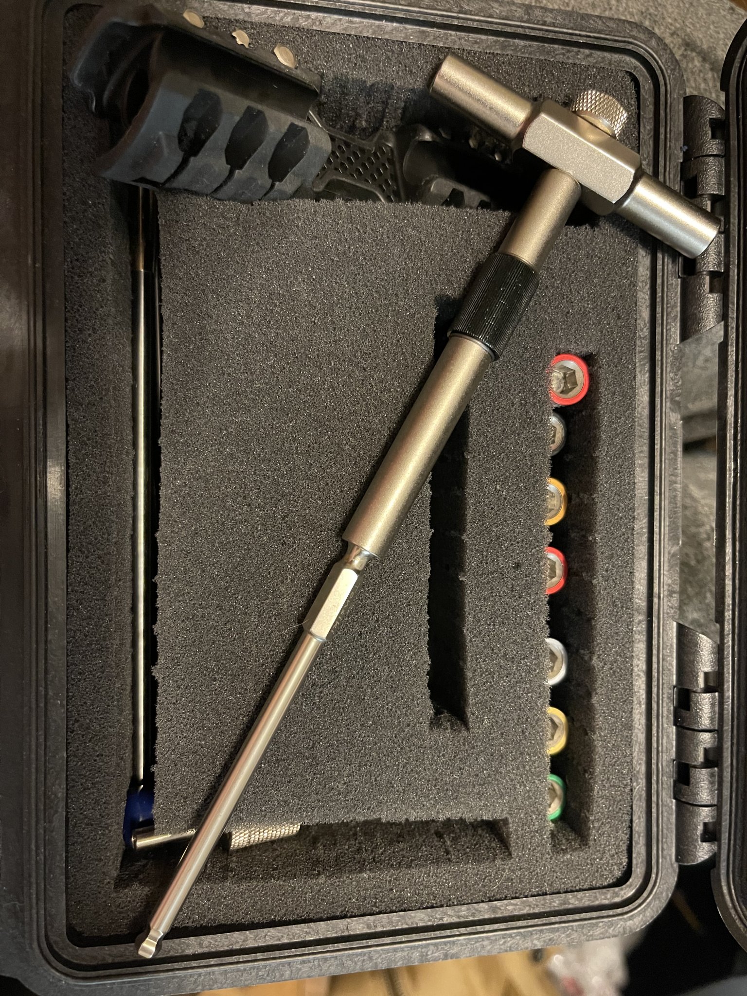

Pick and pluck foam always looks like shit. I’ll get a hot knife or some laser cut eventually.
I decided to leave the fixed T handles out of the travel kit. I have extended bits that will handle that job.
AW mag on top of closed case for scale.

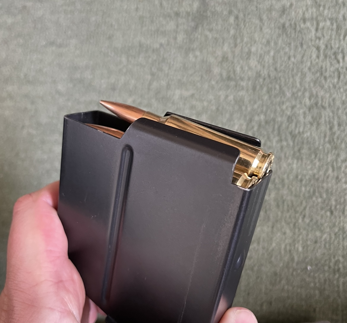

Shot my new ATX for the first time today. Unfortunately I had feeding issues with 6.5 CM. Using the magazine that shipped with the gun and others that I already own. Push up on the mag and it feeds. Bolt now rides over an empty magazine, was the geometry changed specifically to allow that?
I've dozen of mags, am I suppose to send them all in and get them re-worked/exchanged for the ATX's? Why lower the mag in relationship to the bolt where you get these ride overs and no feeding. None of these same magazines have feeding issues in the many other AI's I own.
What's the likelihood with reworked magazines over time they will spread @ the lips/upper body and the problem returns?
By the way, even with the feeding distractions it shot lights out. Love the trigger. Got to get those folding hinges out! :)

They decided they want it to ride over. Pretty much all the explanation needed.
The body of the mag seems to have been the issue on a lot of mags and they are fixing them. I wouldn’t expect the body of the mag to change over time.
Personally I’m getting six AX mags that feed properly. Three will be used and the other three will sit on the shelf or in the case in the event of issues arising. I already do this with any other mag as you never know when you’ll drop one or something goes wrong.

Been following this for a while, I own an AT with an interest in getting an AT-X in the future, great guns and historically without equal.
Just to summarize. On the AT-X, AI wanted the bolts to override the magazine follower on an empty magazine so they change the chassis geometry and therefore created a potential feed issue and now it is a magazine problem?
Happy to be corrected.

I’d say at *worst* they made the system more susceptible to out of spec mags.
There will be 100 opinions what people think of it.
But, three brand new AX mags I bought run perfectly fine. And AI has been fixing or replacing any that don’t.
So, after that, it’s just complaining to complain about an issue that is resolved asap if it happens.
Also, and I’m speaking absolutely hypocritically and in no way, shape, or form have any info from AI.
In the event that the small change makes the system more susceptible to a mag that is *out of spec* (meaning it’s bad already), there’s likely no way to have known that. You can only test so much. And it doesn’t make much sense to force a mag out of spec and test it…..because….it’s out of spec.
Now, if you have come across a situation where your past rifles would overcome this magazine flaw, that was basically incidental and not by design. Probably didn’t even know it was possible either way.
Now, let’s say it’s identified it’s more susceptible….this isn’t even remotely close to a recall or anything like that. A bad batch of mags got out and they are fixing or replacing. That’s all you can ask for.
If they decide later to change the geometry back, well, that’s just how it goes sometimes.
Opinions otherwise would basically be saying they should have designed a rifle to work with mags that are essentially broken.

@Scott Seigmund
If this was already mentioned, I apologize. There’s a ton of posts here and I may have missed it.
If I understand you correctly, you would like the short bridge to be able to came back to the receiver with no gap as on the full length bridge?

NO! The magazine positioning in the AT-X mirrors that of the AX. I stated in an earlier post that the bolt may or may not hold open on an empty magazine on the AT-X and AX series rifles. This is dependent primarily on the magazine. Some will hold the bolt open and some will not.
The feeding problem is well covered in previous posts.

The short bridge was always intended to be used in the middle to forward positions. If a zero gap is desired, the full length bridge will give you that.
-Scott
Makes sense. The short rail *seems* to allow a 1.25” barrel to but run (as it’s further out that it touches when moved a bit) and still give a “handguard” as many of us use an nvg rail for.
Seems like keeping the rear geometry the same as the long would provide users with more flexible options via just having that extra 1/8” or so needed to reach the rear mounting holes.
Personally for me, no big deal. I’m just gonna toss it on mill and take of a little on the rear. It’s a tool that’s gonna get beat all to shit at matches anyway.

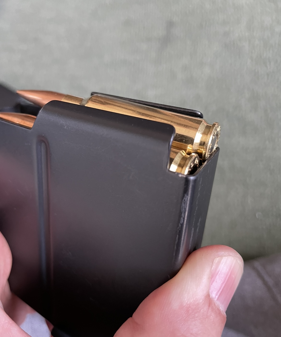

I have an 2014 AT & 2018 AX. Not a AT-X so apologies if this isn’t the right place, however there is a conversation going on.
I do get occasional mis-feeds in both rifles. I’ve always assumed I’m short stroking or something and never paid too much attention to the mags or looking at the issue. (I don’t shoot matches and my life doesn’t depend on this rifle) With this thread for shits and giggles I decided to look at all my mags. 3 x AX and 3 x AT.
Loading up with 6.5 Creedmoor 3 x are perfect (all rounds sit square and level), 2 x show an issue and 1 ever so slight.
Now I’m not expecting AI to replace my mags as they are old.
However would you or anyone else be kind enough to post a DIY fix for mags. Which bits need to be bent or expanded and how etc.

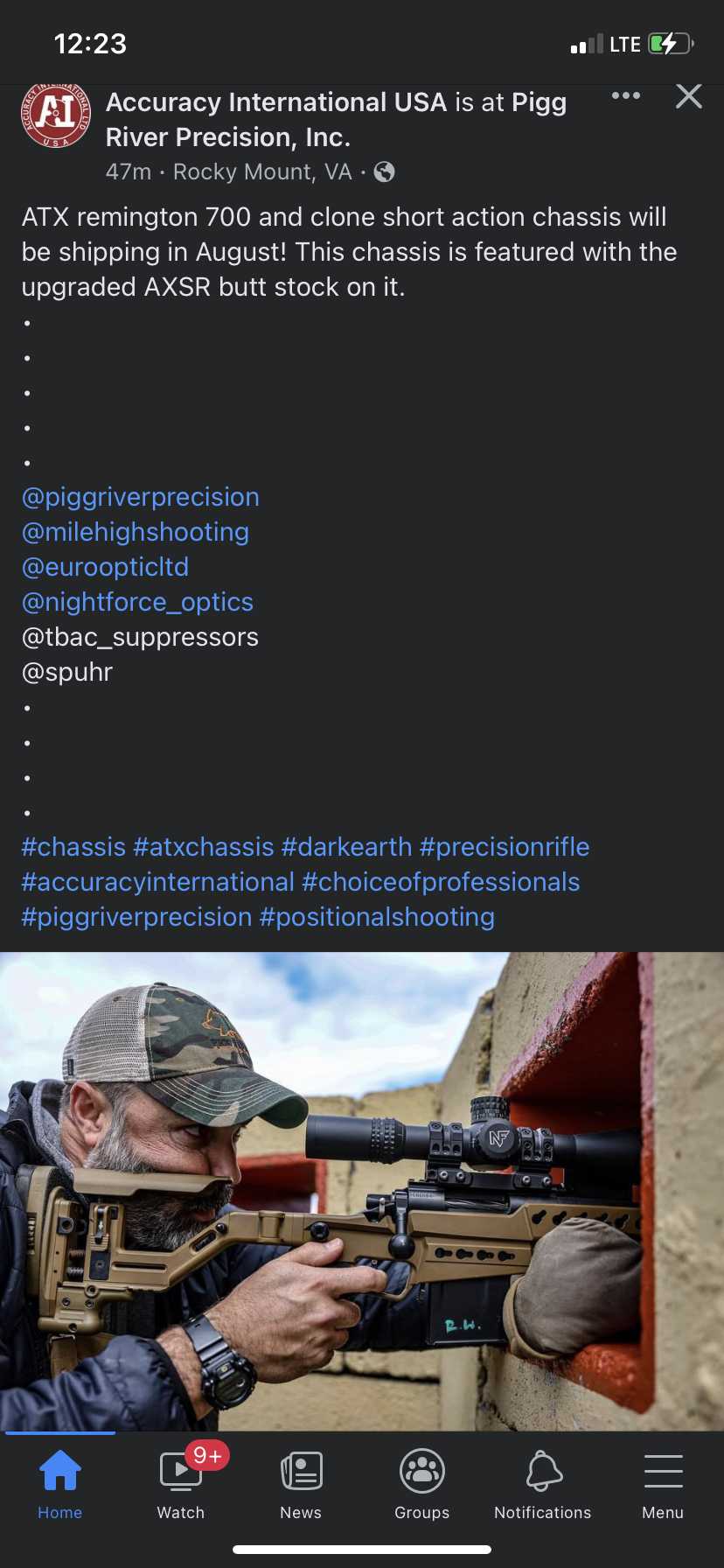

To anyone (I remember someone here was) that was asking about the chassis, this was just posted on their Facebook page. Says August.

My AT-X requires 5 different torques and 4 different bits.
I’m not sure how anyone would say it’s less tools and less parts. If you’re counting plastic skins, sure. But let’s not get into nit picking like that.
To access the trigger I have to take off the buttstock and the bottom metal. On the AT it’s just the plastic grips.
And again, there is user error. If I don’t get the grips perfectly right, not a huge deal. If I get the bottom metal loose, now there can be issues. As well as a wobbling butt. You also need a long bit with a T-handle to get into the bottom metal to break the screws loose.
These are just my opinions and love the AT-X. But I’m still grabbing an AT for work and such.
Regarding the number of tools, I believe he said the current version of AT-X uses the 4mm allen wrench for all major parts/adjustments.
If I had to guess, it was changed in later versions due to user feedback on the V1 models.
Also, FWIW, I had three of the original comp triggers fail.
Two of them I sent back to the designer/manufacturer who put springs in and adjusted them on his jig. Upon return, they both failed immediately on 3 different rifles.
The third I took out of the package and only adjusted the first stage out. As directed over the phone via designer. Didn’t touch anything else. It failed at about 500 rounds.
My current X trigger I haven’t touched. Left at the 2 stage settings from factory. It feels awesome and seems like it’s going to be fine.
But, as far as I’m concerned, the jury is still out as I had failures on triggers I didn’t even touch.
