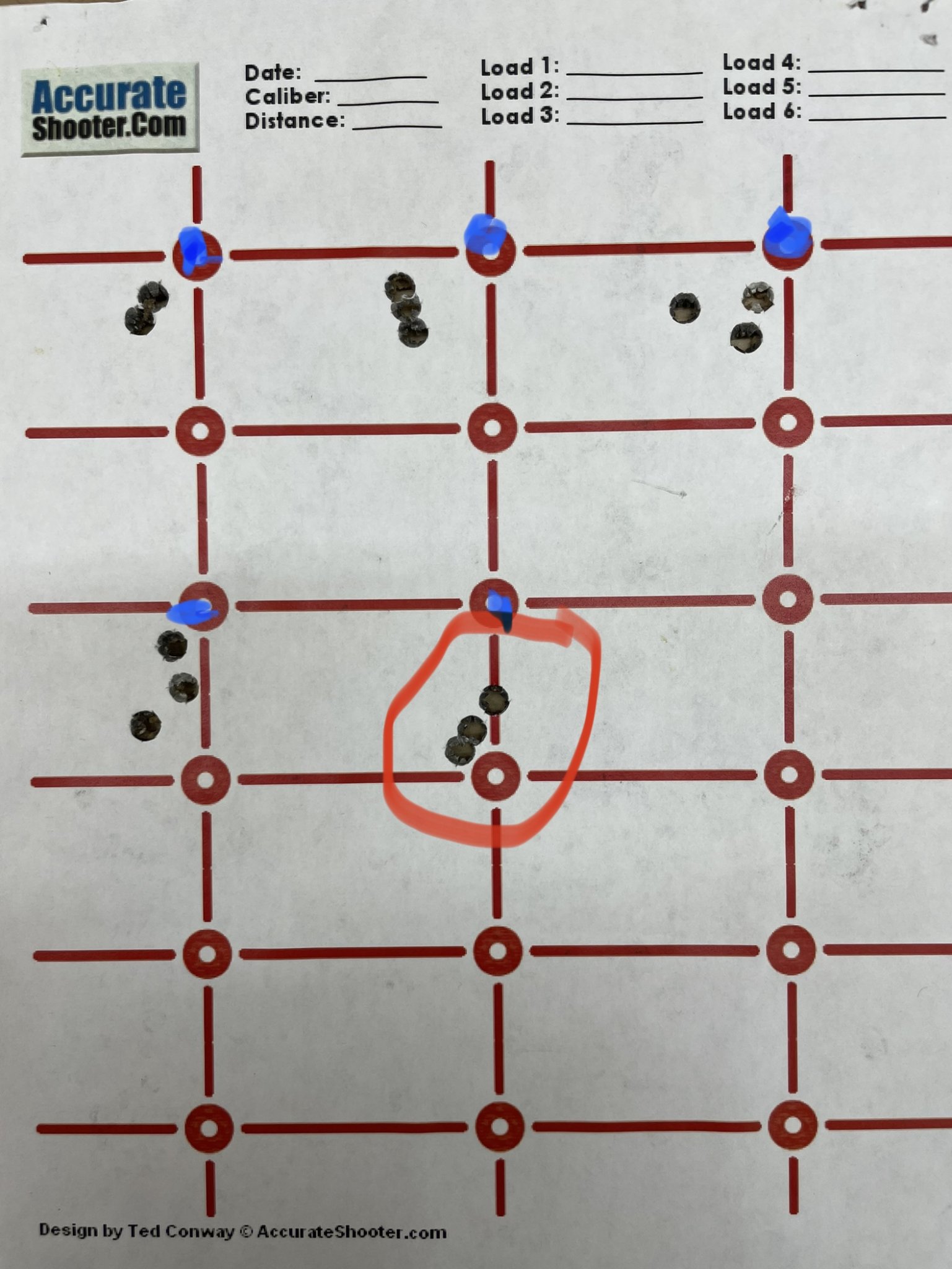

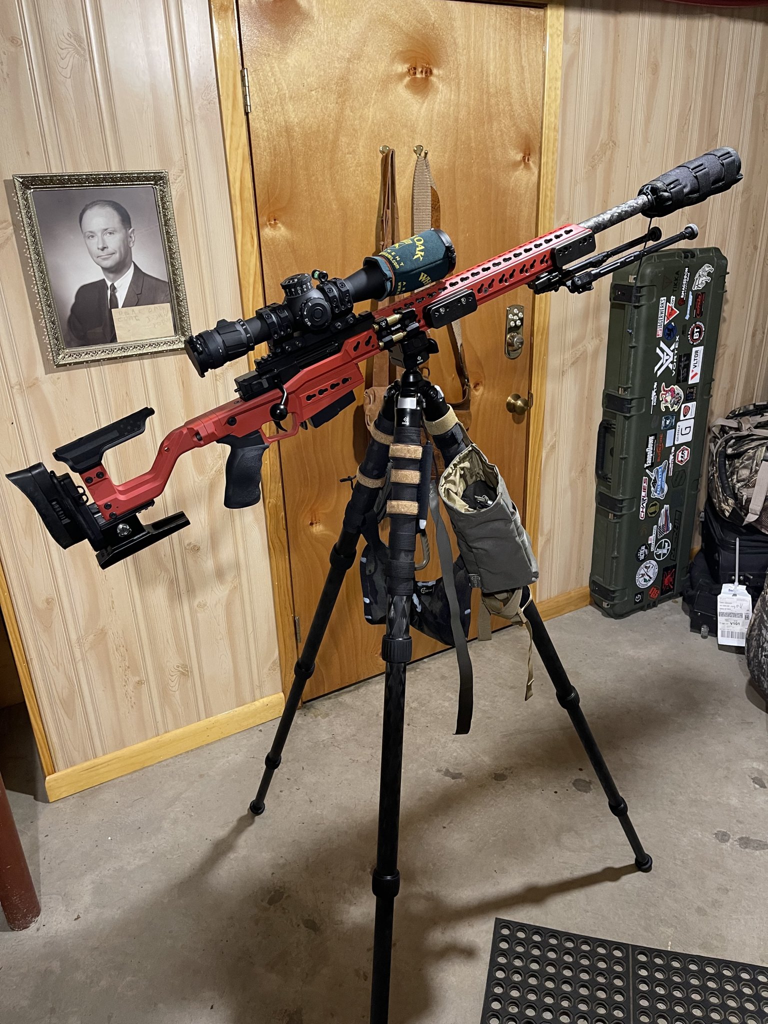

My first AI or quick barrel change setup. Getting so poi shifts. Its a 6.5cm barrel I had cut down to 18” to lighten it up as I have a TS Customs 6 dasher on the way for comps.
Shooting 140elds. Hornady brass. Been fired in chamber. Annealed with amp. Sized with sac modular. H4350 42.2g. Br2. Seated 0.020” off. Here was todays range session. Ive noticed it a few times. Scope is zco. In m brace torqued to 55 in/lbs.
Point of aim is blue. Last group moved right and down. 🤷🏻‍♂️
Anyone else see this. Im running TB Ultra 7. I made sure it was tight.

Looks like shooter to me
How are you putting the barrel on?

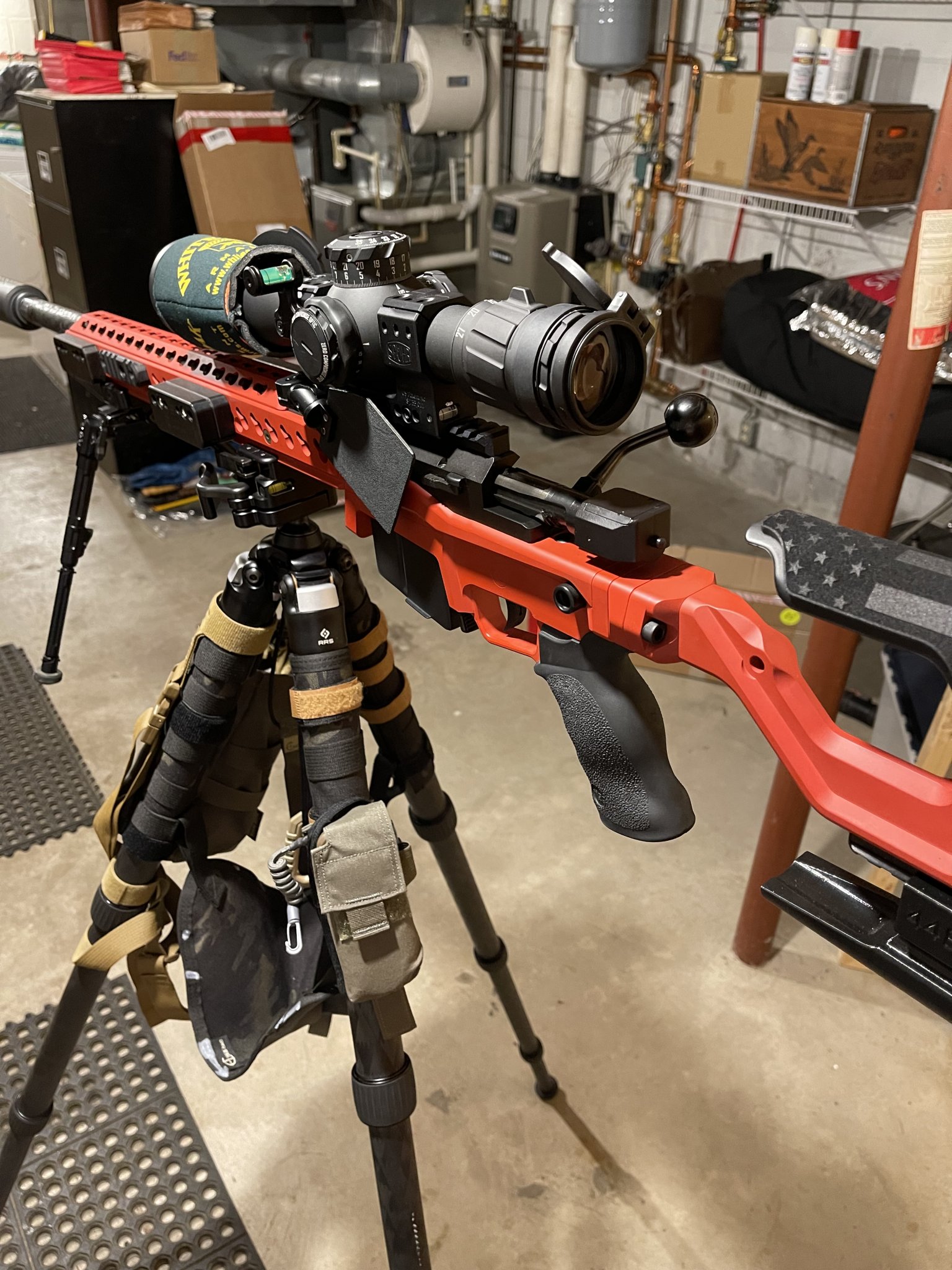

So what, didn’t like the blue, then didn’t like your home cerakote, now it’s off for official cerakote?
Hated the blue. I liked my home Alumahyde ODG color, but the finish wasn’t durable. After 2 Team Matches in November the blue was starting to show. So off to get blasted and cerakoted a color similar to Alumahyde ODG.
