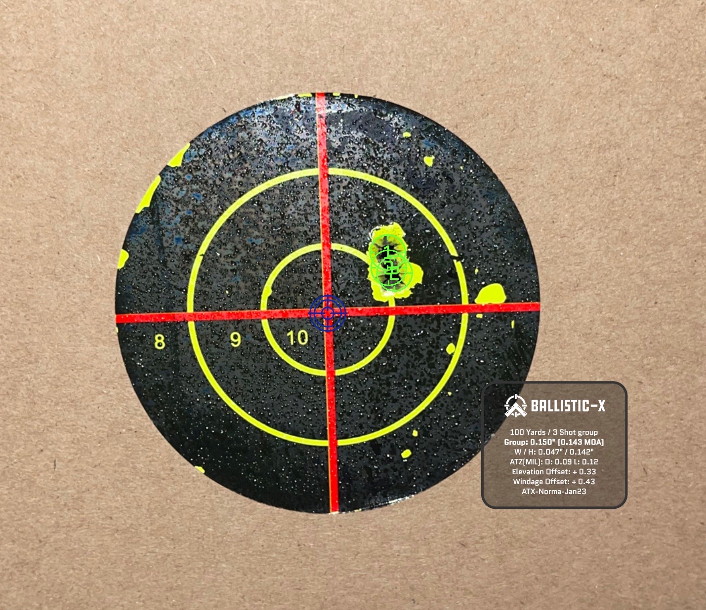

Norma seems to be good stuff. Shot ridiculous from my XM3. For $1.28 a round to my door no less. Was damn near the same as me buying 200pcs of norma brass.

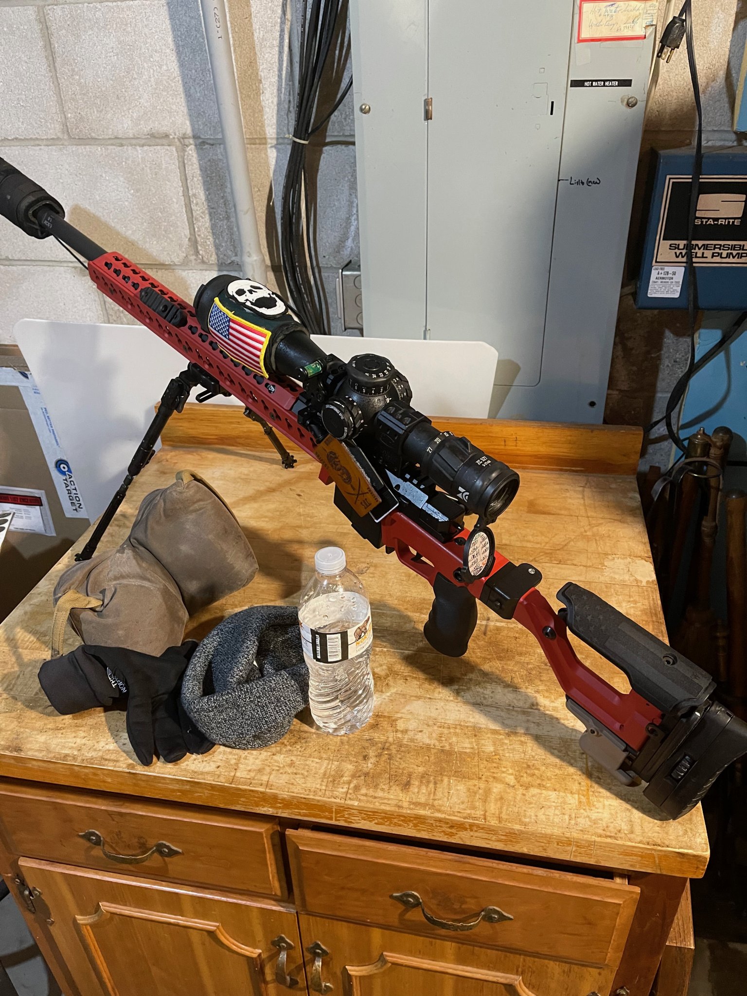

specs

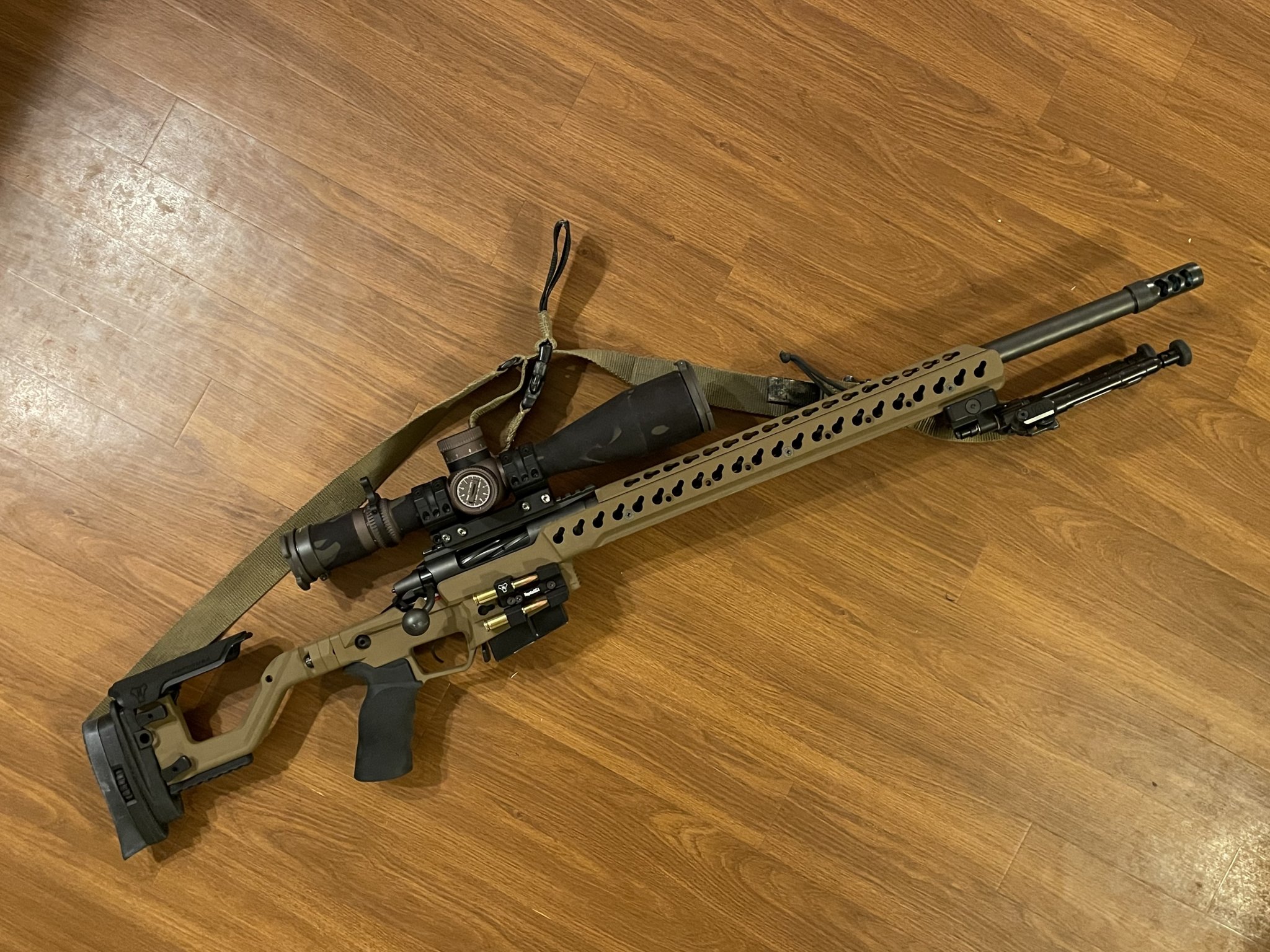

Rem700 .223 with some upgrades. Side bolt release, 8-40 base screws, blueprinted, one piece bolt, etc. I wanted the rem700 to use the AI scope rail so it would run continuous and match up to the rail on the bridge. 24” MTU barrel.
