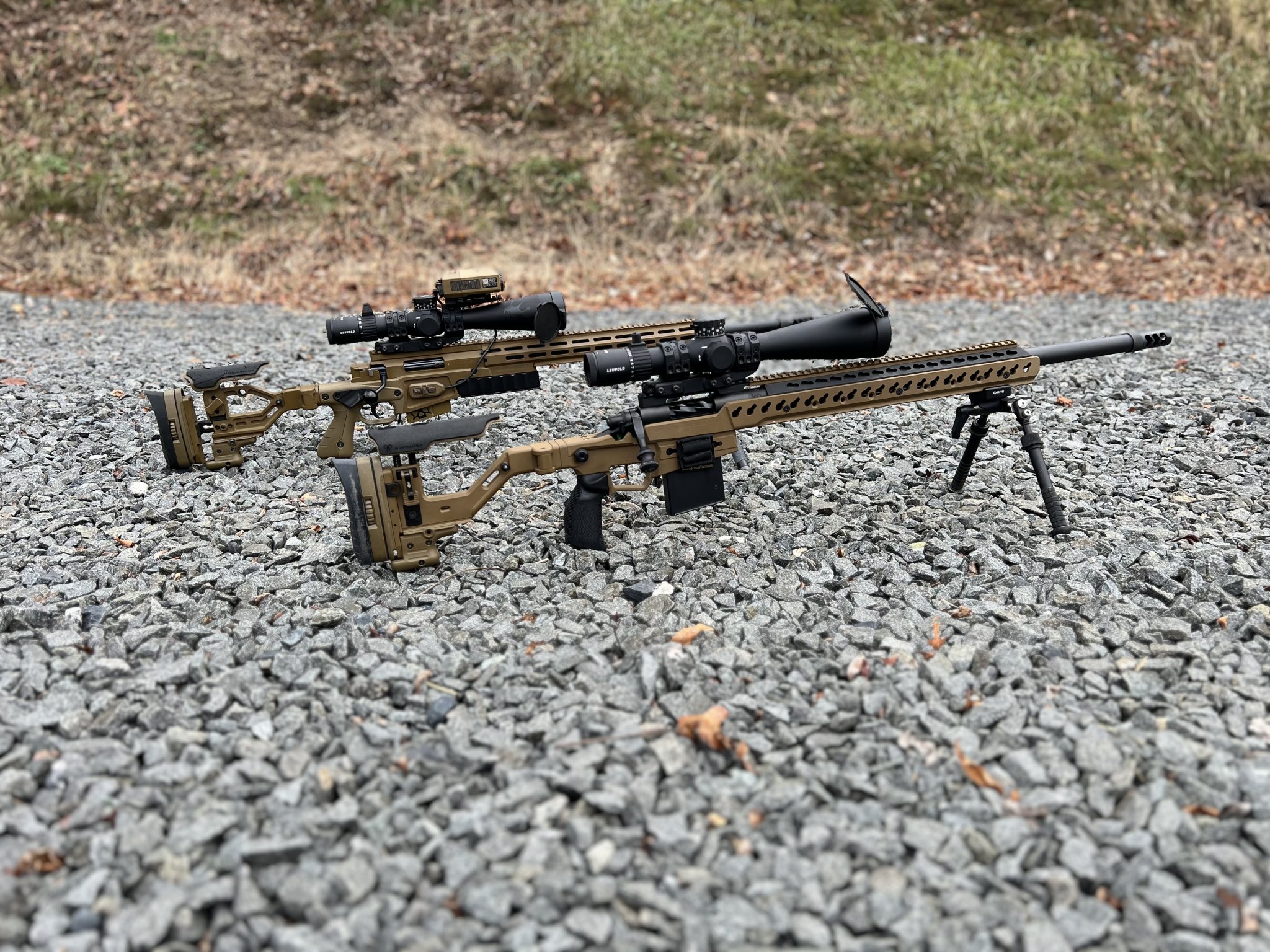

Finally got the rifle setup the way I like it and was able to get out yesterday to zero everything. Really liking the setup so far. And it makes for good gun porn. Next step is rattlecan!

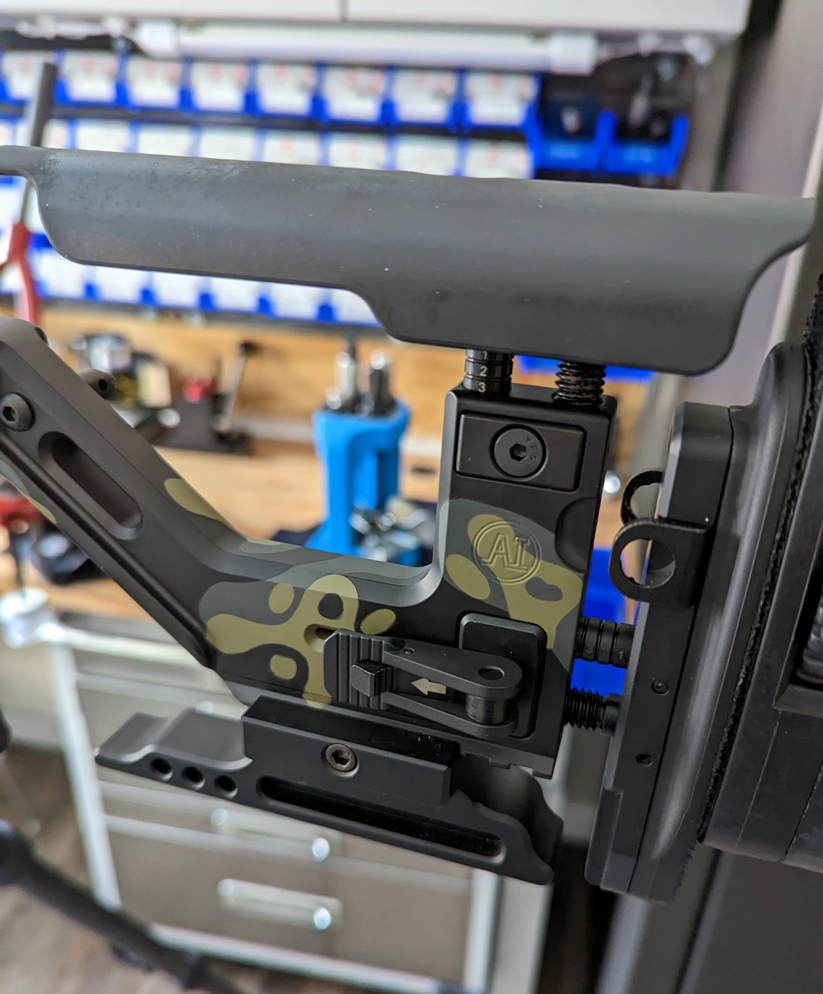

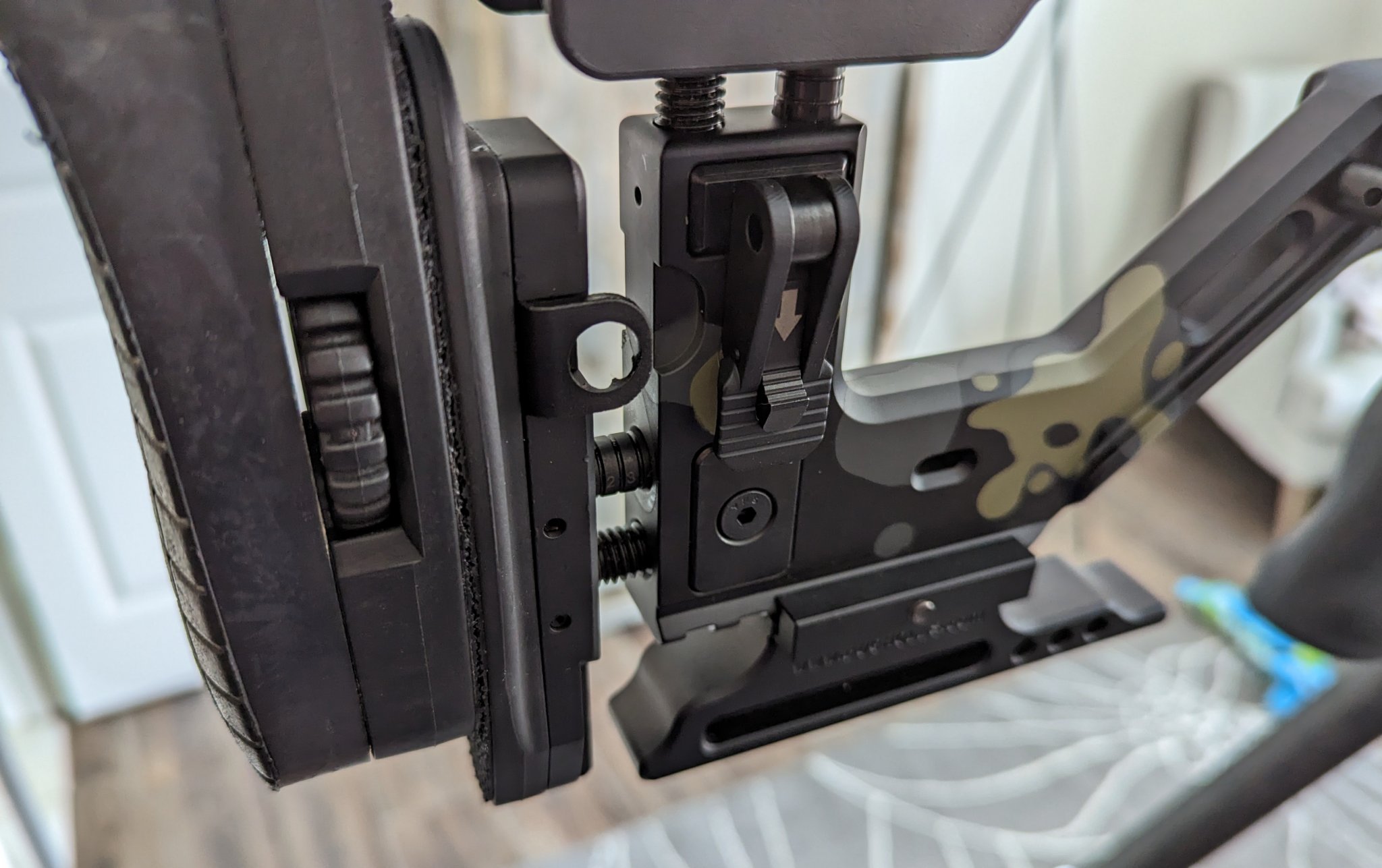

Good guess, the quick adjustment levers on the SR stock were all on wrong. Here's how they are supposed to go if anyone else is ever trying to figure out how they are supposed to go back together. View attachment 8058131View attachment 8058132

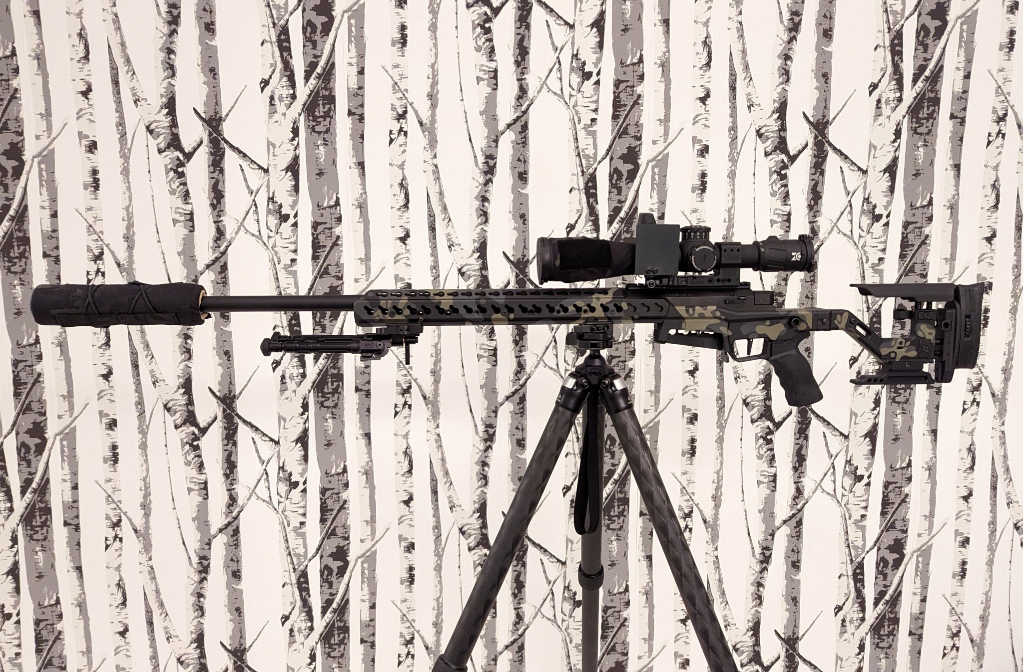

That camo is sick AF. Just a hybrid multi cam standard/black? I have another atx700 chassis coming in black, might have to copy that.
Reactions: kthomas
It's a 3-color camo. not really a MC but it does look a lot like MC Black fabrics. I think multicam patterns are typically 4 colors and the base coats are faded. The cerakoted colors used are Graphite Black, Sig Gray, Noveske Bazooka Green. GCP did the work and they did a great job quickly.
Thanks, that's a great looking rifle. Wish the atx chassis just came with axsr rear section, I'd gladly paid the premium.
