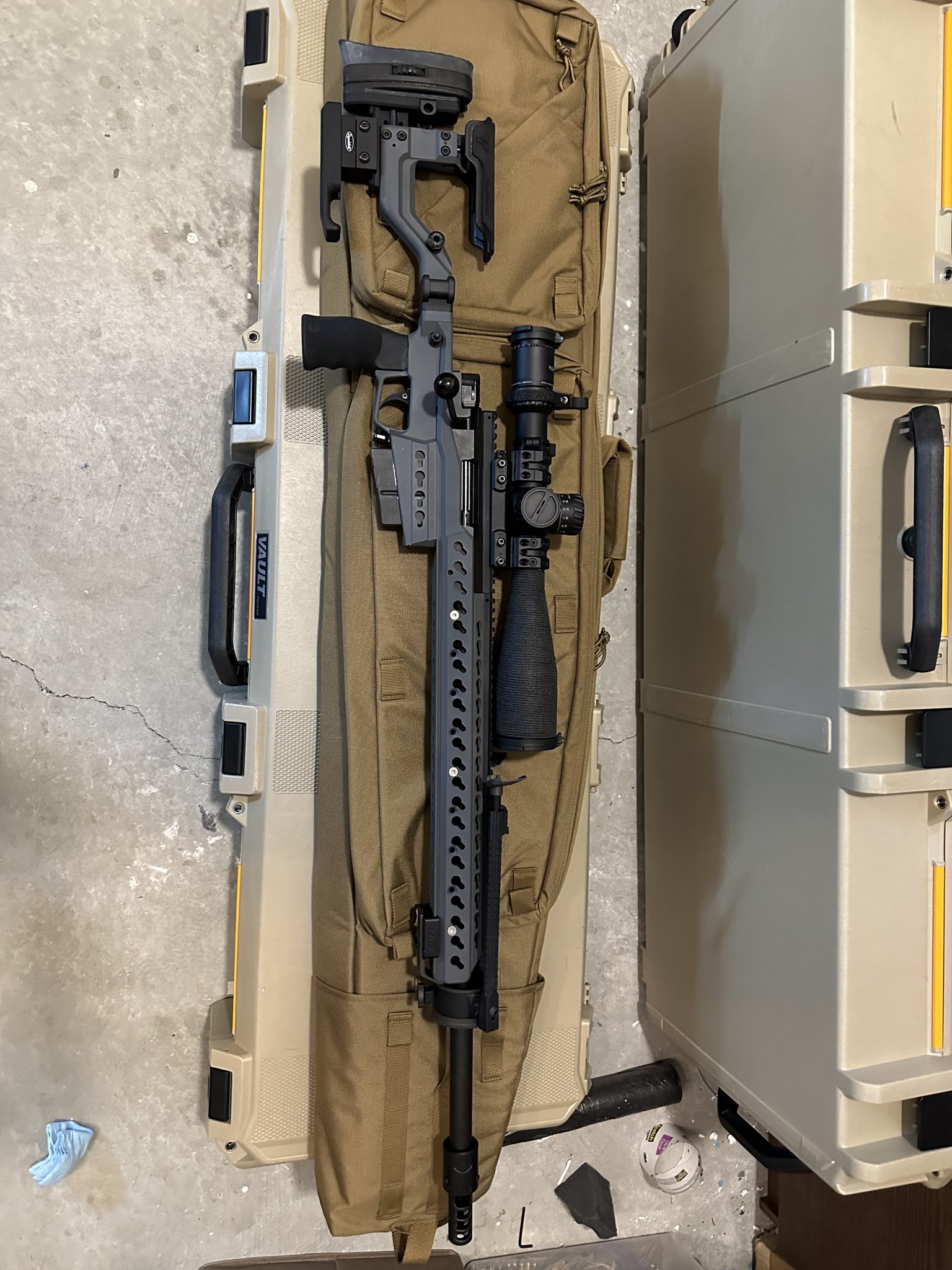

Finally got my AWM set up , just need to zero it ,
Goddamnit I need to look closer next time before “love-emoji-ing”.Thats not an AWM, thats something in an AICS chassis.

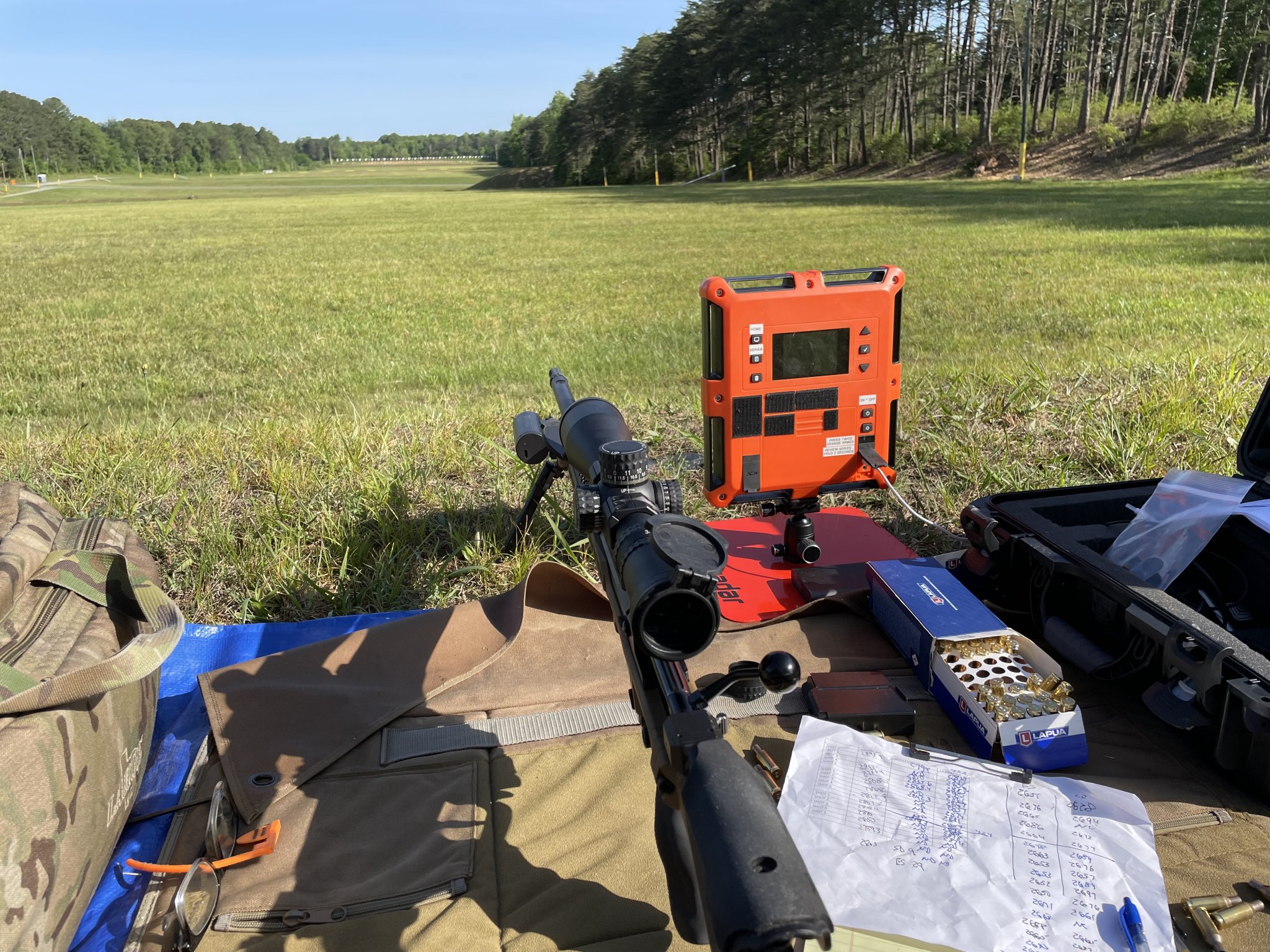

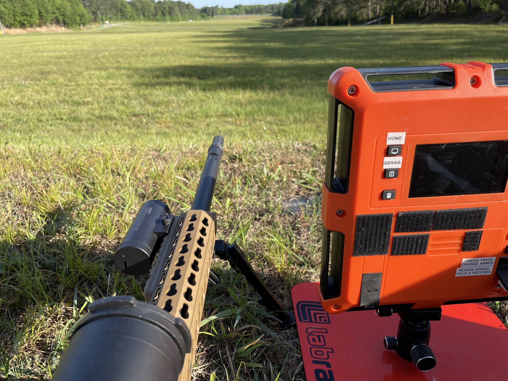

It happens sometimes when you put a brake on. I had it happen to me on a couple of barrels and depending on the brake or brake and suppressor combo the barrel harmonics didn't like it to where it shot like total shit. Recently, I put Dead Air Brake with a Silencerco Hyrbid via KeyMo on my 300NM barrel. It opened up the group to over 2 MOA. Took the whole brake and QD setup off and made it into a direct thread Hybrid and it shot fine. Also had a APA LB Gen 2 on my 6.5CM barrel and shot like crap, took it off and put a suppressor on, and it shot fine.I know I need a suppressor, it's next on the list.
But I have a question, has anyone had a barrel just not like a muzzle device? This 308 shoots lights out with 175 fggm. But when I screw on an area 419 brake it opens up to 2.5ish moa. Take the brake off back to .5-.75 moa. Brake shows no signs of strike. All my other guns love 419's, but this one hates it.
Thank you for that. I've had great luck where my brakes always helped, this is new. This barrel is such a hammer I don't want to ruin it. Any chance a different brake could help?It happens sometimes when you put a brake on. I had it happen to me on a couple of barrels and depending on the brake or brake and suppressor combo the barrel harmonics didn't like it to where it shot like total shit. Recently, I put Dead Air Brake with a Silencerco Hyrbid via KeyMo on my 300NM barrel. It opened up the group to over 2 MOA. Took the whole brake and QD setup off and made it into a direct thread Hybrid and it shot fine. Also had a APA LB Gen 2 on my 6.5CM barrel and shot like crap, took it off and put a suppressor on, and it shot fine.

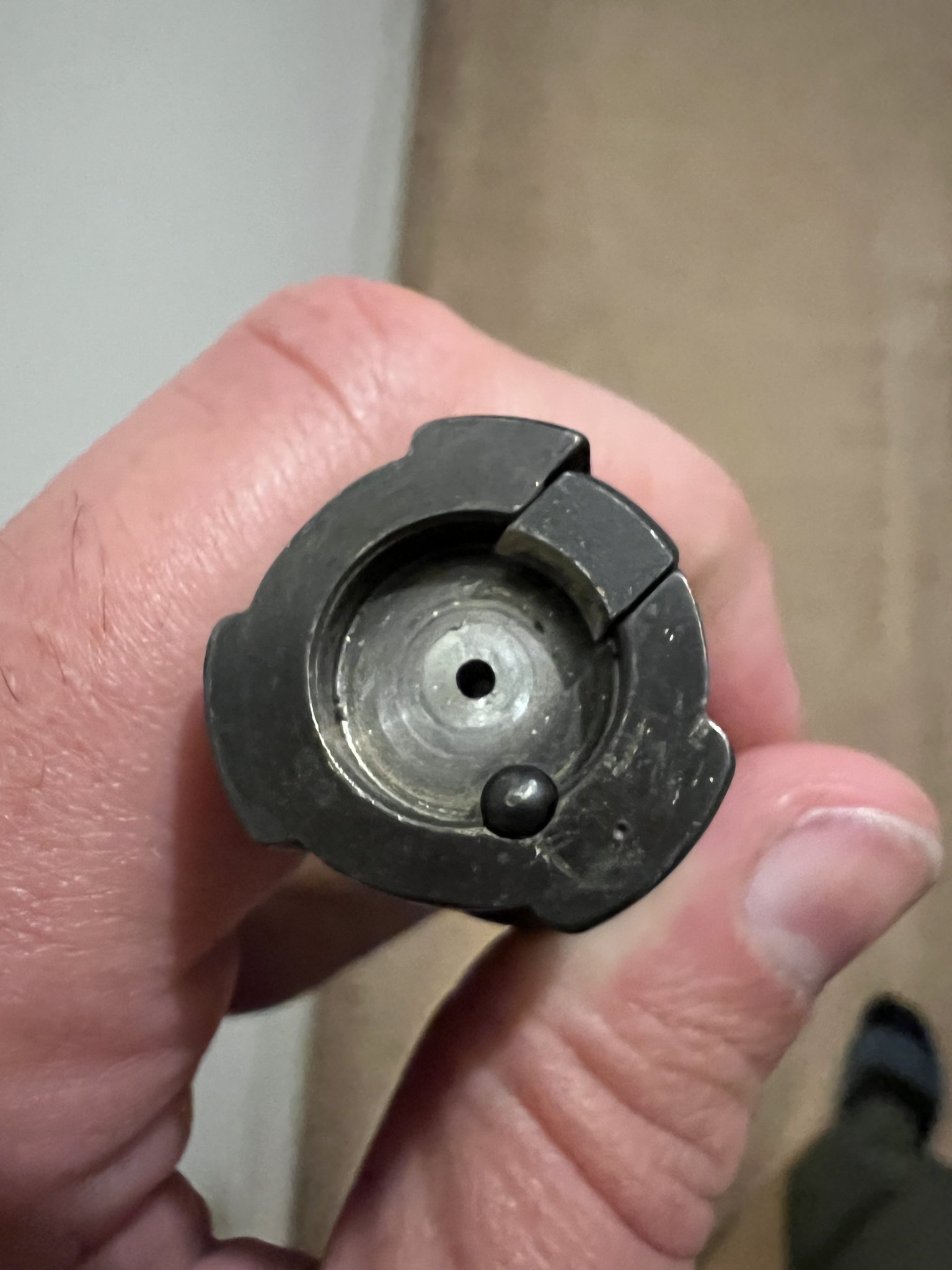

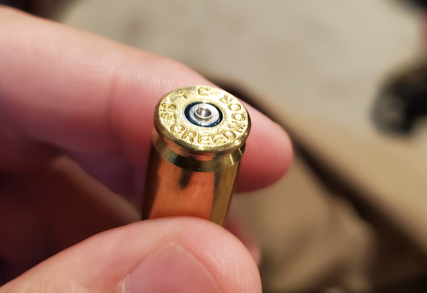

(AXMC with small rifle primer ammunition)
So that was a short range trip
Factory ammo, proof barrel, and a 338 ultra sr gen 2 that was probably 250 rounds past where i really should have cleaned it.WOW!
I shoot a LOT of Federal 6.5 CM with the Berger 130 grain bullet out of my MC and have never seen that happen. Was this a handload or factory?
Were you using a SFP or LFP bolt? Would that have something to do with it?Factory ammo, proof barrel, and a 338 ultra sr gen 2 that was probably 250 rounds past where i really should have cleaned it.
Oh its the LFP assembly and I know I can fix it by either having LRI bush all three of my bolt bodies OR by getting a SFP assembly but neither is cheap and I just bought a new roof this week.... so back to shooting 308 for a minuteWere you using a SFP or LFP bolt? Would that have something to do with it?
I wish AI migrated the MC to the SFP. There is no chance of me obtaining a new SFP in LH.Oh its the LFP assembly and I know I can fix it by either having LRI bush all three of my bolt bodies OR by getting a SFP assembly but neither is cheap and I just bought a new roof this week.... so back to shooting 308 for a minute

My RH “18” AXMC 308/.470 bolt is SFP.I heard that they went SFP with the AXSR but MCs were always LFP. Not sure of the ones sold only to LE today
LRI doesn’t bush AI bolts anymore!?Oh its the LFP assembly and I know I can fix it by either having LRI bush all three of my bolt bodies OR by getting a SFP assembly but neither is cheap and I just bought a new roof this week.... so back to shooting 308 for a minute

Could be wrong, but my axsa was a large firing pin model and I had to buy a new bolt and firing pin. Otherwise it looked like the op's.
That’s glock.this is what we're purchasing, PERFECTION
Sounds like I need to send it to LRI to be bushed lolIf you have a 14 model then you have the large firing pin.
It'll affect you if you try to reload or shoot any of the higher pressure rounds. Mine had slight primer flow with FGMM 308win ammo but got pretty bad with handloads. The fix was either to get it bushed and have your firing pin turned down to fit. Or replace the bolt body and firing pin with the new small version.
Shooting factory 308win should never be a problem.
Do you know what they actually do when they perform this service? Is it limited to the FP or does it rework the bolt as well?They bushed my LH AMXC .308 and lapua bolts back in the fall, came to $374.76 with shipping
I know AI also uses a ferritic nitrocarburizing treatment for their parts as well so after the FP are reduced in diameter, is there any coating applied?
Is it more cost effective to do that or get a new firing pin from MH?They drill out a small section around the bolt face firing pin hole to insert a "bushing" that has a smaller id firing pin hole.
They then turn down the firing pin to fit.
I don't know how the bushing is held in place.

Sounds like I’ll call Chad at LRI lolIt was like 150 shipped for the whole thing from Lri iirm .
If you got the factory ai parts, you will need a new sfp bolt body and a new small firing pin if they will sell you one. If not you will need to order an entire sfp assembly. All up your probably 1k there.
He did mine and I couldn’t be happier. Thousands of rounds with no issue.Sounds like I’ll call Chad at LRI lol

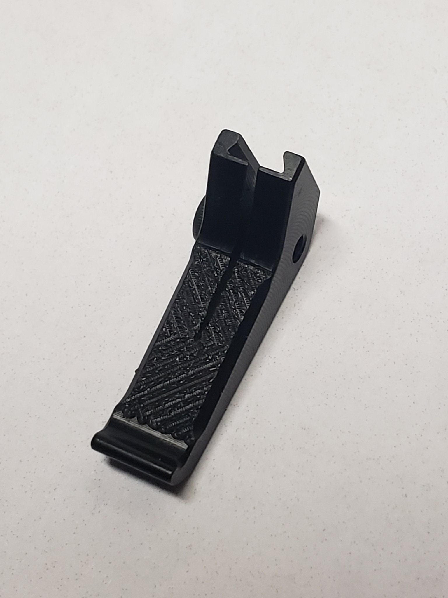

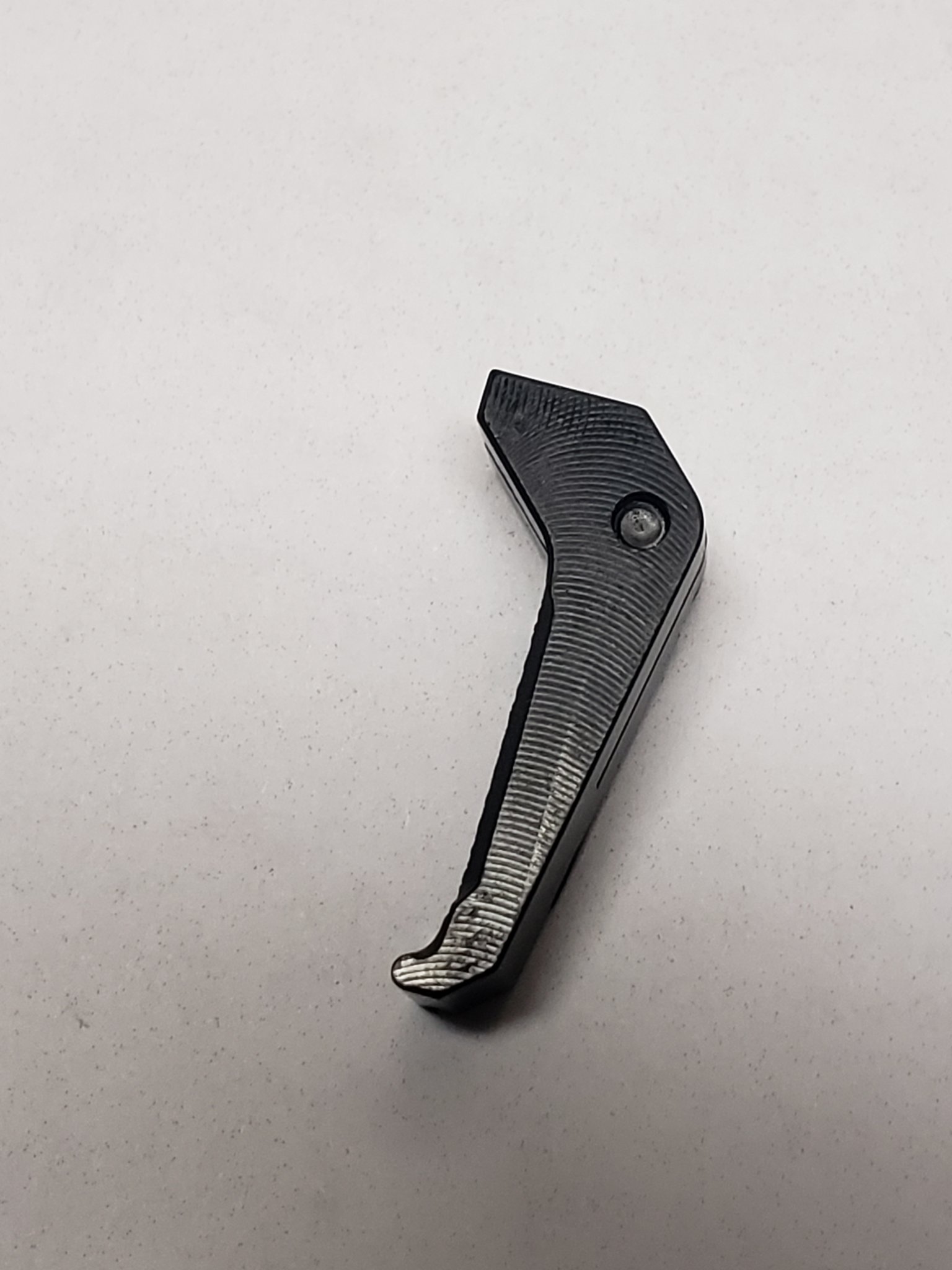

Soooo.... do you just PM him for one?Okay @pfl338 latest flat trigger is now officially the best ai flatty out there if flat triggers are your jam. Serrations are perfect not to sharp but enough your finger stays put. Index bump is great for getting your finger in the same spot each pull. Well done pfl338..
