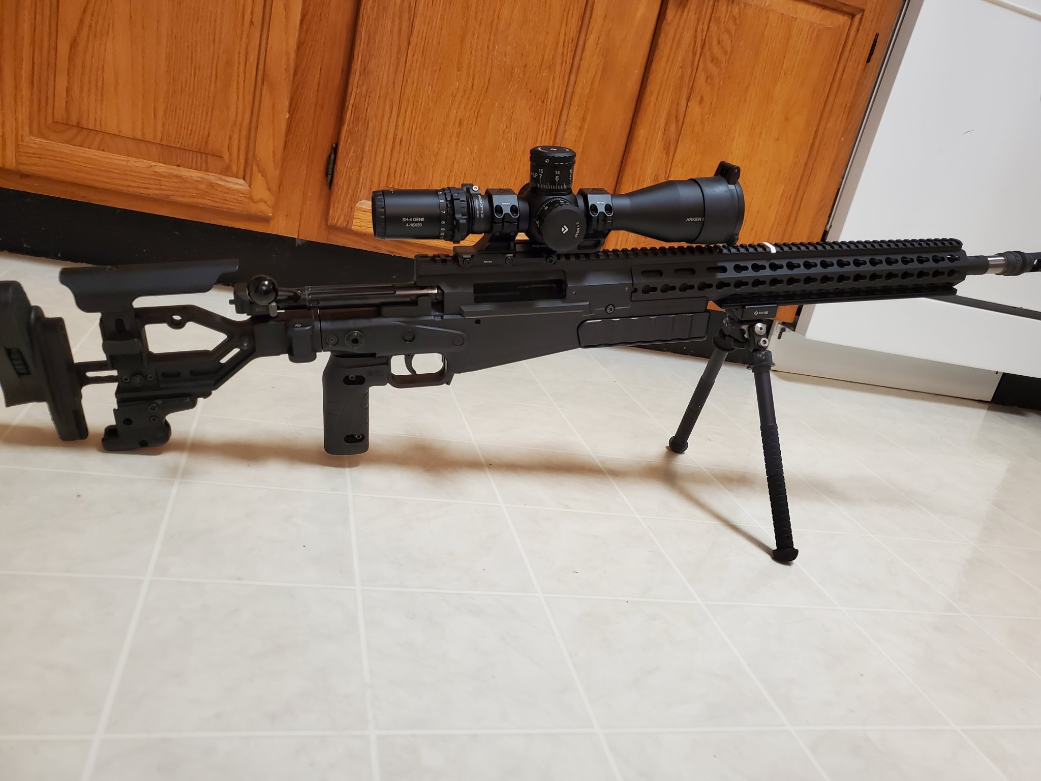

I put an mlok attachment for a QD sling and didn’t realize for the last couple days it was pushing my barrel to the side. 🤦🏻‍♂️🤦🏻‍♂️🤦🏻‍♂️
Shouldn’t affect it right? Just rezero maybe. I’m sad lol barrel has scars now
You realize that is the exact reason they come with keyslot
I suppose the handgard moved not the barrel so probably not a big deal. The barrel contour gives less clearance there so I’ll have to be more careful. 🥲
You didn’t damage it if that’s what you’re worried about
This is exactly the argument made for the keyslot “penis” system.
Not only is the keyslot much stronger due to the design. But the screws sit flush with the inside of the forend
What you did is minimal. Having rails on there and removing/installing barrels with screws sticking could damage tenon threads or very least scratch the barrel. It also limits your barrel profile size as it takes up room inside the forend vs keyslot
Keyslot for the win. Other than rails and maybe a QD sling mount I can’t think of a lot more you’d really need to attach.

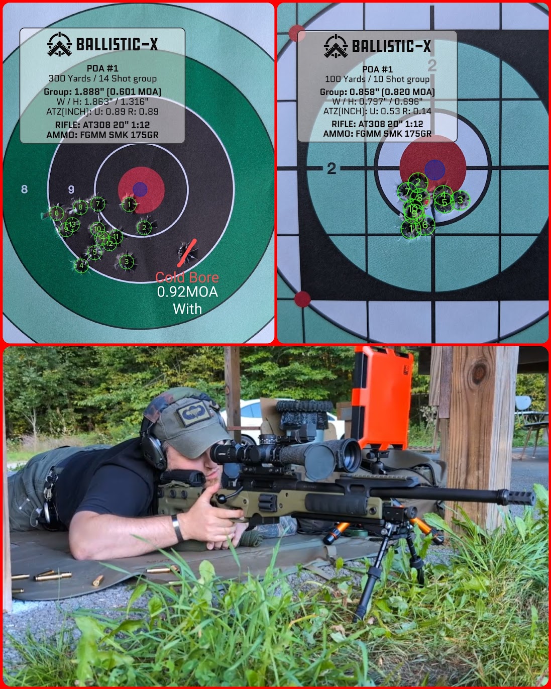

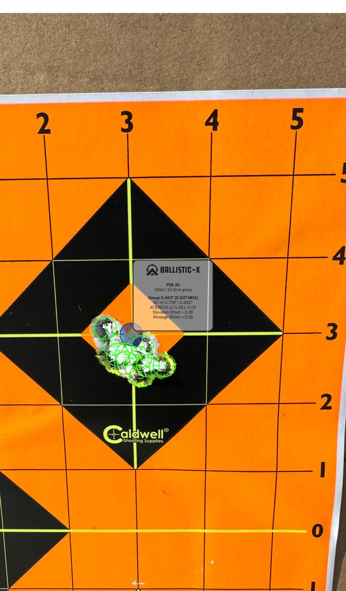

Ammo testing with 20" and 24" Lothar Walther 1:12 Twist barrels AT308s. They seem to like Federal Gold Medal match 175gr, and Norma Golden Target 175gr. The 24" barrel really likes Hornady Black A-Max 168gr but, I'm still testing to see how true this is. I still can't get either AT308 to shoot real well with Hornady TAP ELD Precision 168gr, but the tan AT is getting 0.8MOA from it, while I need to do more testing to know what the green AT can do.
I've removed and reinstalled both barrels, and torqued to 49 inch/lbs with Fixit Stick dedicated torque limiter. Tan rifle was 2 click, Green rifle 3 click to slightly over-torque. I'm still trying to find one round for both that 1) groups 0.6 MOA or better (10 round) and 2) gets me to 1000 yards effectively, 900 yards consistent. At this point, I'm completely open to factory ammo suggestions that both barrels would like. I'm considering a heavier ELD round, going with Hornady Precision Hunter ELD-x 178gr. If anyone has experience with this ammo from the Walther barrels, can you tell me about it?

No big offense to you, but are you capable of .6" 10rd groups consistently? I'd pick the ammo that's shooting best right now that you can get a lot of and get plenty of trigger time before you list criteria like that.
As for torque, many of us found 55inlb was a more constant torque when swapping barrels. Once it's clamped in at 49 or 65 the accuracy won't change, it just effects the repeatable poi when swapping.

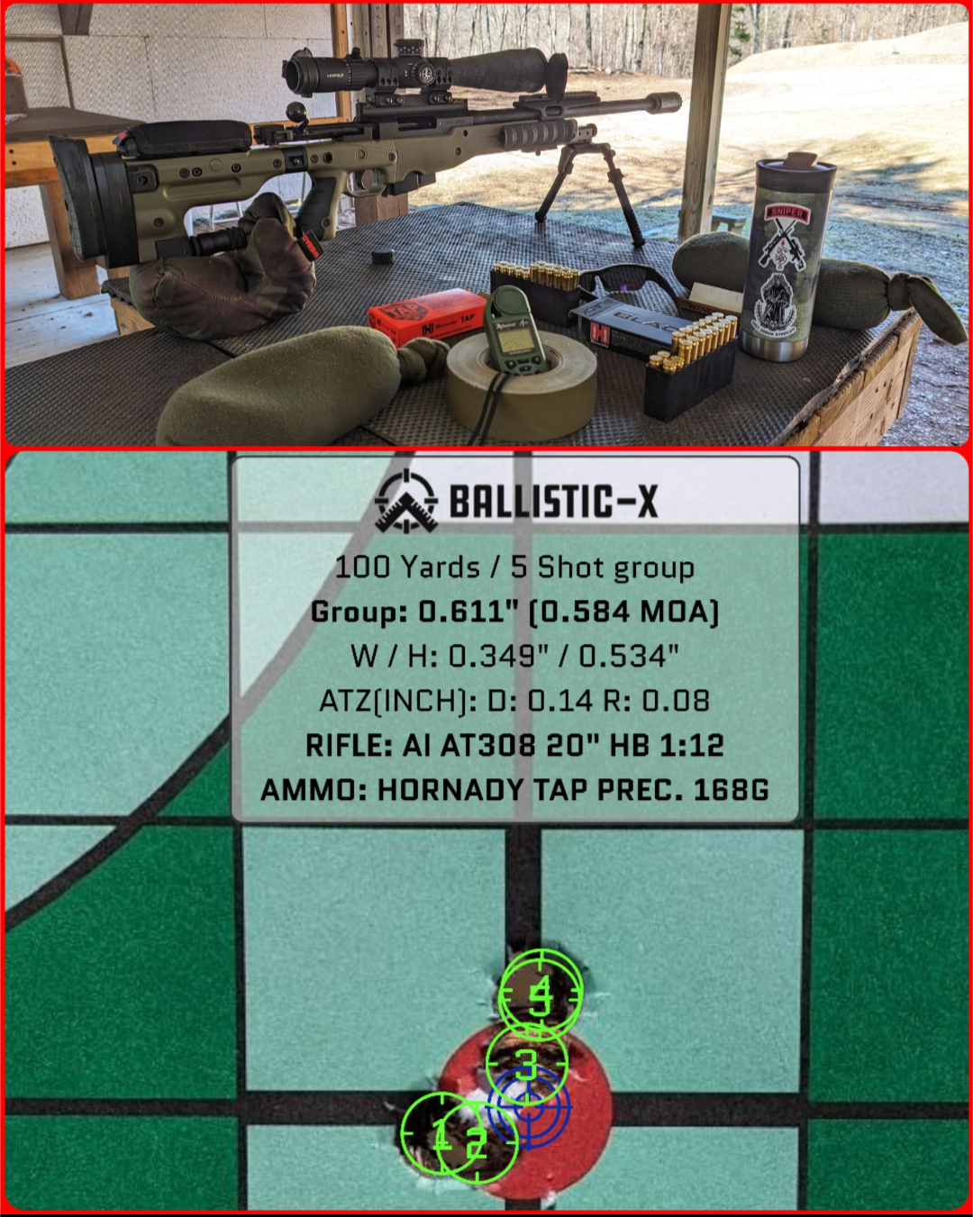

Short answer: yes. 0.6MOA on a good day, 0.85MOA on a bad day. So, picking the right ammo to stock up on is my priority.

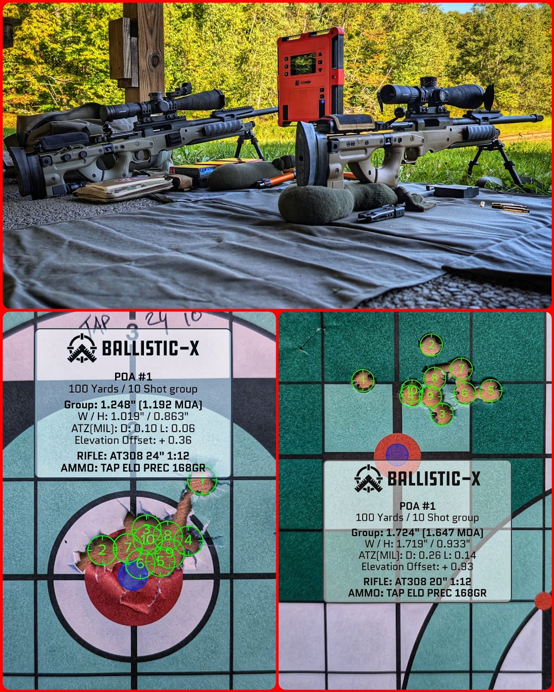

This is the sole time I was ever able to group Hornady TAP ELD Precision 168gr well; it was like a laser beam and felt effortless. This one box shot well the entire day across the board. This was in March 2024, and I haven't been able to replicate it since. I'm trying to get it to work again as it is the ammo I wish to use while also having the best BC and features for long range.
The entire day shooting Fed. GMM SMK 175gr was consistent like this with the 20" Walther barrel. If I had to grab just one ammo today I could count on, it'd be this. But, it has the worst range and BC.

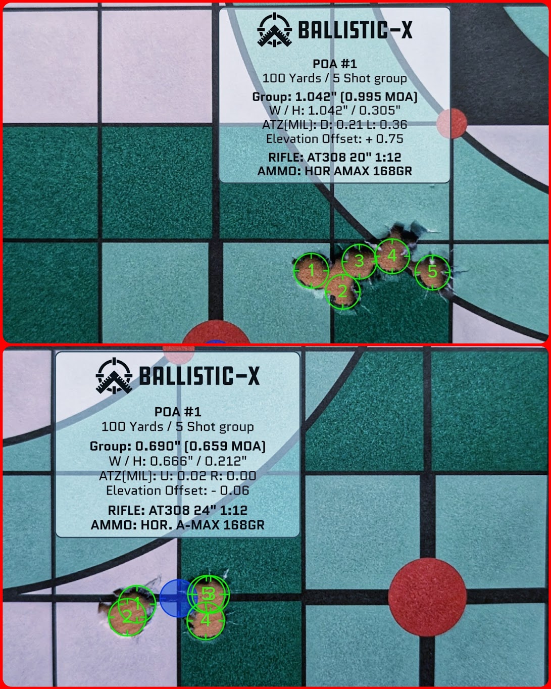

This has been the current trend with Hornady TAP ELD Precision 168gr, tested with both the 20" and 24" barrel. Since removing and retorquing the barrels on both rifles, the groups have shrunk from 4MOA down to this. The 24" likes it a lot more, and without the flier, it would have been a 0.8 MOA group. I need to get more of the ammo and test more for a greater set of data.
Both rifles now, strangely, like Hornady Black A-Max 168gr: 20" above, 24" below. They were shooting around 2 MOA prior. This is was unexpected and also needs more shot data.
Considering these are 1/2 to 1/4 MOA rifles, this isn't hard to accomplish -- with the right ammo -- and I've been transparent on here, on r/LongRange and on Instagram with all my shot data. What I'm struggling to wrestle with are the quirks of a 1:12 twist barrel with modern ammunition. And so far, the 20" rifle feels different from the 24" which I'm also trying to understand: the 24" is notably easier to shoot, easier to handle.
This is the sole time I was ever able to group Hornady TAP ELD Precision 168gr well; it was like a laser beam and felt effortless. This one box shot well the entire day across the board. This was in March 2024, and I haven't been able to replicate it since. I'm tring to get it to work again.

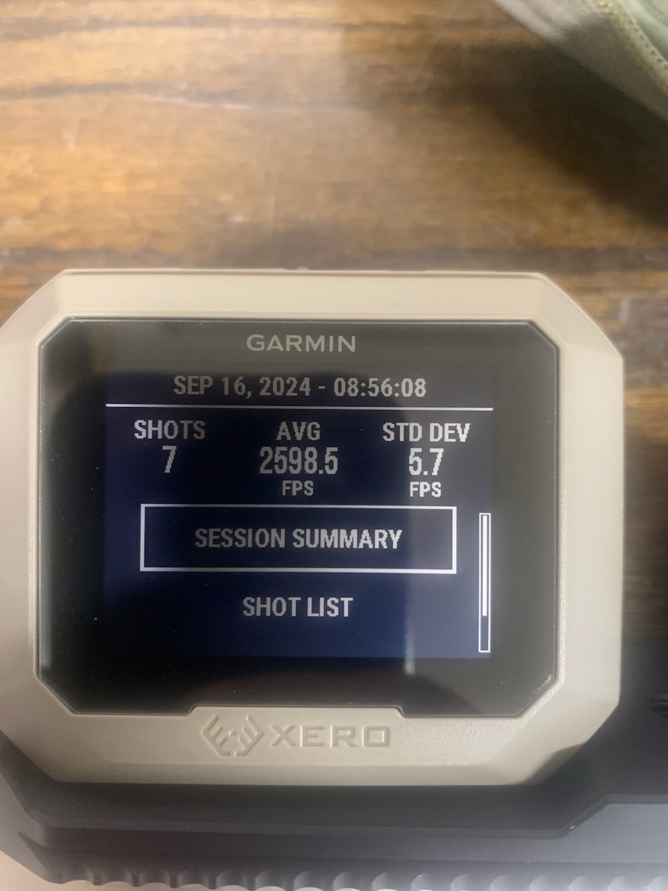

I'm getting 2512FPS from the 20" barrel. I wasn't able to record proper velocities from the 24" and redoing that is a priority of mine. But I'm suspecting around 2600FPS. With the 20" barrel, FGMM is going transonic right at 800 yards, and subsonic at 1000 yards. With the 24" barrel, FGMM is trans at 825 yards and subsonic at 1025 yards. Effectively hitting within the transonic range is not easy to do.

My factory barrel is 2750 with 175 FGMM.
Where do you live that a 175 is going transsonic at 800?
That 175 at 2550 is still going 1175 at 1000 in a standard atmosphere.
Do you live in Death Valley when it is freezing or something? It is pretty hard to get an atmosphere that dense.
Altitude is 1050 ft. I double checked latest data from my chronograph, and since reseating the barrel, the 20" is getting 2550fps from Fed. GMM SMK 175gr; I've gained 50-75fps since the reseating and retorquing of it. I don't currently have data on the 24" barrel, as it got corrupted and didn't capture the velocities.
All I shoot right now is FGMM 175gr .308 and it's consistently around 2600 in my 24" (1/10 and 1/12) and 26" (1/10) barrels. @MK20 are you sure you're getting 2750 from FGMM .308 and not the 7.62? Because that's the only way I was able to get anything over 2700.
Regardless, @HKSniper11B you'd do fine with the 175gr SMK even if it is going transonic. Frankly, I think the accuracy gain you've demonstrated with that ammo will outweigh the ballistic advantage going with something else. That said, have you tried the 185 FGMM yet?

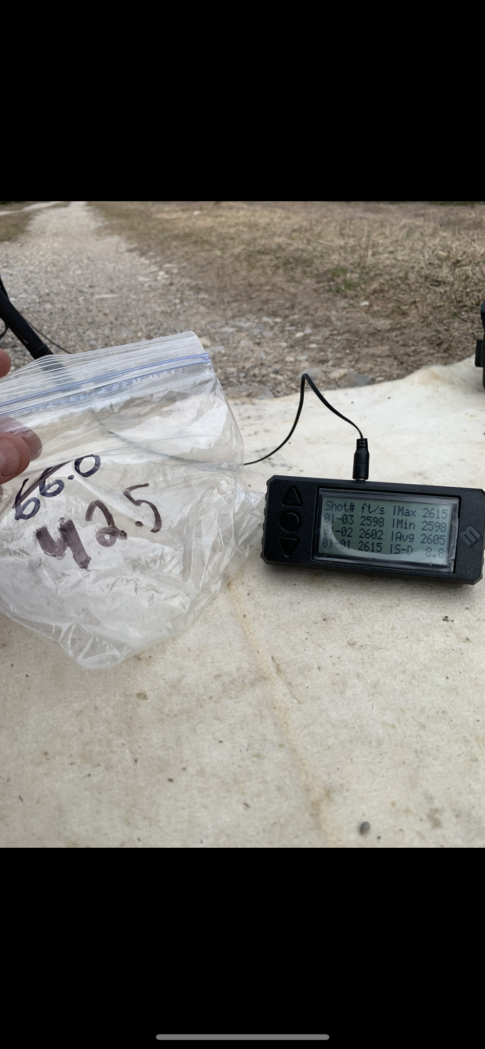

All you guys getting over 2600 from 175FGMM in a 24” can go take a long hike off a tall building. 🥲
I'm getting the same numbers from my 24", maybe up to 2615 depending on the lot. My 26" gives me 2620-2630. I have a 20" that does like 2550-2560.
There's gotta be guys here with years upon years of Arctic Warfare AW308 experience who can lend their thoughts, yea? What have been your experiences? What are you old dogs using besides custom loads? What factory ammo did you love best for your AWs? Right now, the best option I have is "Go with Fed. GMM SMK 175gr and accept being limited to 800 yards effective, 900 yards max." And I'm not satisfied with that.

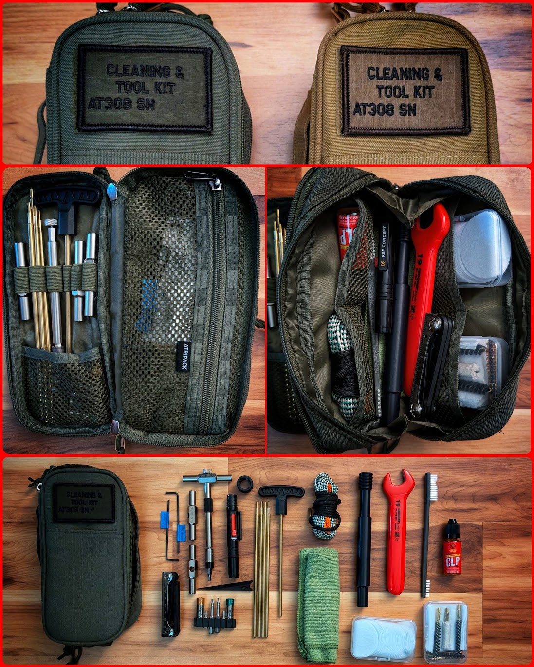

Serial numbers were blurred out.
It took a while to properly build these, but it is a 9.5"x4.5"x3" cleaning kit that holds everything. It is a children's school pencil case that originally came with a hook-loop American flag on it. The new Label Patch was custom made from Tactical Gear Junkies.
* Torque Tools are from Fixit Sticks, for scope and barrel screw
* Hex Keys are from Klein, with two separate keys for the scope (in my case, 3/32nds for Leupold turrets)
* Barrel wrench is from Gedore in Germant, a rubberized and chromed medical wrench, chosen so it doesn't marr or scuff the barrel
* Cleaning kit is from OTIS, their base kit that has bronze rods, with added nylon bore brushes
* Factory Accuracy International milled aluminum bore guide, imported from the UK. The US version is polymer.
* Hoppe's Viper Boresnake; Pro-Shot 2" bore cleaning patches
* Lens brush and microfiber cleaning cloth included
If anyone wants specific part numbers and websites to get each item, let me know and I'll do the work to update this post with everything. But I figured this is something that everyone here would want to see put together and possibly replicate.
