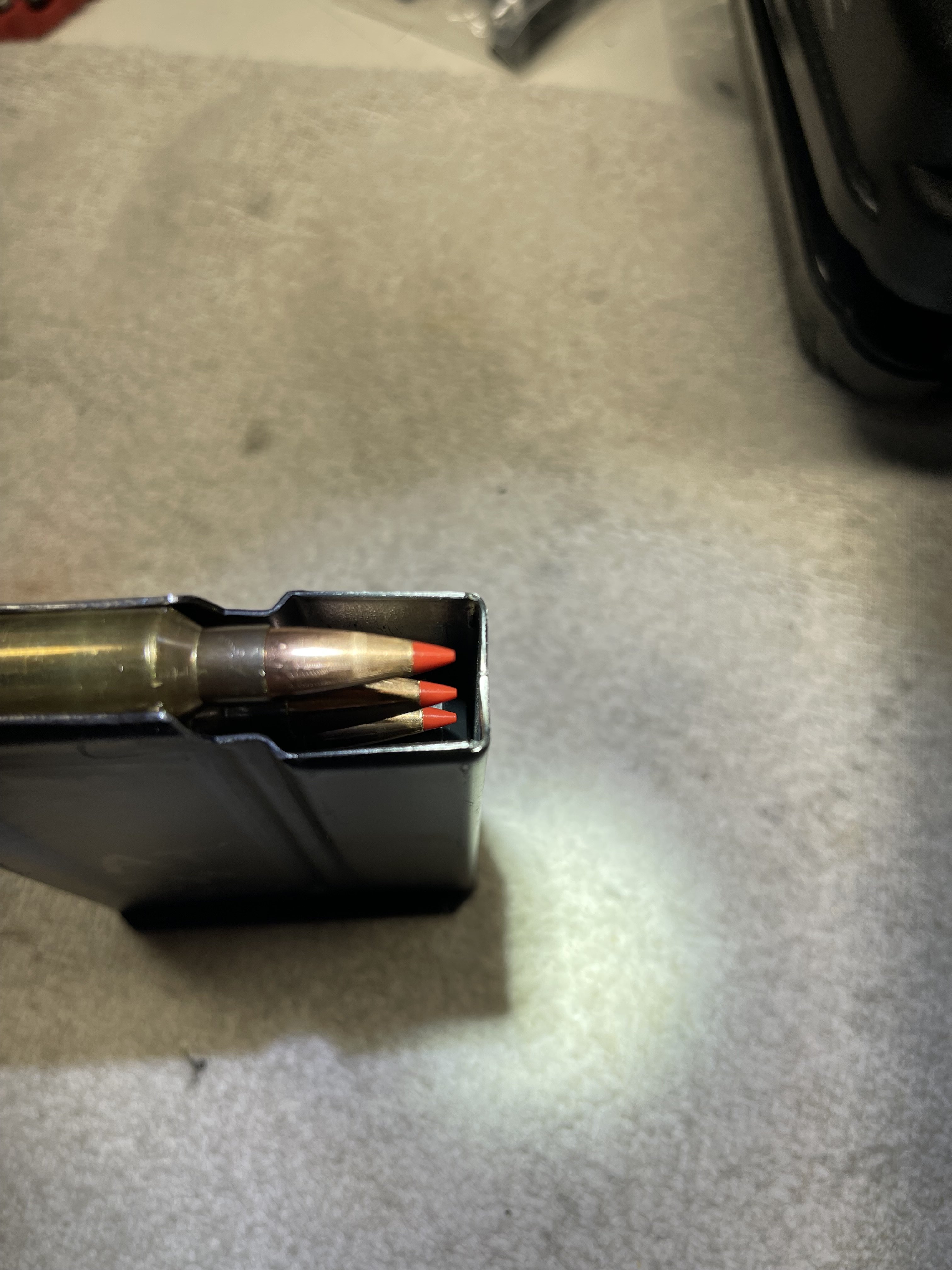

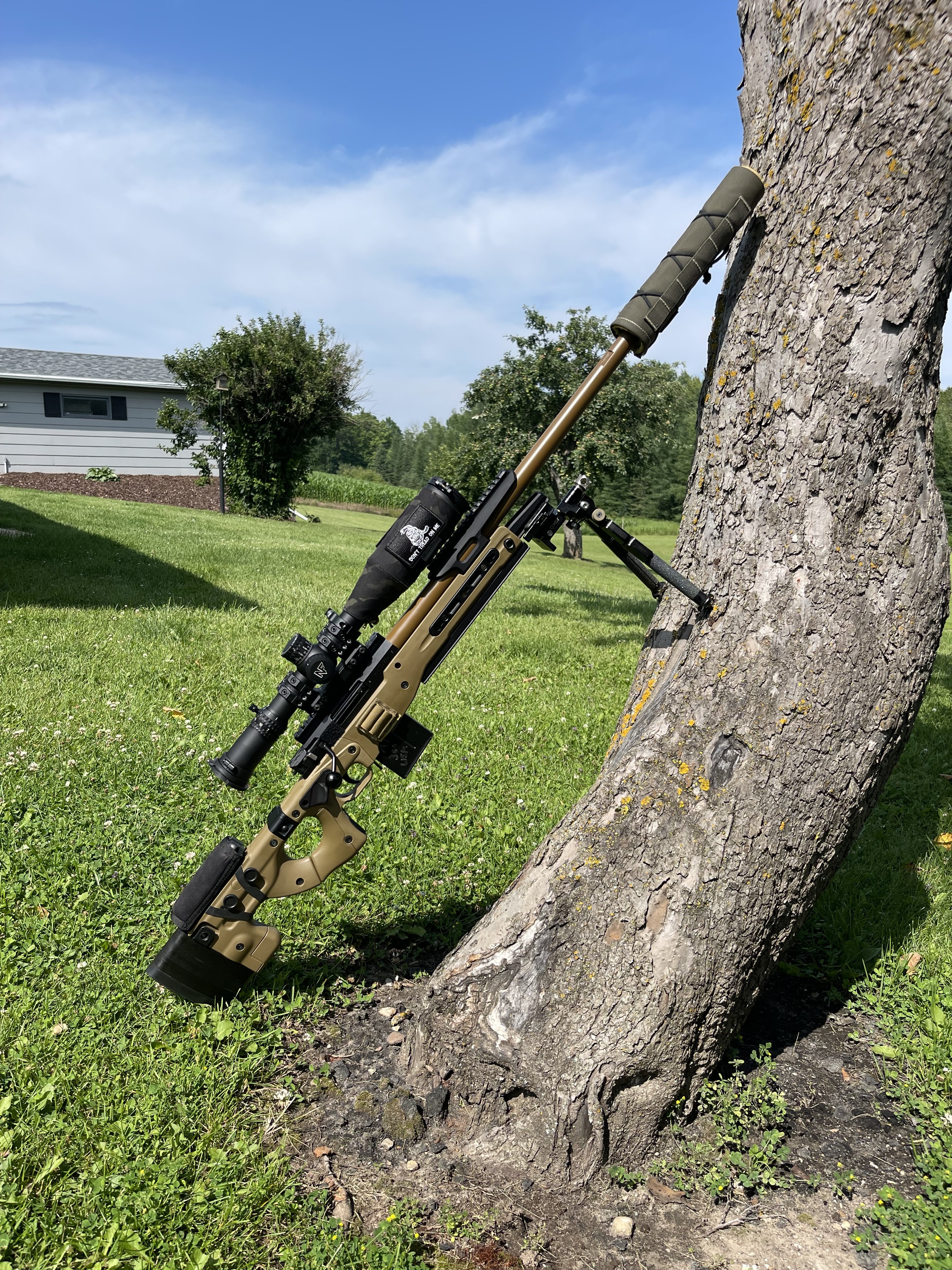

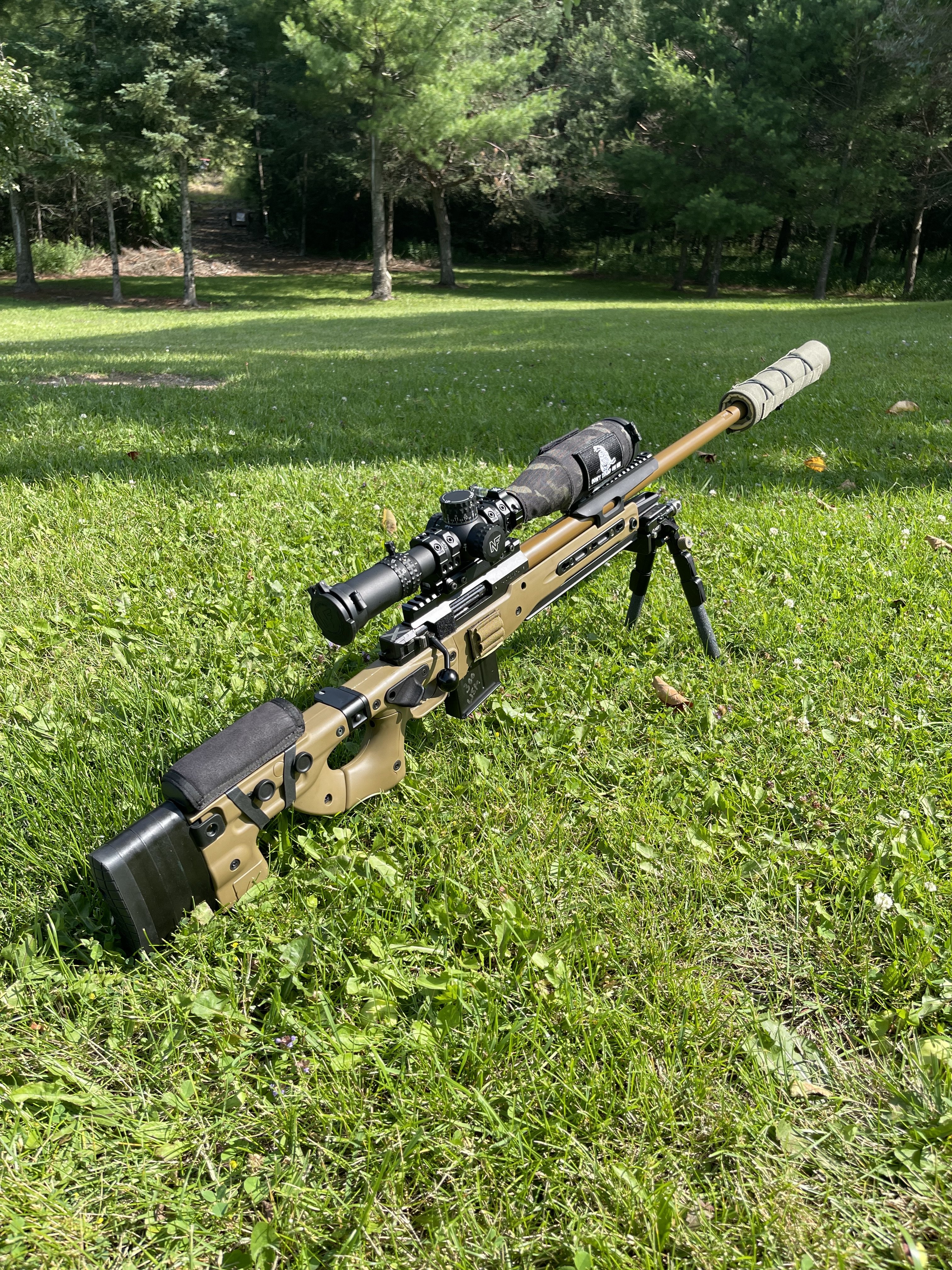

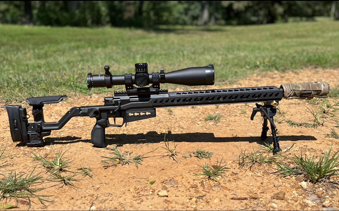

Just used this new build to get my first cleaned match at 1000 yards f-class match! KS Arms SA3R action, 6.5cm hv Palma 24” barrel with spearhead tuner! Looking to add a bag rider to this bad boy.
Looks great!! Have you tried cycling ammo through it yet to see how the bolt is functioning?
Yes. I got the 7 round mag functioning good. Took some dremel and feed lip adjustments to get it to cycle.

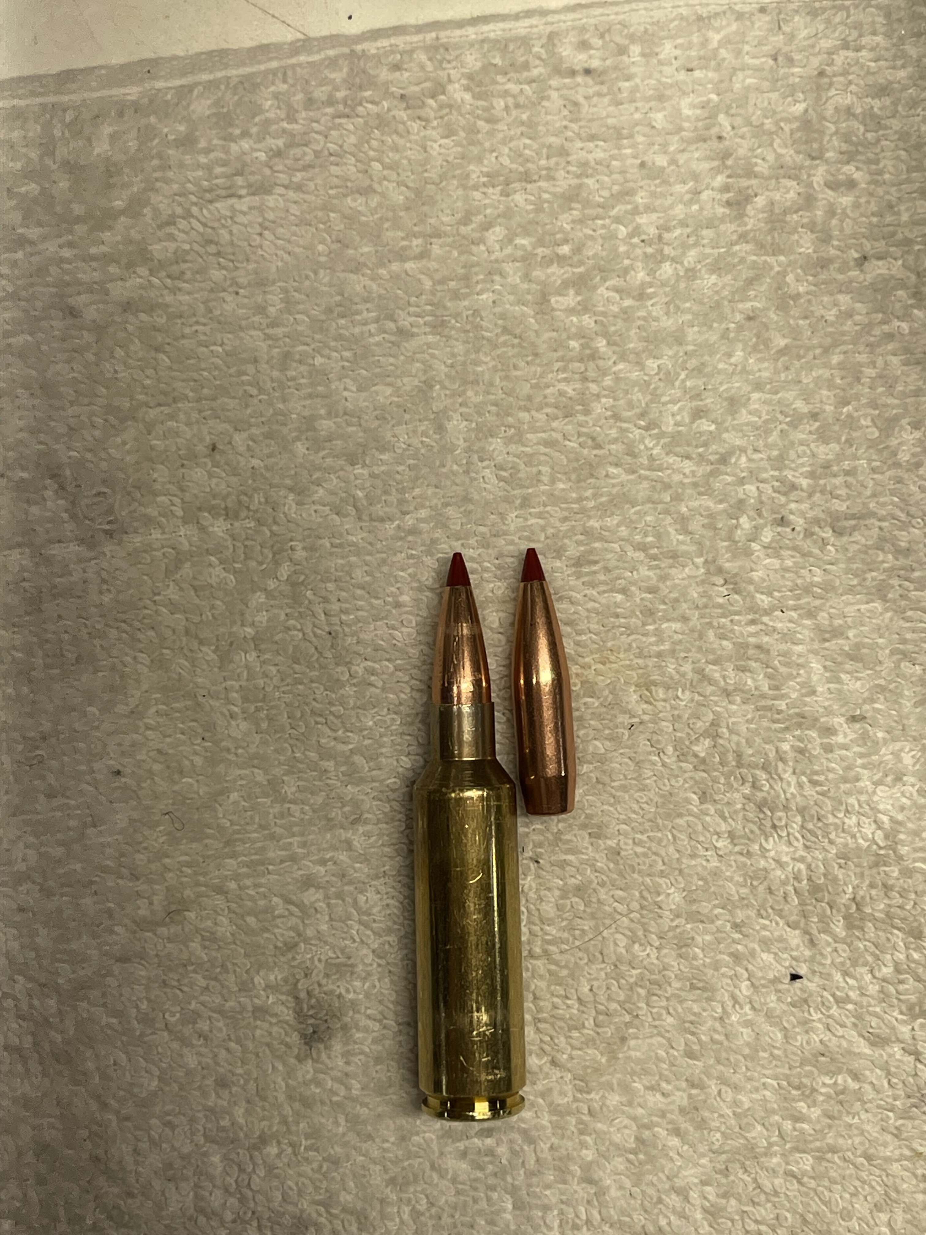

Forgot how much those AICS style mags scratch the shit out of brass. I loaded 7 rounds set .020” off the lands with 178 ELDX and messed around until they reliably cycled
For reference this is SAAMI spec chamber and the pics below are my 178’s in dummy rounds where I’ll be loading them
I bought a vld stem for my Redding comp die because it’s grabbing the bullets. So I’ll iron that out
The other thing I noticed is if you work the bolt hard it sometimes kicks past the bolt stop/bolt release block. The factory bolt that came with the gun I could not get it to do it. But this one can. Of course running it faster than I probably would anyways. But something to note
Another note: the standard AW mags are much much smoother to run. This feels like my other R700’s or Savage bolts in comparison to how smooth my AI normally runs. You also give up the ability to load the mag from inside the rifle.
Just food for thought to those moving forward pursuing similar builds
View attachment 8732978View attachment 8732979
I just want to make sure I understand. None of your observations regarding the smoothness of the action, and none of the required magazine modifications, are due to the reworked bolt body.
The only thing that gets reworked is the bolt face. When you do the conversion on a short action AI you have to run magazines that aren't necessarily designed to work in the chassis. Everyone I've spoken with that has done the conversion on the short action has varying degrees of contact between the magazine feed lips and the bolt. In your case with the long action bolt you should be using the same mags you always have, so you shouldn't see any change.
This would be correct
It’s the magazine. The bolt contacted the feed lips of the magazine which is a center feed double stack style AICS mag. Simply bending the lips out allowed the bolt to clear but the larger casing didn’t have enough room to clear the next round in the magazine when ejected. So it hung up
So the lips had to be ground down a bit so they could be bent in to hold the round lower in the chamber but also clear the center of the bolt body
@Nik H Your setup should perform just like a factory setup

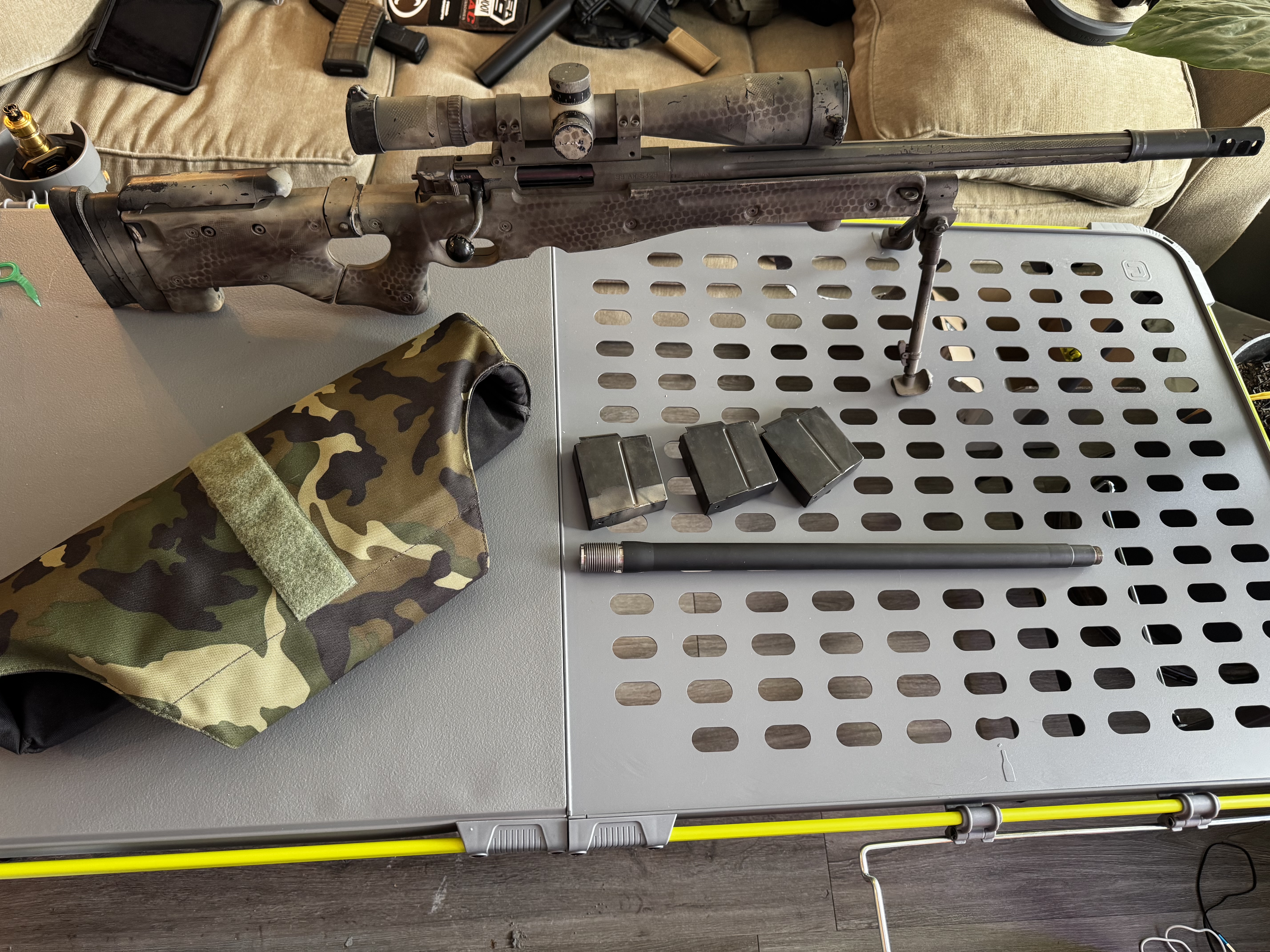

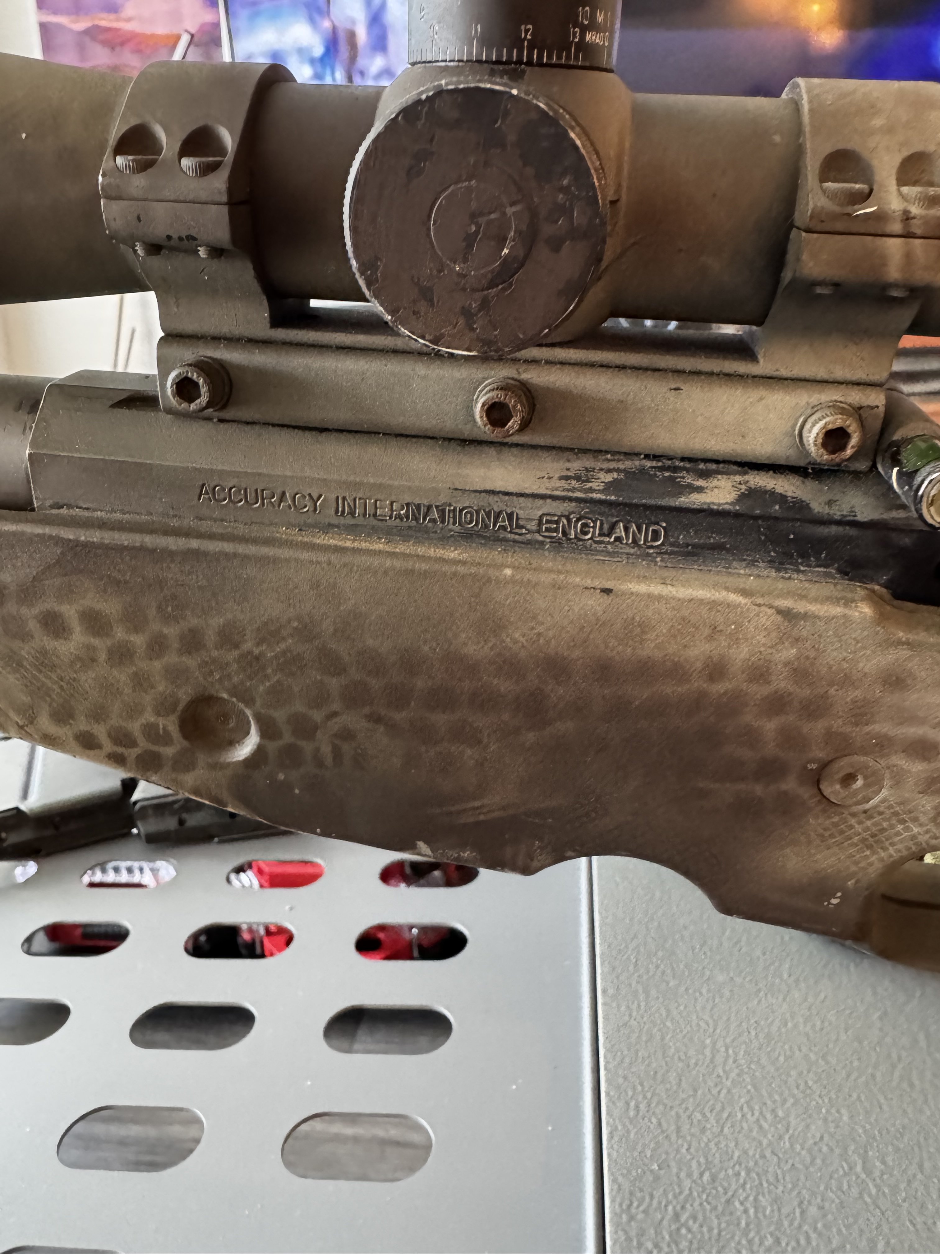

Thinking about letting this go but having trouble determining value. Suggestions? It’s an AI AWP with a second barrel, Schmidt and Bender glass View attachment IMG_1724.jpeg
You’d want AX mags
The AX/ATX mags are stagger feed similar to the AW mags used in the AW/AT rifles with a lip on the front
What you tagged above is AICS mags. Which are what the chassis use. Which are regular centerfeed mags. The AT XC should use the same mags as the AX/ATX
The optimized mag in the link below is designed to feed the more modern cartridges and is what @Roadrace33 is referring to above your post
